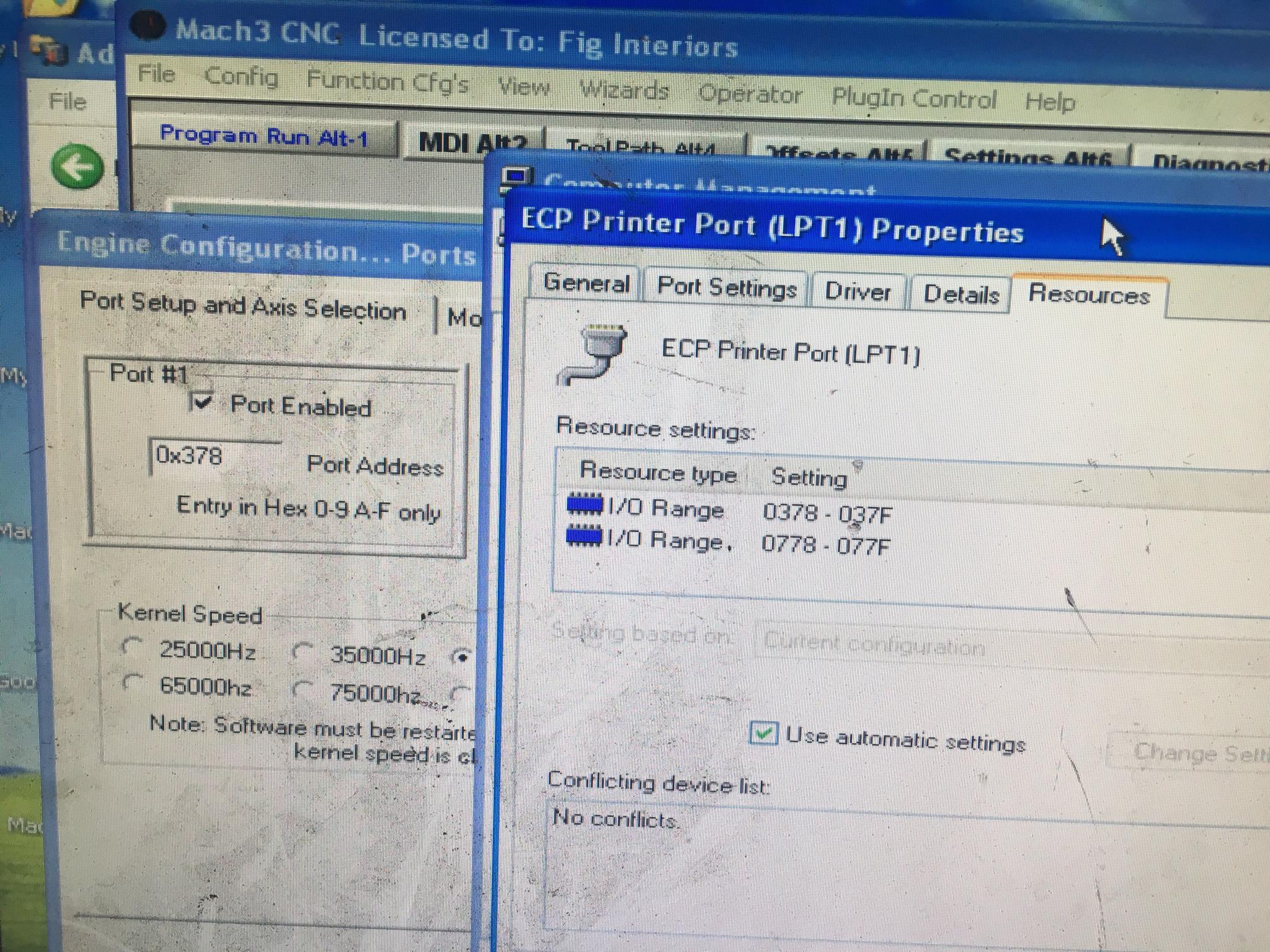

Re: Troubleshooting non responsive machine- Mach3/Syil x4
paulus.v
You said in your first post that
you have:
-replaced the pc (was on it way out anyway)
-checked the ports configured
Did you actually checked that the Port Address of your new pc parallel port matches the one you set in Mach3 (0x378)?
Attachment 26296
Is that correct or should it be the ‘com1’ address?
JAZZCNC
Don't know if this as been asked but did you install Mach3 and the parallel port driver or just copy across your old Mach3 folder.?
I bought the pc off a computer guy, he set it up with Mach 3 before giving it to me so I’m unsure - in saying that Mach3 shows up in the device manager if that’s an indication of the driver being installed- I mite reinstall Mach 3 just to be sure
JAZZCNC
Wow. Jazz may have just jumped back in from obscurity to save the day.
OP/Mitch. For information. I was playing this morning with an old XP machine that I'd been previously using with Mach3 and an ethernet motion controller. I was having exactly the behaviour that you described during my diatribe yesterday - no response from Mach3 to any of the parallel port settings. Using both a DMM and oscilloscope I could get no joy from the parallel port, even though Mach3 was configured for parallel port interface.
I've now re-installed Mach3, ensuring that I included the parallel port driver. Immediately there's life in the system. I can measure the X-DIR signal alternating between 0 and 3.3V (note, not 5V.... I'd turned the printer port from Bi-Directional to EPP mode in the computer BIOS, in doing so the signal level on the parallel port changed from 5V logic to 3.3V logic).
Ignoring the e-stop (as OP described - it can't be obviously disabled - but you can set the port# to 0 which looks to effectively disable it) - I can short pin 17 to pin 11 (configure that for e.g. X-Home) and confirm on diagnostic page that I can toggle this with left/right control.
To summarise - even though the parallel port may be selected within Mach3, unless you install the parallel port driver - my experience is that you're on a hiding to nothing.
Doddy
So I uninstalled then reinstalled Mach 3 and installed the parallel driver.
When I started Mach 3 and pressed the rest button - the warning appeared that basically says you estop is on - I pressed ok then pressed the reset button again and the warning appeared again.
I then went into ports and pins and and changed the estop from active low.
Then pressed reset again and no warning appeared however the machine still has no life nor does estop in the diagnostics screen
