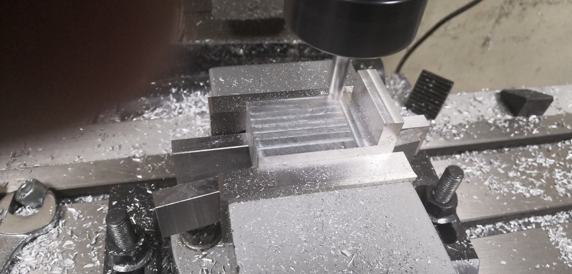

I also thought twice before milling the locating slots on the different plates. On some joints it is not so critical, such as attaching a stepper mounting plate but when you are joining two plates that locate the axis at exactly 90 degrees such as where my gantry end plates join the X bearing plates it is super critical. In this example it was also critical the slots in the top of the X bearing plates were not only planar with the plate surface but also identical depth on both X bearing plates.
When I mill out shapes from plate I clamp the plate to MDF so the cutter clears the mill table. MDF (particularly when it has sat in the garage for a year) is not sufficiently uniform for accurate Z milling. Therefore I mill these slots after the outside profile has been finished. I set the Z height on the mill and lock the axis then I clamp each X bearing plate to the mill table directly and mill the slot. I do both plates without unlocking the Z axis so they should be identical.
Before doing any of this critical stuff (particularly milling the gantry extrusion flat where the Y rails are mounted) I checked the mill table was flat within 0.01mm over the entire travel with a DTI in the spindle. You don't want to do this if your saddle is sloppy or any long work really.
I'm an amateur machinist at best, only been playing around with the manual machine for a few months really so take this advice with a pinch of salt. The slots are within 0.01mm in depth over their length which is good enough and no worse than the milled plate itself. It is quite satisfying when you get a friction fit on the joint between two plates.
Also bear in mind that the milled plate isn't exactly whatever nominal dimension you purchase, mine in nominally 16mm but is infact 16.055mm thick, also your cutters are not exactly whatever dimension they are supposed to be. This means if you just mill the slot to the DRO readout it wont be the correct width.
What I do is designate one side of the slot as the reference since my cad drawing assumes 16mm plate, then mill that. Then open up the slot and use a piece of clean spare plate to test the slot until you get a nice fit, this is much more accurate than trying to measure with a vernier or micrometer as the slot is too shallow.

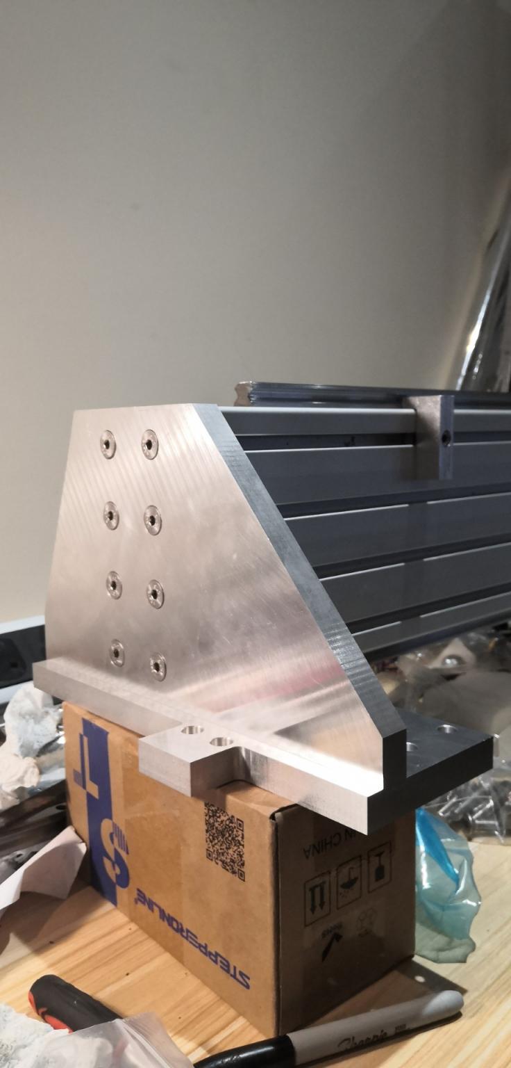

7 Attachment(s)
Re: Joe's 1000x600x200 steel and aluminium router started

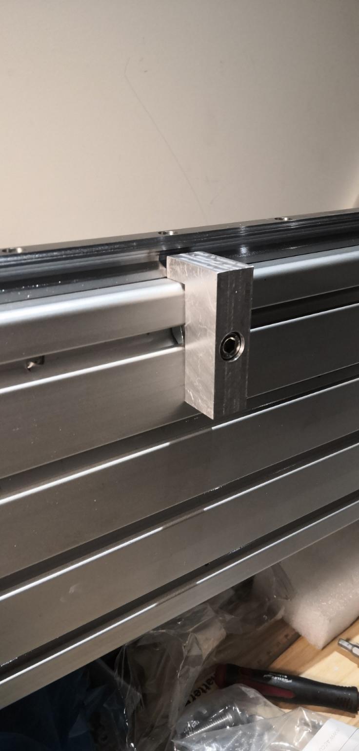

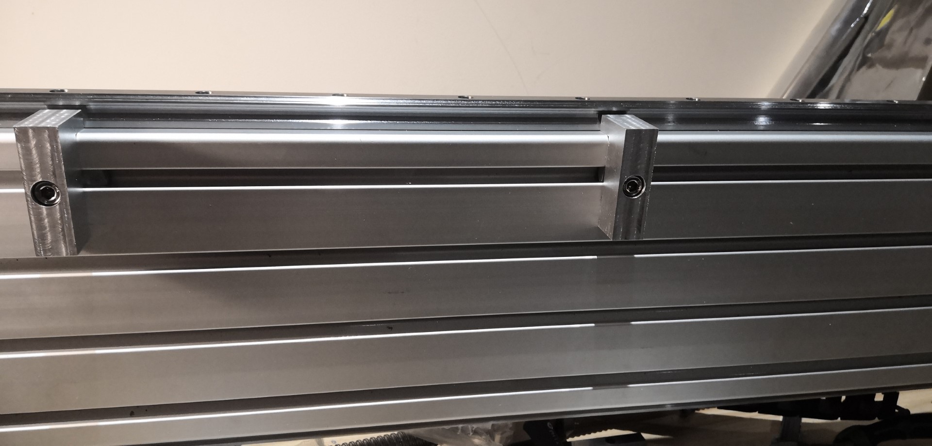

Once I fit the gantry end plate assemblies to the gantry I wont be able to mount the Z assembly without removing one of them, therefore I think this it is time to align and tighten the Y rails to the gantry in their final location.
For this I have just machined some precise setting tools, they were machined as a pair to ensure they are identical.
Attachment 26988
Here they are attached to the gantry, they bolt into the T-slot. Plan is to snug them up, the milled faces should then act as a reference surface to match up the reference edge on the hiwin rail, they will be moved along for each rail bolt. Note that I made them long enough so they extend across two of the high points that are on the reference plane on the face of the gantry extrusion.
Attachment 26989 Attachment 26990

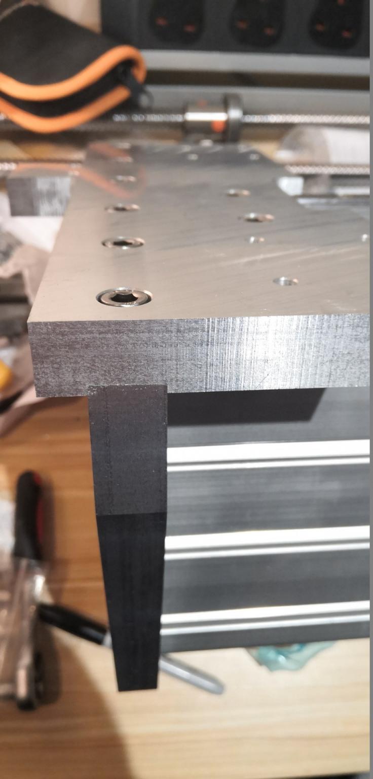

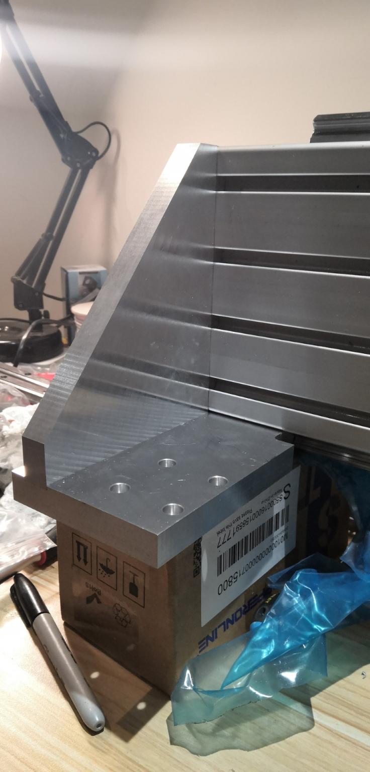

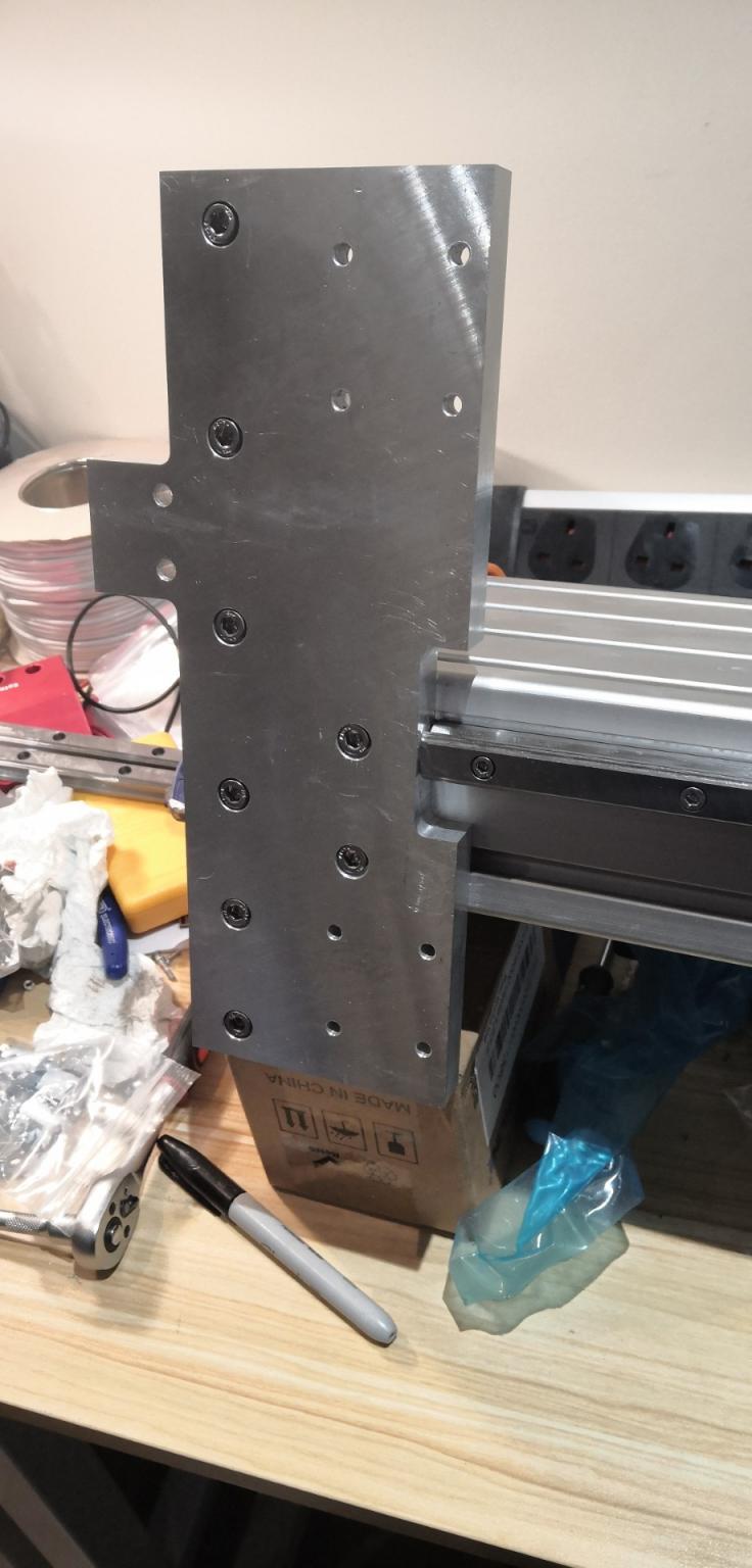

First gantry end assembly bolted in place, I used countersunk M8 bolts rather than cap head to reduce the amount of material removal for the counterbore, meant the countersinks had to be done on the mill as there is very little adjustment vs a cap head. As well as the 8 M8 bolts into the end of the extrusion there are also two M6 bolts bolting up through the X bearing plate into the two T-slots on the bottom of the gantry.
Attachment 26983 Attachment 26984
Bottom view showing bolts fixing up into extrusion:
Attachment 26985
Plate-plate joint using the alignment slot:
Attachment 26986

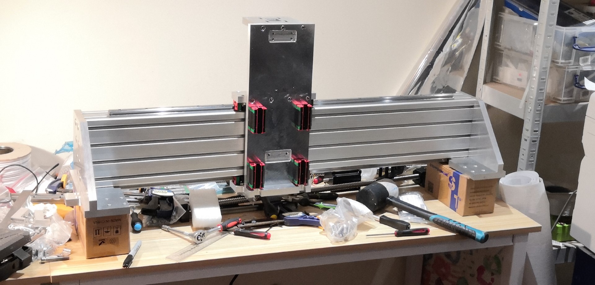

Y rails are now fixed in their final position using the setting tools described above, worked very well and was super quick to do. Both gantry end assemblies are aligned and bolted to check final fit, everything looks good. Note rubber mallet, this is a precision build honest ;-)
Attachment 26987
Other than ballscrews everything from the X plates upwards is now complete, will move back to the steel frame next, need to decide whether to pour epoxy or attempt to rig up a mobile surface grinding contraption to bring the frame into plane.
