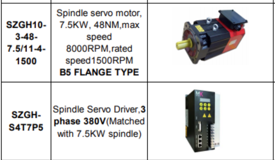

So SZGH are saying that this spindle setup wont work behind an invertor / filter. Of course, it might, but not surprised as without testing / knowing, they put their hardware and reliability at risk.
So, anyone want to buy a 7.5KW 380 3 Phase Driver, Spindle Servo Motor, cables and braking resistor? The cost to me was $USD 990, plus a bit of tax and sadly the shipment was expensive due to the weight of the motor (60 ish KG). Let me know if interested. Ill possibly stick it up for sale on a few other places too.
Surely it's only the drive you require not the motor.? this wouldn't cost a fortune to replace. What is the model number of the drive, so I can check it against mine which does supposedly work with single-phase, though I haven't tried it, and will use 3 phase anyway?

I thought so too, so queried with them, reckon no go as the motor is wired for 380V. I did notice when I connected it they only expose 3 wires, so cant change from high to low voltage.
The drive is SZGH-S4T7P5, the motor is SZGH10-3-48-7.5/11-4-1500.
Attachment 29505

Would you get a single phase drive for a motor that size?
For servo drives 3Kw seems to be about the max for single phase and I would have thought spindle drives would be the same.

Good question. I hope so, otherwise Ill need to make a plan here.
I run my 6.8 KW 24K HSD spindle on single phase with an inverter. Its a 380V version but I know you can specify 220V at that power.

When I asked SZGH Mike told me the drive I have could be run on a single-phase supply but at a de-rated motor output.(approx 20%) Not that it matters because I will be running it on 3 phase anyway.

And that was my understanding too. What I did not pick up was that the version I ordered is 380V only. Ive had words with them, I intend to order more stuff - then they quoted on Friday for 220V 3 Phase despite me reminding them I only have single phase.
They suggested they could supply one of the items at cost as a 'sorry' for the issue but then tell me how much more complicated / expensive the 220V version is, so perhaps no discount after all. Lets see, Ill probably hear from Susie in the morning.
