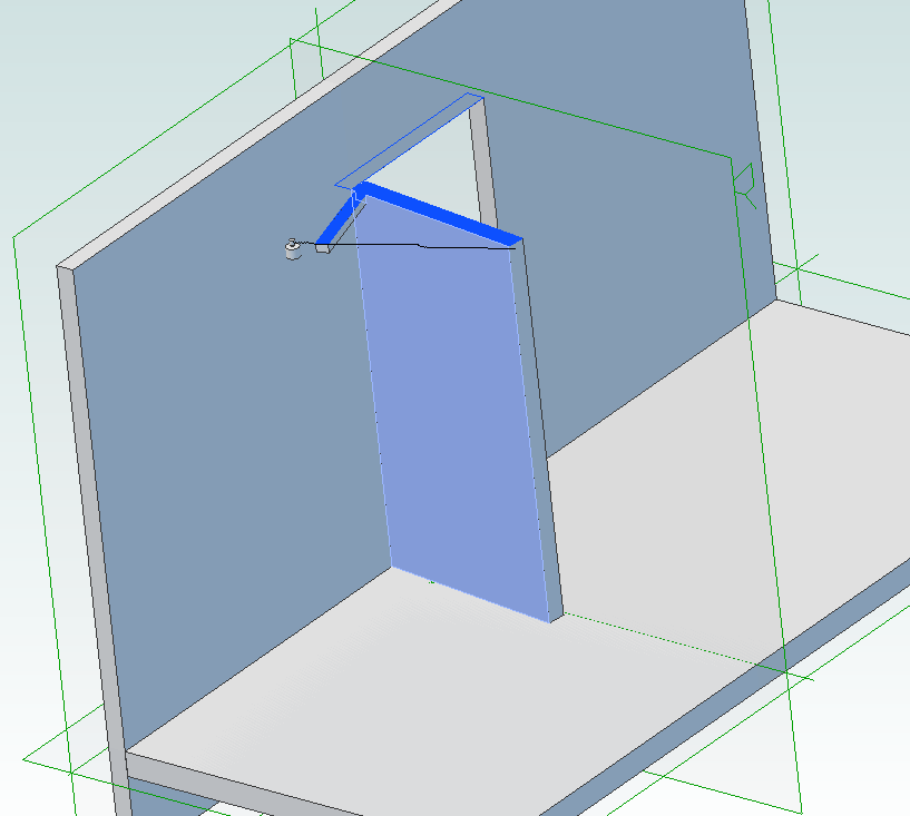

Re: A new life - irving reborn after near fatal accident
How about this for a Heath Robinson solution...
Door is closed by a standard door closer.
Door is opened by string wound around a bobbin on an electric motor.
I haven't had time to look at interference between opener and closer but it should be possible to work around it.
Apologies for the dreadful drawings...
http://www.mycncuk.com/attachment.ph...id=14482&stc=1http://www.mycncuk.com/attachment.ph...id=14483&stc=1
lol, don't think my wife would accept a heath-robinson approach! having said that, I did look at a cable pull design, but the door closers don't give a positive closure against the draft proofing for the multipoint locking to engage, so needs to be an active pull closure as well. also needs a clutch/freewheel to allow manual opening of the door.
