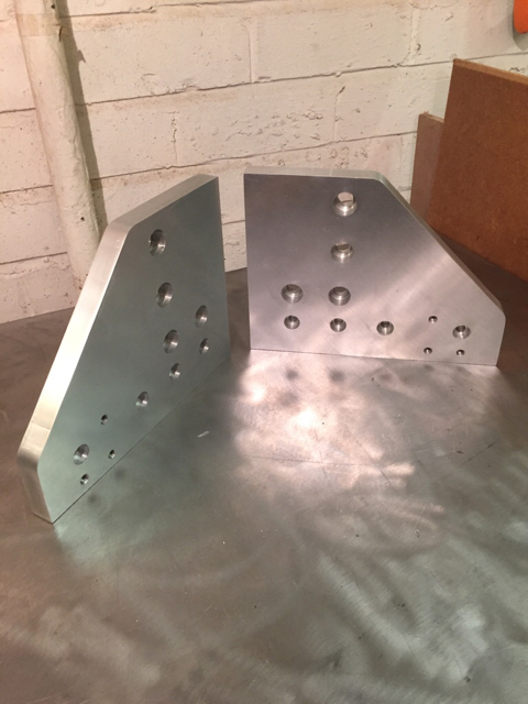

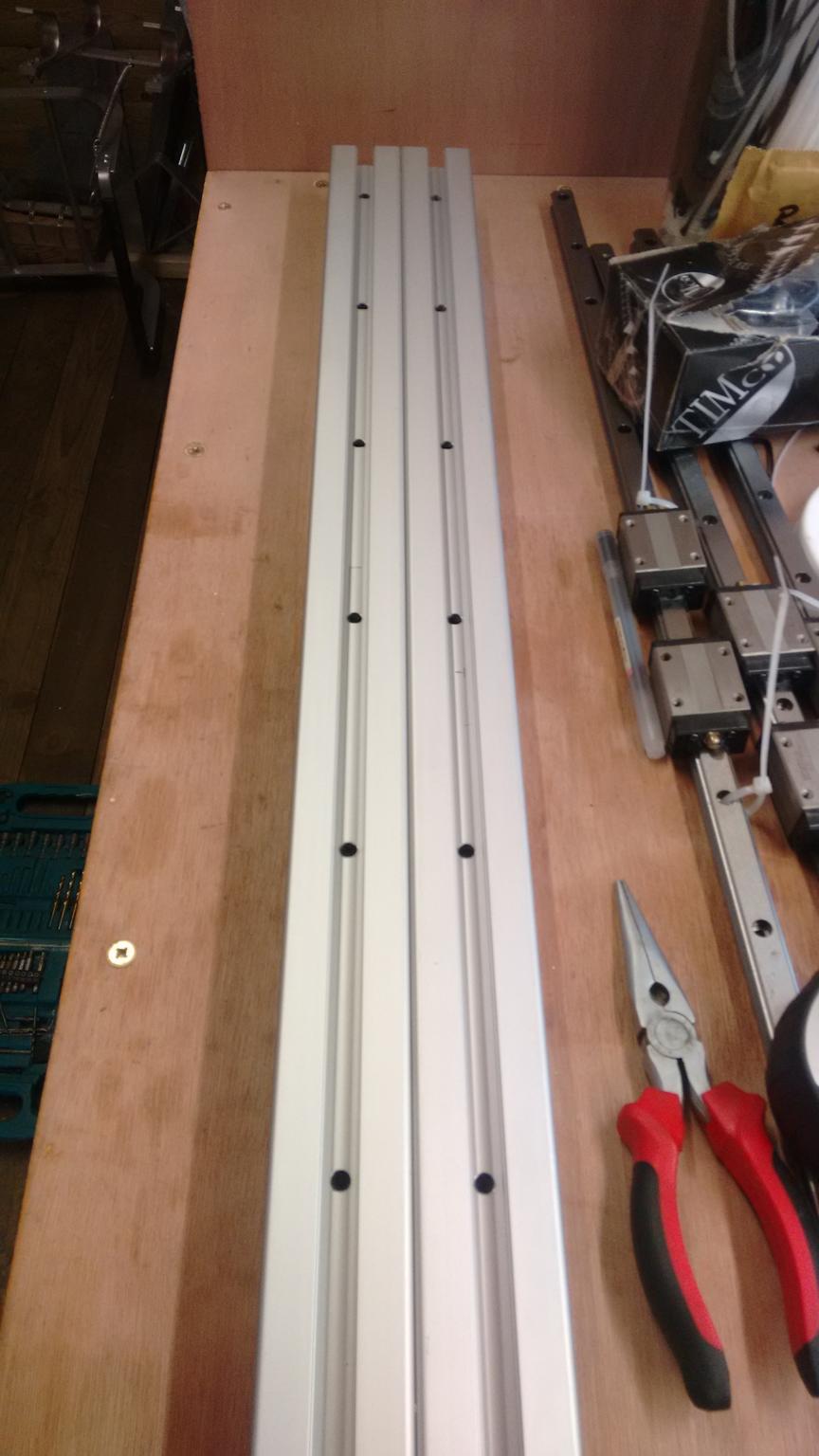

I have counterbored m12s into 20mm plate. The 8mm left between the head and the extrusion is plenty enough.
Printable View

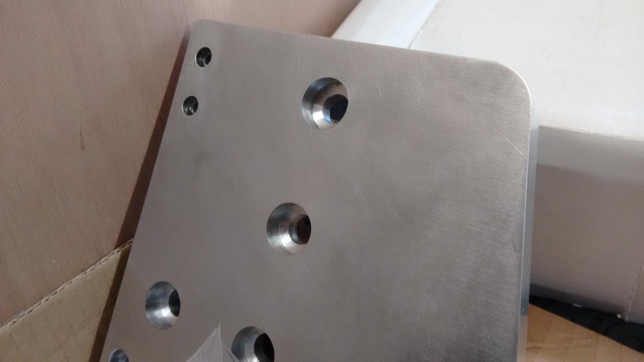

I think that looks like the best solution. There 20mm so 8.4mm thickness left according to solidworks. Now the question is, do I attempt to drill them out and re-bore myself or send them back and get them re-done professionally? I'm worried about the drill bit wandering off from centre.
Attachment 17511

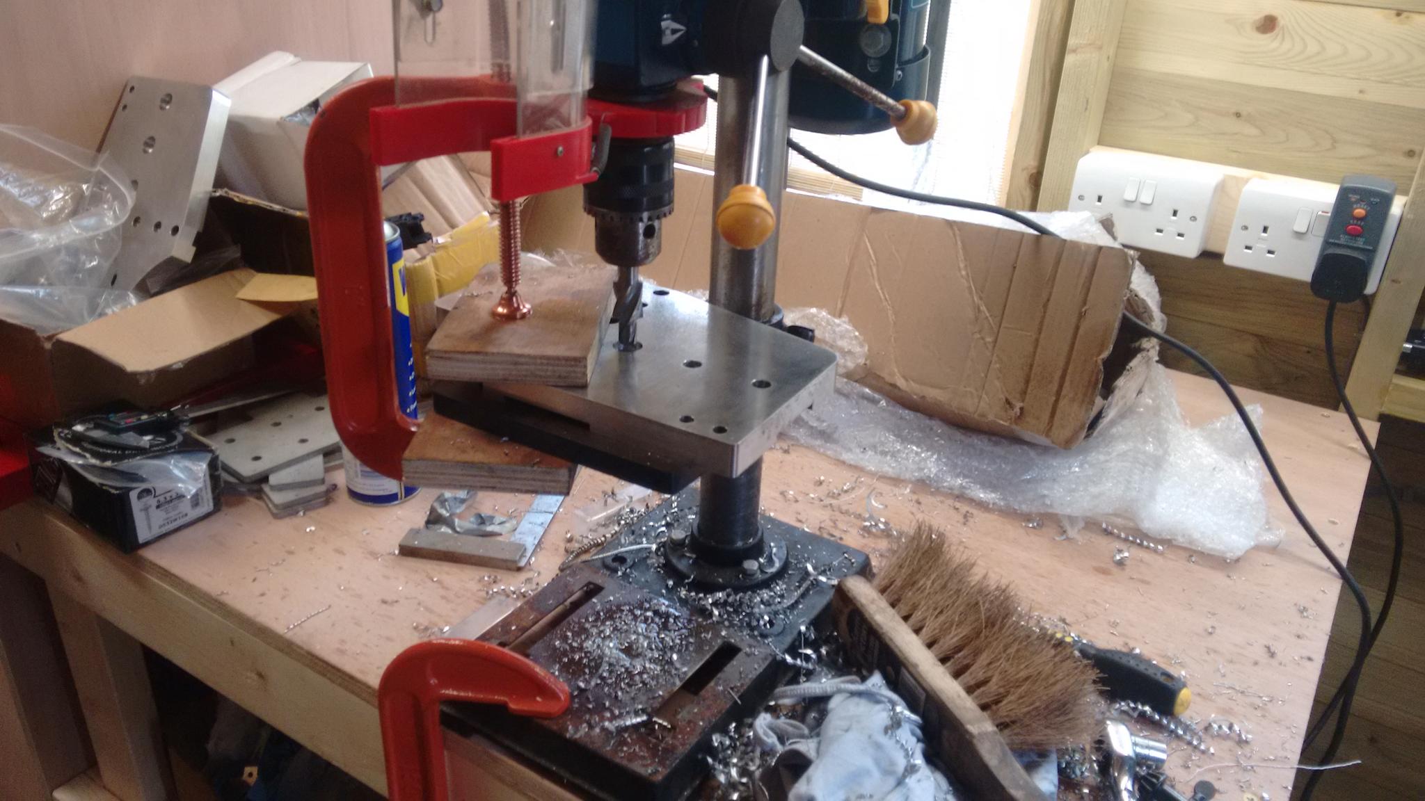

Attachment 17512 these were drilled out with several bits starting small and working up...... You would just be starting further down this process?
They look very good! I assume you used a drill press? (mine is an el cheapo one and has a bit of play in the head). Did you use any kind of guide for the bit?
No, no guide and my press is only a table top Axminster thing so nothing pro! Attachment 17513
Minor detail not worth stressing over. Domed head look fine without being counter bored so don't bother just drill them out to 12mm.
Attachment 17515
Wow Jazzy! Pimp my ride eh?!
Fair point but I have to say counterboring is strangely pleasurable!!
Also - if you counterbore you could cap the holes with diamonds to complete the look!!
I was wondering if a step drill (13mm max diameter) would be a better idea for enlarging as it would be self centering?
Step drills are intended more for sheet metal. I would get a decent hss twist bit. You can pick up dormer bits on eBay for very little. http://www.ebay.co.uk/ulk/itm/140928964799
I think you'll be fine, what may happen is you get chatter from the drill so may end up with the not so perfect edge.
Also you don't really need to buy proper counter bores, the right size drill bit used in the same way works great for pretty much the same effect, do you really need need flat bottom holes for the cap head to live in?

I'm stepping up to 15.5 and 20mm for the screw clearance hole (the very middle one) :). I can show the bigger holes if you really want but they came out pretty decent, don't use a step drill and if you don't mind go for quality drill bits.
If you do end up with a less desirable finish on the bore OD, you can always add a chamfer with a counter sink or again an over sized drill bit.

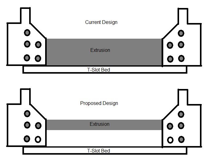

I have started to really think more about swarf and coolant removal during/after machining. Hopefully the paint diagram below will help explain what I'm thinking about doing. The gap will allow me to brush swarf straight off and into a bucket under the bench. Would the proposed design weaken the frame too much?
Attachment 17605
EDIT: Infact, could I even remove that extrusion completely or is it going to put too much outwards pressure on the sides?

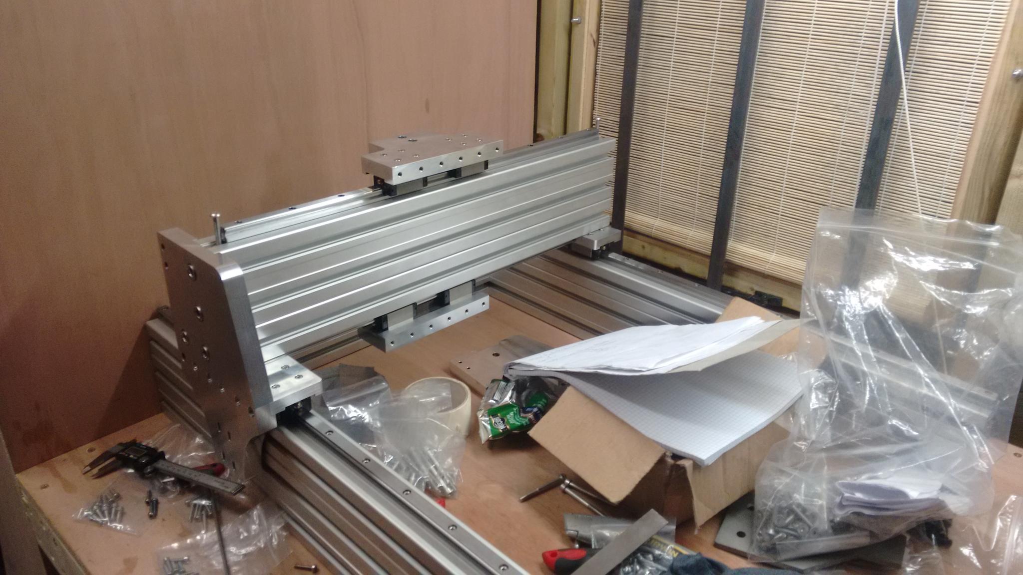

I need some help if I may. On the x axis (long axis) when the gantry approaches either end of the bed, the ballscrew gets tighter. It's not just one side, happens to both. Something must be bowed?Attachment 17912Attachment 17913Attachment 17914
And could anyone explain what tramming is please?
If the ballscrews are bent then you will get a periodic tightening as you rotate it, especially at either end of travel.
If the ballscrews / mounts / nuts are all mis-aligned then it will have a constant tightening at either / both ends.
Assuming the ballscrew is fairly straight then looking at the design the ballscrew supports and ballnut bracket are probably not completely in line. It doesn't look like you can adjust in the plane away from the sides of the machine, only up and down.
Try moving the machine to the driven end, loosen the 6 bolts holding the ballnut to the ballnut bracket, and remove the floating end bearing. This should allow the ballnut to sit in an unloaded position.
Nip the bolts back up and move the gantry over to the other end. Gently slide the floating bearing back on - it should sit snug onto the mounting block on the side of the gantry. If it is out, fit a shim. If it is tight you need to machine a bit off the mounting block.

I think I've solved the ballscrew problem, re-made one of the BF mounting blocks and shimmed it a little. How hard should it be to push the gantry back and forth on the machine? It takes quite a lot of force to get it going then it still requires a far amount of force to push it...
The mechanical build is nearly complete, just got the back gantry cover to finish!
Attachment 17963Attachment 17964Attachment 17965
My one slides fairly easy with the belts off.
Did you try loosening the bolts on the BK & BF then moving the motion to the bK end and nipping them up then move to opposite end and nip the bolts up - there should be no tension on the screw when the bolts pull up.
This worked wonders on my build.
If you mean with the ballnuts disconnected from the gantry then the gantry should move with one finger. A light shove should see it carry on for a bit and coast to a halt.
If it is hard to move and stops as soon as you stop pushing then either bearings are faulty (unlikely if new) or more likely is they are misaligned relative to each other.
They are very intolerant of misalignment in any plane. This is why epoxy is popular. One side could be higher than the other side, or they could be the same height but twisted, or they could not be parallel etc. etc. I does not take much to make them bind.
