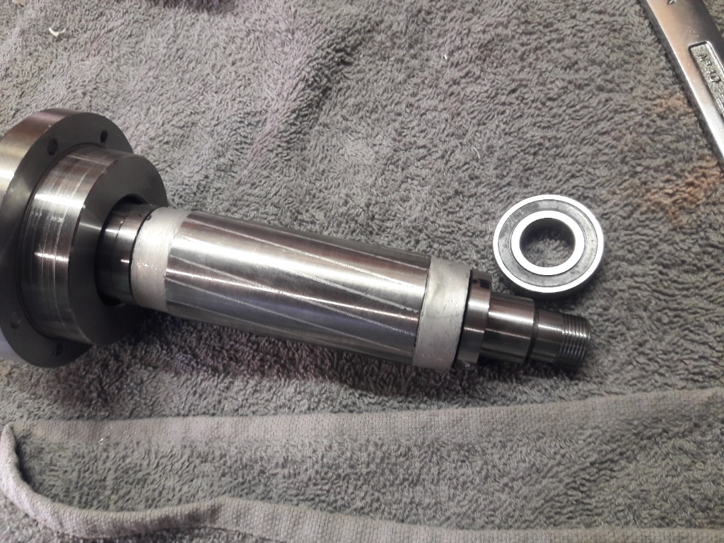

I've been looking for the difinitive "How to dissassemble, re-grease and reassemble your 2.2Kw water cooled spindle without breaking it" thread but haven't found it. I'm sure a list of key pointers to what you must and must not do and what tools you must have before you begin would be much appreciated by many readers contemplating a check of their bearings. Is this something the pro users do regularly?
6 Attachment(s)
Re: The 2.2Kw Chinese Spindles - Info, Setup and Advice + More
Spindle: 1 Me: 0
It's a pita because you must fabricate your tools, and even they easily breaks (only 2.5mm pins...). You must heat at least 3 minutes in full power with your heater before trying unscrew this "#&@% full of holes". I enlarged them to 5mm,. But after this first victory, there's another flange. End of the story for me.
Attachment 27398
Attachment 27399
Attachment 27400
Attachment 27401
Attachment 27402Attachment 27403
The 6002 bearing must have the large side pointed to the top. It's not a radial bearing.
