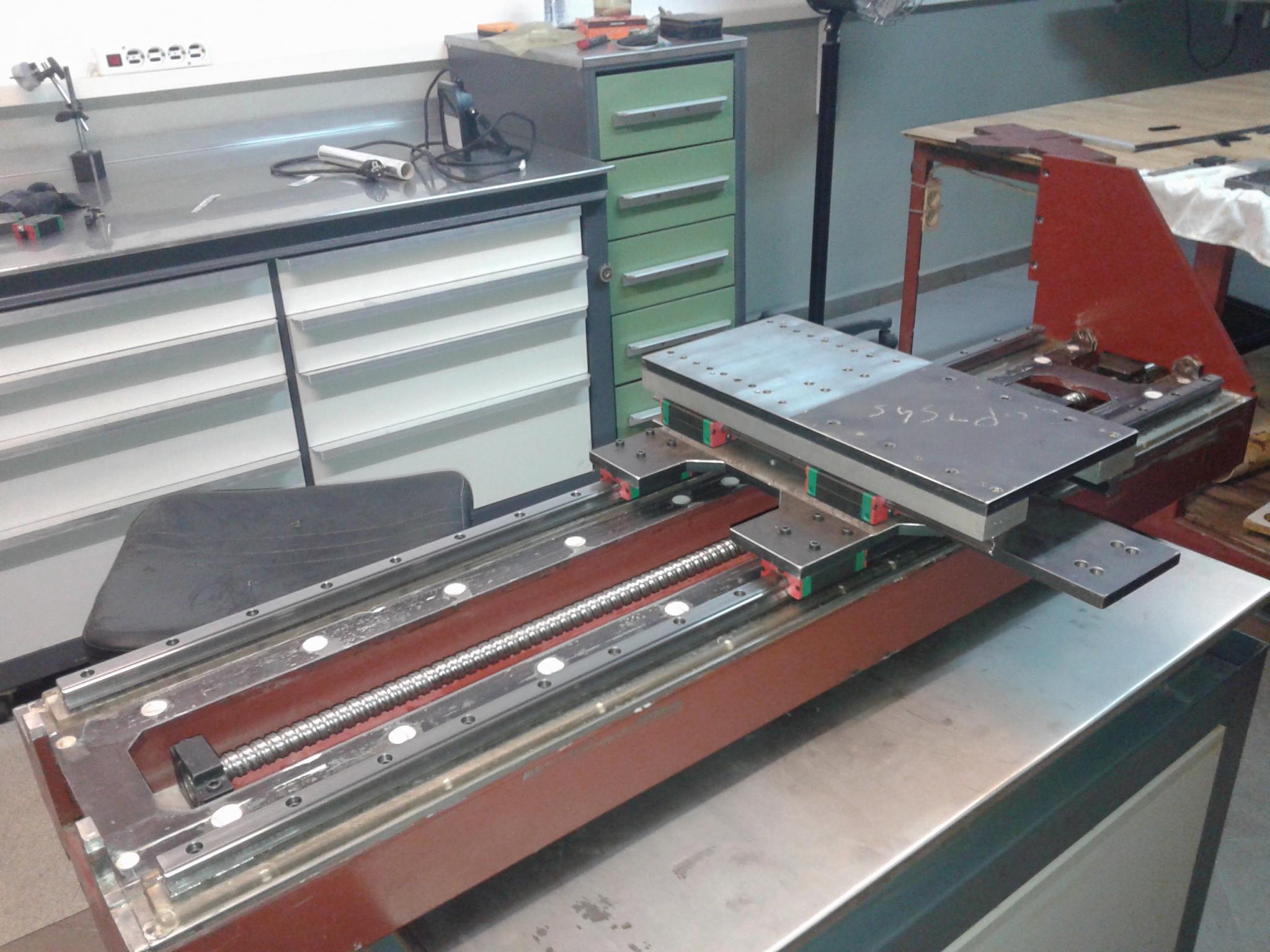

After shimming I try to attach the y axis steel plate (that moves left right)
My question is how tight should be moved. I know that the hiwin carriages have some preload in order to be more accurate.
I made some tests
I use a zero flat ( from surface grinder) steel plate that will be used for my x axis.
I connect to this plate two carriages and put it on the y axis rails
By using a kitchen scale I measure 700gr force for the plate to move
I did the same with the y axis plate( that has been milled in a mill and it is nearly 3 times havier). It needs 2,7 kgr force to move it.
I made a video that show the two plates
First I move the x axis plate (that will be used in x axis), and then the y axis plate
I would like to ask if what you see and what you hear is normal for hiwin carriages
Also if there is any suggestion for grease for the hiwin carriages

Re: Stell frame cnc 1500X1000. Adjustable table your opinion please
That sounds a little dry - do they have any grease in the carriages??
2.7kg also sounds tight - if this is a truck on two parallel rails, i would slacken the screws on one rail, fit the carriage/plate etc and the gently tighten the screws as you slide the carriage assembly along. Also the same for the screws holding the carriages to the plate - slacken and tighten them with the assembly in position. This allows all alignment stresses to be released hopefully.
Still sounds like it needs grease though, my HiWin stuff was very quiet.

Yes you are correct, I haven’t put any grease yet
Is there any special type of grease for these carriages, or a general purpose grease can do the job?
ba99297
A general purpose Lithium 2 grease will do just fine:
http://uploads.tapatalk-cdn.com/2016...3ae9dd03e0.jpg
A Premium quality mineral oil, lithium thickened lubricating grease suitable for general purpose applications in plain and anti-friction bearings.
Conforms to leading bearing manufacturers specifications for general purpose industrial and automotive grease.

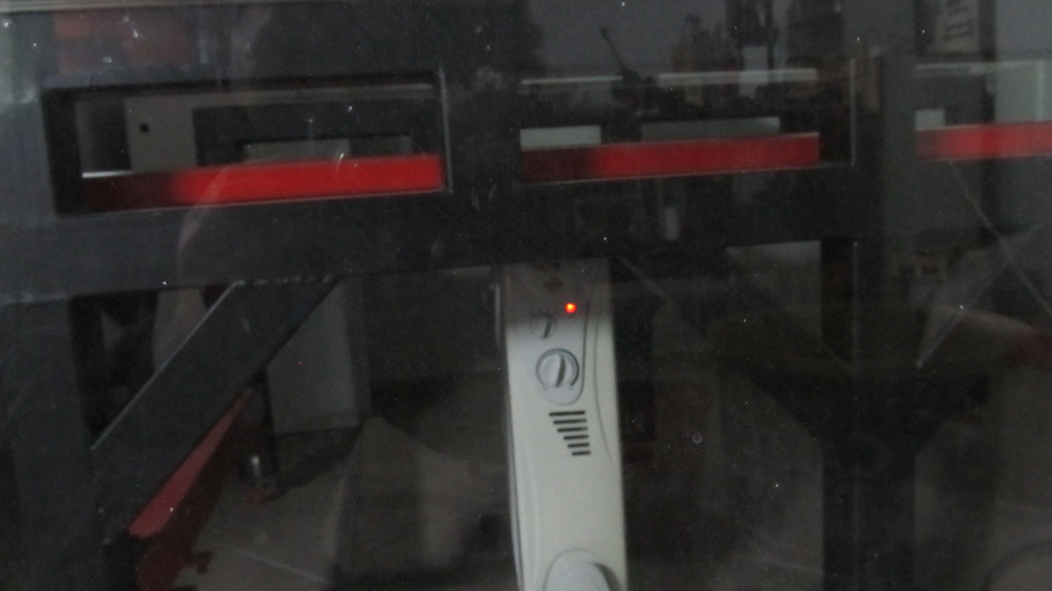

All the previous night i use an electric heater to rise the temperature to 20-21 celcious
Attachment 20263

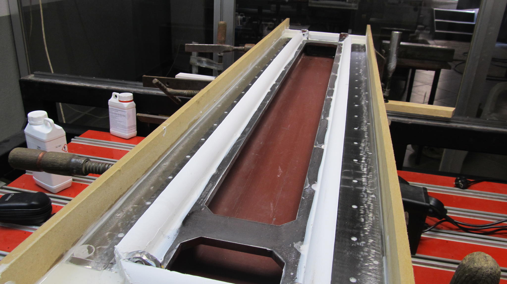

Today morning i start creating the dome
Attachment 20264
I use both mdf and foam
Attachment 20265
Attachment 20267
Here is the epoxy i use
Attachment 20268
More than 10 hours working time
300 mpas viscosity
Pot life 29 hours (70 ml at 23c)
48 hours at 20 co after casting the first epoxy layer (4mm thick) is sticky and starts hardening.
Today morning 8-1-2017 I apply the second layer (also 4mm thick)
Things seem to be ok.
if so you need a moat between them
If you see the photos that i upload, i already have made two moats, at the edges of the gantry
Attachment 20316
They are the white extensions left and right of the gantry
It is like a cyrcle. All the epoxy surface (underneath the rails and the moats) are 50mm wide
Thanks Clive

Some photos of my progress till now
Attachment 29291
Attachment 29292
Attachment 29293
Just to remember some basic specs of the machine
Cutting Size 750X1200
Ballscrews x,y axis 2010 z axis 1605
Gearing 1(motor):2(ballscrew)
At first I was planning using three motors (one each axis X,Y,Z) so I bought a set of three Yaskawa servo motors 400 watt, one of them with brake. After many suggestions and advices I finally bought another 200watt Yaskawa for Z so I have
2 X400 watt for x axis (long)
1X400watt (the one with the brake) for Y
1X200 watt for Z
Here is a picture of the motors
Attachment 29294
My main concern is if 200 watt servo with 1:2 gearing and 1605 ballscrew is enough to handle z axis that is nearly 25-30 kgr (assuming that gearing and ballscrew pitch will 4X the torque of the motor)
Last days i work on attaching the ballscrews so I can mount the motors and see what pulleys and belts I have to order (htd5 15mm wide). Are the Chinese ebay pulleys ok? Do you have any reliable supplier. Do I have something to be carefull. Here is my last progress
Attachment 29295
Attachment 29296
Attachment 29297
Attachment 29298
So i repeat my questions
#1 Is 200watt servo enough for z axis
#2 Pulleys and belts.a) What to be carefull about, b) reliable supplier
Thanks for your time
