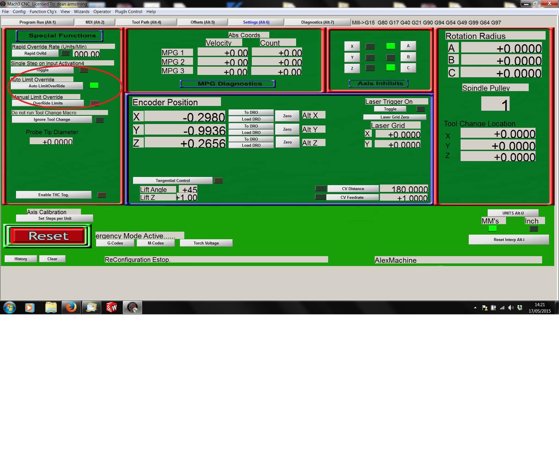

How have you got the limits working.? Are they just stopping the control/Mach3 and not physicly dropping anything out using relays etc.
If so then all you need to do is set Mach option for Auto limit override. Then when limit trips you just reset mach and Jog off the swithc.
You don't need to wire a Switch or use an input to override so not quite sure what your doing here.?
just stopping MACH 3 , no relays involved. where will i find auto lomit overide? spoke too soon , found it! cheers for that

Limit overide is here.
Attachment 15361
