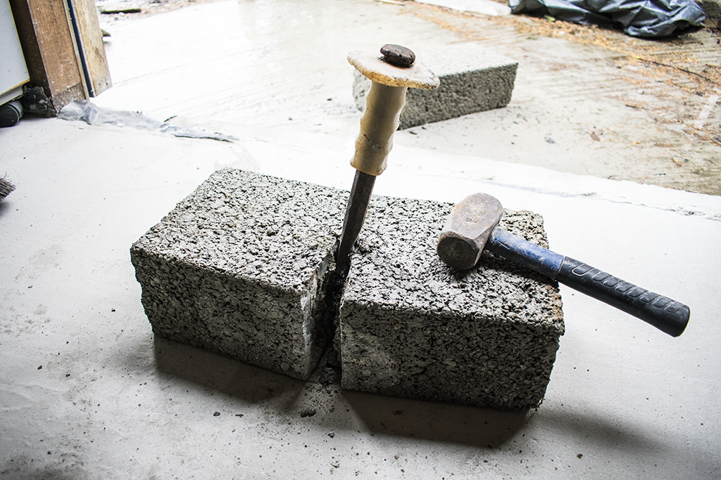

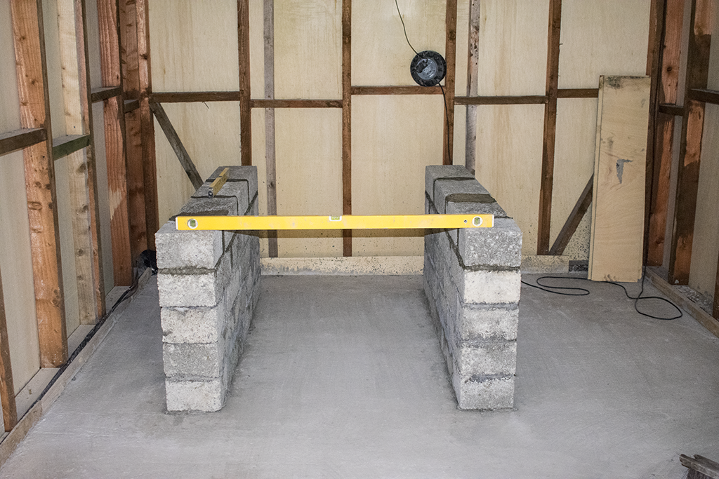

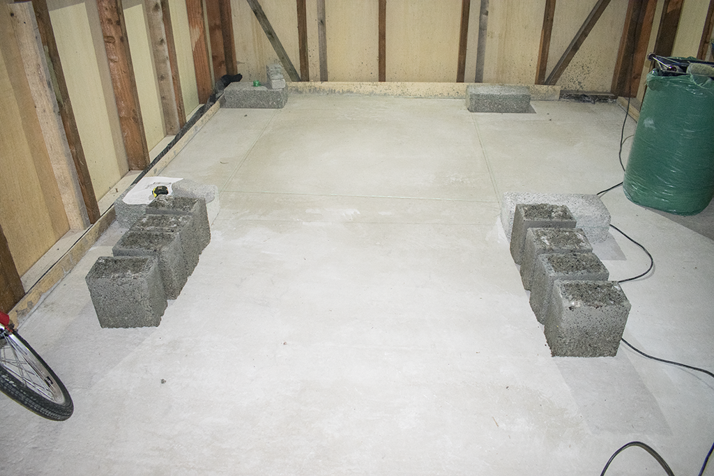

So a bit of progress. I slowly managed to get the walls built for this machine base. I ended up mixing small batches of my previous glass reinforced mortar mix, essentially just scaled up to larger batches and continued building one layer at a time, leaving a couple of hours between layers to allow mortar to go off slightly.
I ended up with 3.5 blocks long per layer and five layers high in total, to bring it roughly to waist level. I began by pre-cutting the granite/concrete blocks with a diamond disk on the 4" grinder and cut around the circumference in the centre, blocks were then easily separated into pretty clean halves through some brute force with a bolster and club hammer. It doesn't take a huge amount of effort in reality. I certainly won't win any awards for my block laying skills, but this mortar is more difficult to work with tidily than regular mortar due to the glass fibre input. It should be worth the effort I feel as it is tough stuff, so I don't see any issues with it. It should mostly be under compression here so hopefully shrinkage will be a non issue later. We'll see I suppose.
I tended to try and keep the mixture on the drier side. It is more difficult to manage that way but I feel this will be a good approach in terms of the overall strength. The water volumes are only a guideline really, in practice each batch will differ slightly so half is added, and gradually added there after to avoid making it too wet. With the super-plasticiser it's easy to overshoot the water addition and end up with a mix which has too much flowability.
Attachment 28379Attachment 28381Attachment 28380

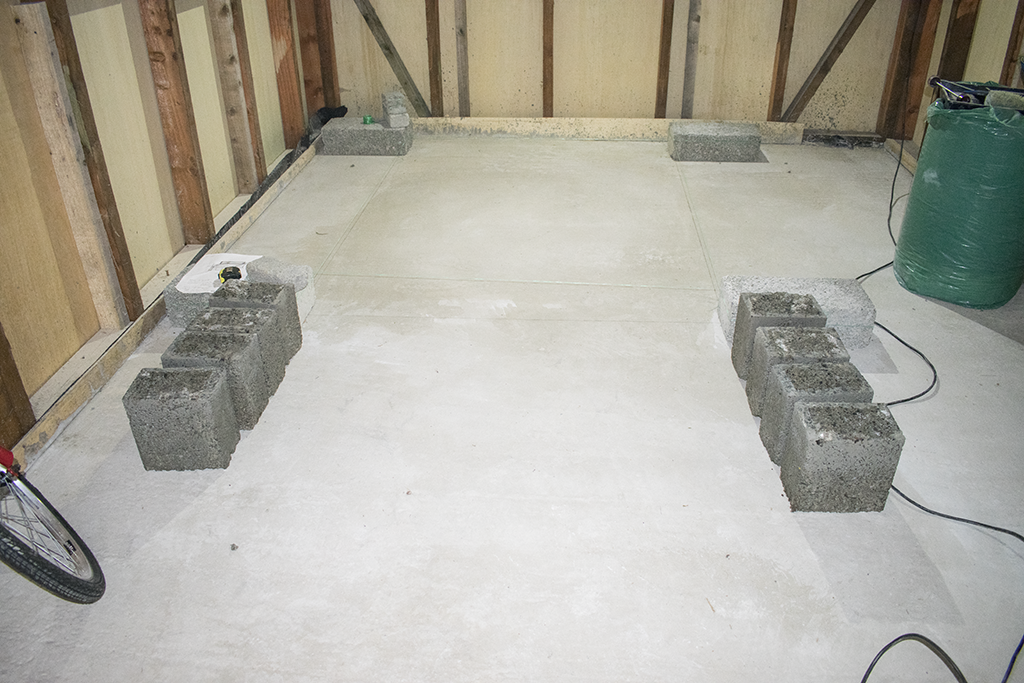

I ended up leaving some space around the perimeter in order to facilitate access and to allow sufficient room for any future enclosure.
Attachment 28383Attachment 28382

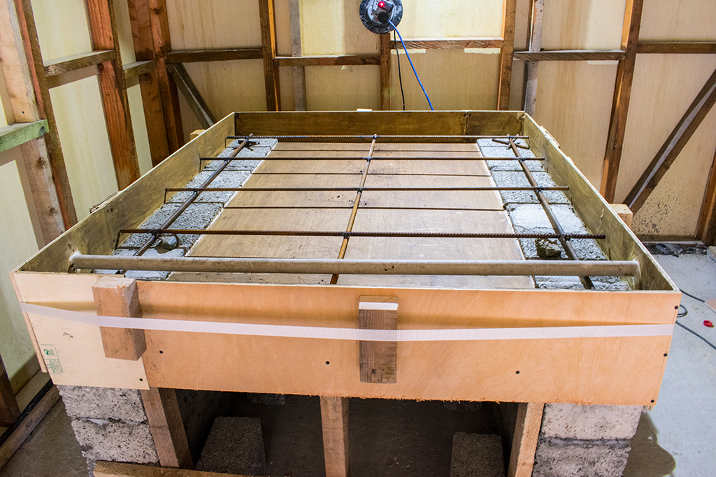

Next step in the table build was to build a mould for the concrete top which will be cast soon. I'm awaiting some more super plasticiser but that should be here soon. Calculating the approx weight it will be in the order of 400KG when cast, so my first concern was bracing the open section well.
Attachment 28433

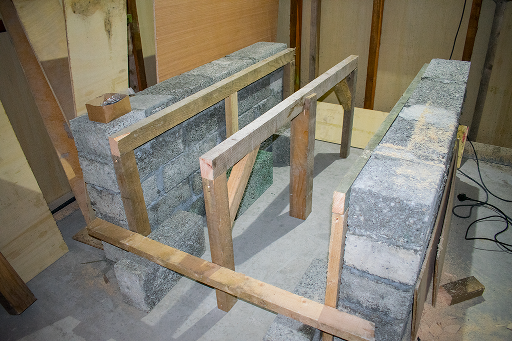

I chose to use studding which was left over from the building of the workshop in which this machine resides. I made up three sets of braces one for each side and a beefier version for the middle section. I chose to do this with the consideration that it needs to be knocked out from underneath later: I want it to be solid but also removable after the fact. There were some additional braces between these sections that isn't shown here.
On top of this some 11mm ply was set and sealed with silicone between joints. I chose to have the ply a little lower than flush with the walls, this might be difficult to see in the photographs but the idea is that the concrete pour will step down 10mm (vertical) over the end of the block walls before meeting the ply on the inner side of the blocks, creating a key of sorts. I thought this would add some additional strength.
Attachment 28434
Toward the front I added some 34mm (I think) plastic conduit so I can cleanly route a few wires from left to right (front left Y motor and home/limit switch). This is cut to be a tight push fit against the ply walls, which are fixed to the walls with masonry nails and a 600Kg ratchet strap is added for additional support from bowing. I also ran some lengths of string through the conduit/pipe and fed these through the ply walls at each end such that I can easily pull my wiring through post casting later.

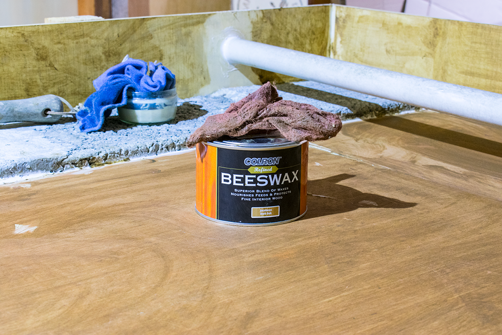

All the wooden surfaces that will be removed were given a couple of coats of beeswax to function as a release agent to aid removal post concrete pour.

Lastly, high tensile steel rebar was added in an overlapping cross pattern. I chose to tack weld these together with the ARC welder and prop them up towards centre (ish) with some rock that can stay in situ as I cast.
Attachment 28437
I've got a few little gaps here and there to fill with silicone but as soon as the plasticiser arrives I should be good to go on the casting of the top section. I roped my brother in law to help out, likely it will be Saturday next when I get started on that bit.
