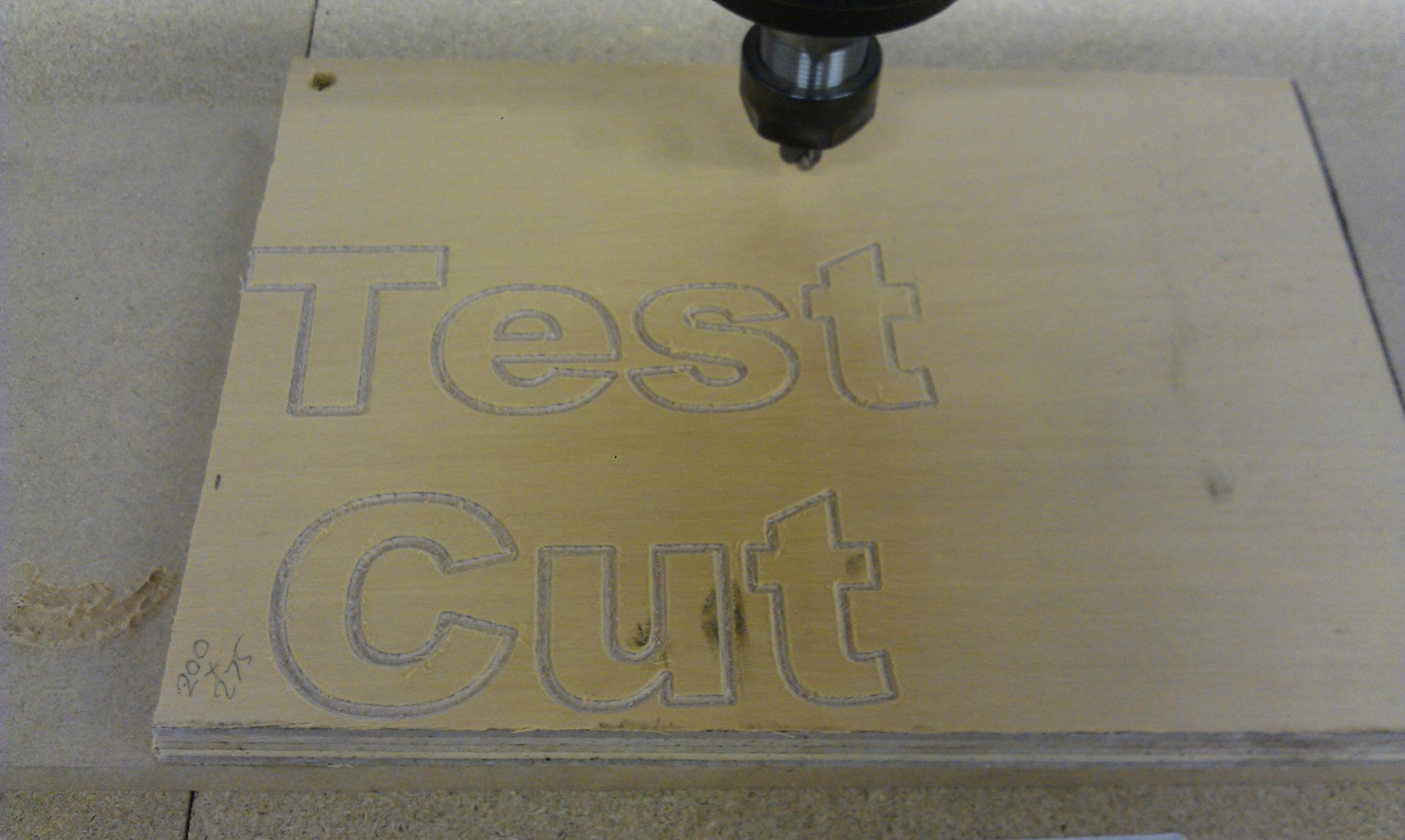

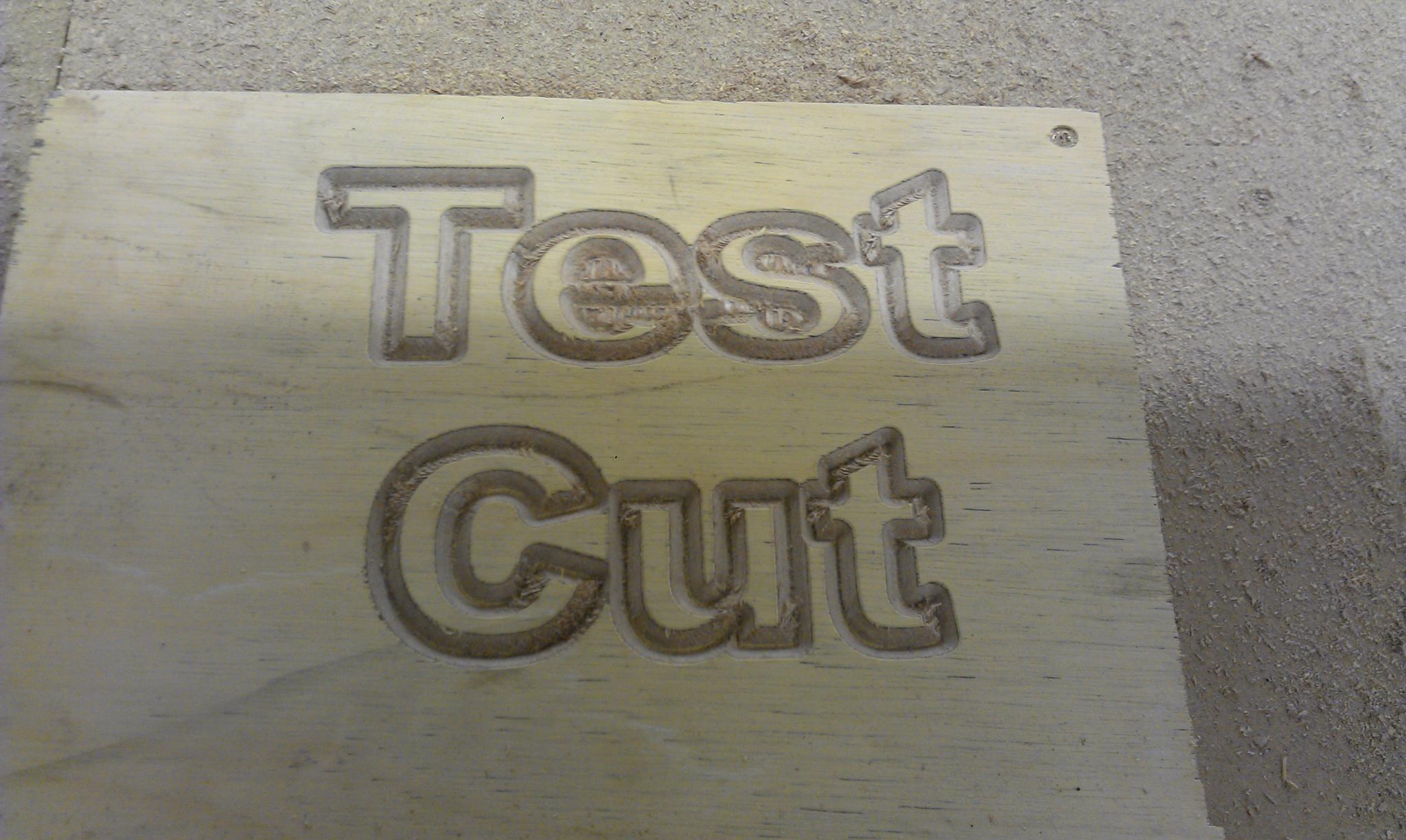

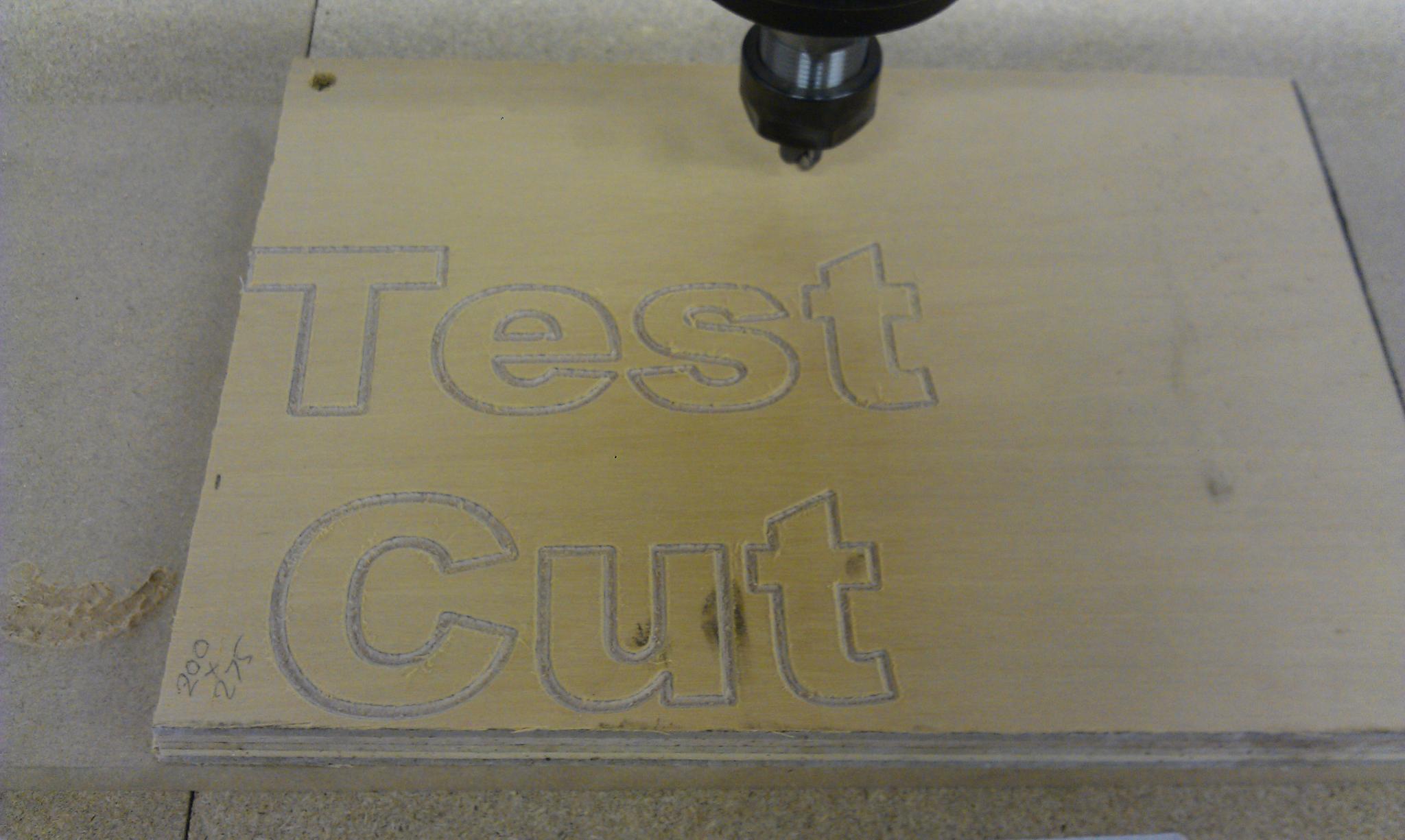

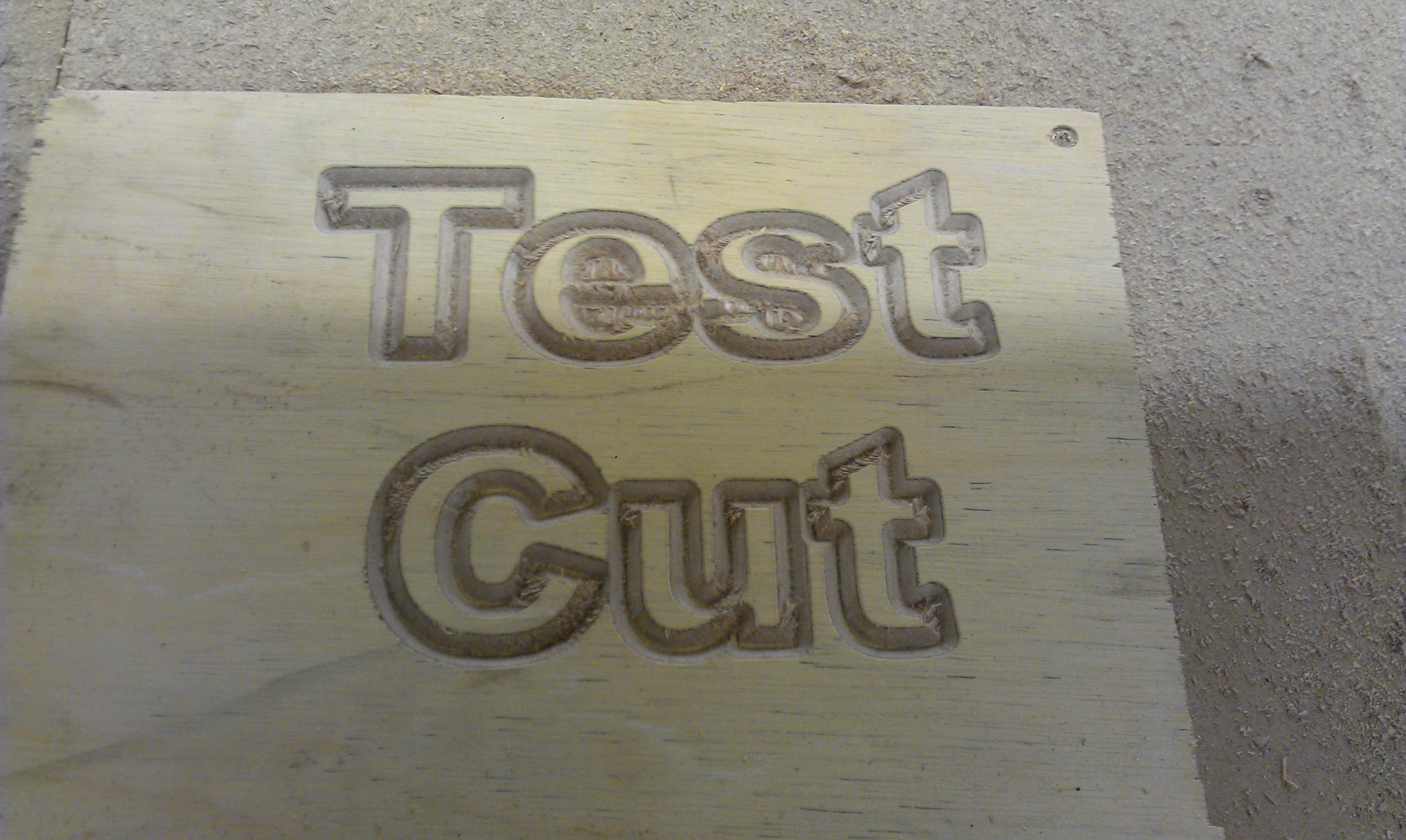

Right I have managed to sort out a problem with creating cutting files with the help of Adcnc, many thanks Adam, and have actually done two cuts tonight!!.
The material was standard 18mm thick plywood and a standard 12mm vee cut router bit, I didnt want to trash any good stuff to start with.
Attachment 4525Attachment 4524
Cut quality wasnt the best by any means but the machine functioned properly. First cut was at 2mm depth and 20mm/sec feed rate and the second one at 4mm depth and 40mm/s feed. I did attempt to video the second cut on my HTC Desire HD but the wife phoned and the end of cutting the first letter and knackered the video so I will try it again later in the week.

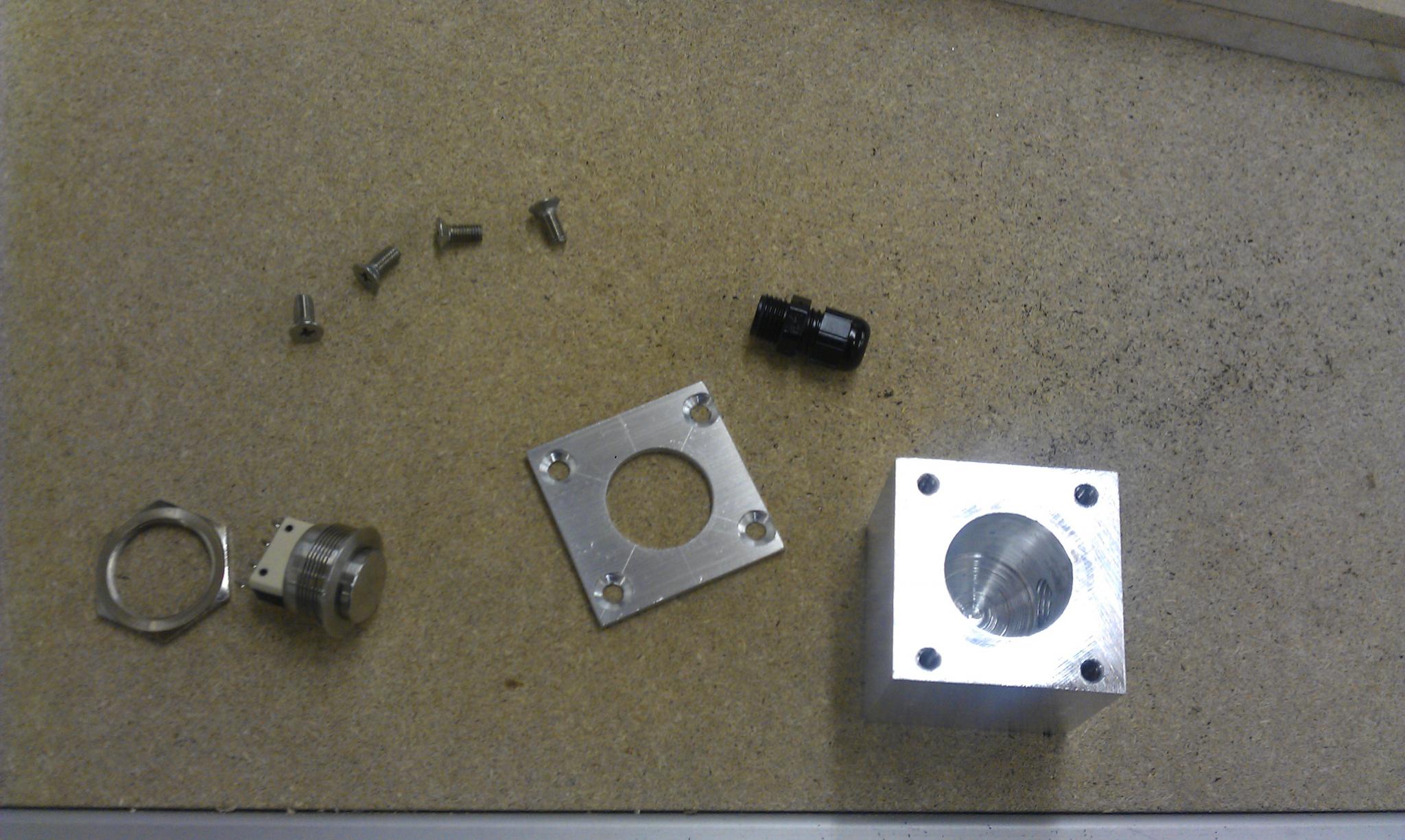

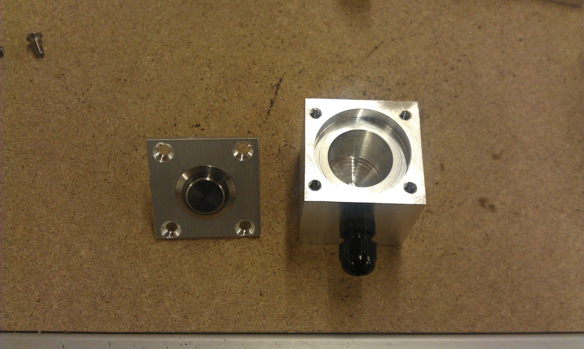

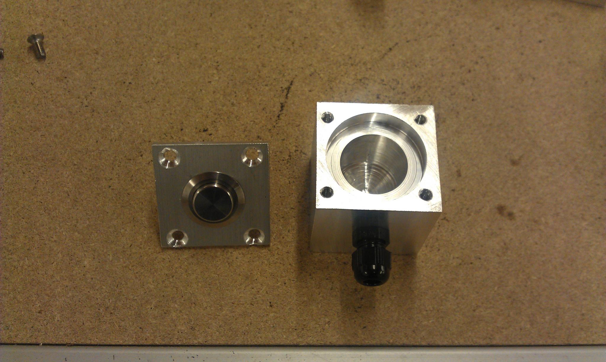

I have made up a tool height setter. Its a bit rough but I will make a better one when I get more time.
Attachment 4543
The basic parts. The centre of the top section was a bit off so doesnt look quite right.

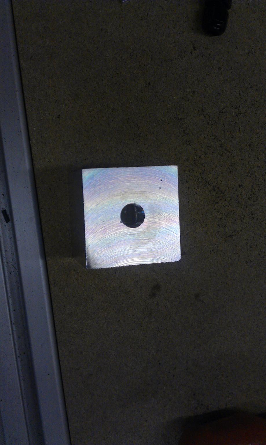

Attachment 4544
Hole drilled and tapped to PG7 to accept the cable gland.

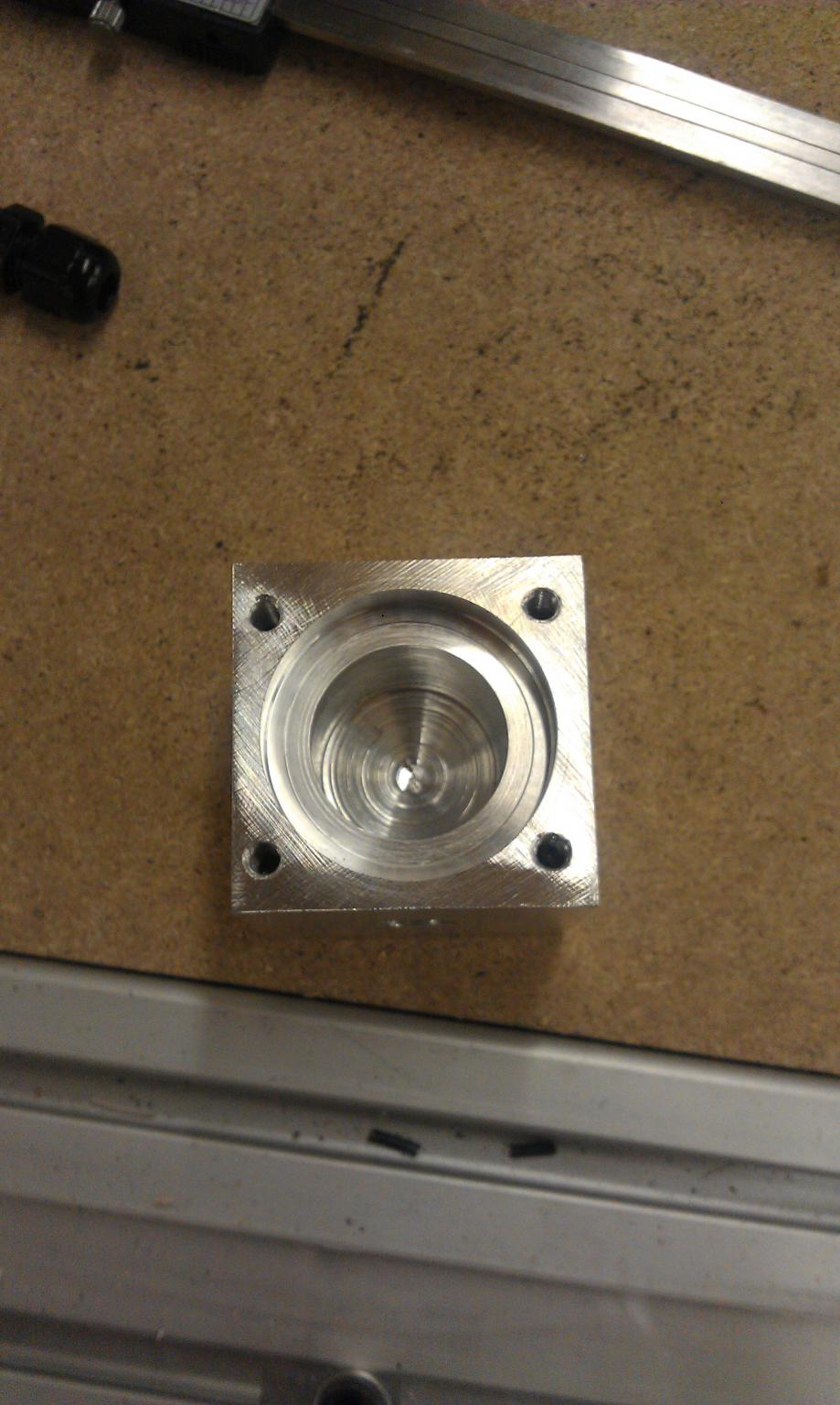

Attachment 4545
The block was cleaned up a bit on the lathe and the inner edge recessed to accept the switch locking nut.

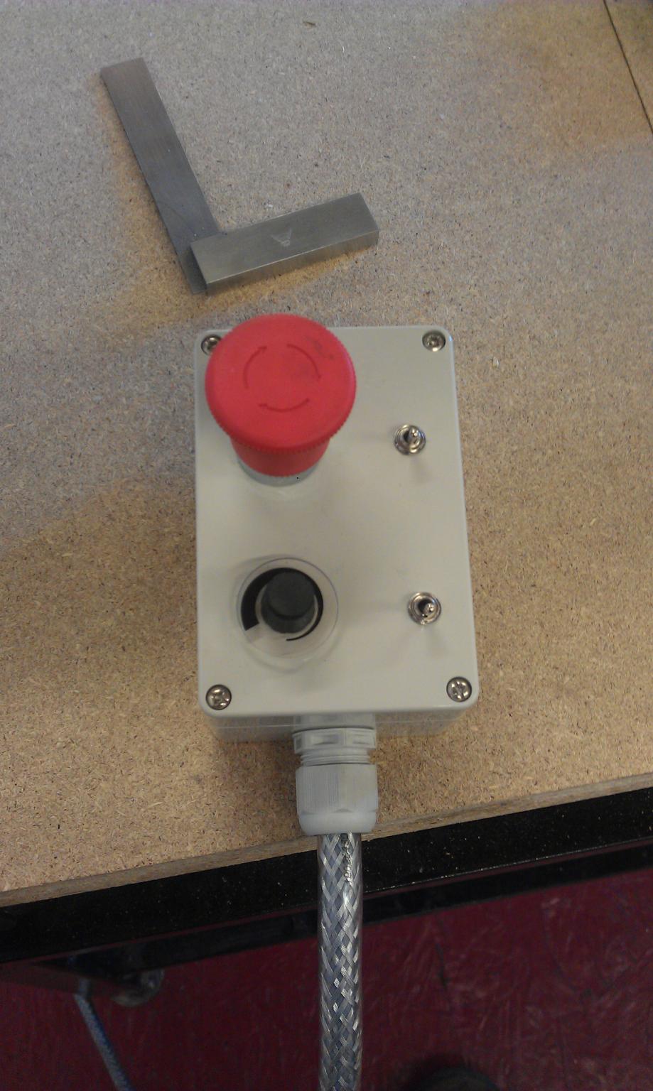

Attachment 4542
The finished parts before assembly.
I have also set up the block in USBCNC and calibrated and tested it. Working fine it is.
