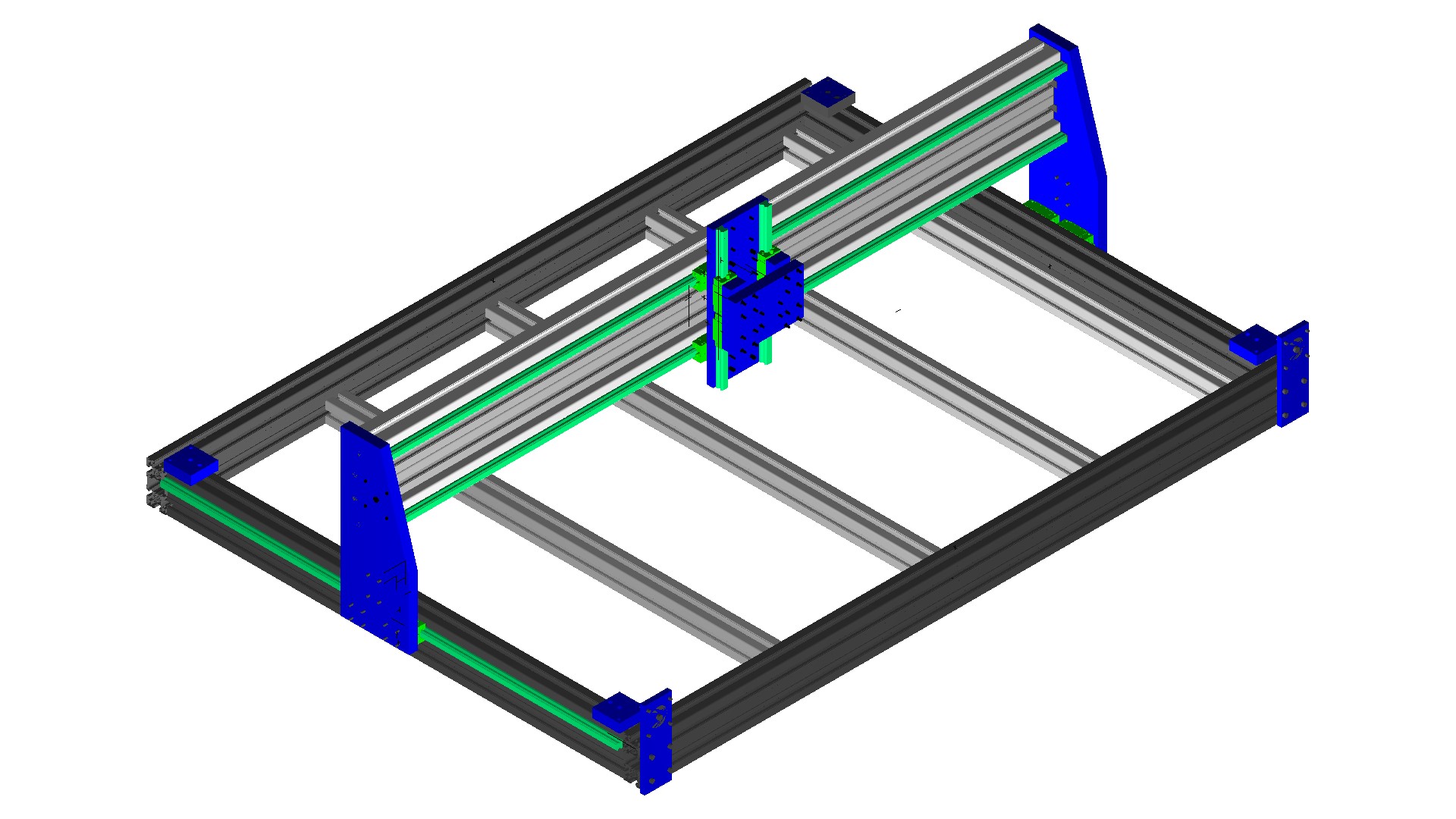

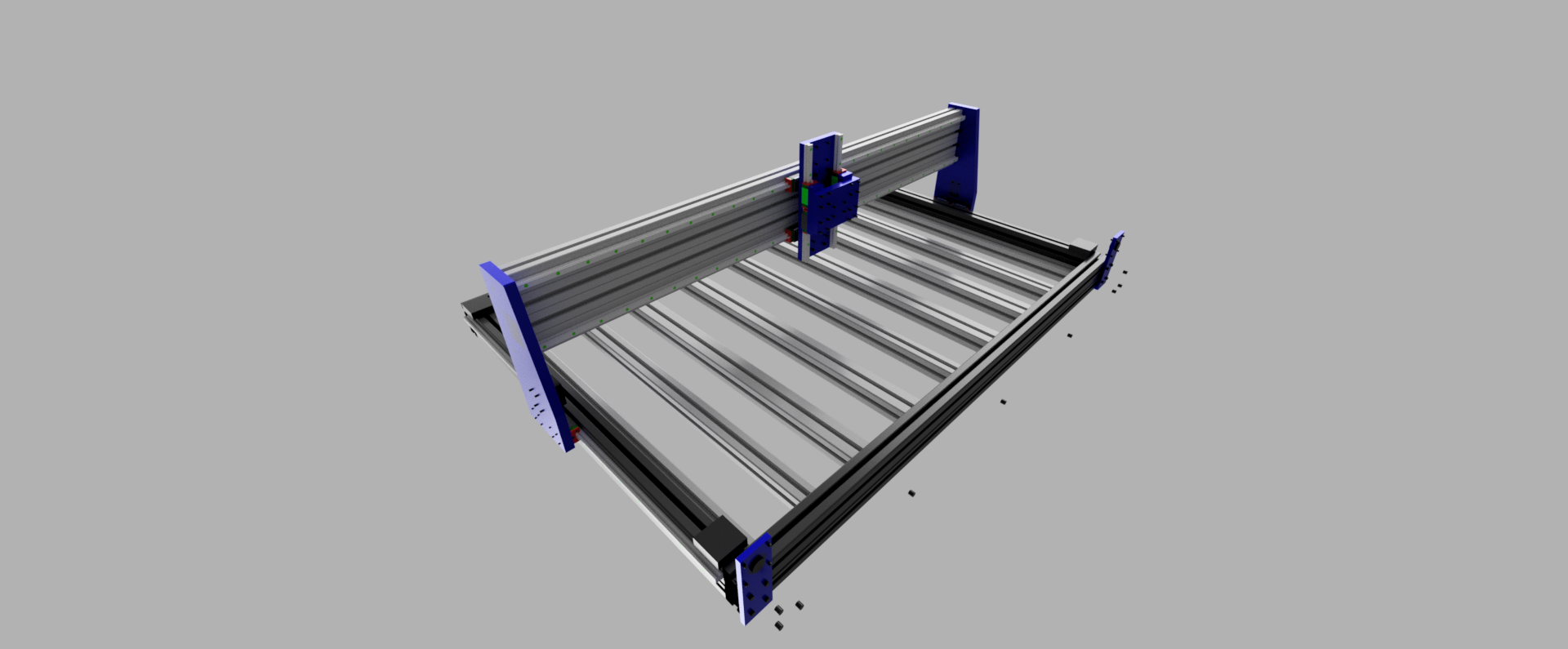

Good to see you're getting into the swing of things with fusion.
The adaptive machining is invaluable... yesterday I was whizzing around with a 10mm roughing cutter at 2000mm/min and 10mm Depth of Cut - unthinkable with conventional machining strategies and such a relatively flimsy machine.
I haven't looked at the CAM yet I wanted to get to about the same standard in Fusion as I was in Turbocad first so I'm comfortable editing models but interesting to read ;)
I think TBF on turbocad this is a properly set up render
Attachment 22891
I think it's pretty bloody good for a cad render.
e2a fusion can create some nice shots with little effort
Attachment 22892

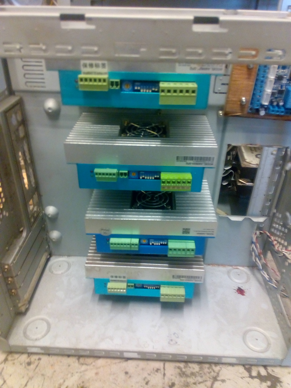

Had a bit of time today so thought I'd start on the wiring but realised I'm missing 2 of the power input connectors on the stepper drivers, does anyone know what they are called?
Not going to try and cram the transformer in after all would be tight in the case and I would worry about heat, got loads of space under the router more than enough for everything.

Started the wiring today ;) Only going to wire up 2 of the stall protections for now (For the dual ballscrew) once it works we'll add in the other 2.

4 Attachment(s)
Re: New build with recycled parts on a ridiculous budget 120cm*60cm work area
Little bit more done today, limit switches are fitted directly into the aluminium extrusion
Attachment 23122 You can just see the red microswitch at the end of the energy chain a Hiwin carriage triggers it, there's identical switch on the other side in same position.
Attachment 23123 And just under the bolt in the energy is the other switch only one bolt at moment need to find a 5mm piece of aluminium so I can fit the 2nd bolt but the edge is tight against the Hiwin rail so it's solid.
I drilled them tapped the holes, very happy how they came out. There is no Z axis switch yet will rebuild the Z axis so they will be added then.
Power supply is ready to be hooked up to the AM882's
Attachment 23124
AM882's now have all the stall protection wired in
Attachment 23125
The PC to control this now has windows 7 and Fusion 360 on it, and a parallel pci card installed. Wiring is in the energy chain just need to connect everything up, earth the spindle and connect solder that up and we can get it running.
Need to get some wiring for microswitch just going to use cheap 2 core a junction box to split the power from the home built PSU to 4 steppers and some connector plugs will pick up on way to work tomorrow.
How should I connect the CY cable to the nema cable, soldering or connectors?
