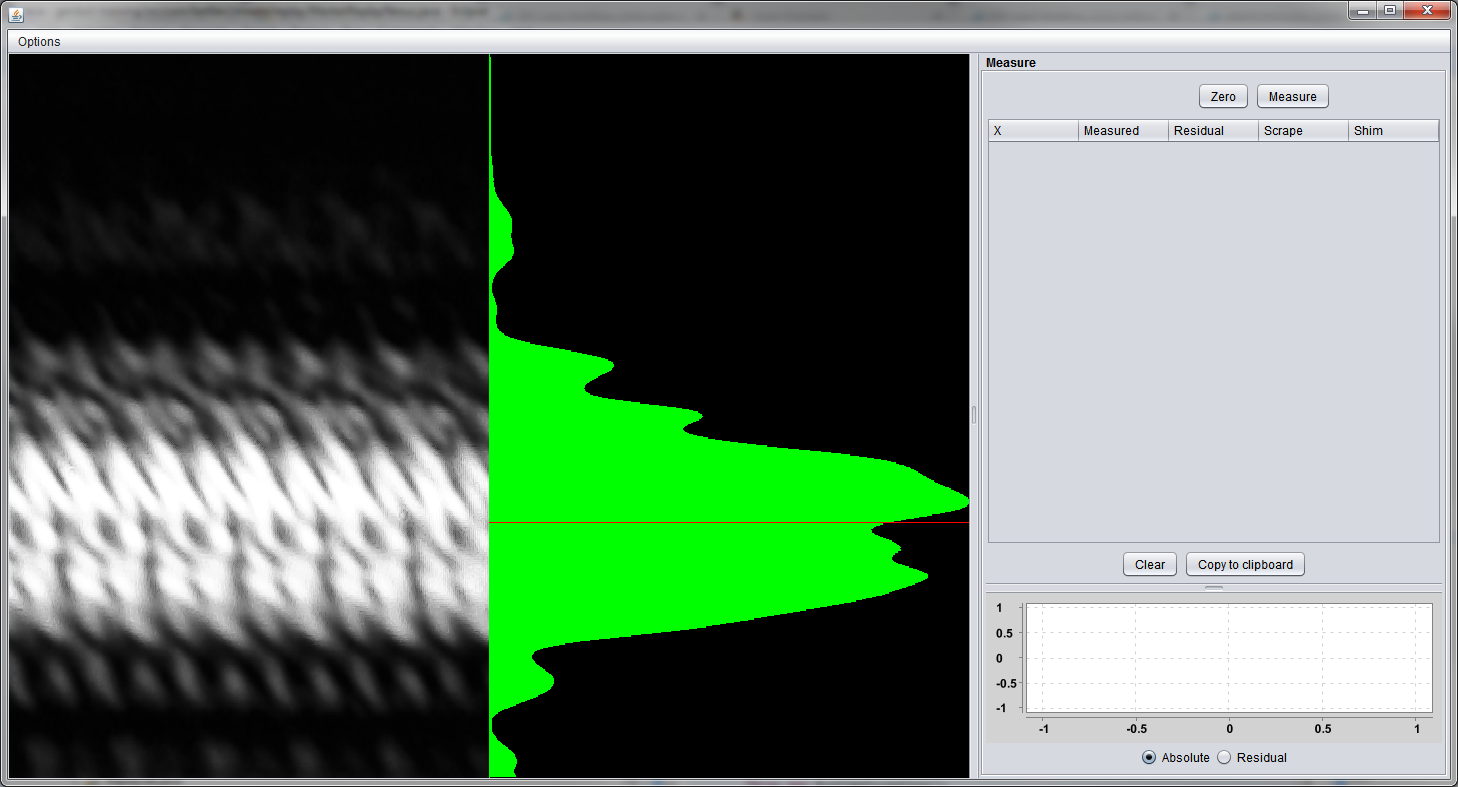

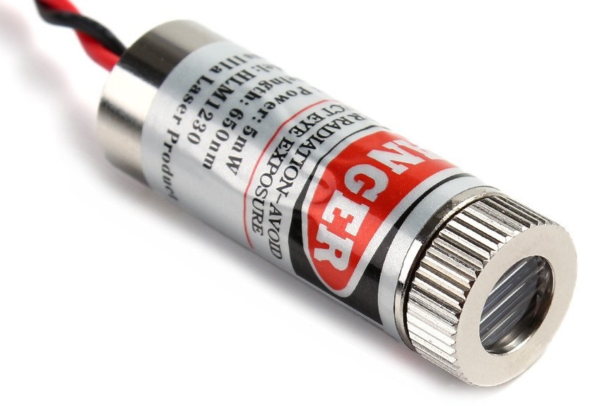

Today i got to some measuring again.
About my setup.
I have a cheap bosch crosshair laser which I now know is not up to this task.
The webcam is a 1920x1080 6.2 ish by 3mm sensor... so +/- 3um.
Yes i have m12 adjustable bolts in the feet.
10 deg of turning on the feet is clearly visible in the software.
About the units i am sure it is still on defaults so 1um, need to check.
Yes my measurements in the earlier post are off by factor 3.
Not yet that important since i was testing the setup and finding out the sop.
### about The laser.
The selflevelling seems to be spot on.
The optics are not.
I found out today.
Moving towards and from the laser the light is straight (light travels in a straight line) moving along the projected line gives false readings. +/- 60 um / 80 cm at about 3meters distance so only a few degrees
Now i know this, it is okay the way it is.
Just make sure you move in a straight line from and to the lightsource.
I have to put the laser a bit further away to get into the better sensitivity range of the camera. It all helps.
Actionplan:
* Input the correct units in the software
* Use a tripod laserplatform
* Put the tabel diagonals in plum.
* Check the 2 long axis.
* Check the short axis for horizontal variations.
* Check the short axis at lowest point and highest point to check top and bottom rail for allignment.
I have not thought of a way to check the spindle for misalignment by webcam/laser without trusting the optics.
But maybe a conventional plumbline and a light source (is that the right English word?) can do the job.
Grtz Bert.
Re: DIY Laser levelling using webcam and laser level
Really useful details, thanks Bert.
When you see the error from moving along the projected line, is it random noise or is it like the line is bent up or down in the middle, like your gantry measurement ?
I think I have seen the line bent like this. I did a little experiment with a dot laser and a glass cylinder (wine glass stem). When the laser passes through the cylinder at 90 degrees you get a straight line projected, when you angle the glass a lot you get a visibly bent line either up or down depending which way to hold the angle.
Maybe this is a common problem with the line optics, and maybe we could calibrate it out by taking two sets of measurements along a straight edge with the laser flipped 180 axially for each set. Will have to think on this, any thoughts welcome...
Although it would not be easy to flip your laser as it is on a pendulum.
devmonkey
Hi devmonkey,
Yes it was like you described with the laser vs wineglass stem.
The noise was within 5 orso units.
when measure is pushed several times in 60 sec... maybe +/- 1 or 2 units.
Grtz Bert.

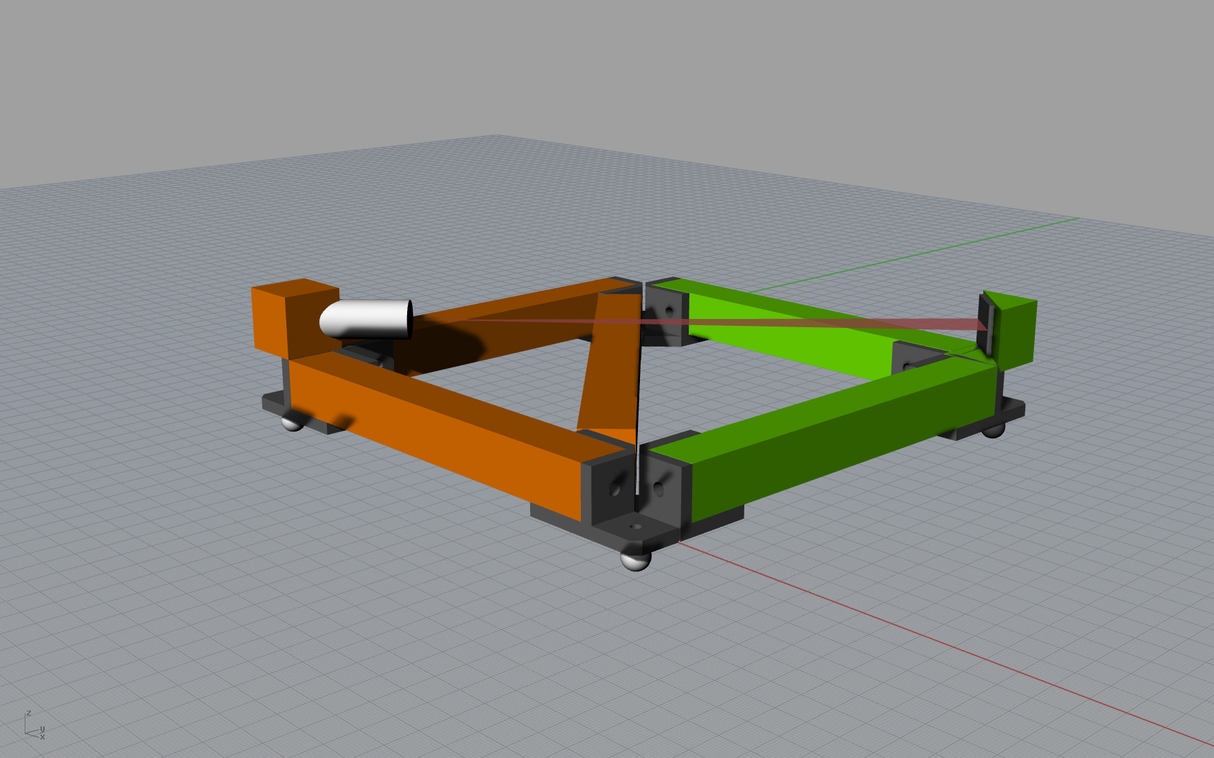

3 Attachment(s)
Hi Bert and everyone,
Here are some renderings of the laser-plano-meter I've been trying to describe.
Attachment 27468 Attachment 27469
It consists of a square device sat on 4 spherical feet at the corners. 3 corners of the square are rigidly connected to form a triangle (orange part) with laser attached. The forth corner is attached by the green arms to the triangle with flexures that allow it to pivot up and down with respect to the triangular plane, effectively the square is allowed to fold along its diagonal. The camera sensor is attached to the forth corner.
Attachment 27470
The laser will project a line on the sensor, the height of this line is related to the angle of the fold. The goal is to find the sensor reading where ALL 4 feet are in the same plane thereby providing a method of measuring the error of any surface from a plane. We will call this sensor reading ZERO.
To find ZERO we place the device on any surface, doesn't need to be a plane. We then take the laser height measurement H1 in this position. Now rotate the device 90 degrees about the Z axis and replace it on to the same surface so that each foot is in the same place as its predecessor was in the first position. Now measure laser height H2.
With both H1 and H2 we can calibrate the device. ZERO is the mid point between H1 and H2.
Now place the device on the surface to be measured, e.g. the pair of X rail beds of the CNC frame. The deviation from ZERO will tell you how much to adjust the frame under the 4th foot in order to bring the surface into plane.
An alternative way to think of it is if you just placed the non-zero'd device on the machine frame and take the laser height measurement, then rotate 90 degrees and repeat, if the heights are different you need to adjust the frame. Make the adjustment, rotate the device back to its original position and repeat until the height readings match.
EDIT
Should be noted that this device could be constructed with a DTI instead of a laser as per a normal repeat-o-meter. In this case you would have just the orange triangle and replace the laser with a long arm with the DTI on the end. The problem of course would be that the error due to the long arm flexing due to its own weight and the pressure from the DTI spring would far exceed the resolution of the DTI. This is not a problem with the laser beam as it wont bend no matter how long it is.
Cheers, Joe

Yes, that really helped.
This is a clever design.
I will try this later. I think a simple laserpointer will do i guess in this scenario.
Thnx Grtz Bert.

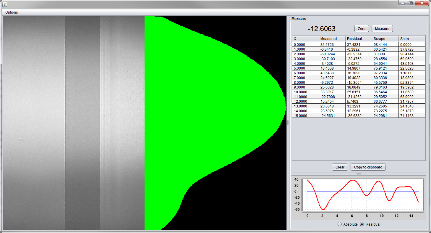

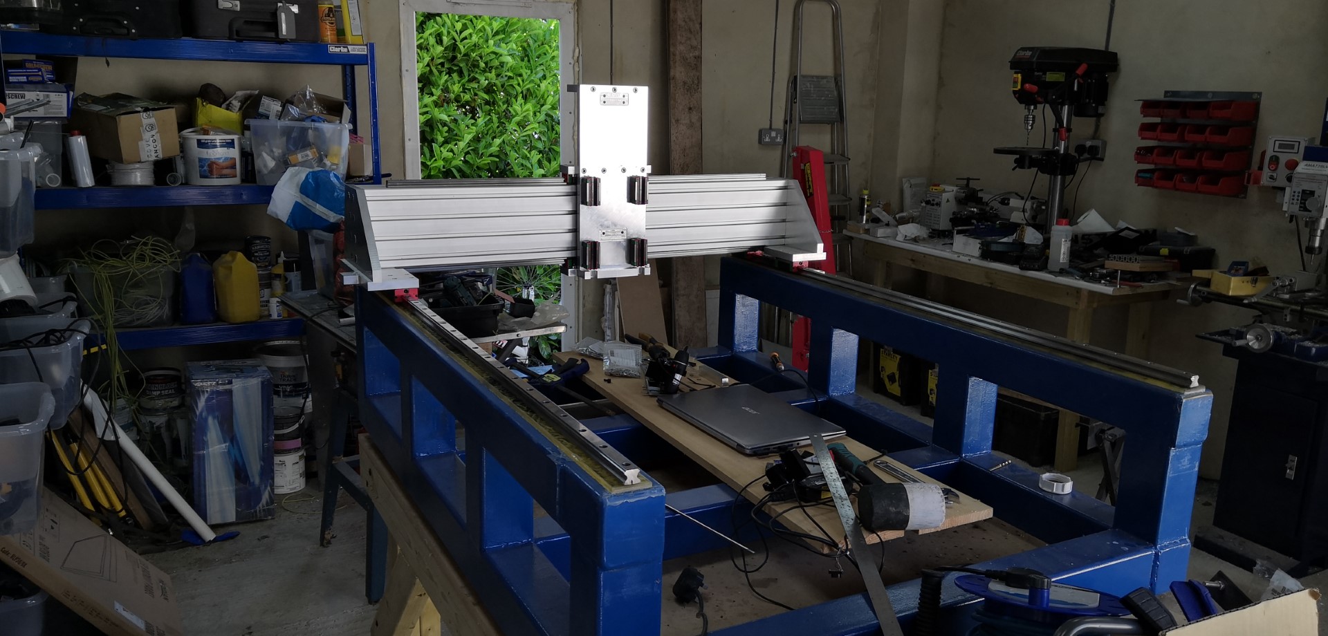

Afternoon all.
I've finally got back to my machine project. I gave up with trying to create a planar surface in one shot and as the weather had warmed up I poured epoxy, this looks like it has worked well and made a very close surface for final levelling using the laser and shimming if required.
Anyway the purpose of this post is to describe a new app I put together today for laying the master rail straight. I decided it would be easier to use a taut wire rather than the laser for this and a cheap USB microscope.
So armed with some 0.28mm black fishing line I found in the garage and a club hammer I tensioned a wire parallel to where the master rail will sit. I used some white insulation tape on the machine frame below the wire to provide good contrast for the software and the wire runs over a couple of bolts that run through angle iron supports clamped to the ends of the machine frame. The wire is anchored at one end and the club hammer suspended from the other, the fishing line stretches out quite a bit and you can see the nylon flowing under the microscope, I waited for it to stop flowing before doing anything else.
The microscope is attached to a hiwin carriage and the new app accurately locates the wire allowing you to zero the tool then reports the error as you slide the carriage back and forth. A 3D printed clamp allows the microscope to the rigidly attached to the magnetic base.
Nothing new in the process that other people have performed other than the app that lets you achieve excellent accuracy with little effort. The resolution is roughly 3um per pixel repeatable down to less than 1um (relative to the straightness of the taut wire obviously).
The wire locating algo is quite different from the laser gausian model and seems extremely robust. For those interested it locates the two edges of the wire using a median gradient threshold down each column of pixels, regresses lines down these edges and auto tunes the threshold until it has exactly two lines that completely cross the image from left->right. It then bisects the two edge lines to locate the wire centre. This removes any error from tapering of the wire due to stretching under tension. You hit zero then the app will will show you the relative error to this point as you move the rail and/or carriage about.
Anyway I captured this video showing the app working on the machine frame:
https://www.youtube.com/watch?v=us2mTcvHHOw
I will use this tool to set the master rail over the next day or so.
Cheers, Joe

Hi Kit,
Yes they do sell steel leader, music wire is also an option. These axis are only 1300mm long so normal lightweight fishing line seems to be perfect, very uniform and black meaning it is easy to resolve in the software. It only flows for around 30s after tension is applied and under the microscope you can see when it stops. The length I put on the machine yesterday hasn't stretched at all over night.
Some things I noticed that maybe useful:
1. The microscope (£20) must be focused once at the beginning and then not touched. Turning the focus winder shifts the optical axis which would throw off any measurement. The focus winder is solid enough not to move on its own.
2. The microscope cable must be tied to the carriage to avoid any force being applied to the back of the scope pushing it off axis.
3. M6 bolts make perfect wire guides for 0.28mm wire, the wire locks into the V of the thread.
The depth of field (variation in objective distance where object remains in focus) of the microscope is probably <1mm so you need to get the wire guides to the same height so the wire is not sloped, I set mine level with the top of the epoxy bed using a ruler. The wire is then suspended a few mm outside the epoxy bed.
If there is enough interest I will share the app, needs a bit of a cleanup first as it was a quick hack.
Cheers, Joe
Hi Joe
You just made my day.
Gee using a microscope with your software is a huge step, 3 um = 0.00011811 about a ten thousandth of an inch imperial. accuracy.
Using wire or fishing line allows the measured line to be accurately positioned. By anchoring each end of the wire to the machine frame precisely you can place the linear rail exactly where you want it. A lot easier than pointing a laser from one end. It also allows you to easily place two rails parallel to each other, by simply measuring the space between the ends.
I would really like to try your new software. In fact I am quite excited.
While tweaking it You mentioned that you used black fishing line piano wire is bright and I guess would require a dark background instead of the light background you used to enhance the contrast of the line you used in your experiments.
Maybe the ability to invert the pixel colour in the contrast discrimination code would be a useful addition.

Quick update,
I've managed to set the master rail reasonably straight with the setup. It is within +/-5um along the entire length. It was not easy for a few reasons I will outline:
1. The microscope axis is offset in both X+Y from the centre of the carriage, I did this because obviously it has to be offset in Y as you can't 'see through' the carriage but also in X since I couldn't fit the microscope next to the carriage and remain over the frame. This arrangement is highly non-optimal as you are measuring an offset AND an angle. Eventually you get used to how much adjustment to make, however there must be a better arrangement that avoids this coupling.
2. Twisting the carriage hard on the rail can induce a few um of error.
3. Pressing hard on the machine frame and deflect the entire frame a few um.
The conclusion is that with a machine constructed like mine from 80x80x3 box section over a long dimension of 1300mm aligning to an accuracy of +/-5um is probably the absolute limit and it isn't sensible to try to achieve any greater. Also the frame is unlikely to hold this in actual use due to the deflection under force measured. Still it is good to be able to measure these things to get an idea where the limits are.
So in conclusion I've managed to align to ~1/2 a thou with a setup that cost a few quid. It is all entirely dependent on the taut wire actually being straight, however if we assume it is then this setup is equivalent to a DIN 874/00 spec straight edge, one of those 1500mm long will cost £2k then you still have to actually align the rail with it.

2 Attachment(s)
Attachment 28205 Attachment 28206
Will use gantry to space slave rail correctly, progress on this particular machine will continue in my build thread:
