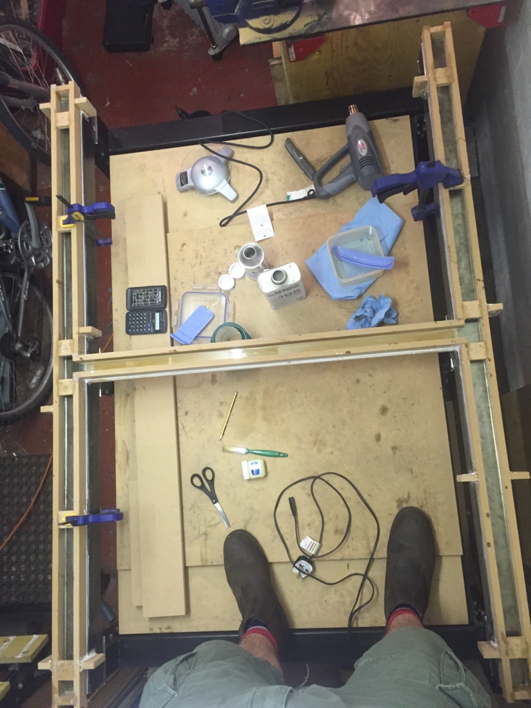

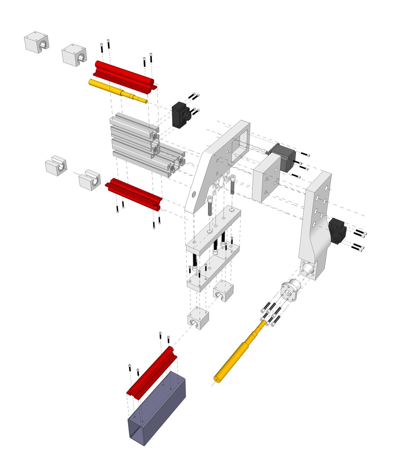

Setting up these rails is insanely hard work!! I wish I had a straight edge the length of my rails... I managed to get one pretty much bang on but the more cap screws I add, the harder it is to keep the rail exactly straight... Time to take a break! https://vimeo.com/173678941
Evening guys - I have just finished mounting my rails - whoop - and have to say that is one long and screwy task!! I have attached a video of the various sounds of the bearings moving up and down depending on what they are mounted to as the hollow shs makes them sound much more noisy than on the aluminium. At least I hope that's what it is?! I've mounted these things pretty straight, parallel and level!https://vimeo.com/180356379
Joe Stop panicking they sound fine see what they are like when you put the gantry on:onthego:
Thanks Clive! It's just taken such a bloody long time I don't want to be doing it again! They sound about the same with the gantry on although the next task is to get that all squared up.... I'm sure it's fine - when I give the gantry a shove it keeps going for a while before it stops which I take to be a good sign.
These carriages also seem slightly rough when moving unloaded - try moving them with your body weight on them. Under load they become much smoother.
Perfectly normal Joe that's the preload your hearing/feeling. When greased and under load they will sound different again and work great.

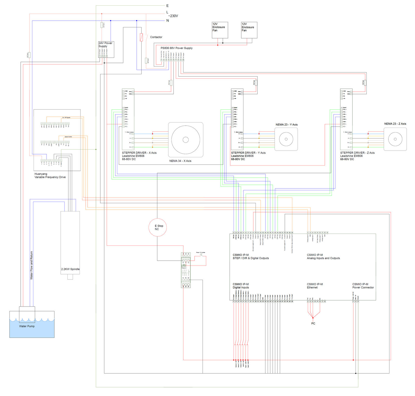

Attached is my first crack at a circuit diagram for the machine. I am not sure that I have got the pilz right and I think the estop circuit in general could do with some work as the spindle is not currently part of it. Do I connect to the same contractor I have for the stepper drive power supplies or another? I have a couple of relays left on the pilz X1 if I need them... Also, I'm sure I have read that you shouldn't just cut power to the VFD...?
I'll continue to work on it (and research) but thought I'd put it up for your amusement! As always any comment gratefully received :hopelessness:
(Just realised that the resolution reduces when you upload. I will try and sort out the text sizes as they are pretty fuzzy in places)
Joe The text is a bit small to read. You are showing a 68V power supply does this also provide the 12V to the fans
Sorry about the text. It looked OK until I uploaded it. When I get a minute I'll pump it up. Yes the 68v leadshine power supply powers the fans via 12v auxiliary: http://www.leadshine.com/productdeta...model=PS806-12
Not very easy to read labels but I suspect your using the HV option on controller to turn on contactor.?
Don't use it my self because it's pain in arse.? It will drop the power to drives every time you put mach into reset. This means because the motors jump when powering drives you'll have to home the machine everytime mach goes into reset. Many times that will be ok but there are others when you don't want that. Like when making simple setting change etc.
I'd just have the E-stop safety relay switch contactor on.
Couple of small things I see.
#1 Fuse the Water pump.
#2 Run water pump 0V thru VFD relay so only comes on when spindle running.
Regards VFD power then wouldn't get too OCD about it.! The controller will Stop it spinning when see's E-stop so could leave it out of the E-stop system if you like.
But if you do want to Kill it then use Timer relay which is set to drop power after spindle stops spinning. Personaly I wouldn't bother because the few times you will Kill power while spindle is spinning won't hurt the VFD. Plus the VFD takes several sec's to power down anyway because of Caps. By which time spindle will have stopped.! . . . . . Anyway If Cutter is embedded in your hand you won't really care because you'll passout before VFD powers down.:hysterical:
