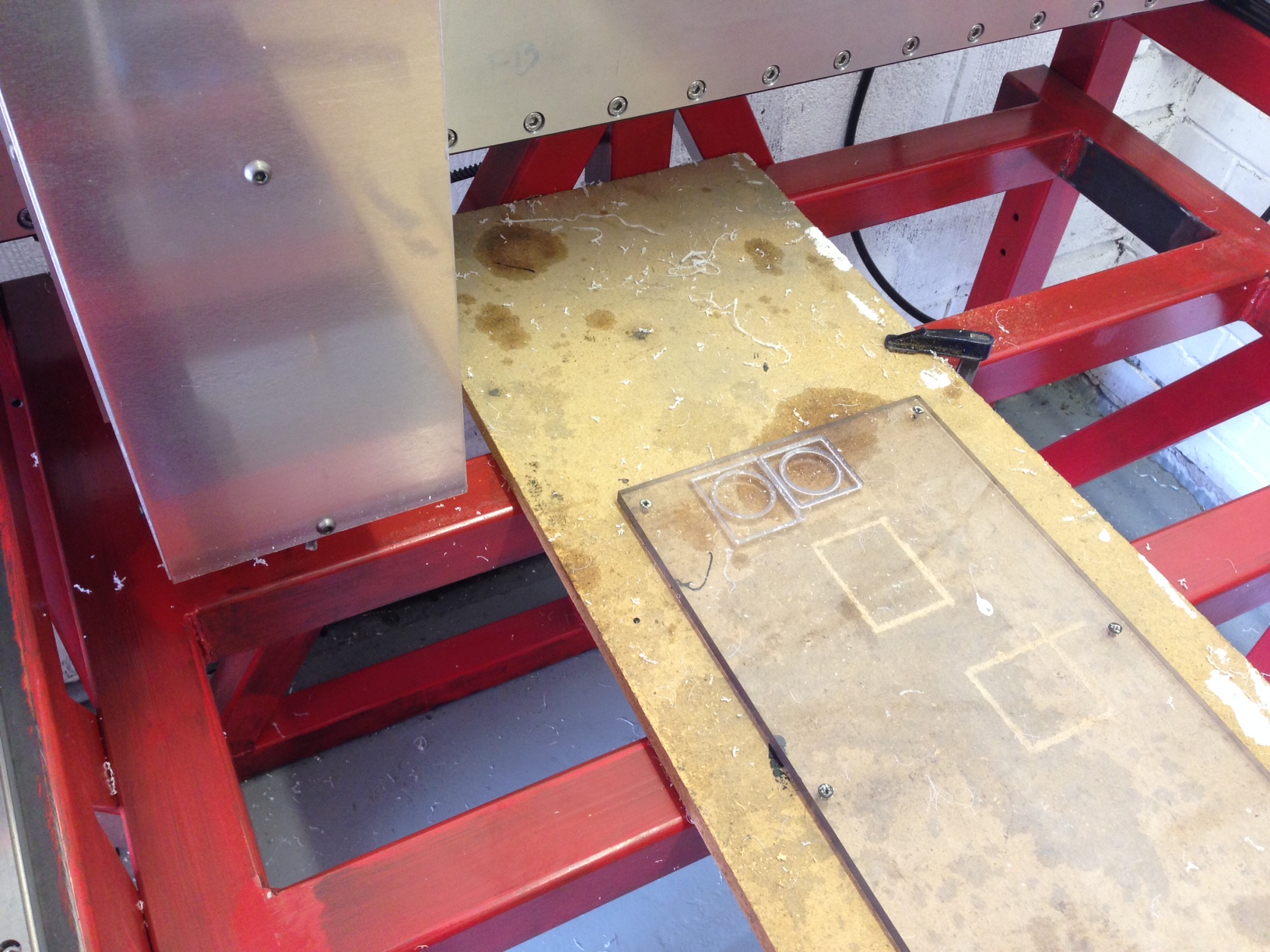

Ok so thats all three axis working now great stuff! very happy with that, just need to get the limit and home switches wired in and the spindle housing made up and then I think its on to the bed and some fine tuning of the machine.
I am thinking about getting a full sheet of material for the base of the bed and then assembling aluminium strips on top to form t slots with a wall around the outside to contain some material however it won't be very high because we still need to be able to move the bed in the future so maybe 150mm hopefully it should contain a small percentage of the shrapnel I fully expect to end up on the workshop floor!
what thickness should the base piece be.... or should I just mount them direct to the top of the steel bed.
Put some Thick Plastic sheet round the sides so then you can raise or lower and still contain everything. Thick along lines of bellows but all around edges.
How to have Bed.? . . .Well there's million dollar Question.!! . . . . . . So many options and not one will suit everything you do on the machine.?
What I mean by this is that you will always find that some Job won't suit how you have the Bed.?
My bed is Aluminum pieces arranged to make a T-slot but I find most the time it's covered with a Spoil board that I screw into rather than using the T-slots.?
Reason being is that 95% of my work is milling aluminium that I drill thru, Cut thru or Pocket thru which makes a bloody mess of the shiny aluminium bed.
The work piece always falls so that you can't reach the bloody T-slots or I need scaffolding to reach them for secure clamping. 90% of the time most jobs have one or two holes and if not then usually no problem making some around waste edges so screwing down is easy and quick.
On the machine's I build I find the best setup is Solid stable base board, Aluminium or Palstic if using coolant with a Matrix of tapped holes Drilled or in router case Marine Plywood with Laminate face and threaded inserts. Then a sacrificle surface on the top with Same Matrix of holes drilled for Access for clamping. The top board can be screwed into if needed, which is often the case. It can cut when profiling, pocketing or drilling and be re-surfaced when becomes too chopped up.
It can be removed easily when more accurate work is required like engraving, which often needs a very flat surface and work sticking down.
So my Vote is either Aluminium plate with matrix of holes or Marine ply with laminate surface. Both using surface board.!

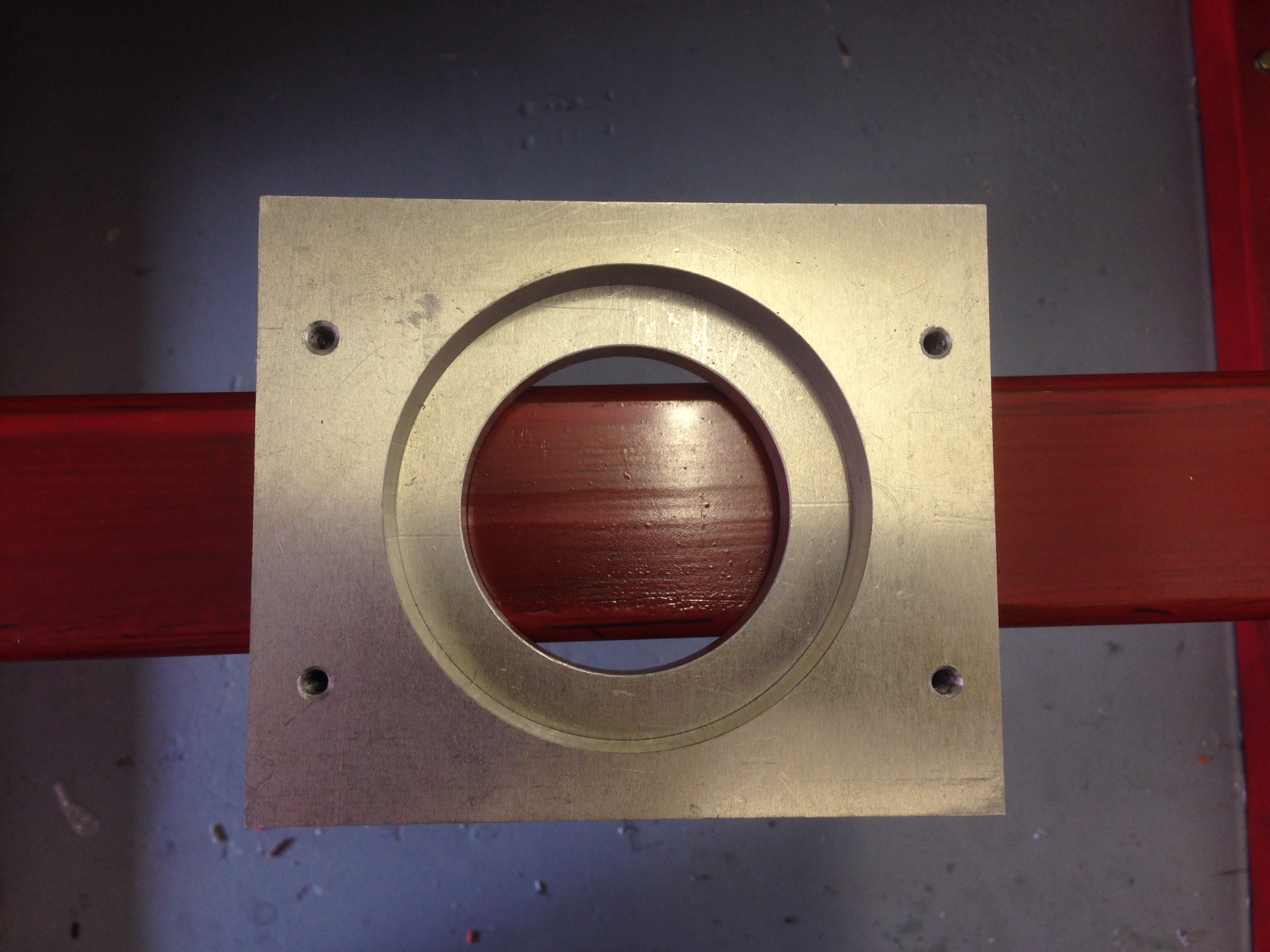

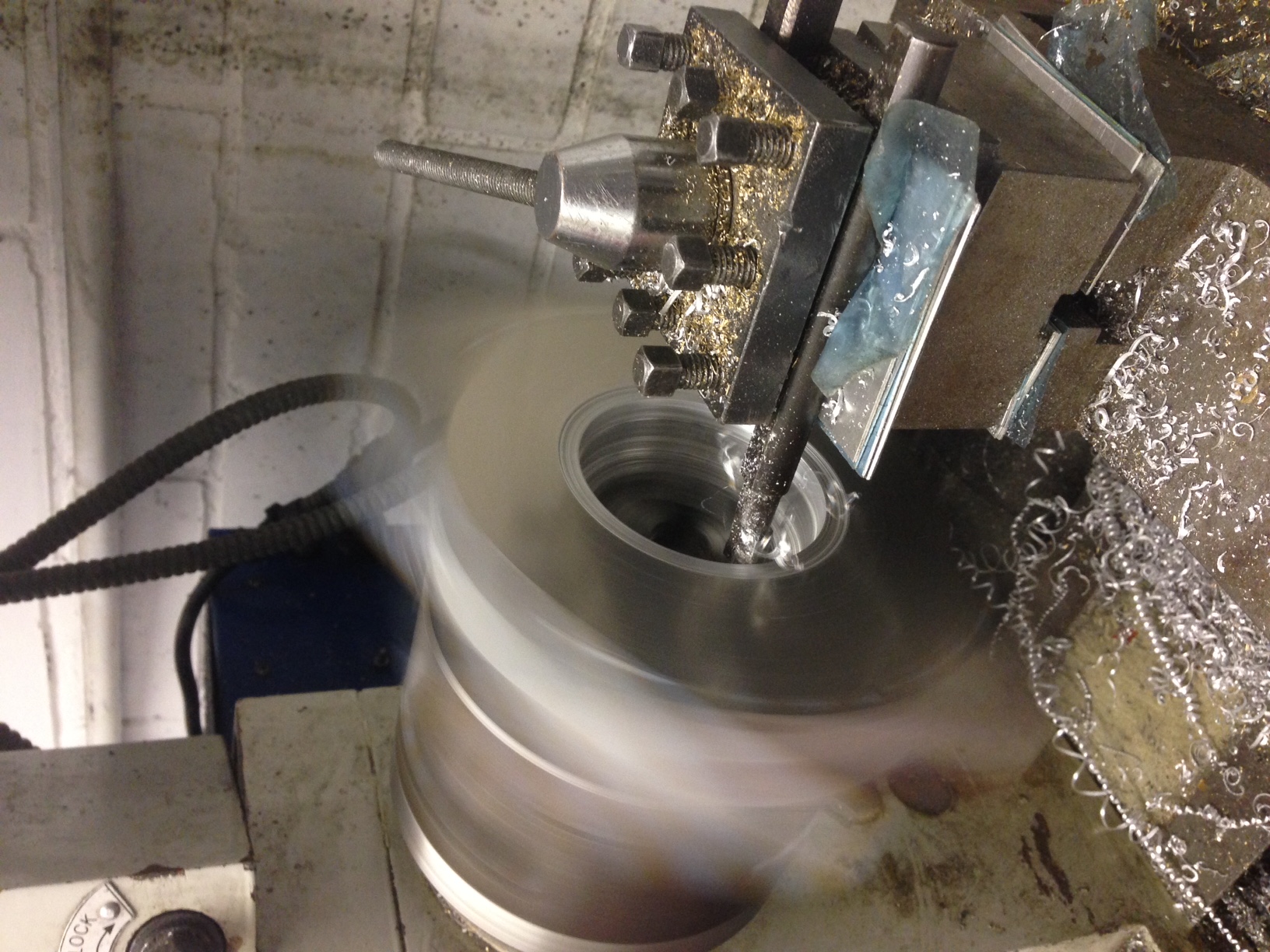

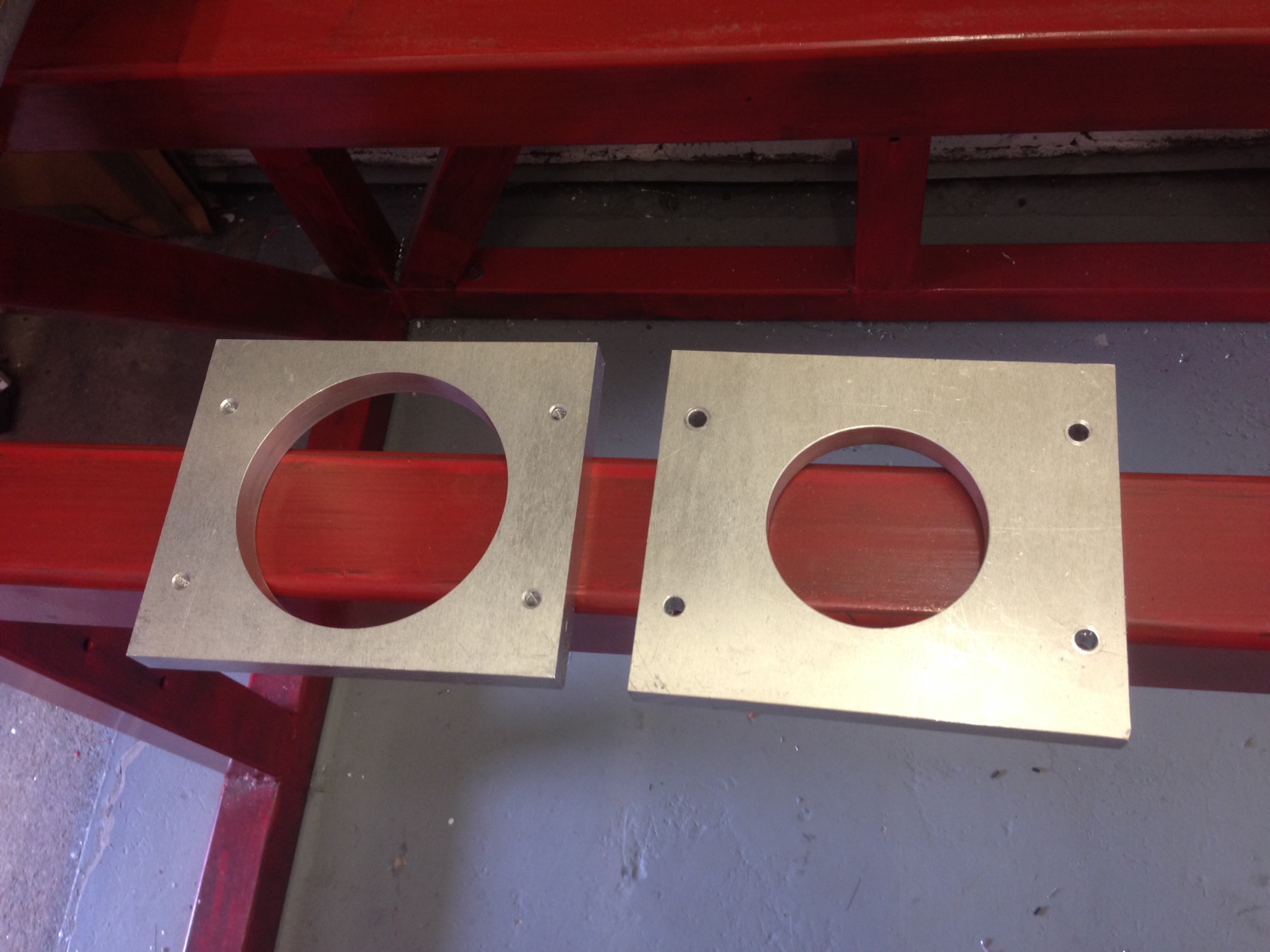

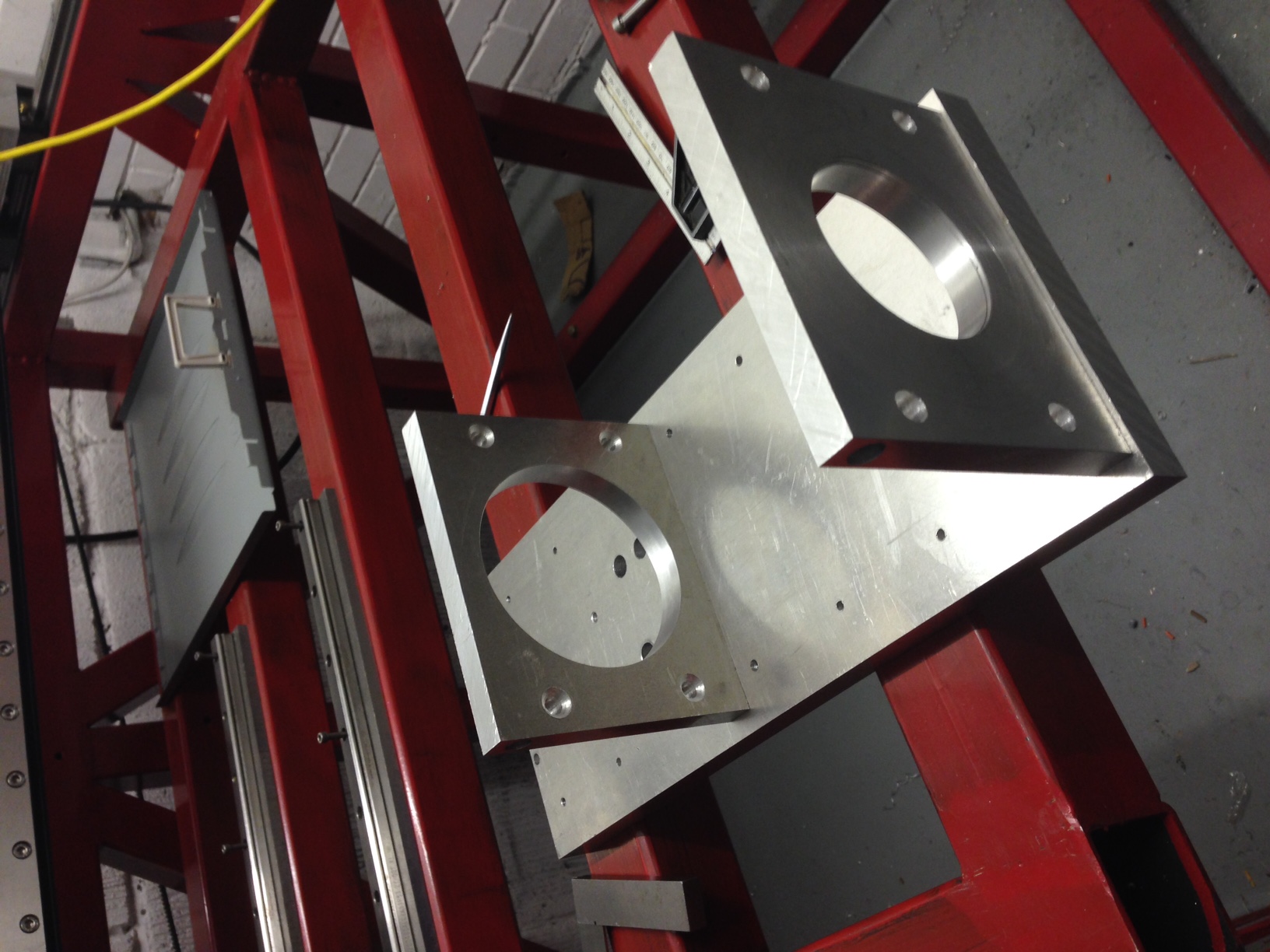

So I spent yesterday dismantling the z axis as I knew there were a few things I needed to take care of before I was happy to say that was done. One of them being some proper mounts for the spindle being as the ones on there were temporary polycarb ones.
I have drilled the plates for the pinch bolt just have not put the slot in it yet so I will be doing that shortly however I wanted to get all the covers made up whilst it was off the machine and easy to access.
I have also put in place the holes for the internal pipes I am putting in for the coolant / mist / blower system - more on this to come but there will be 4 small heads which will direct the air/mist relevant to the path of the cut as the machine moves around. Similar to the datron system Dean pointed out earlier in the thread. Currently waiting on some solenoid valves to turn up for this so I thought I would prep the pieces ready.

Been a month or so since I could get anything done on the machine but am aiming to have another full on weekend in about a fortnight so want to get some bits ready for the machine.
I am still stuck on the best way to create the bed surface for the machine. I would like to be able to catch most of the chips that sit from falling underneath for example if I just put aluminium strips running perpendicular to the steel current bed. I suppose a thin sheet of anything attached to the bottom side of the bed would do this.
As for the main material lets assume I use aluminium flat bar, how thick and wide does this need to be given I plan on using t nuts to secure down any spoil board or at least some similar sort of system.
fingers crossed I can get it cutting some material soon rather than the basic square and circle combo I have to keep replaying just to prove to people it works!
Re: New CNC Mill on the horizon
fvfdrums
On my Old machine I used similair setup with approx 35 x 16mm strips but I'd suggest thicker material 20mm min depending on support spacing.
Now this worked OK but in all honesty I found it to be mostly waste of money as 2/3rds was covered with some kind of spoil board which meant couldn't access T-sots so material was screwed down etc.
The area that wasn't covered was only used when I needed better accurecy on say things like engraving etc and I didn't want to surface the whole bed.
The type of work your mostly doing will determine which suits best but I found that while mostly cutting aluminium and mostly 2D profiling that a Good stable spoil board with a Matrix of holes using threaded inserts worked best. It gave good clamping options and most flexabilty for work fastening.
Very rarely did I need to remove the spoil board for acceess to more accurate aluminium base.
If you need accurecy but not over a large area then I'd suggest buying piece of Machine tooling plate and drilling matrix of holes. Then cover rest of bed with stable spoil board material and use T-slot track or Matrix of holes again.!
Just T-slots I find restrictive when using as general all-round machine cutting mixture of materials and Job types.!!
Thanks as ever Jazz :)
What would you consider a reliable spoil board material?
