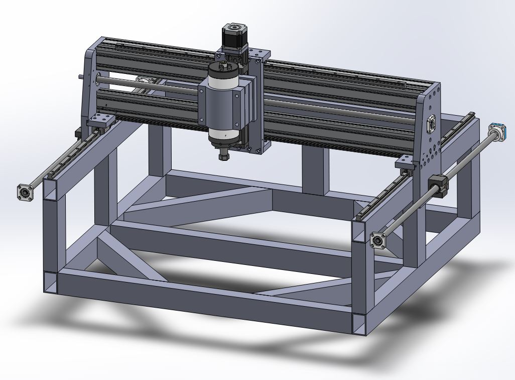

Hmmm I think its probably best to disassemble the gantry from the base and re assemble everything checking alignment more strictly as I go...at least I now know it all goes together!
Right, time to order a DTI (don't shoot me, probably where I went wrong in the first place!). Should I go for lever or plunger type? Lever appears more expensive but if it's going to be more useful then I don't mind. I'm looking here: http://www.lawson-his.co.uk/precisio...ial-indicators
While I'm at it, is there any other piece of measurement equipment (straight edge etc.) that is worth buying for setting things up?
Cheers!!
I think you could use either to align the second rail. Be aware you also need the connecting rods to hold the indicator in place and ideally a mag base. You can buy Mitutoyo (v good quality) but for DIY I'd look on eBay. You can get a DTI, adjustable rods and mag base as a set for under £20.
Mine were both mid price units from ArcEuro
Cheers for the help, I was looking at mitutoyo but will have a look at those cheap ones too.
I can't yet see how exactly to use a DTI to align the rails?
Fix 1st rail by pushing it tight against a known straight edge. If you don't have one you'll have to skip that for now and assume it is straight.
Put one carriage on the rail put the mag base on the carriage and use rods to reach across to the other loose rail and put the DTI touching the other loose rail. Run the carriage on the 1st rail back and forth (which will move the DTI)and nudge the 2nd rail until the needle doesn't move any more. This will at least set them parallel to each other.

Oh so close! I have movement, all sensors working with mach 3 etc. Just need a spindle and I should be there. Got some slight crunching noise to sort out on one of the ballscrews. Only happens near the end of travel so I suspect it's an alignment issue?
http://uploads.tapatalk-cdn.com/2016...1e98a81e82.jpghttp://uploads.tapatalk-cdn.com/2016...96a715292b.jpghttp://uploads.tapatalk-cdn.com/2016...9eb7431e6b.jpghttp://uploads.tapatalk-cdn.com/2016...d485c22afa.jpghttp://uploads.tapatalk-cdn.com/2016...d07aaac33f.jpg
Looking good! And very close to a finished machine. Nice one!

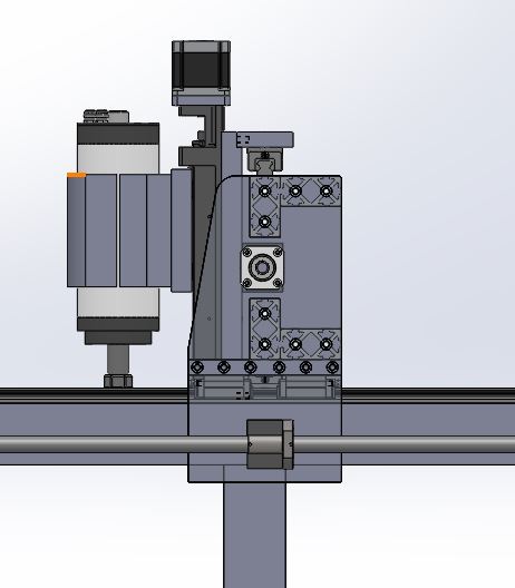

One question why is the spindle so high up the front plate.?
One suggestion.!! . . .Cut deeper.
That cut could have been done in one pass and much quicker. Know there your first cuts and probably think it's better or safer cutting shallow but your more likely to knacker the tool and snap it cutting shallow due it over heating the tool.
Very nice, looks a sturdy little machine there.
The spindle could really do with being lower, I agree. I wish I designed in more Z clearance height though! (Let that be a lesson to anyone designing a machine at the moment).
