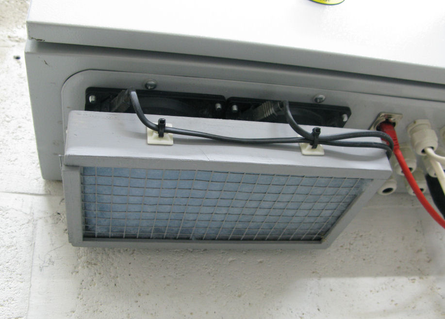

Gave me time to get the fans fitted anyway, something I was not looking forward to but not as bad as I thought. I'll probably fit a thermostat with a remote sensor in the hood.
Two fans mainly because I already had them but they are 110 Volt so just wired them in series. Made a box with a sliding lid to allow easy replacement of filter medium, the fans are blowing into the panel pulling air through the filter medium. A vent at the top allows heat to escape by convection or forced by the fans, it does not allow crap to enter under gravity.
The wiring will have to be kept to the back of the panel as much as possible so as not to interfere with air flow.

I like that top vent, do you have a source for them?
I'm hoping they come in 80mm square versions. I currently have regular fan filters at the top to stop crud getting in but I think the air flow restriction they cause will be too great so a vent like that would be perfect. The alternative is to fit a couple more fans at the top but that then risks creating a negative pressure in the case.
Home made from an old IKEA metal shelf, sometimes I don't mind a bit of sheet metal working, I was going to use the side cut from an old washing machine, another good source of sheet metal.
I drew it in Sketchup to get a template for cutting it out of a flat sheet.

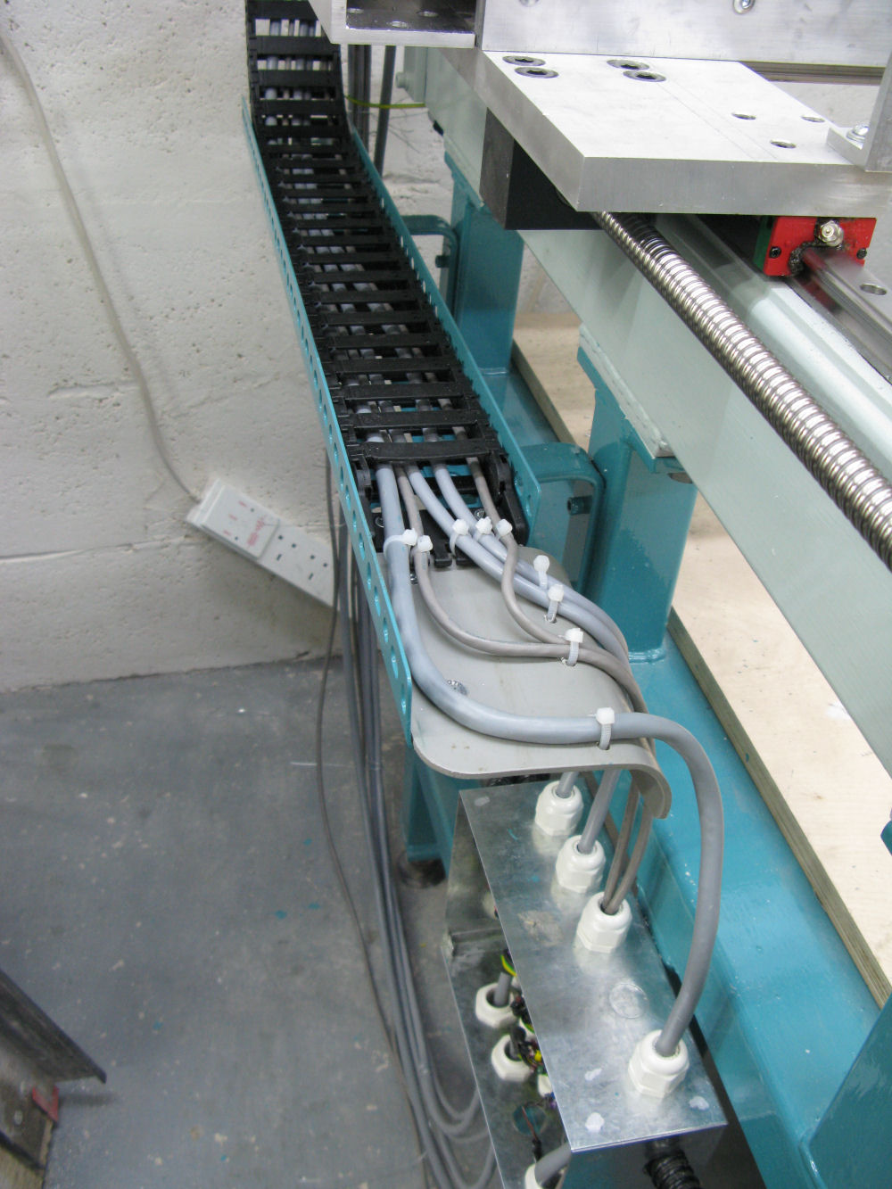

If anyone thinks the energy chain looks big, I still have some 8mm pipes to put in and at least one more cable.

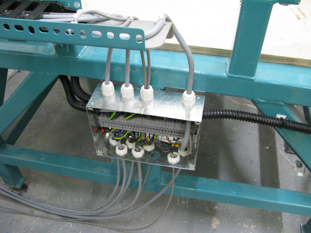

Junction box on the machine, the cables from the panel will festoon down to allow movement of the machine but they will probably have some spiral wrap around them eventually.
On the right, inside the junction box, you can see where I've just passed the spindle cable directly through the box, this is to have no additional terminals between the VFD and the spindle motor,
Attachment 11977

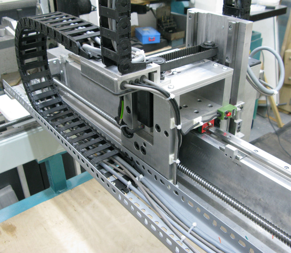

Energy chain now arrived and fitted, note the grey plastic curved piece to transition the cables form the tray to the junction box. This was made from one of my favourite sources of material, soil pipe offcuts. The 110mm soil pipes are made from plastic that can be shaped with a paint stripping heat gun, just cut it lengthways and slowly heat until it lies flat, you get a piece over 300mm x whatever length you cut.
I used Dexion slotted angle iron for the energy chain trough mainly because I've had a load sitting in the garage for years. With energy chain it's advantageous to have a trough that is open because it allows debris to fall through without collecting in the bottom causing all kinds of problems.
Attachment 11978
A small aluminium box just fitted nicely under the energy chain bracket to allow connection of limits and home switches.

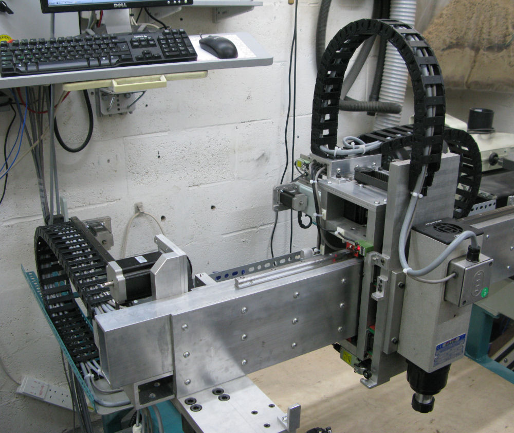

Just a view from the front. Unfortunately my great set up is no good now because the energy chain crashes into the keyboard and monitor bracket so a bit of rearranging will be required.
Attachment 11980
Got it going to it's home position today but there seems to be an issue with the slaved A axis, I might have to fit a switch on this after all. As it is with just a home switch for X, it reaches the switch and just comes to a halt, unlike with Z and Y where it backs off slightly. I tried unchecking the home limit selection for A in Mach3 but that made it worse. Will have to read up tonight about options for that, further reading on this subject here http://www.mycncuk.com/forums/gantry...is-gantry.html

Got the temperature controller fitted, ideal for under £9, it brings the fans on at 25 degC at the moment, it was 21deg ambient in the shed today (logs were good burners) so they were on and off quite regular.
Second photo shows the remote sensor in the ventilation hood, it's held in place with a 'girder clip' for cables.
