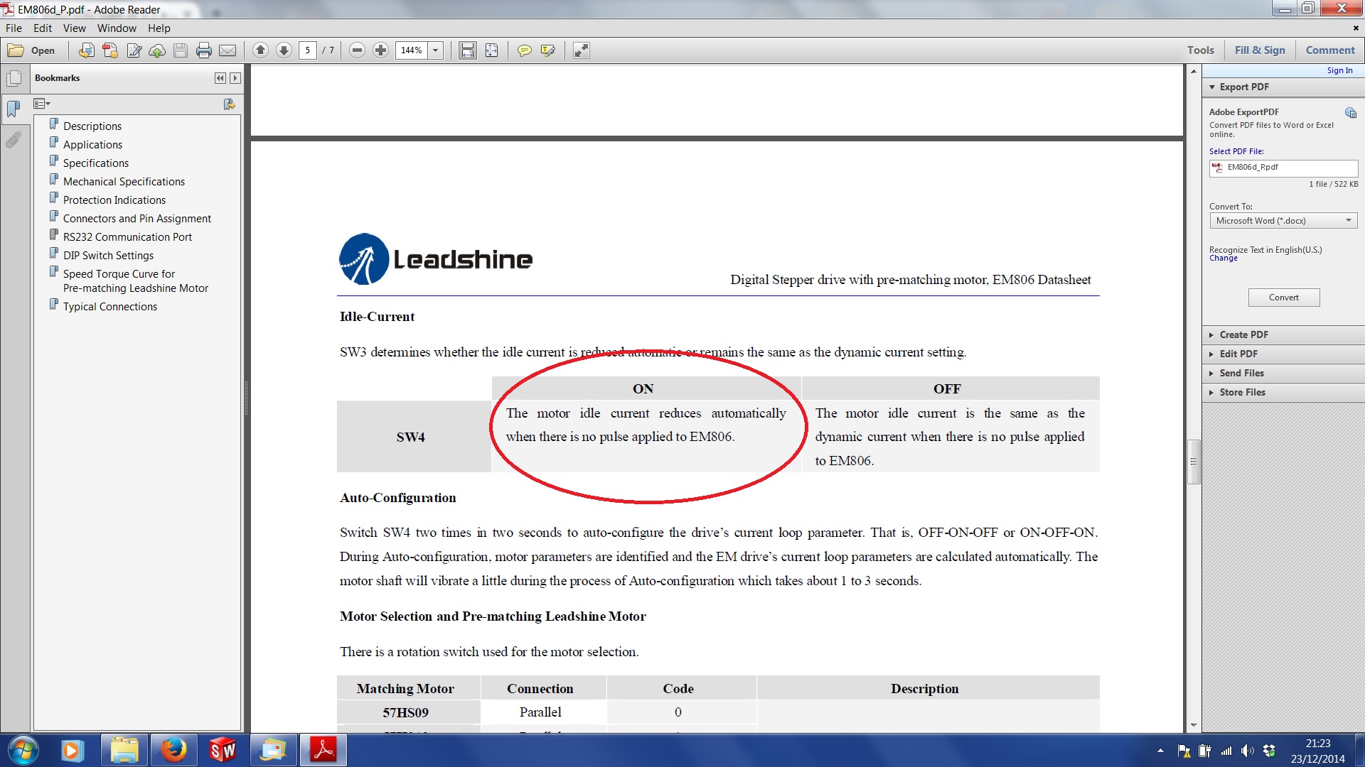

Dean I notice the arrow on the drive is pointing to the letter C is that correct? .. Clive

hi dean
sorry the picture I posted was when I still had it with the 2:1 ratio it is now set at 199.98 or something around that for the 2.5:1 ratio (this we done through the calibration function in setting on mach)
from my reading of the leadshine manual on page 14 from what we can tell it is saying switch 4 should be off for reducing the idel current?
since we re auto tuned the motor it has not yet stopped again but will adjust these setting once clear on them.

Re: Giant 20' x 3' x 2' router build
charlieuk
Not in my manual see pic.!
Attachment 14202
If you change the Amp setting which you really should then you'll need to re-tune the drive. Always re-tune with any changes made.

this is what we have been going by and what I got from there website. page 14
http://www.leadshine.com/UploadFile/Down/EMhm_P.pdf
hmm that's interesting that it seams to suggest the opposite very odd! will try switching the settings according to that!
Many thanks

This is correct and it does work 100% tried tested many many times. .:loyal:
Great thes good news! Many thanks indeed I will change switch 123and 4 then re auto tune. I'm still trying to down load a driver (see other thread) and when I figure that I will ajust the Amps
