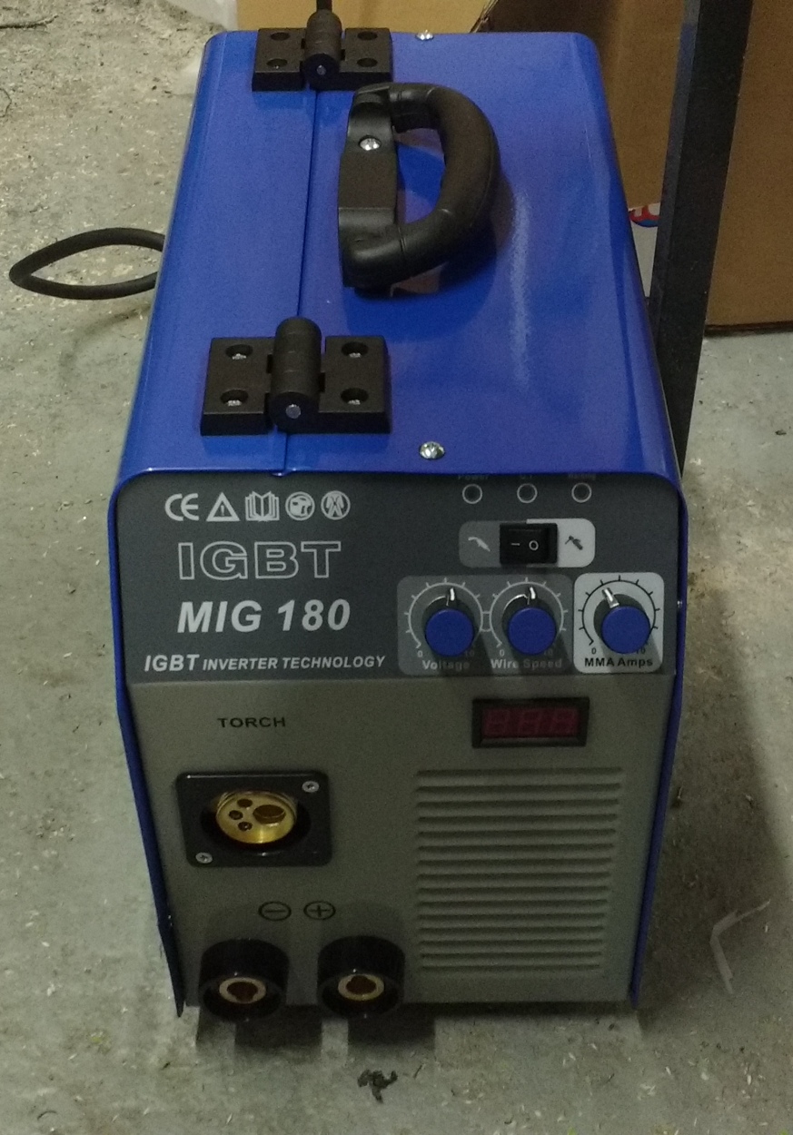

I've already got the steel for the frame (it's sat rusting out in the yard) so decided to get the firm to purchase a new MIG welder, as my old second hand 90A stick welder was OK but I cant stick weld (not enough time spent practising really, not the welders fault as I'm sure it's just fine...) and today it arrived :eagerness: It is an R_Tech 180 Amp Portable Inverter MIG Welder so can be used for MMA and apparently even scratch TIG welding as well if I so feel inclined :cower: It has good reviews and I know Wobblycogs has one of their welders so looking forward to using it, even splashed out on a new auto darkening mask as mine has the head strap held together by gaffer tape :tongue:

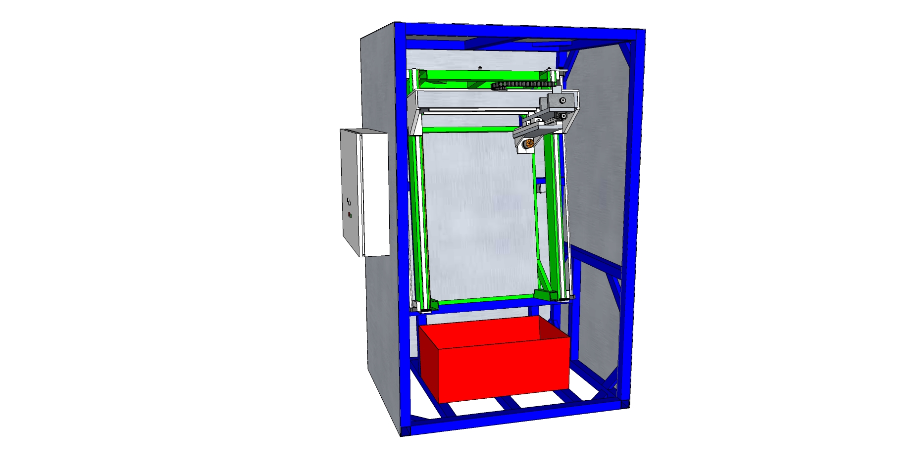

Just in case anyone had forgotten what the frame is going to look like.....
Attachment 17615
So watch this space, frame design will be finished (got to figure how to mount the router to it) the workshop area tidied and cleared and then the frame cut up and welded. Going to add an air extraction system in the workshop for when I'm machining so that will be connected to the router enclosure to extract dust (balsa and ply dust) and at some stage a DIY dust/chip clyclone extraction system (and dust shoe for the spindle) to stop the plastic chips being flung round the enclosure.....lots planned, so little time to do it!!

I got a plain R-Tech Speedmaster XL, nothing fancy...not opened the box yet but it's just a plain colour I think. Yes it's got a grind function....just checked :)

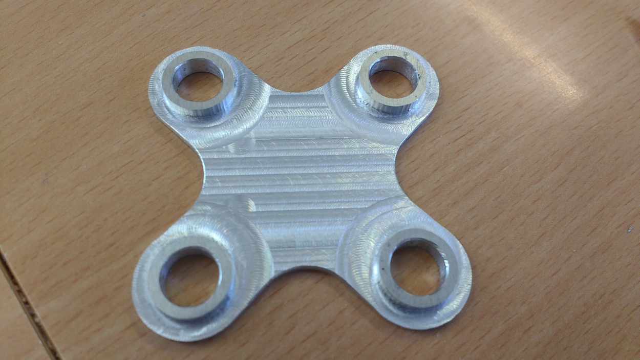

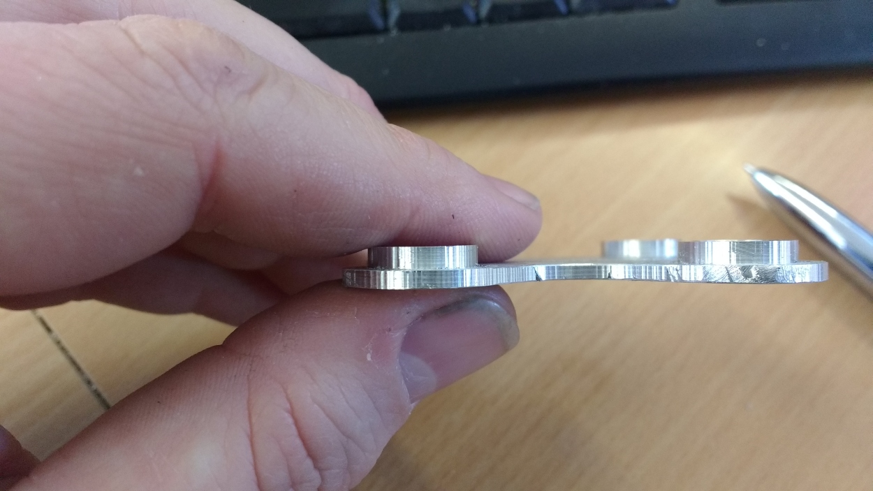

Had 20 mins before work this morning, drew up a motor mount and this morning cut it out using Trochoidal milling on my router...I wanted to use the "onion skin" method instead of holding tabs but my MDF bed is obviously not level!! The piece finished with the 2 finishing operations around the bosses and outside profile still to do! Still it gives me the opportunity to tweak the design a bit and re-cut it in lunchtime :D
There are 4 off 25mm long aluminium tubes (10mm OD, 6mm ID) to press in to the bosses for spacers which I'll then mill to the same height (should be OK as I did them on the lathe)
Anyway not bad for a first effort I think! Video will be up a bit later....internet connection is soooo slow today!
