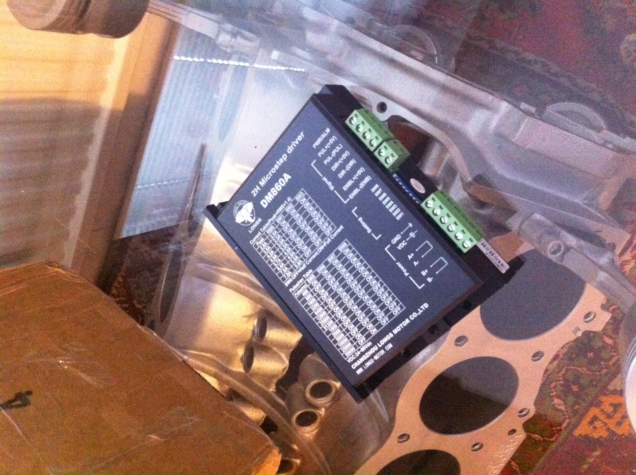

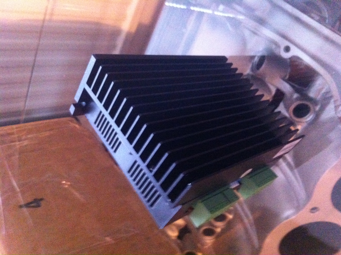

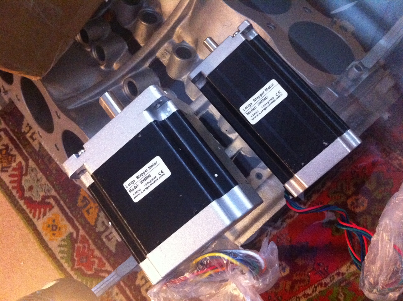

Got a text at 7am this morning to say the Motors and drivers should be here today, thats crazy they were collected in HK at 10pm on friday night and are here this morning now thats service!!
So hopefully I should be able to add a few more pics to the component pile.

Motors and Drivers have just arrived. Well packaged and look good so one more package to come from Chai and I can start on the Gantry. I would just rather have the parts with me to measure from before I start drilling and cutting.
How long does Chai generally take to get things machined etc once the order has been placed? I know it takes 1-2 weeks to ship.
