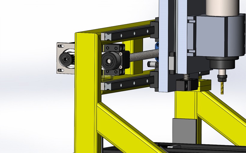

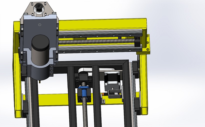

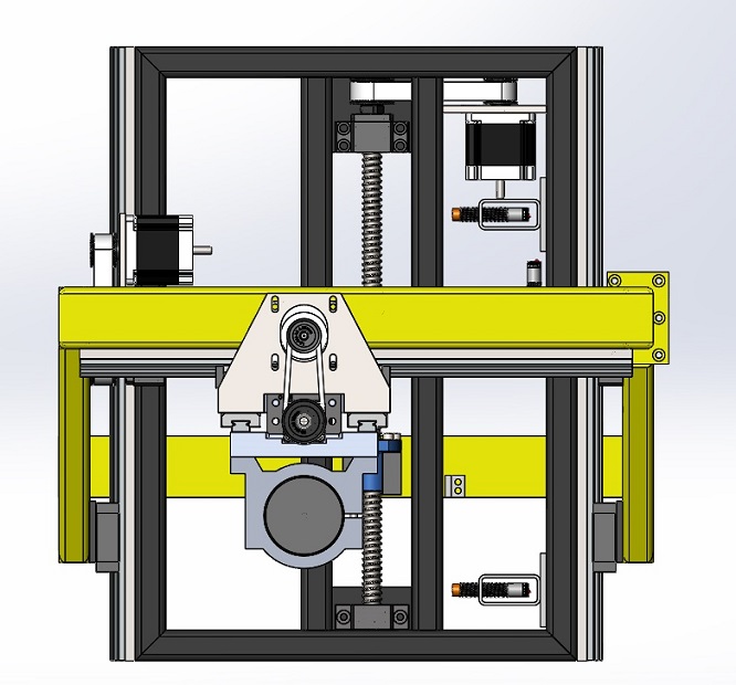

See on design:
Attachment 18803Attachment 18800Attachment 18801Attachment 18802Attachment 18804
