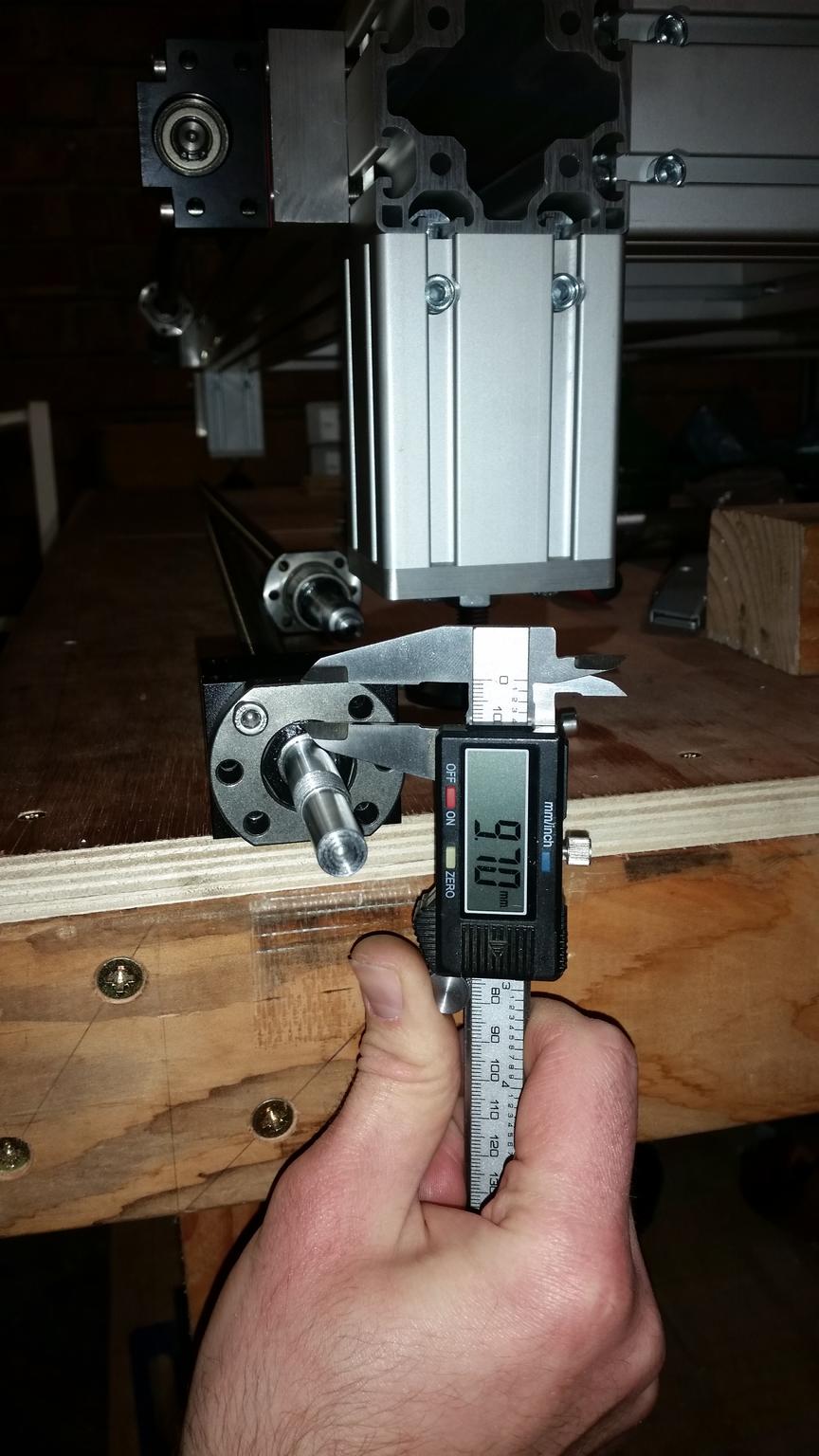

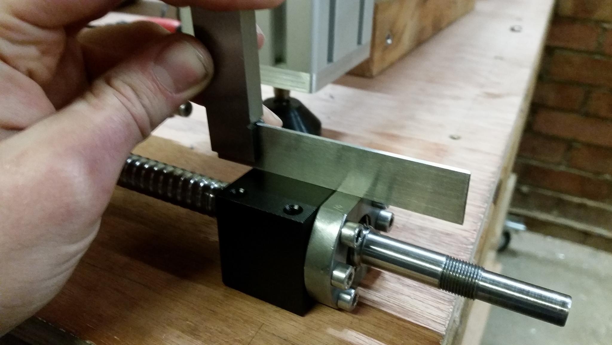

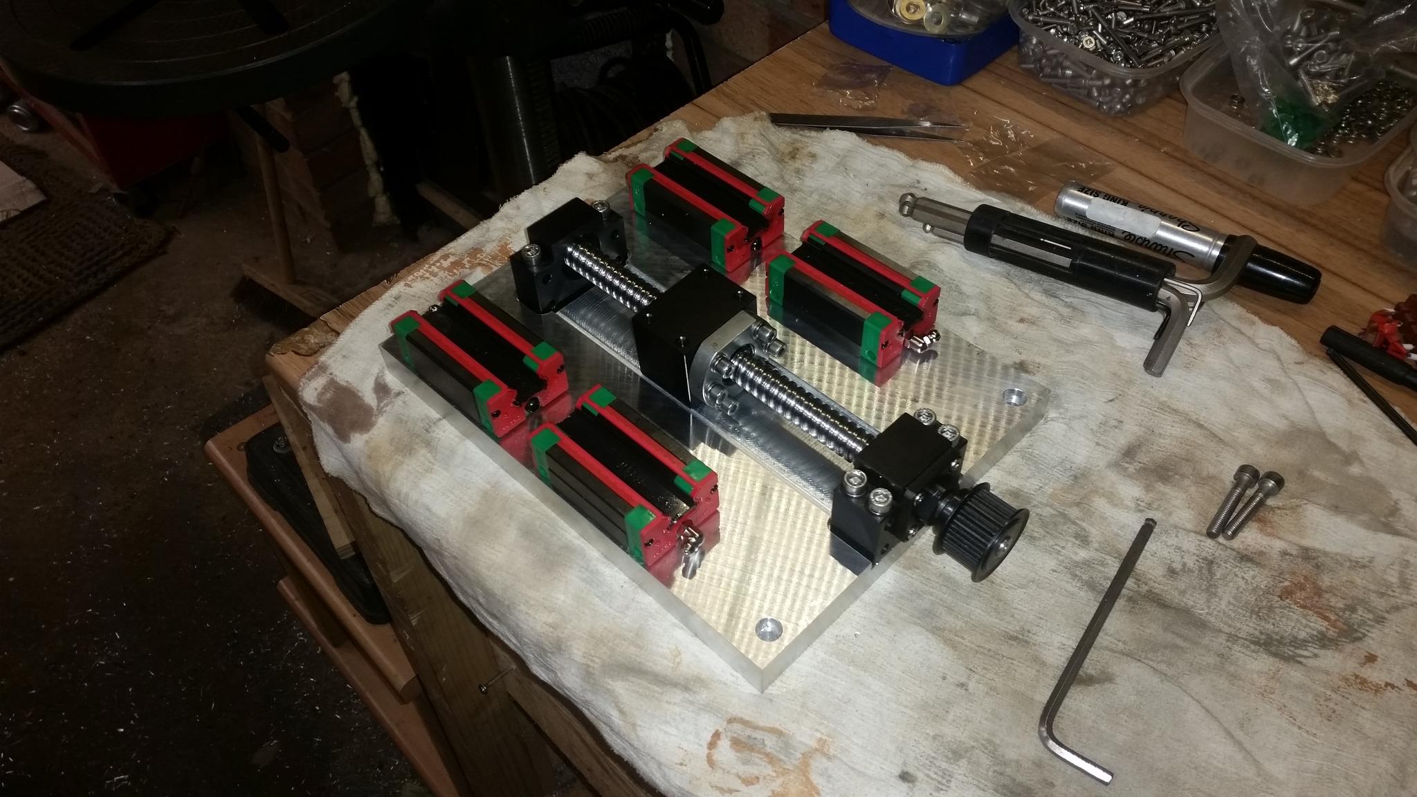

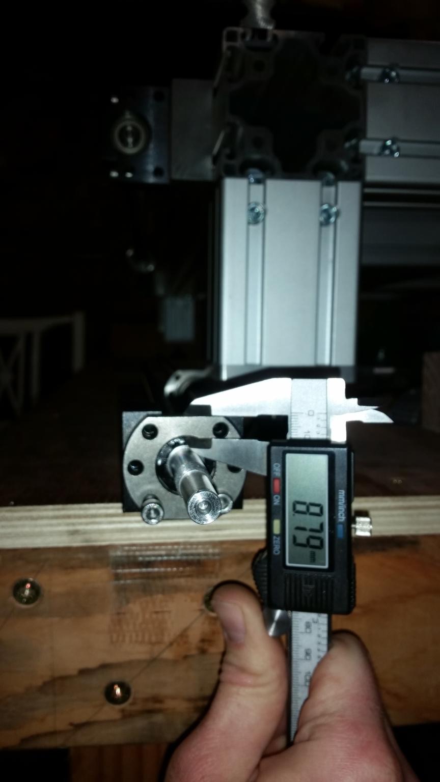

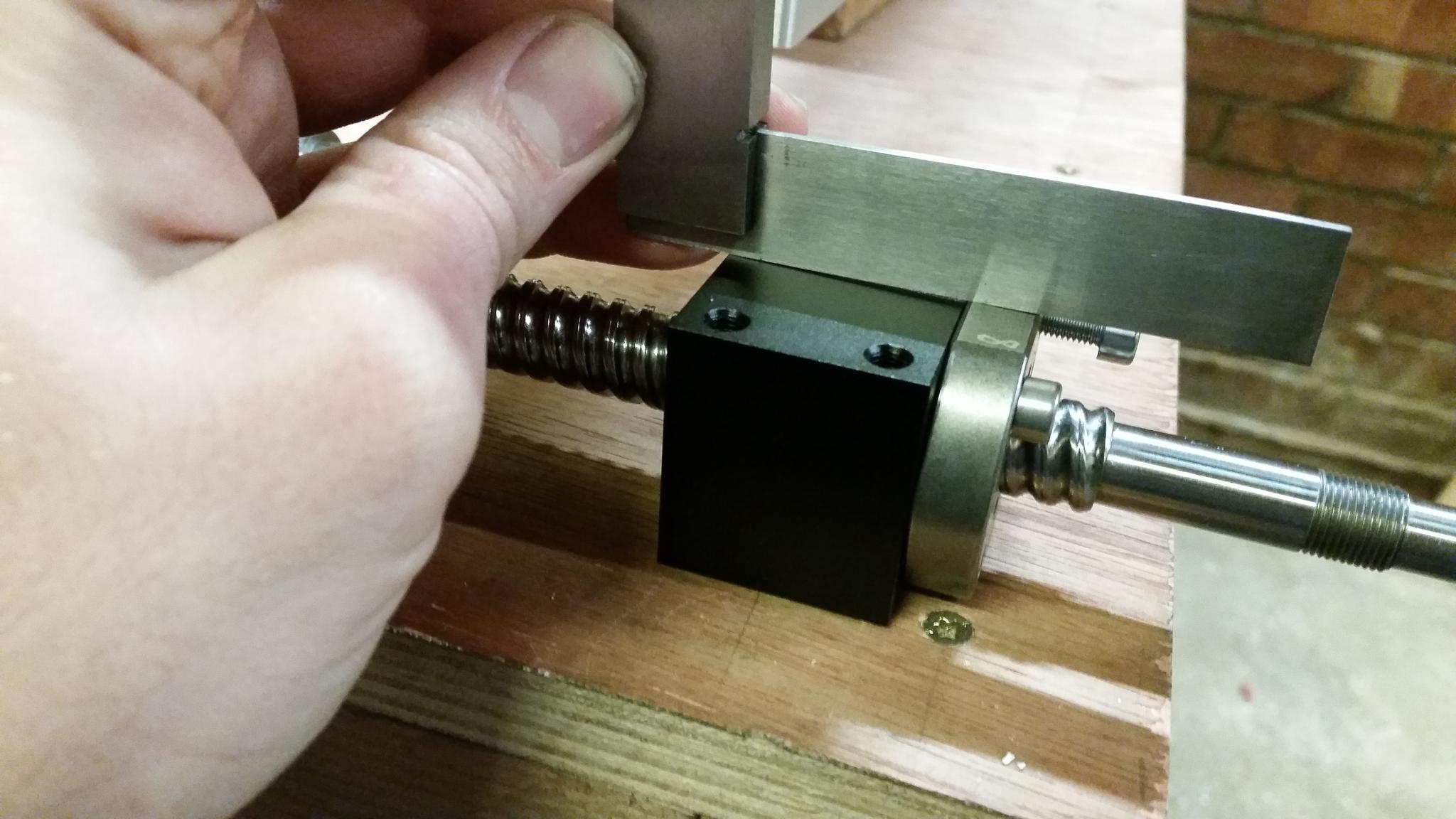

Here are some pics. I think whole centre hole for ballscrew is off center, thats what causing missalignment.
Attachment 20472
Attachment 20473
Attachment 20474
Attachment 20475
Hi Valdis
Machines looking good.
If you have a couple of V blocks you could support the screw in the blocks and put a DTI on the diameter that inserts into the block rotate the nut and record the runout. no idea what the tolerance is for the positioning of the flats but it could be +/- 0.5mm from centre. Dean might be able to better advise, as he is working with this stuff all the time, but if you measure as directed you have better information to give to Fred.

So here it is. All I can say Fred is top man, he takes all responsobility for that. His prices are a bit higher, but his service is awesome. Here are his last emails:
"Hi Valdas,
Thanks for all your help.
So sorry for the inconvenient to you,it is my first time to aware the ballnut size may have error possibility.
You are correct,seems the whoel centre hole are out of the position,the ballnut are produced in bulk quantity,I guess there may have some other wrong size ballnut went into market :(
I sincerely apologize for the problem to you,generally I will test whether it is in smootly running and the backlash,not measure size in before time,could you please tell me which the length for which 3set ballscrew have problem?I guess maybe all for 1610 model?
As now we are in holiday time,and here it is my opinions,
1)If you can waiting and build your machine in the later of next month,
Then I will arrange new production for you once back to office around on Feb.10,and hope can delivery around on Feb.12,if everything going well then shold can arrival on Feb.20.
2)If you need start your project as soon as posssible,
Then can check what's the selling price in your local market for similar Chinese ballnut?I know it will much higher than we selling,but since it is our mistake,so we have to afford all the responsbility,in order not influence your schedule too much,if you can get the ballnut from local market,no matter how expensive will be for the similar Chinese ballnut,I will pay for it.
Another question,are you skilled to install new ballnut?guess you know,the ballnut can't remove or install directly if there is no some tube between the ballnut,that means there must have something(like tube) in the middle of the ballnut,to prevent the inside steel balls dropp,and if you buy ballnut from local market,it is not 100% sure can be use directly,may need adjust the backlash to suitable according change different size steel balls.
If you didn't install the ballnut and adjust the bachlash in before time,then we will send the new ball screw with ballnut together to you,or you can buy the completed set for ball screw and ballnut together.
You can do it in any convenient way for your project.
Sincerely apologize again.
Best wishes
Fred
[email protected]"
Another one:
"Hi Valdas,
Thanks for your kindly waiting,really sorry for delay your schedule,in order to aviad the the new ballnut not in correct backlash in your present ball screw,I think we'd better delivery the completed set to you,so I will arrange the ball screw with ballnut together for the new delivery.
Will arrange the production work once back to office."
So actually i will get another set of ballscrews the only downside of its the time.

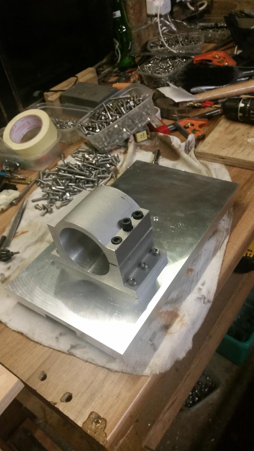

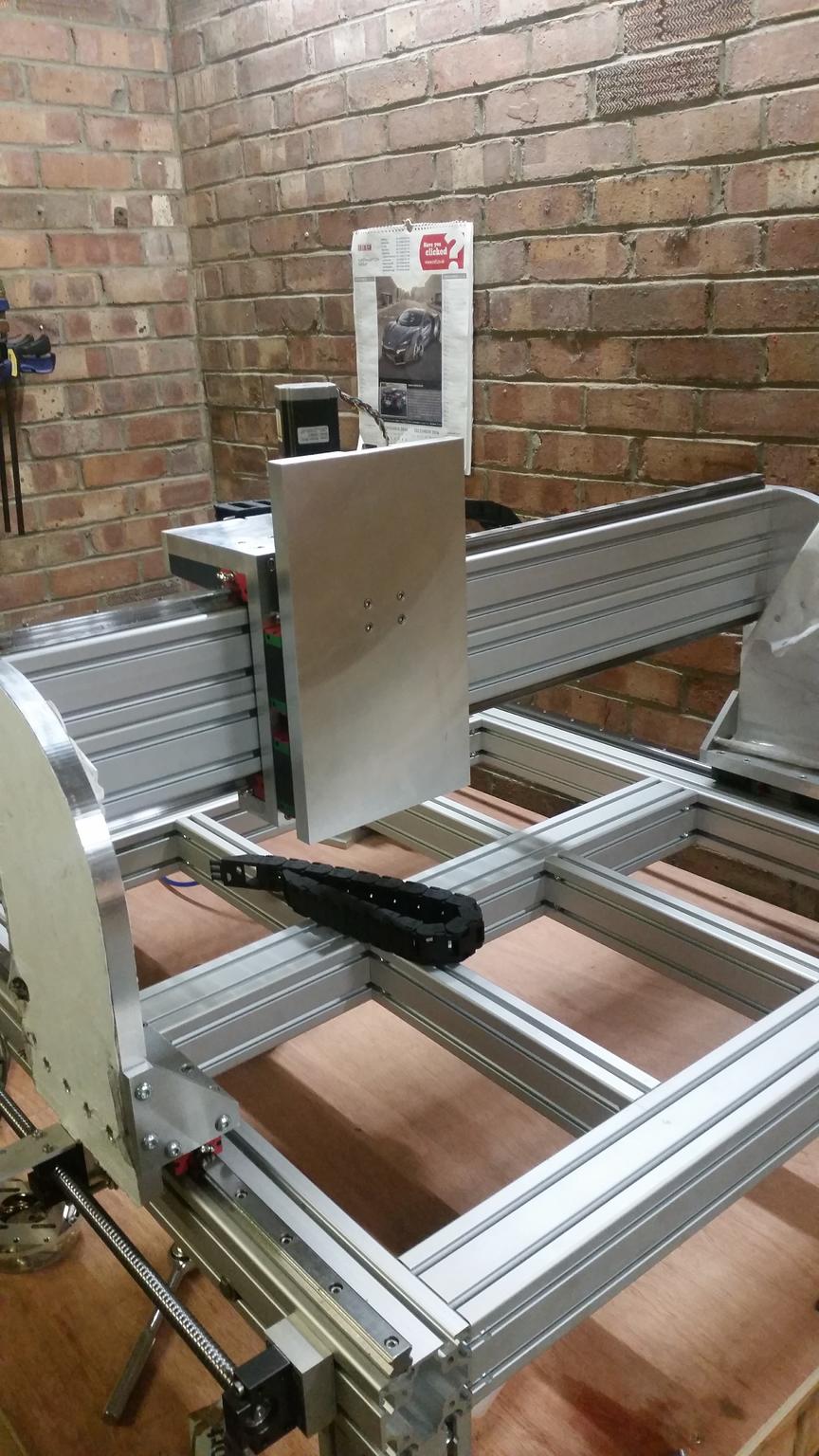

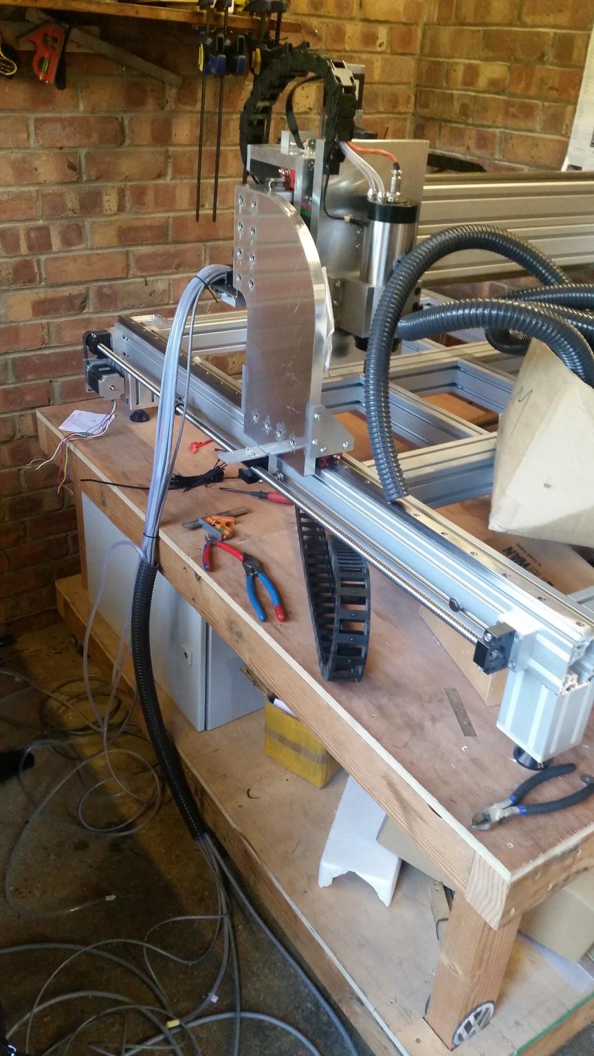

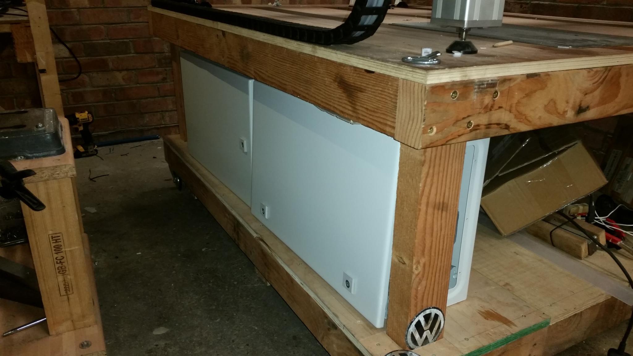

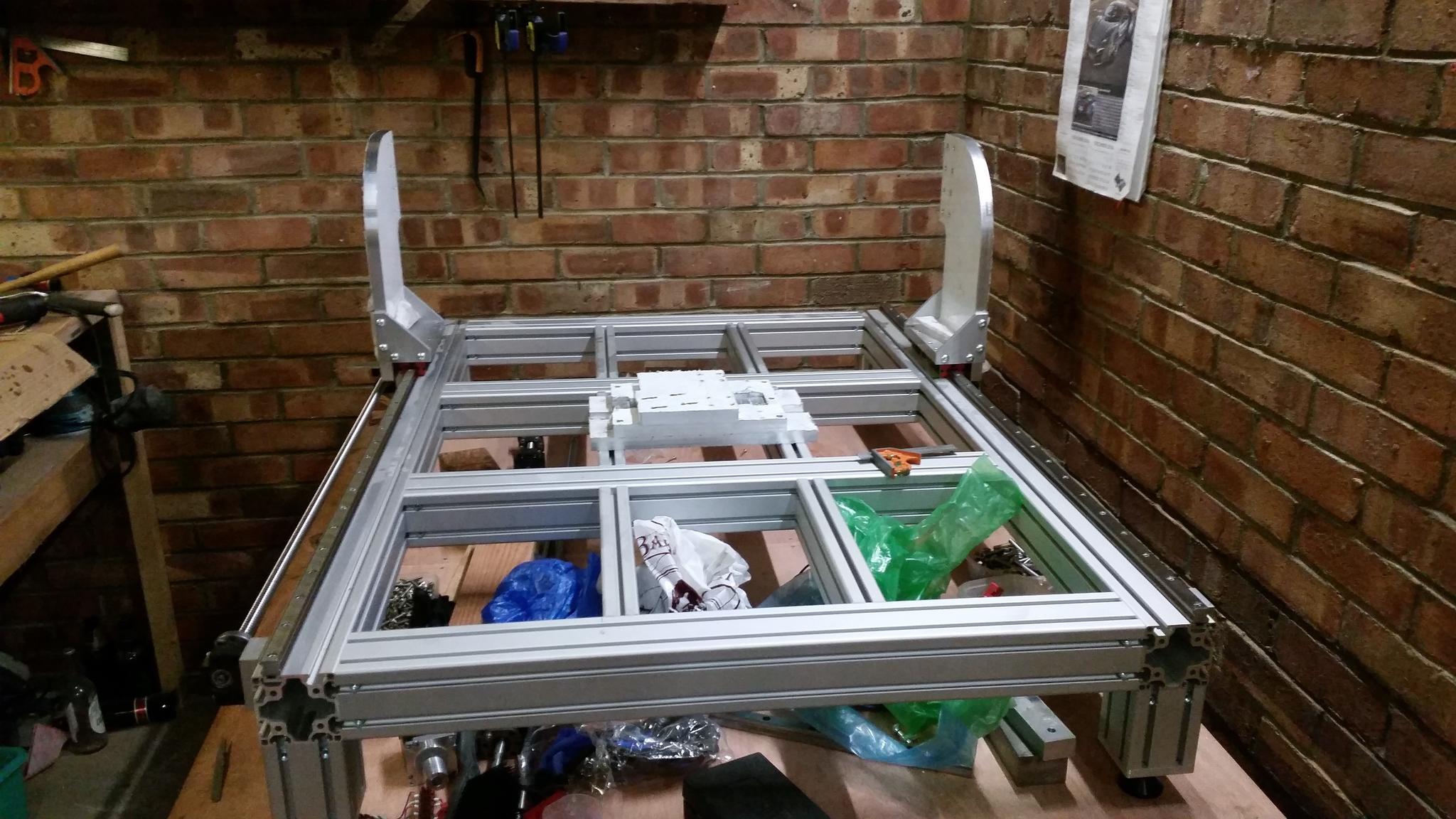

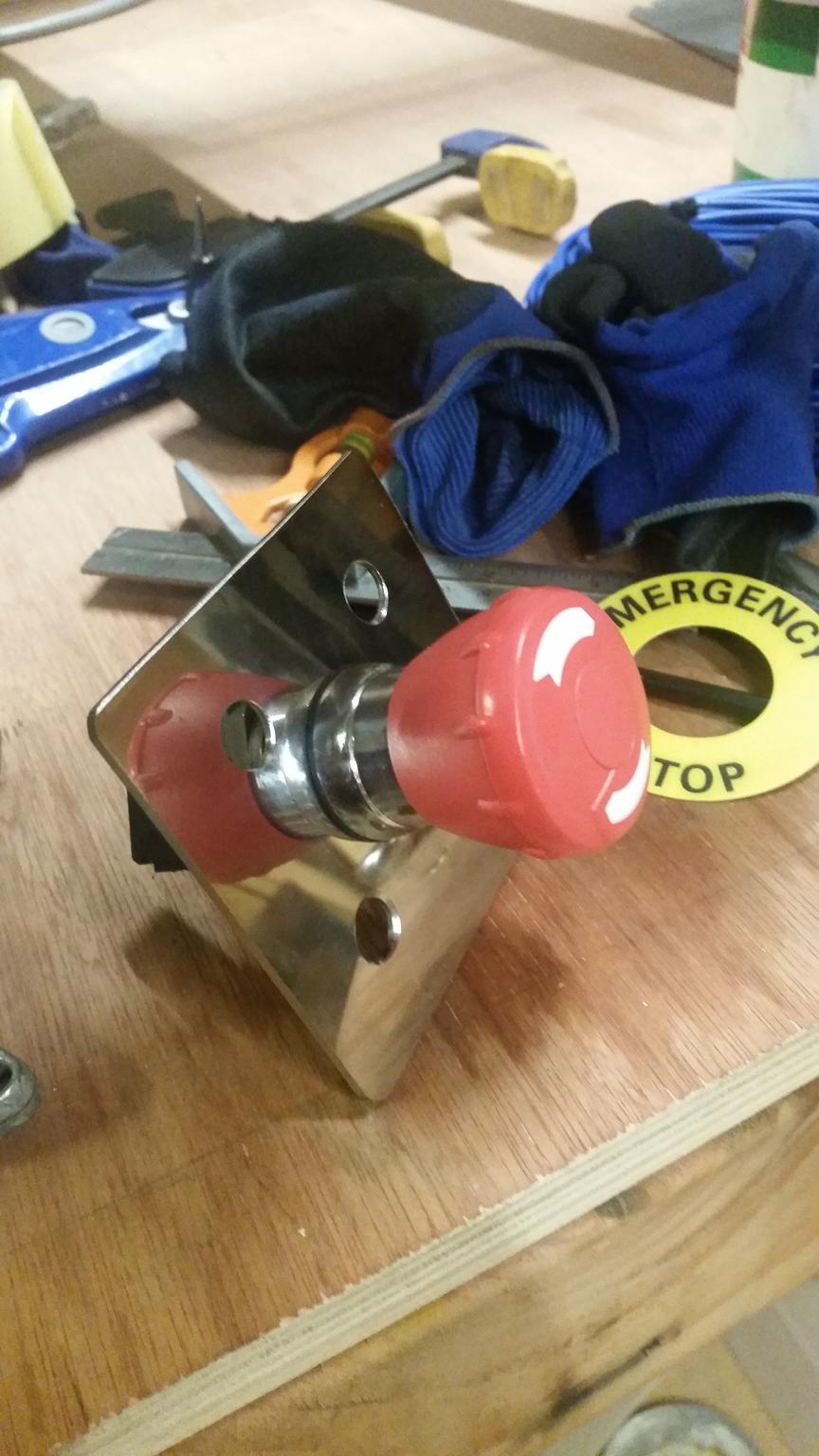

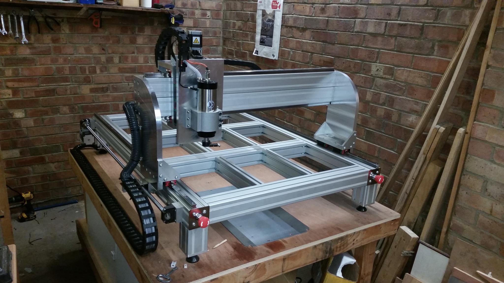

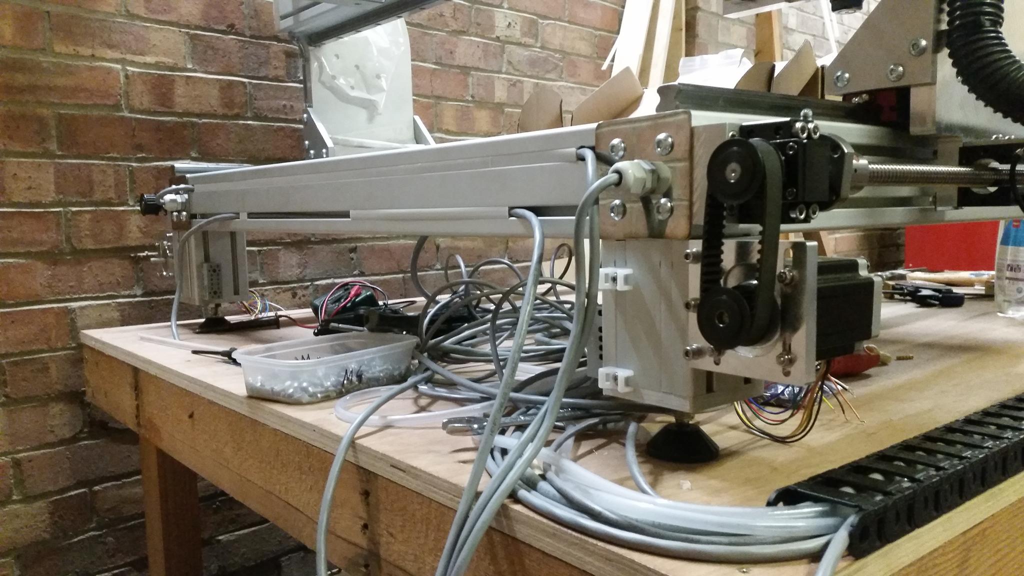

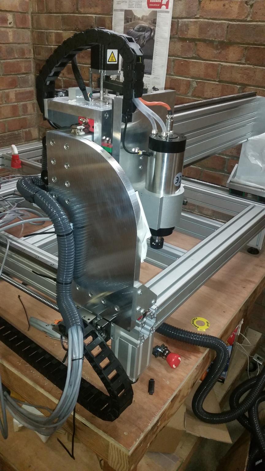

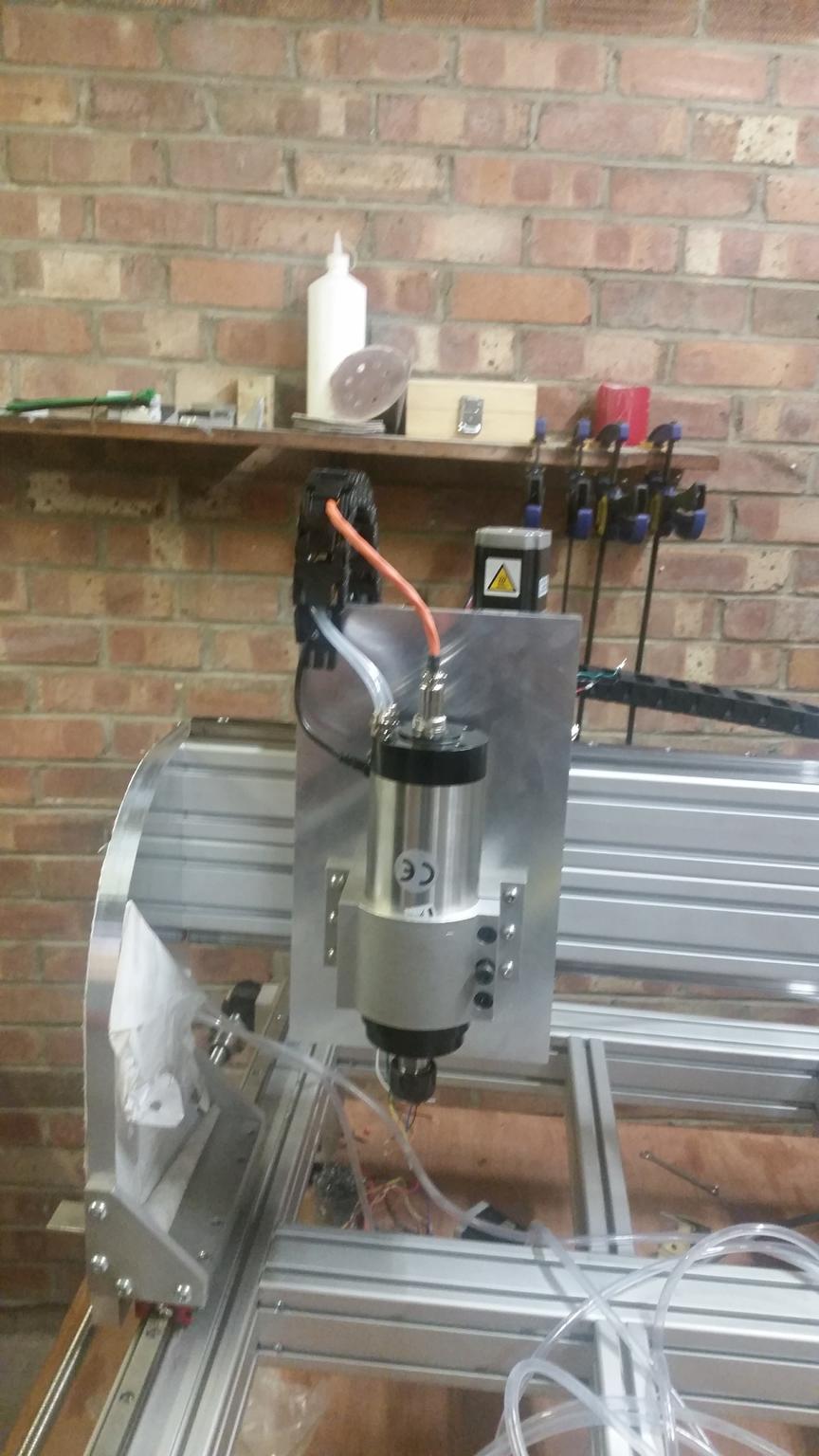

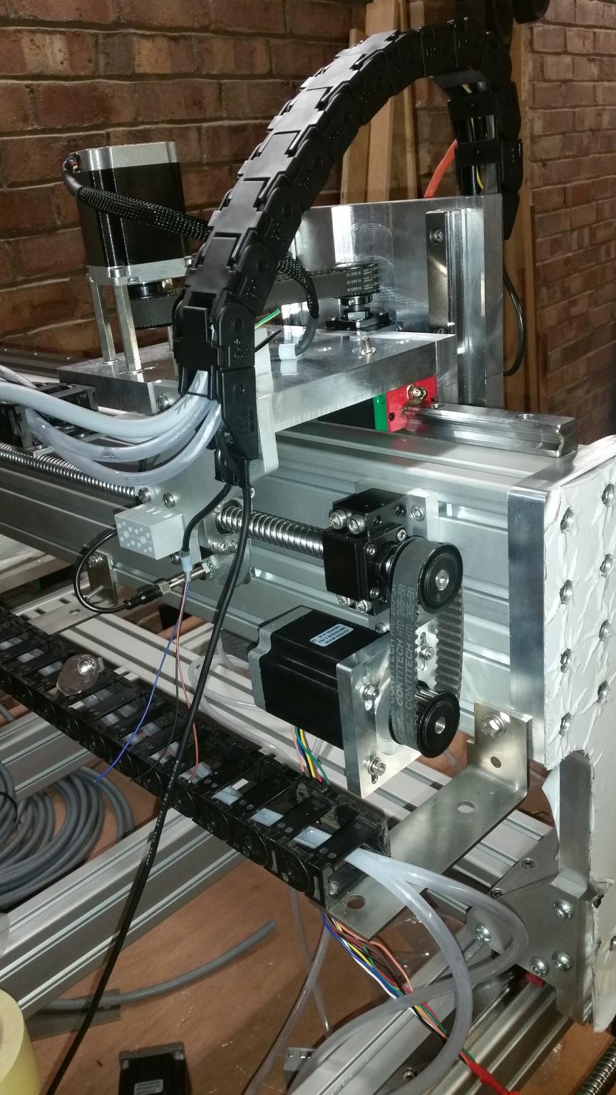

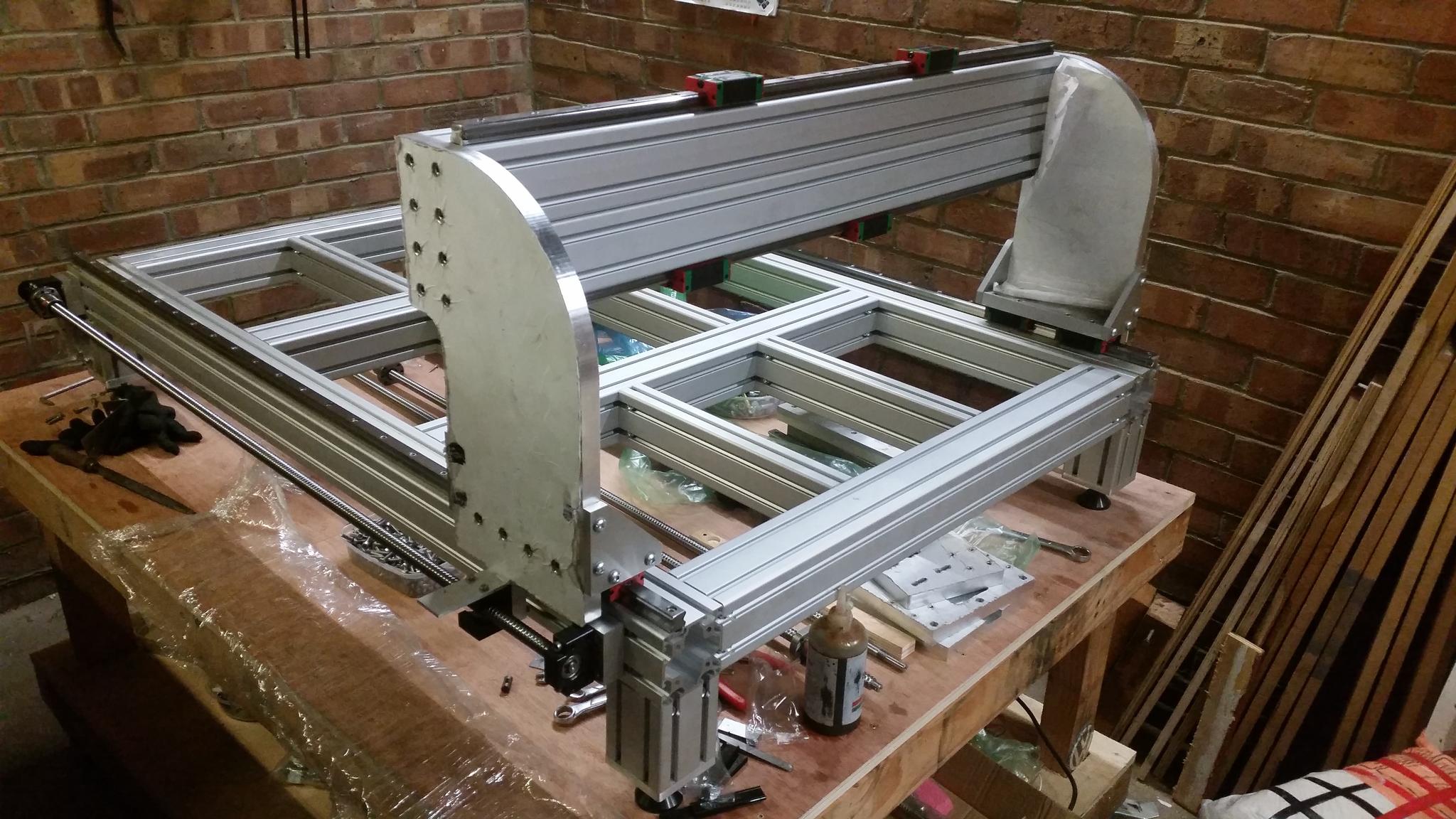

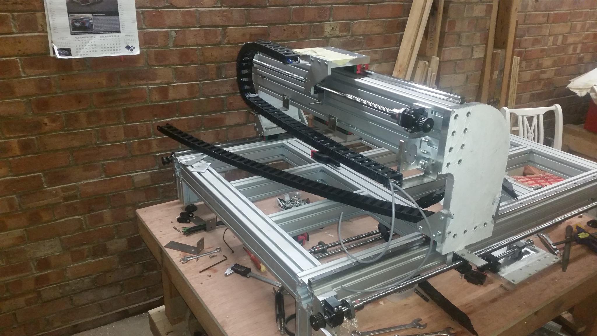

Hello. Coming back with some updates from my build.
So the news shortly are that mechanically machine is done, and partially wired. Now it will be time for the electrical drawings, laying out components buying some of them, mounting everything into electrical boxes..
Some progress photos:
Attachment 22625Attachment 22626Attachment 22627Attachment 22628Attachment 22629Attachment 22630Attachment 22631Attachment 22632Attachment 22633Attachment 22634Attachment 22635Attachment 22636Attachment 22637Attachment 22638Attachment 22639Attachment 22640

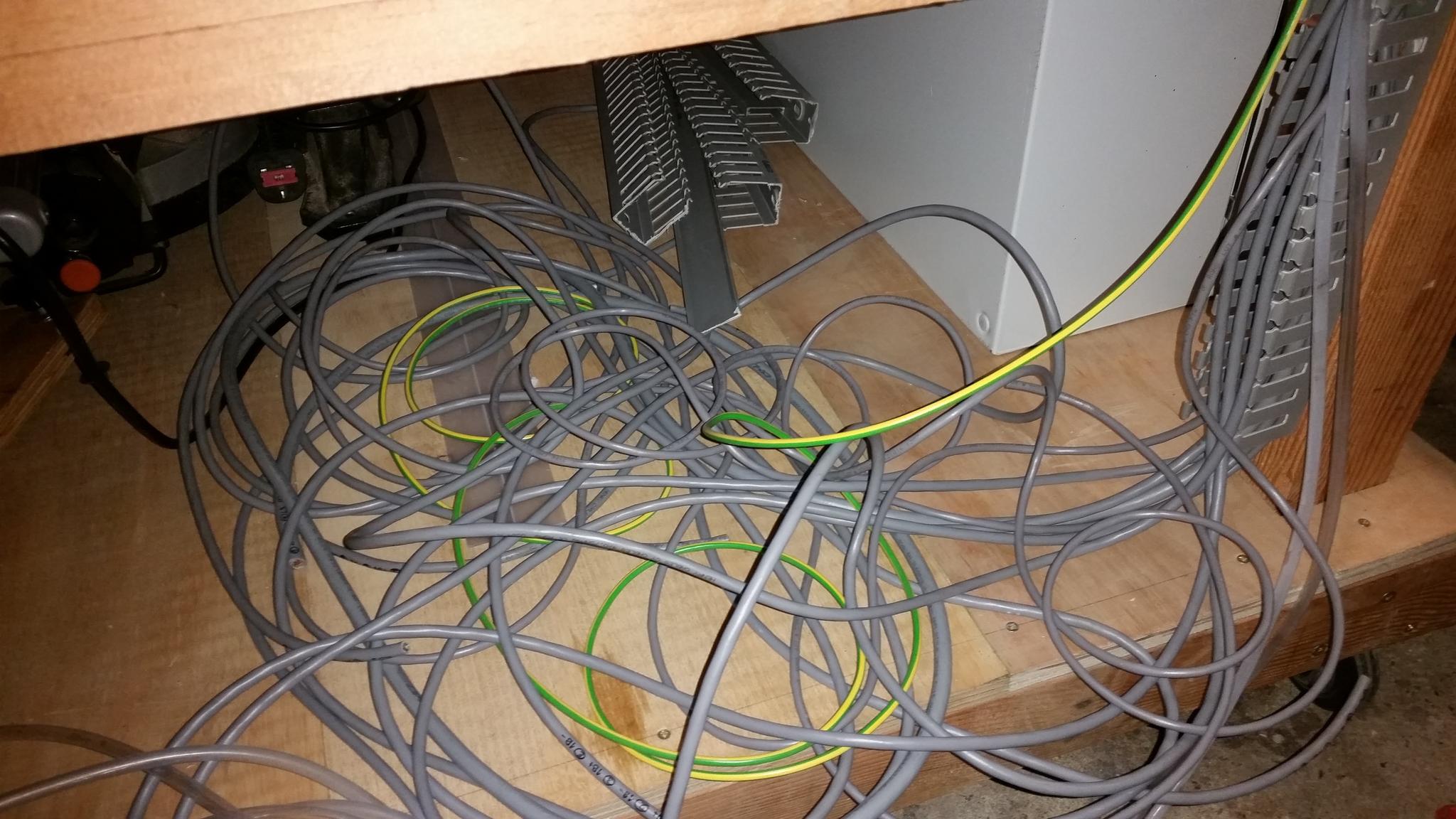

At the moment I ended up with some cables which will need to go to two control cabinets. Two because one is not enough which I got initially, so I got another one the same size, so I am thinking to have mains voltage distribution, for pump, powers supply, and vfd in one box and all the electronics to have in another one. Attachment 22641Attachment 22642
Now I will be doing a bit more reading about electrical side, try to draw some drawings. Have couple of questions for now

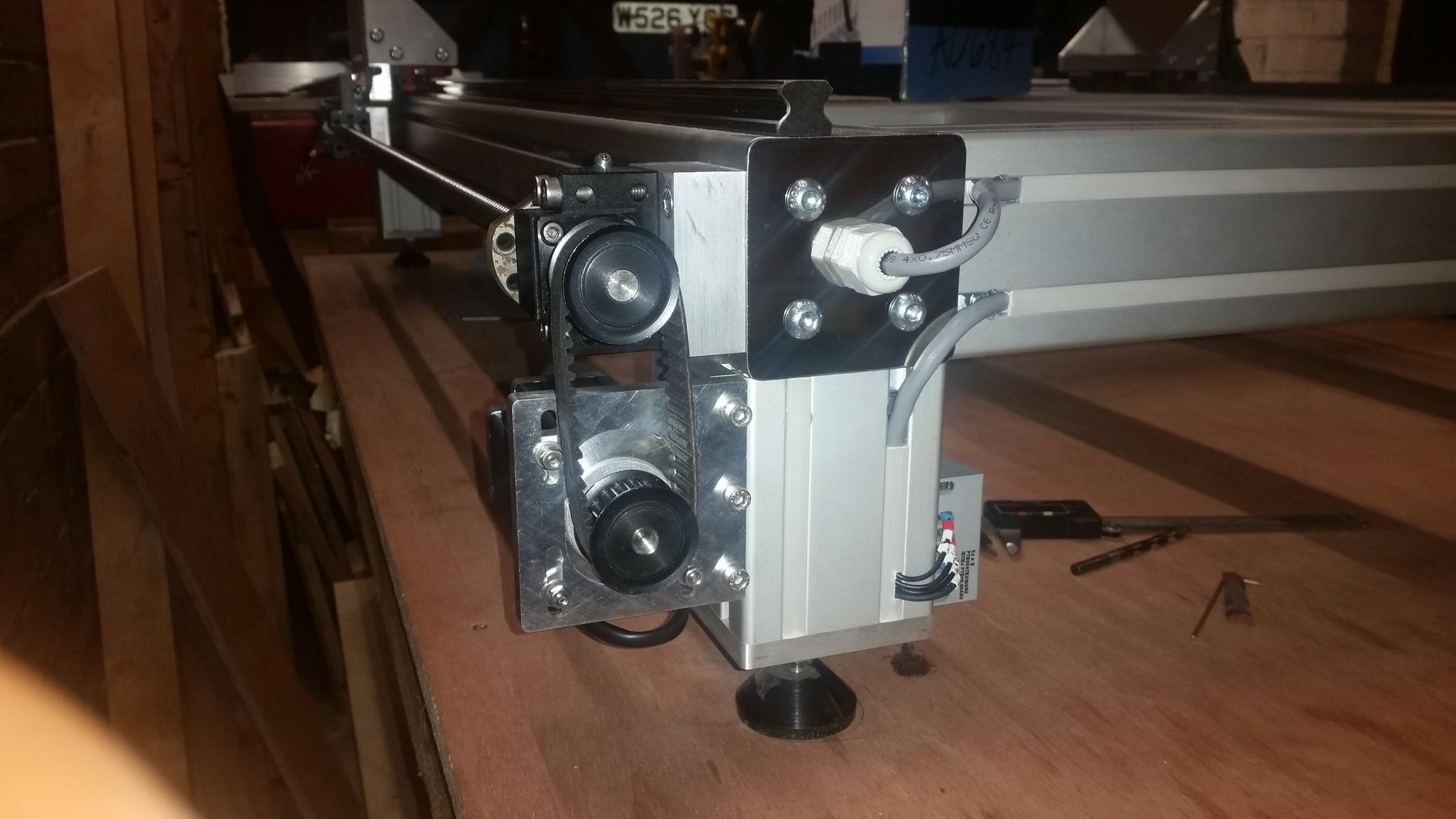

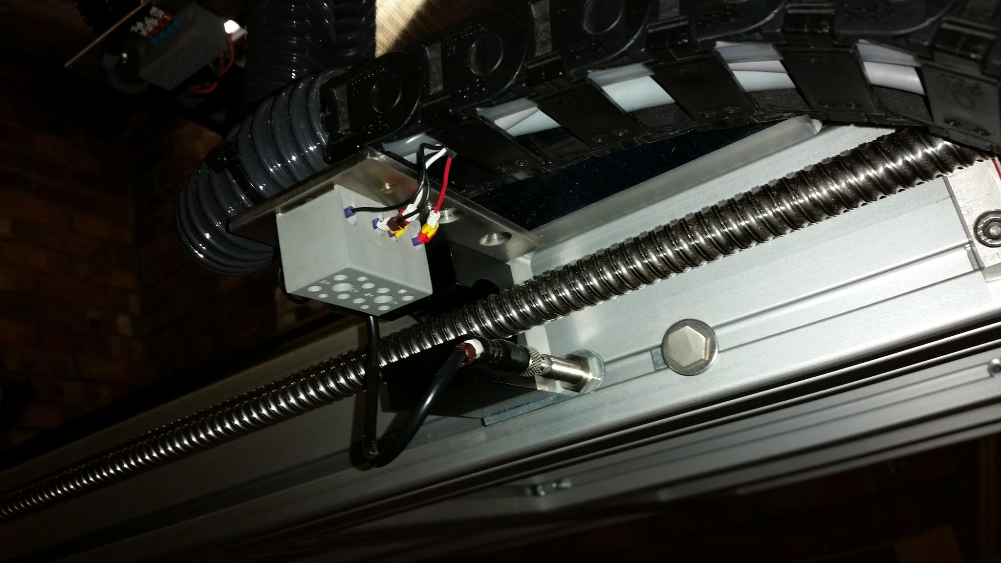

1. About x axis (long one ) home and limit sensors. As I am using one sensor for homing and limits I will have senor traveling with the gantry (one sensor on each side of the gantry) and it will see a bolt in the extrusion channel in each end of the machine. How will I make them bolts in each side to be in exactly the same position so gantry will be square when it reach the sensors?

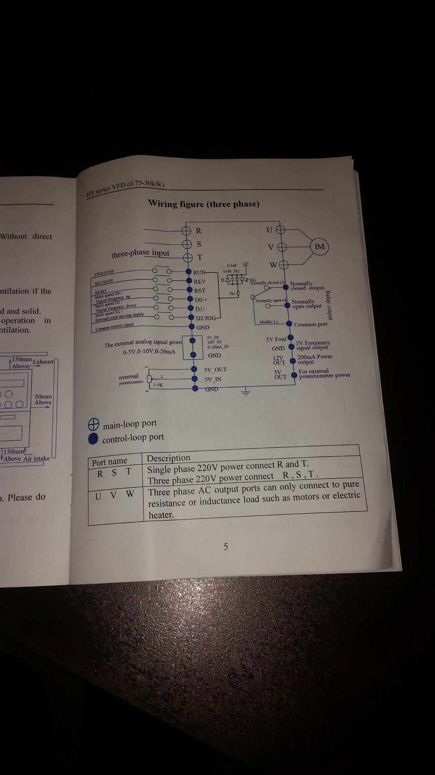

2. As my vfd is a bit different I don't rellly get how to control it with external signal from mach? That Chinese manual is not very clearly written. Lets say I want to start spindle . Do I need to short RUN terminal with GND terminal or I need to use 5v or maybe 12v inputs and then to set it in parameters? Jazz said he used one of them before, might remember it. Heres the drawing:
Attachment 22645

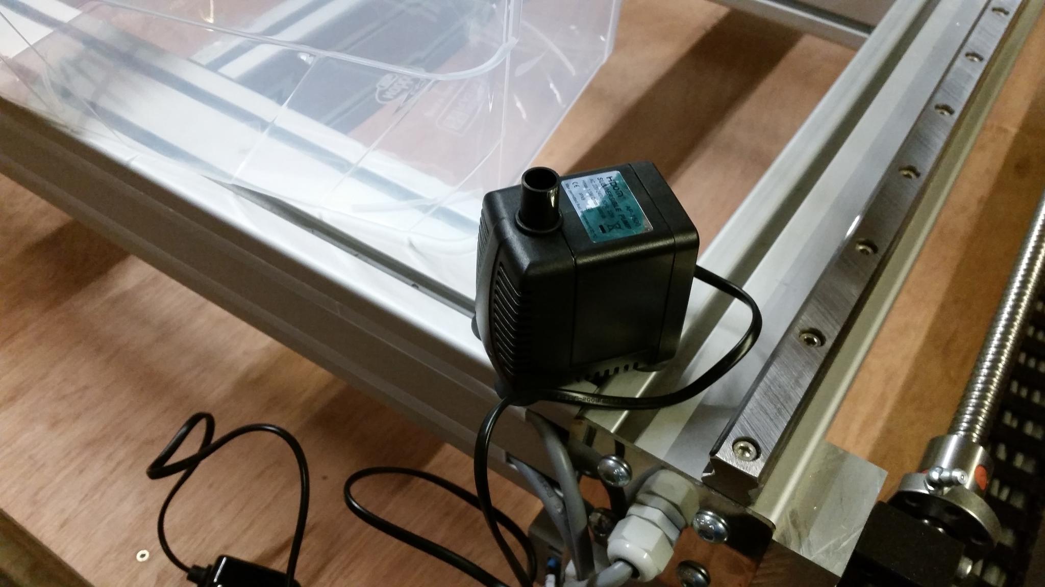

3. Bought 13 liters tank for coolant I think should be ok? I had a tiny aquarium pump 1000l/h wich probably will not be powerful enough to lift the water all the way to the spindle, so might be looking for something bigger. I was thinking use car antifreeze and mix it with distilled water, so the system will be clean, and in the coldest times in the winter it will not freeze inside the spindle. What are your suggestions on that?

You will need to be able to adjust one of the bolts when the machine is built so that you will be able to square the gantry by moving it one way or the other. In Mach3 you will set it up with homing and shared.Quote:
Yes if you want a switch to start it. Or you can use a relay contact to closed it and then control it with the gcode with and M3 to start and M5 to stop. In this case you will have to change some parameters in the vfd. There is a list on the forum that Jonathan started a while ago for setting up an VFD.Quote:
That's fine. 13 Ltrs is a bit over kill. If the pump can not do the head then just stick it on a shelf higher up.Quote:
Powered the vfd today and tried to start it not with panel button but linking the terminals, and it works everyting is ok. Was really surprised how silent the spindle is.
Now the question is how mach3 is controling the speed? In the manual is written that there are 7 methods to change the frequency. (Parameter 3)
Obviously from mach you can get 0v or 5v so how it will tell on what speed to run?
Another question. What is segmented speed? In manual it says you can have 7 segmented speeds. Is it that you need to enter into the segmented speed parameter the frequency you want starting from smaller one and with each segment increasing it, and then mach sends 5v pulses to adjust speed accordingly or i am wrong in here? How does that work?
