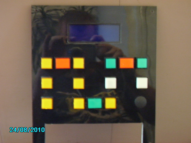

Ok Revision one of the control panel is done, as usual taking into account peoples views and ideas regarding switches and positions it is nothing like the original idea and its not finished yet, i just had to get something sorted to hold all the controls while im doing the machine...
Attachment 2851
Not sure how to rotate the picture but im sure you get the idea....
Attachment 2850
A Closer view of the panel so far still more to be done but things are moving on now..
Attachment 2849
The DRO information repeated from mach3 in the 4X20 Character LCD using pokeys55 board...
Sorry about the picture quality cam is on the fritzz
Rick
