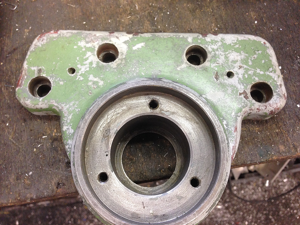

Now, when doing these on the Bridgeport, I am seeing bad vibration or chatter on the tool, it appears to be vertical oscillation but tonight also suffered bad enough radial oscillation to break a 5mm tool ! When it goes into oscillation it makes you jump as its very noisy and you instantly know it will end badly either in poor finish or broken tooling. Tonight I was testing tool sent from my supplier as a "Better" option :ambivalence: this was a two-flute carbide, probably the reason for the breakage as two-flute tools need a more rigid setup.
So, something is not happy - my reservation is the spindle mount (shown below) - its canted out over to one side and although it's clamped to the quill and into an R8 collet in the main spindle, it must be allowing deflection from the cutting forces.
Ok, so I have a bad situation, is there a way forward here?

The first thing that springs to mind, is how much play is in the quill?
By bolting onto the quill the way you have, any play in the quill will be greatly magnified at the second spindle, so it's probably not taken much extra wear to go from tolerable to a problem.
Creating a new Z-axis assembly sounds like the best long term solution.
Yes, I was working through this on the drive to work this morning ;)
There will be play, must be or it would seize, plus being umpty years old i guess there will be a measurable amount.
The setup is perfect on the 2mm tools or engraving etc so it seems somewhere between 2mm and 5mm tooling is a point where cutter force and reaction come into play and bite me in the arse.

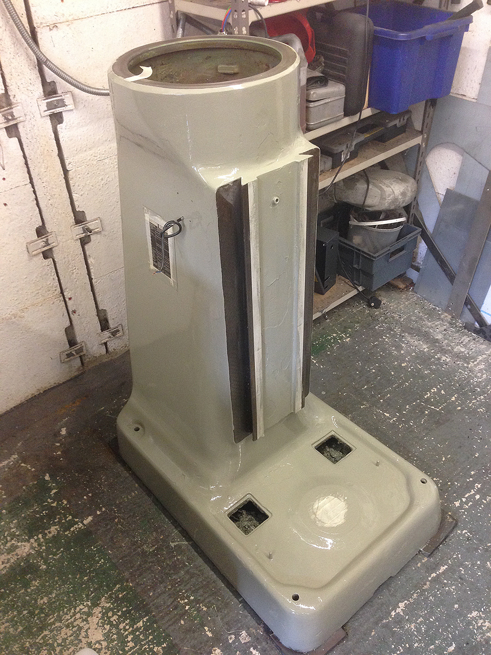

Started modifying my conversion - I am powering the knee with a servo so i can send it tool length offsets, this will give me full Z travel with any length tool, hopefully.
Got the motor mount fitted today, hopefully get the limits and home switch fitted tomorrow:)
