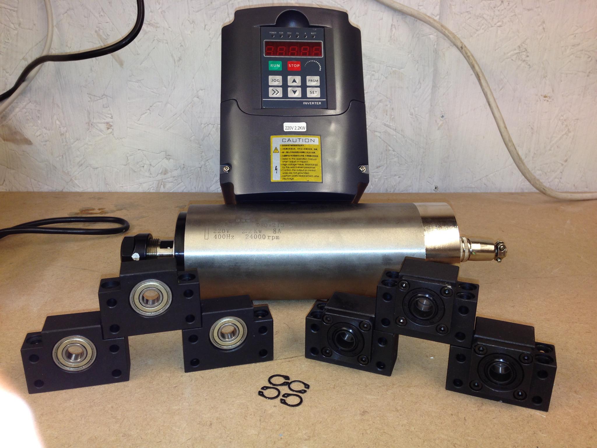

more goodies as expected the bf/bk blocks did come with the spindle and vfd
Attachment 7630
and heres a shot with them all together
Attachment 7631
