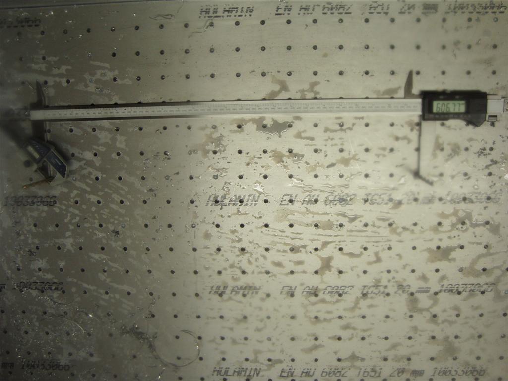

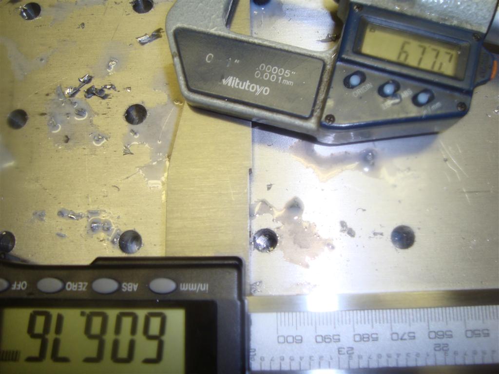

Won't go there regards stalling/racking has it's all been said.!! But there is more to this than just Stalling motors racking gantry's.?
The Main reason why I like it is Synchronization.?
My machine never loses position and the two ball-screws are synchronized exactly the same today has they were when first installed.
I don't have to worry that on long Jobs the machine will lose sync has the slaved steppers drop the odd step here or there running out of sync with each other slowly racking the gantry.
Don't have to worry that after 10-12 hours cutting I'm going to find that holes aren't where there supposed to be.!! Or the part isn't actually square after cutting profile out because the gantry slowly racked fraction of degree.!
The only way to ensure slaved steppers stay in sync is to either have very accurate Home switches or Home to hard stop and do it often. Certainly after every Job to be safe.
Even then if motors are tuned anywhere near close to the edge, esp regards Acceleration, they can easily lose steps without realising on jobs just a few hours long.
On Jobs that run non stop for 10-12 plus hours like litho-pains this could and has been for some slaved stepper users disastrous often resulting in not just in in-accurate work but stalls thru accumulative error over hours.!
Both work and won't argue that fact but I know which works best.!!
