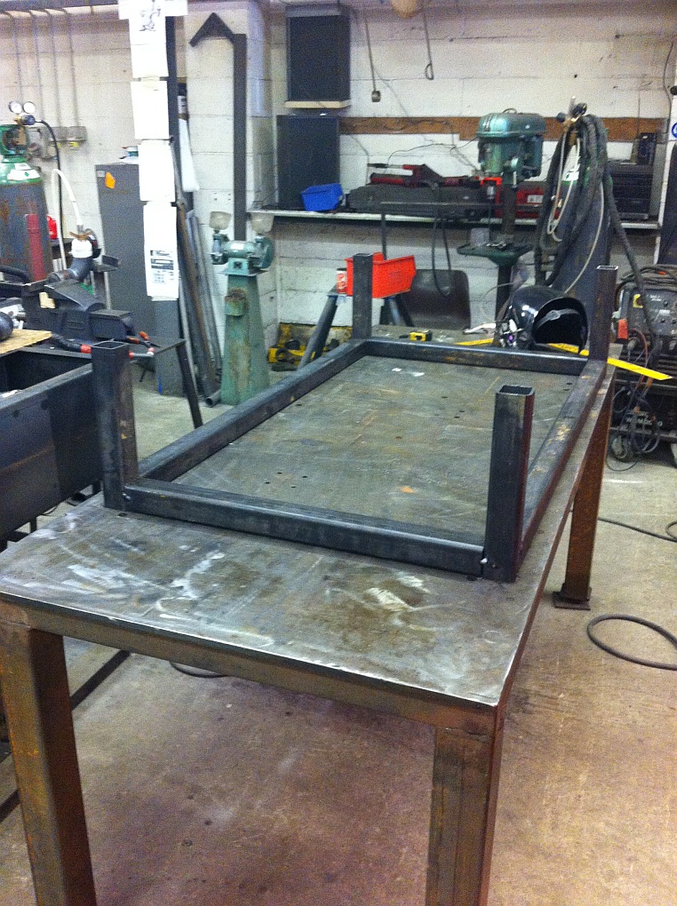

I'm no expert (I seem to weld every 4 years or so) but what I did was cut the pieces to length, dry assemble the uprights and the main frame outer pieces then put either one tack or a couple of tacks on each piece.
Attachment 11529

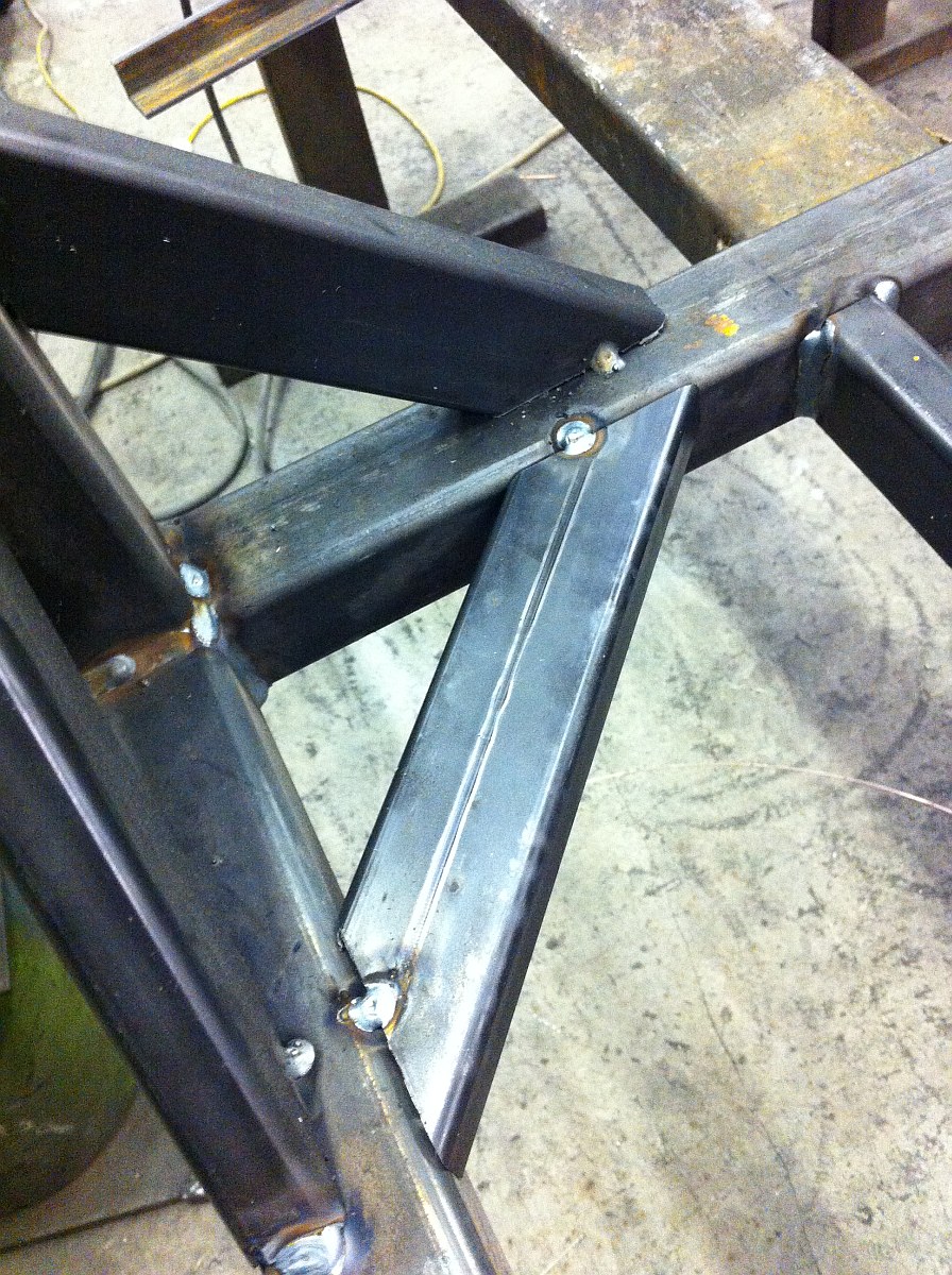

Then I got a square and spirit level and made sure all was as good as I could get. I then tacked in the bed braces..
Attachment 11530
I then checked all was square again before starting to add the angle braces...
Attachment 11531
I then checked that the uprights were still square and all was good and then started welding the uprights. Now here I confess I didn't do it in small short runs spread out round the frame like I probably should have. I just did it in one or two runs per weld (50mm long welds as using 50x50x4 box)
Attachment 11532
I then checked to see if all was still square (otherwise the angle grinder would have to come out!) and then proceeded to weld up the rest of the welds. I didn't do it in any particular order (it was pretty random) and then after finishing the frame (but without the X axis rails welded on) I checked all the frame was still level and the uprights were still 90° to the bed.

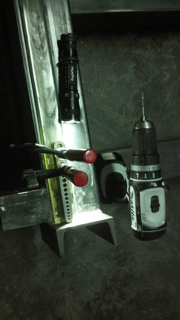

I was tired and working after work. But i wanted and started to feel a kind of satisfaction not being in a hurry and doing things right. So instead of drilling through the clamped hiwin rails, i used a hole transfer tool lightly using the hammer. And a torch, to see better.
Attachment 11546
And as i started to feel that satisfaction, i decided to continue accordingly the process, drilling first 3mm holes, using the very handy tool to keep them vertical.
The torch helped again to see things , illuminating the epoxy from below.
Attachment 11549
Some holes and here is what happened. I had to go for a new drill, as it seems if the drill is not perfect, it adds heat and the epoxy lifts around the hole. Not a big deal, will scrape it with a small straight edge. The epoxy scrapes nicely, as i said-like snow flakes
Attachment 11550
