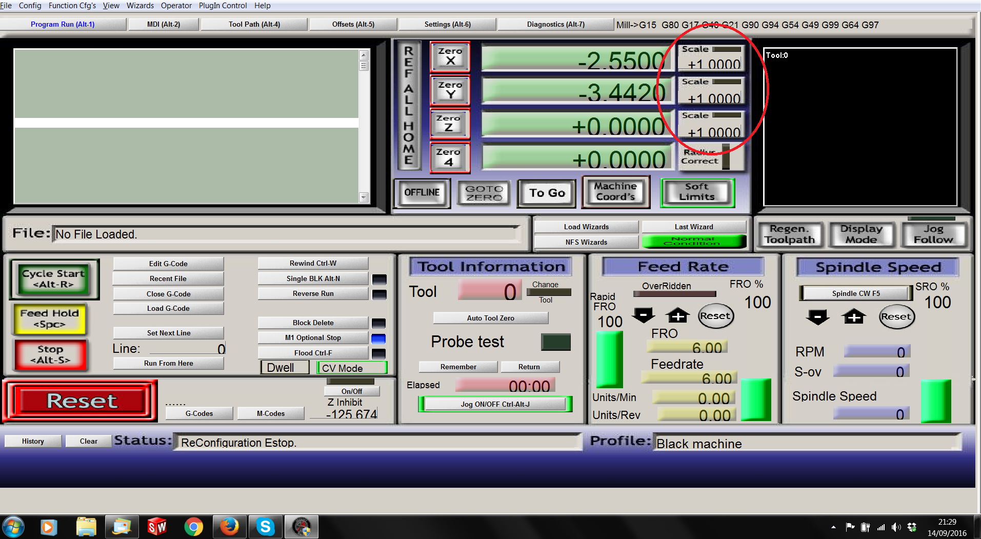

Sure this won't be the case but you haven't set scale factor have you.? If you have the scale LED's will be flashing at you so will be obvious.
Re: mach 3 scaling issue
		Hi.i am looking at the mach3 manual, but it as nothing on scale. In what position are the scale factor leds. Apart from looking at the scale factors, and reloading mach, is there anything else I need to look at. As stated the tool moves correctly when setting the auto measurements of axis. Thanks for helping.
		See pic for scaling location.
To test if moving correct distance use the MDI and command a move. Try this.

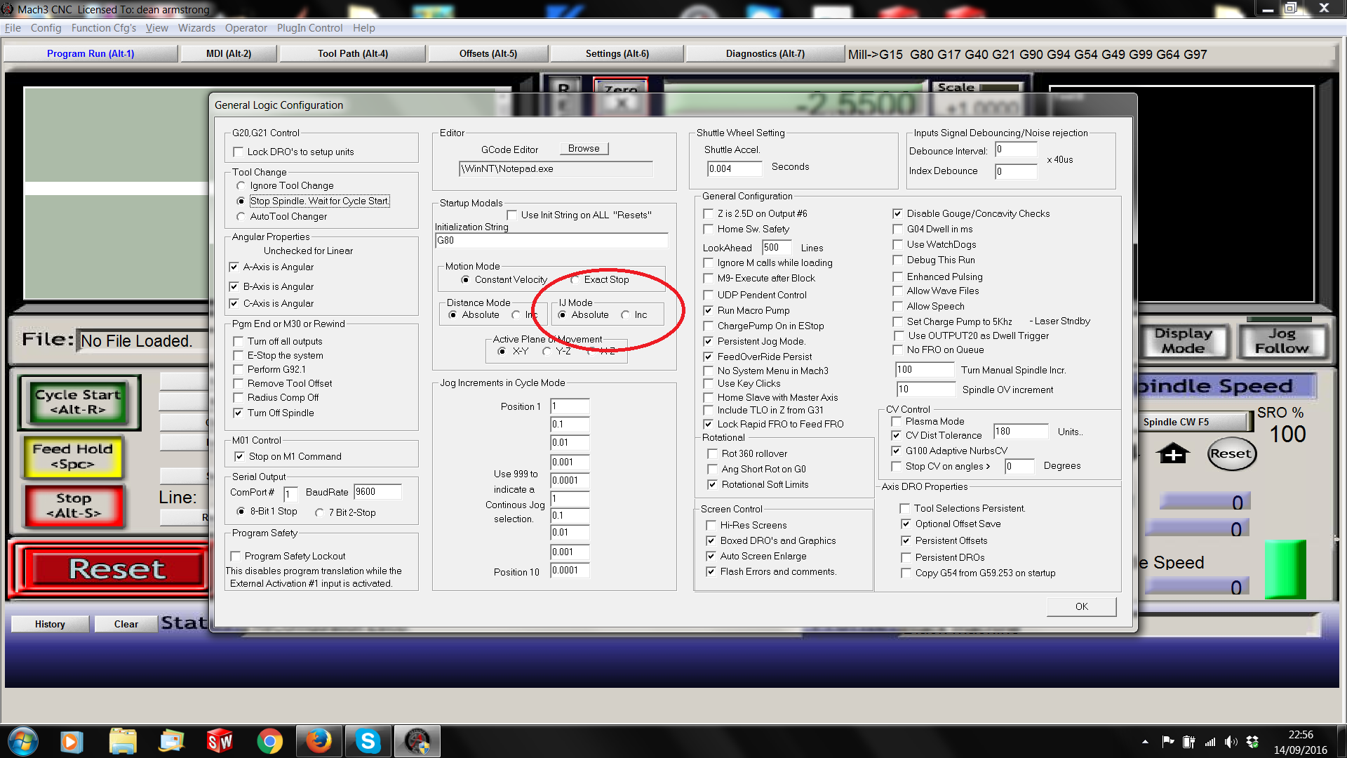

		There is one thing you could try but I don't think it will be the problem but hurts nothing to try.
The code uses IJ mode for the arc moves so could try changing the IJ Mode setting in general config. However usually when the IJ mode is wrong you'll get large circles on the screen.
Go to General Config change the IJ Mode to opposite of what it's set to now. See pic where to find.
Attachment 19197
