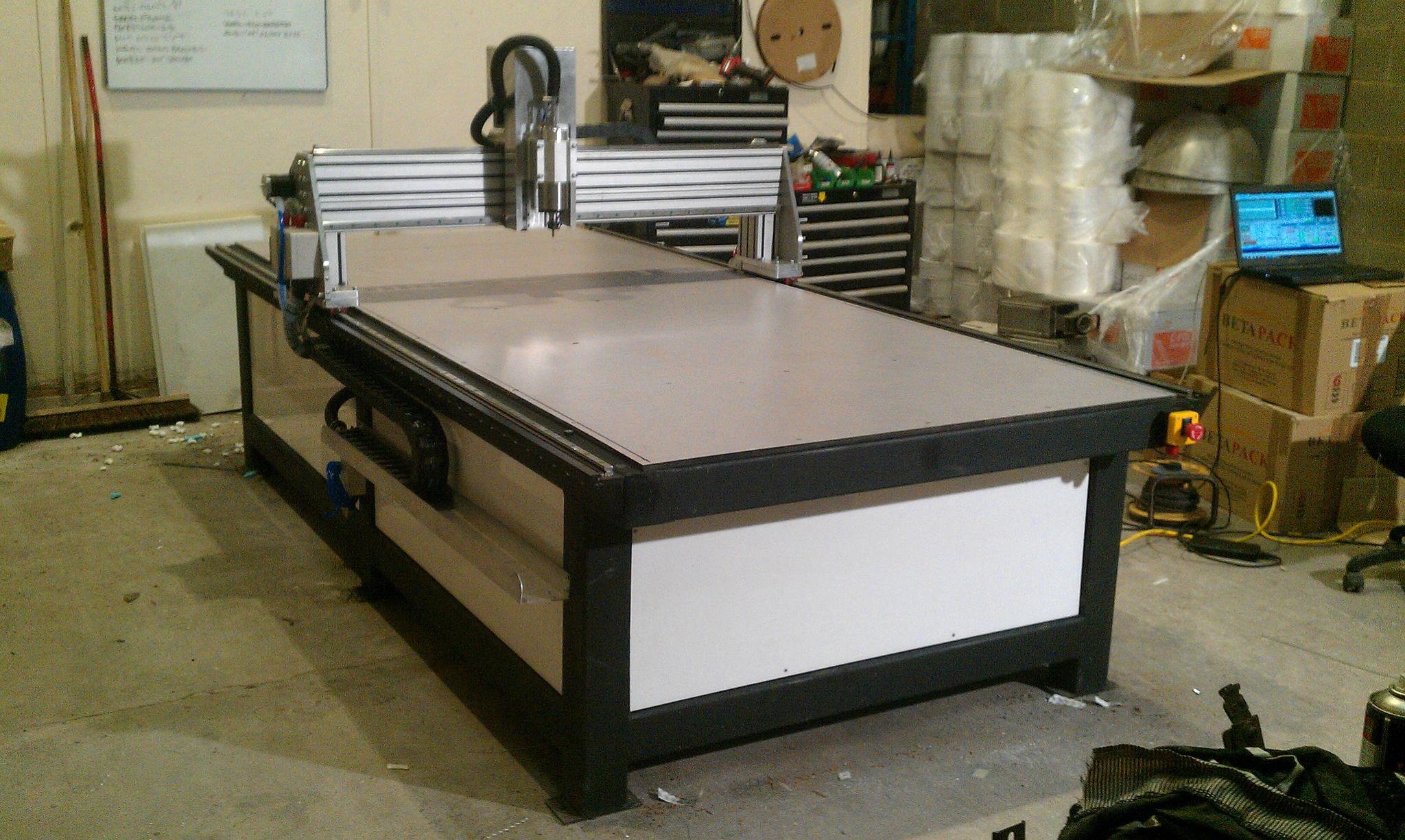

For machine designs there is the fixed gantry style and moving table (which is very rigid but requires lots of space) and there is the moving gantry type which gives a much large working space for a given footprint.
The moving gantry type is generally use for wood working.  This can be split a bit more into frame gantry where the gantry has sides dropping down to the bed:
Attachment 22870
(c) Dean/Jazz
and beam gantry, where the bed is raised up to give more stiffness but can limit access for sheet feeding onto the machine:
Attachment 22871
(c) Clive
On this forum we would usually recommend the beam gantry because of it's versatility (extra stiffness helps for aluminium cutting), but strictly for what you want to do the frame gantry would be fine.

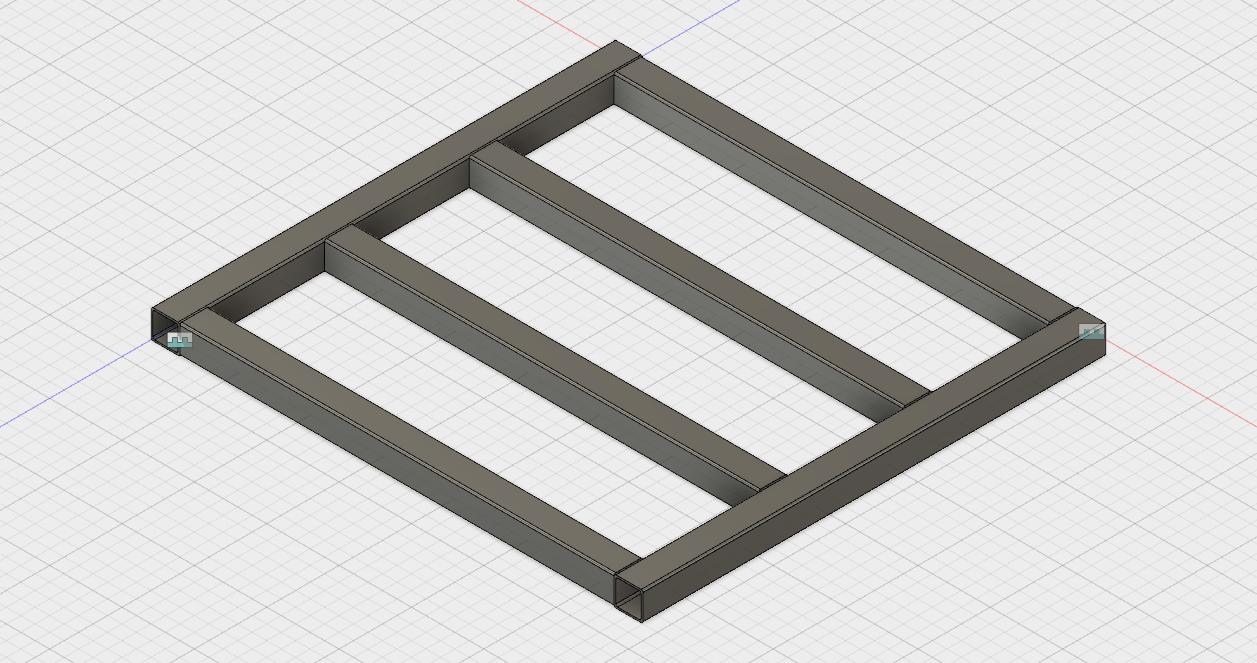

Been slogging through learning F360...whew! Finally got a first shot at the X-Axis base:
Attachment 22882
I said it was a 1st shot... Anyway, here is my thinking:

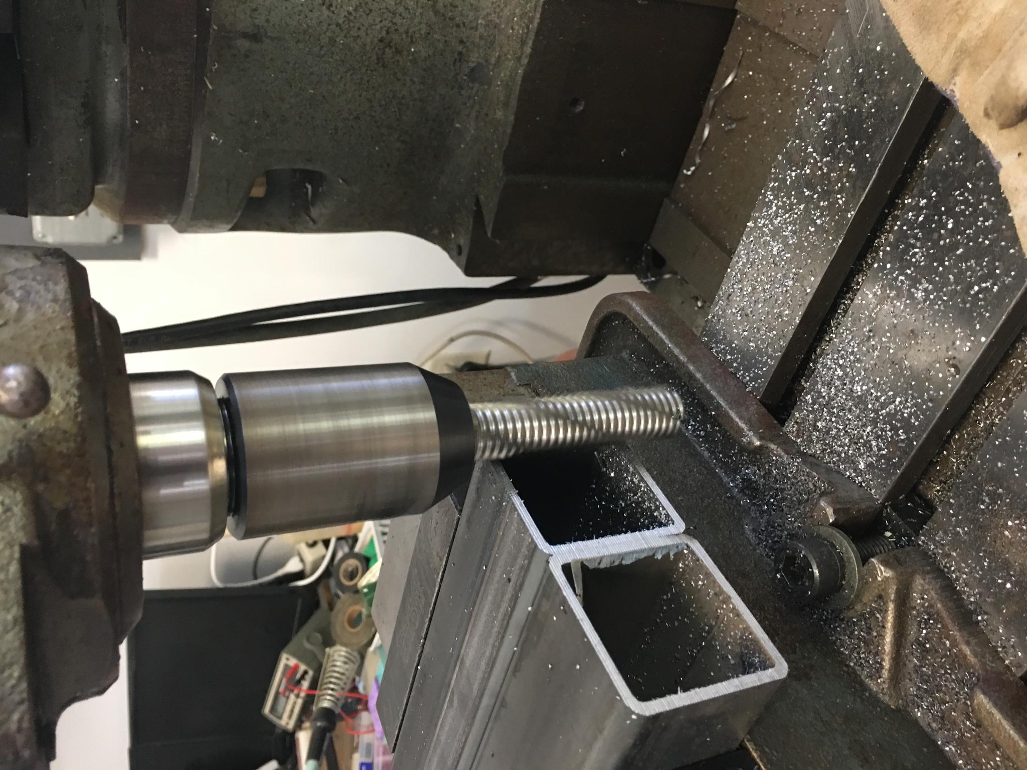

I can cut the cross braces on bandsaw and then use mill to true ends up and make them square and same length. Then, I have a really nice Strong Hand jig to clamp them at right angles to side beams. I was then thinking of mounting linear profile guide rail on sides.
How much of a shot do you think I have of getting the 2 side beams parallel and coplanar enough that I won't have binding? (If I am even explaining this well enough to begin with) I could mount one side rail carefully, and then rig up a temp gantry to use to get the other placed - then pin it and tack weld.
Also, I jumped the gun and ordered a set of these:
http://www.automation-overstock.com/...W01P63&cat=146
with plans on using them for this axis. Dumb question: is this X or Y?
Thanks,
Wallace
		Re: 1st CNC Router: Overwhelmed - Some advice please?
		Hello Wallace!
How do you plan to join the parts? Weld?
Welding can distort the frame alot..
If you want it to work without binding then you can use epoxy selflevelling  or shim the rails. Shimming might be a big job with much trial and error :)
Skickat från min SM-N910C via Tapatalk
		Yes, welding. My hope is that between the clamp and going slow I can avoid too much distortion. We'll see.
Yes, I've been looking at the epoxy options. I guess I'd move the rail to the top of the beams for that.
Thanks,
Wallace

		After carefully milling end to be square and make pieces equal length, I can tell when clamping them up that, distortion or not, there's no way these will be flat and square enough. Sure many out there could've already told me, but steel like this just isn't clean enough as is.
There's a shop close that has huge Blanchard grinder and would grind for reasonable price. But, I think if you start grinding on this stuff it's going to spring all over the place as stresses get relieved.

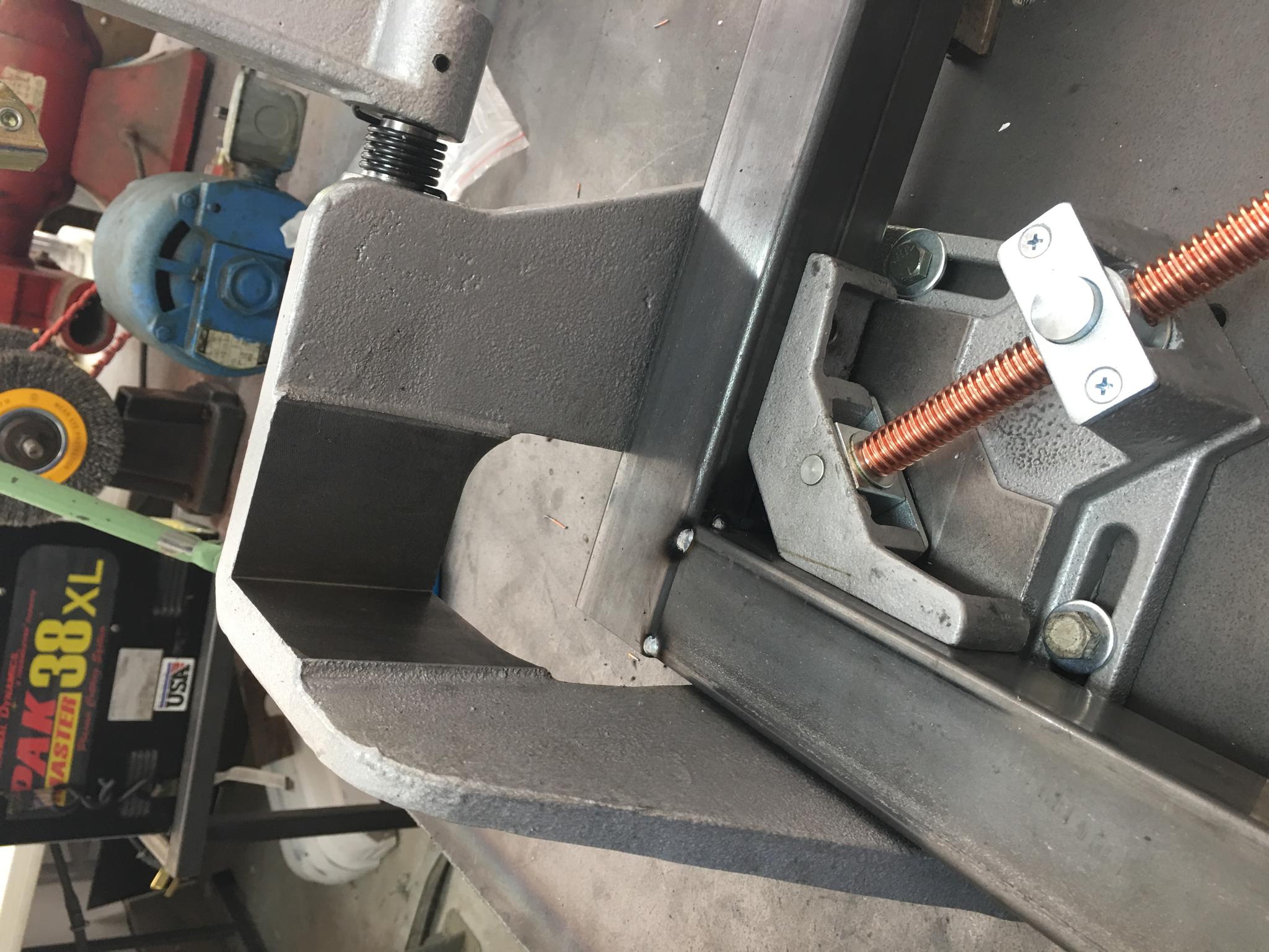

		5 Attachment(s)

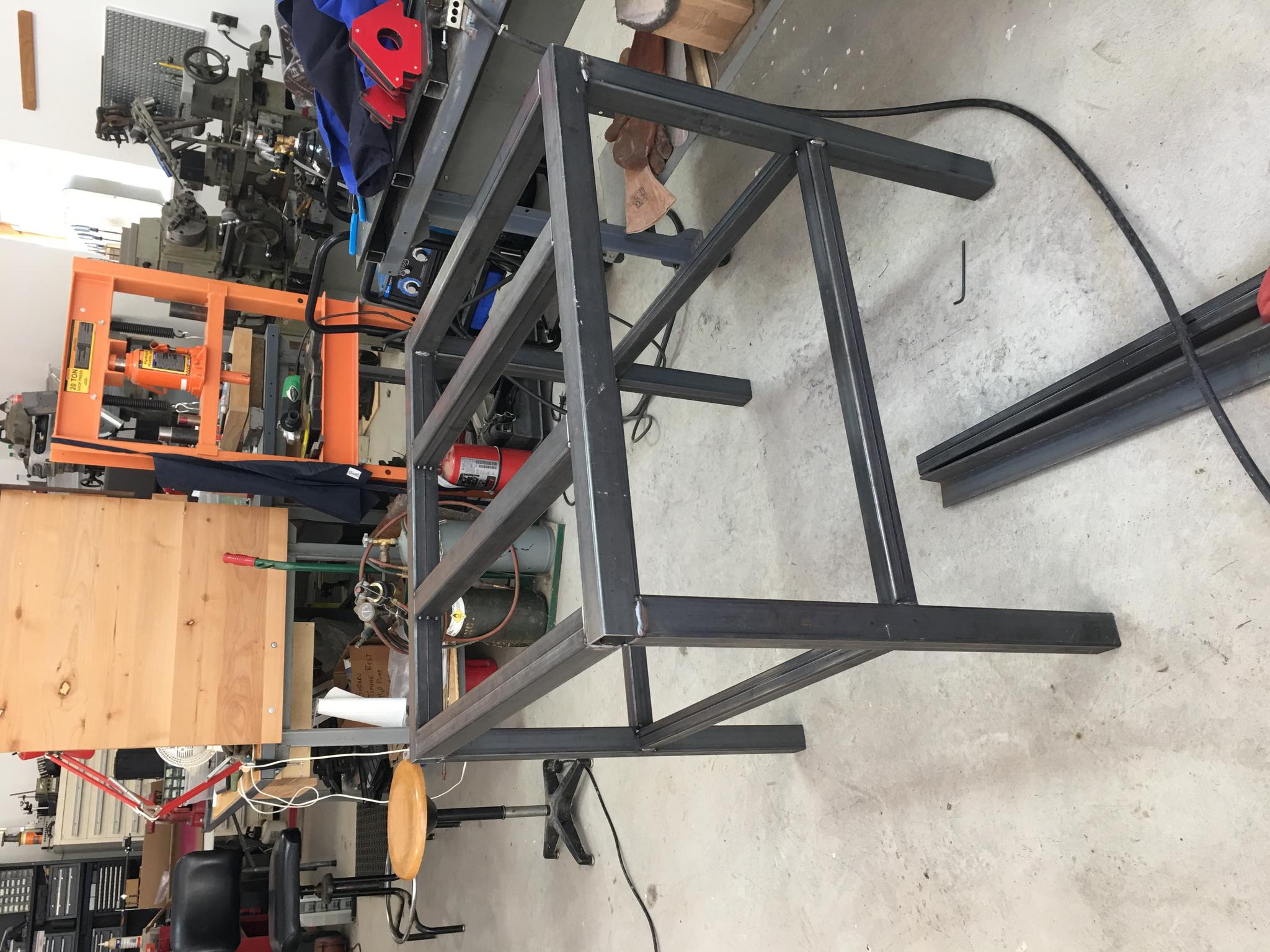

		Welded up the base and added legs.

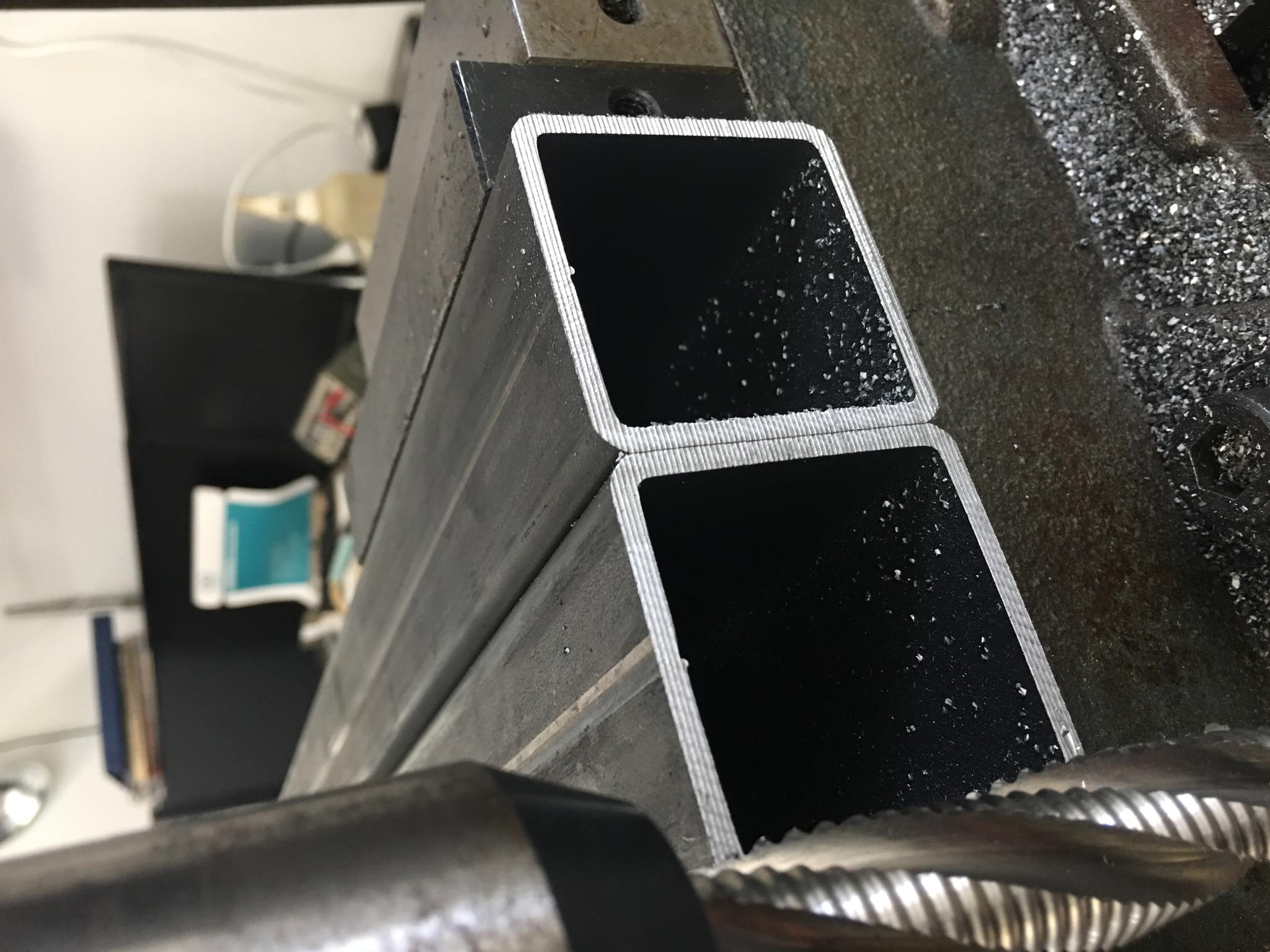

Milling ends to be square and even:
Attachment 22898Attachment 22899
My Strong Hand jig. Very handy for getting things square:
Attachment 22900
So, here's where I'm at now:
Attachment 22901

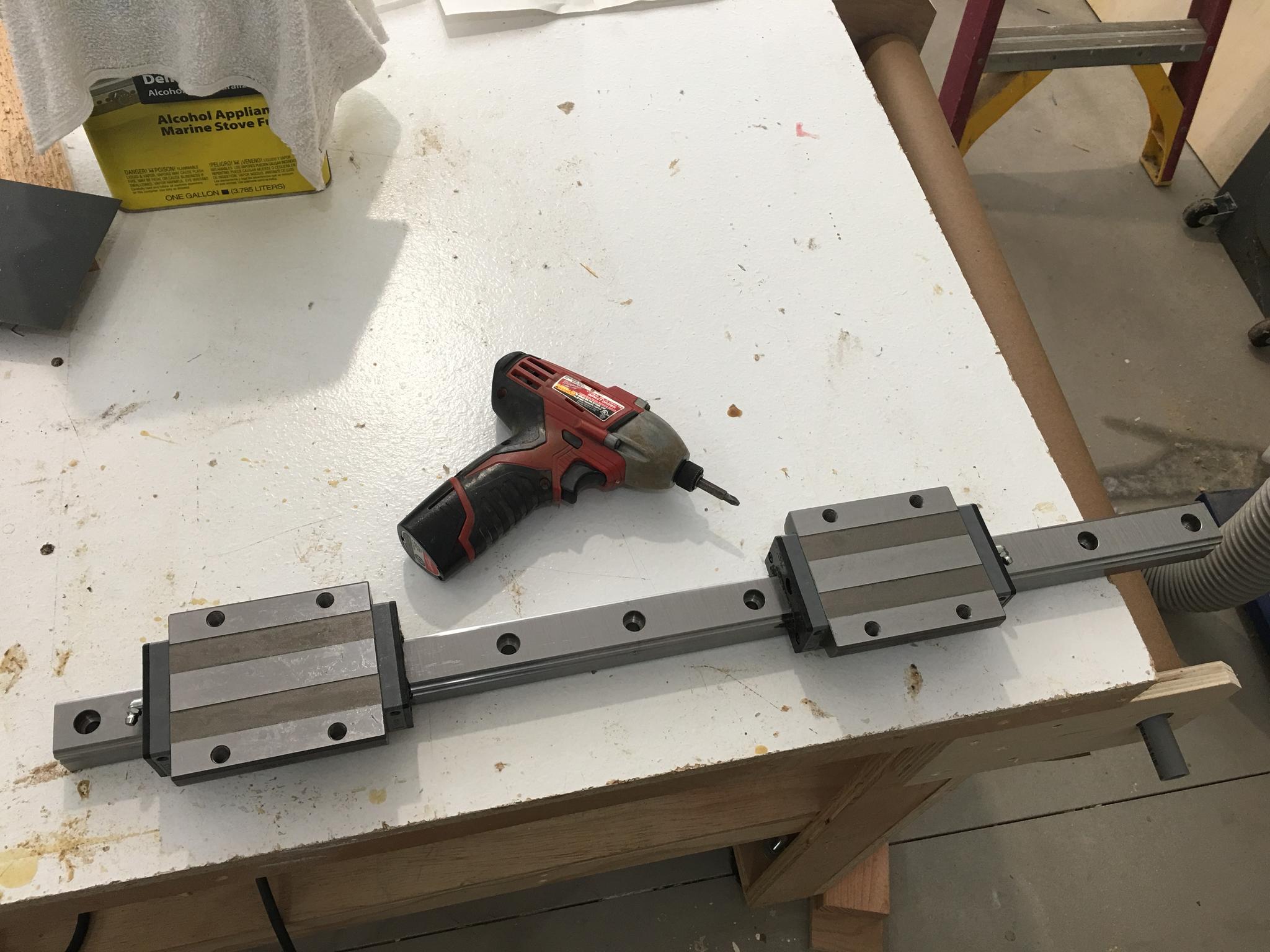

Got these for X (Y?) axis. They are 35mm NSK and 756mm long:
Attachment 22902
These things are beasts! Weigh about 25lbs. each.
So, here are my next decisions. Any advice appreciated:
- Putting another 2" square tube on top of existing ones for added stiffness. I can either mount rails on top (using epoxy to level), or mount rails to sides and use bolts for tubing to provide adjustment for parallelism. Leaning towards welding tube on and using epoxy...
- Using only one of the trucks per rail. Given the size of these, would that work?
All for now. Thanks!
Wallace
