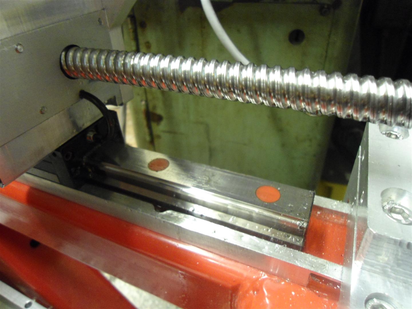

Not sure what fitting they're meant to take, but in the recent build I just made my own adapters to fit in the thread (M6x1 in my case) and routed tubes to each bearing (and ballnut) so oil can be injected into them. Arguably a bit OTT... it depends how far you want to take it and how easy access would be to the existing fittings.
Attachment 11789
