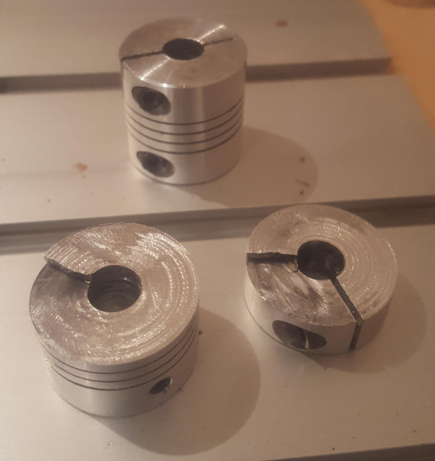

I have just discovered a broken bush on the x-axis.
This is obviously the cause of my problems.
I am very happy that this is a simple fix. The thought of stripping this down is a daunting one!

Re: 6040 finally packed in!
Here is the broken part. I thought it was called a bush but I'm having no luck finding it on eBay when I search for 'CNC bush' which leads me to believe that it's not a bush! Lol
Any idea what it's proper name is?

Hi Kevin
Glad you found the problem.
What your looking for is a flexible coupling.
Thanks again Mike,
Would these work the same as mine?
I notice they don't have the slit/hinge running along the width like mine.
They should be fine as a direct replacement, however I see allot of this flexable type brake in this way, so I would advise going with a "lovejoy" or even better an "Oldham" type coupling.

Hi Kevin
That's a very kind offer.
The coupling in the link locates and is locked with a grub screw, yours just has a different clamping arrangement so it will be fine.
Your coupling will have sheared for a reason, what you need to do is check that the gantry isn't binding for a start, but i would suspect it's probably a slight misalignment of the motor and ballscrew shafts causing the coupling to flex on each rotation and eventually metal fatigue results in a break.
While your waiting for your coupling try and align the two shafts as best you can, if possible shim the motor to suite.
Good luck
Mike
Thanks again Mike,
That makes sense.
I will try to get them aligned as best I can but I honestly wouldn't know how to go about this.
I guess I'd need one of those gismos for super fine measurements. I don't have one but I've seen them used in a few youtube videos.
