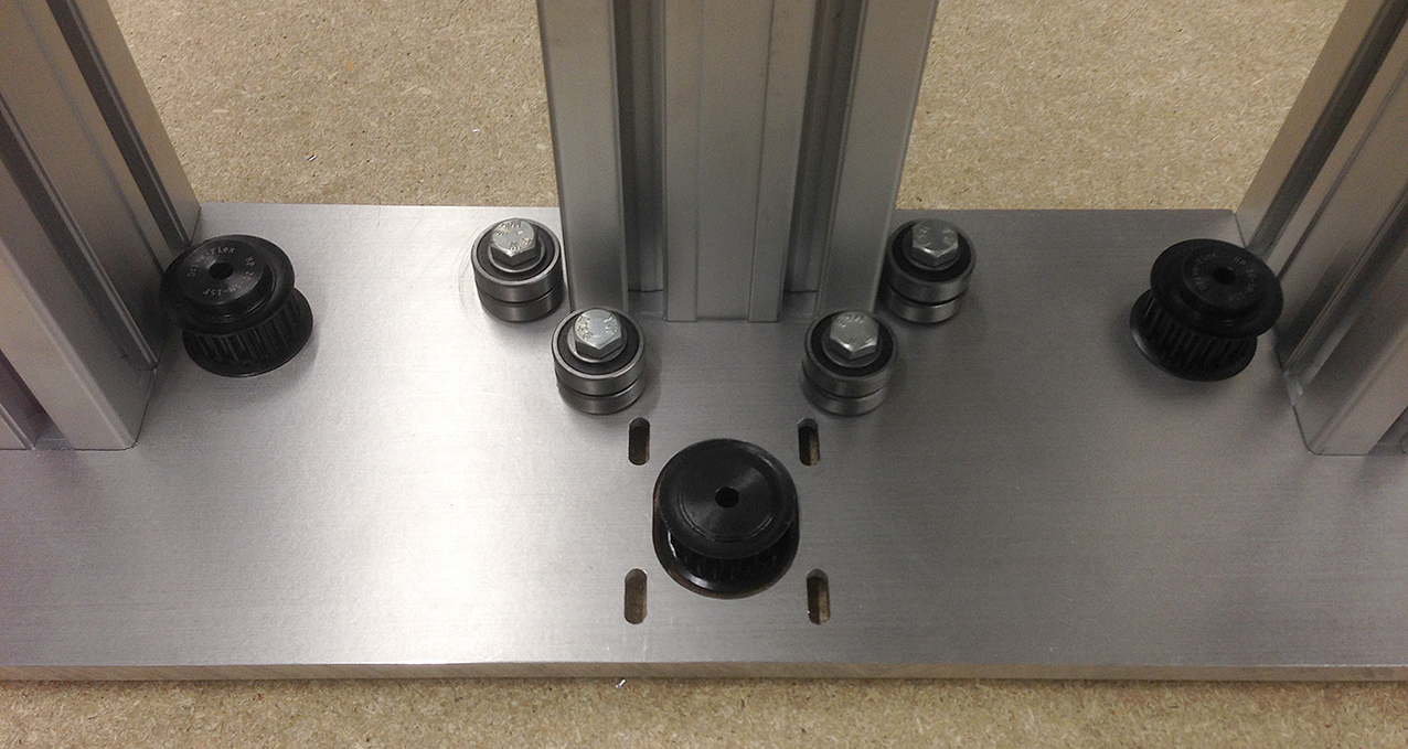

Practically all-aluminium structure, 3NM stepper motors, digital drives, 1610 ballscrews, 20mm HiWin motion, Mach3 control via a UC100 motion controller. Y axis is twin screw with single motor and belt drive via 15mm HTD belt, X axis is single screw/single motor again with 15mm HTD belt. Currently ALL pulleys are 20t 1:1 ratio but being belt/pulley drive will mean I can easily adjust ratios later depending results.

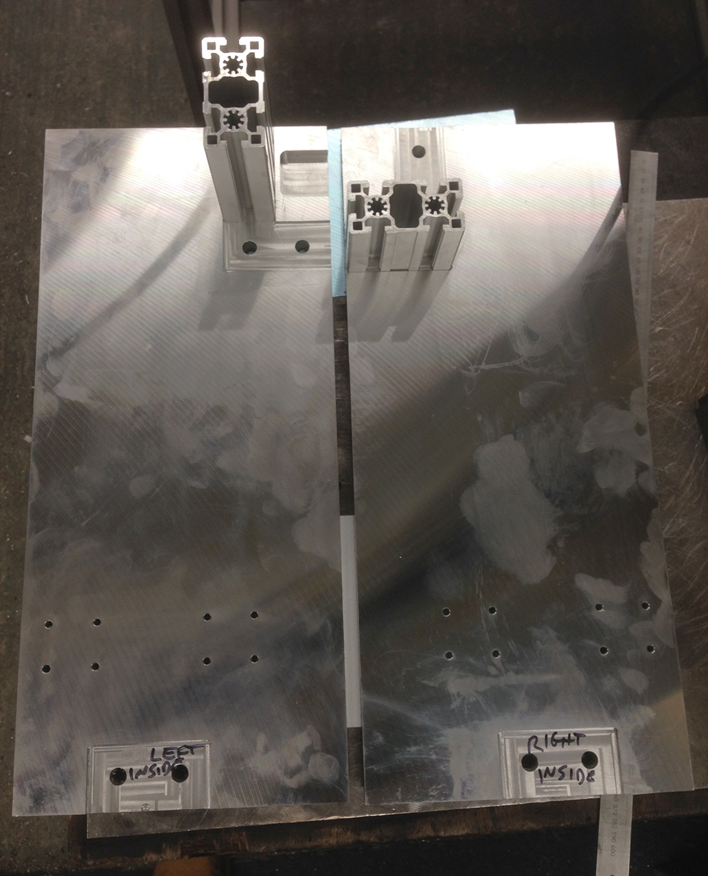

First cuts were made today, started on the gantry support arms...
Attachment 17644
Might not look much but thats two heavy slabs of 20mm ally, my idea is to build and get it running then remove the supports and mill them to the customary inverted L shapes and radius the corners for safety.

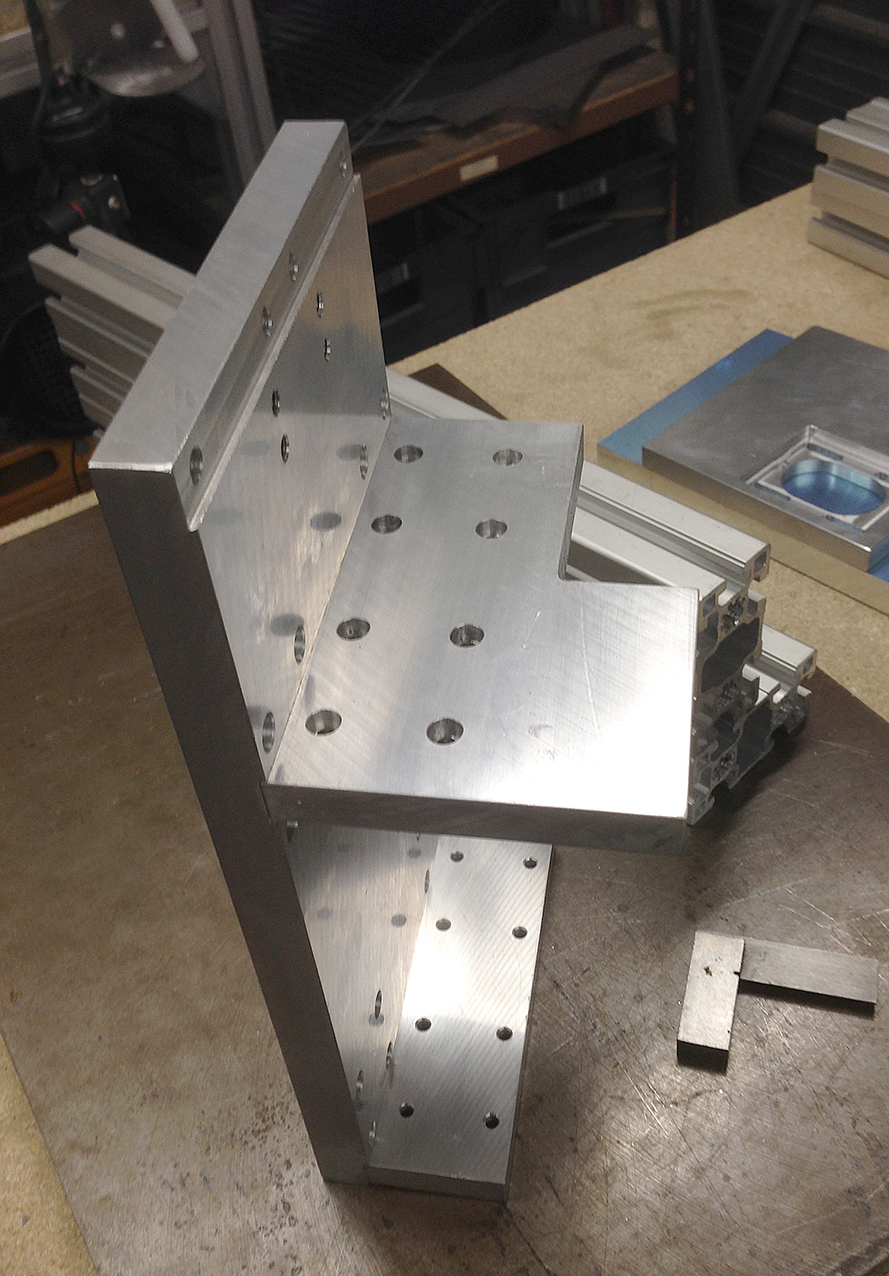

		Bit more...

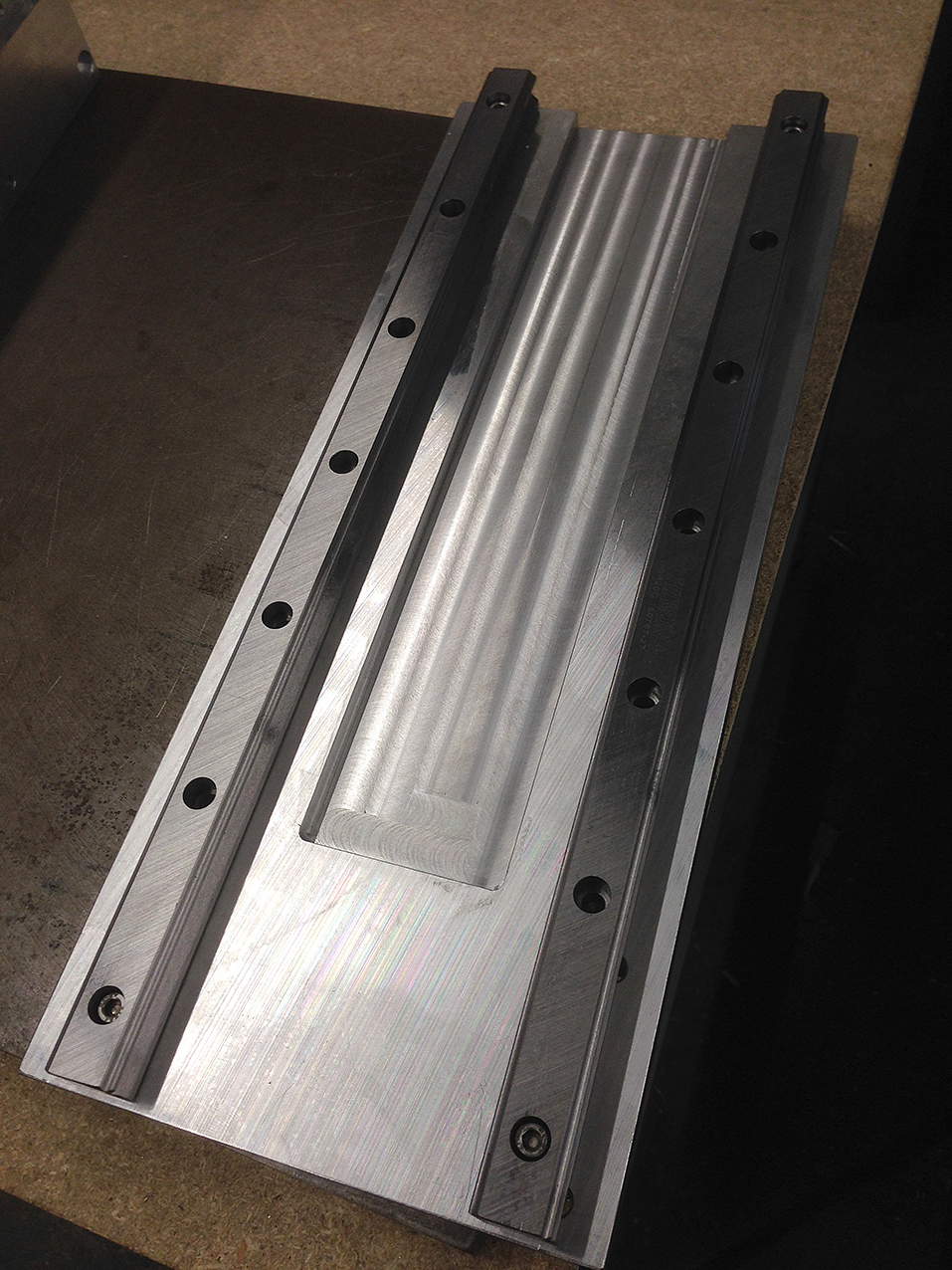

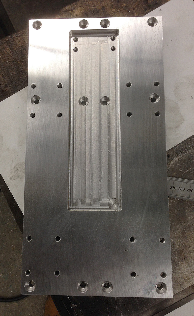

Z Axis front plate...
Attachment 17658
Yes, that is a boo-boo in the bottom right corner of the pocket, what happens when you grab the Z axis handle on the mill instead of the Y axis, D'oh!
Its only about 0.5mm deep so will not affect anything.

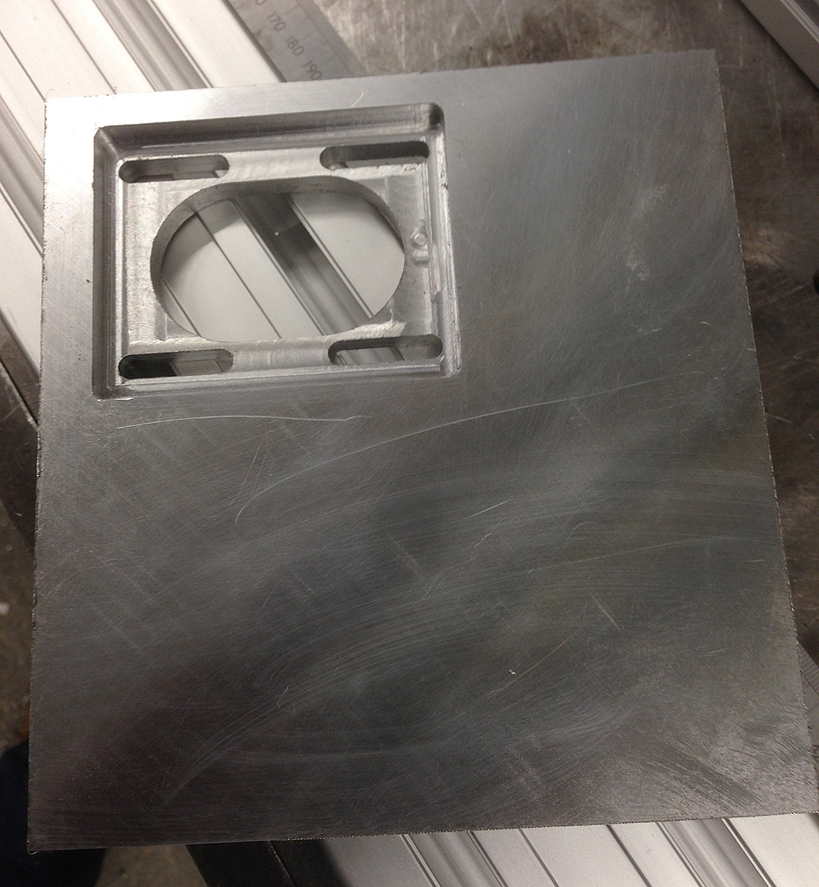

Z axis motor mount plate...
Attachment 17659

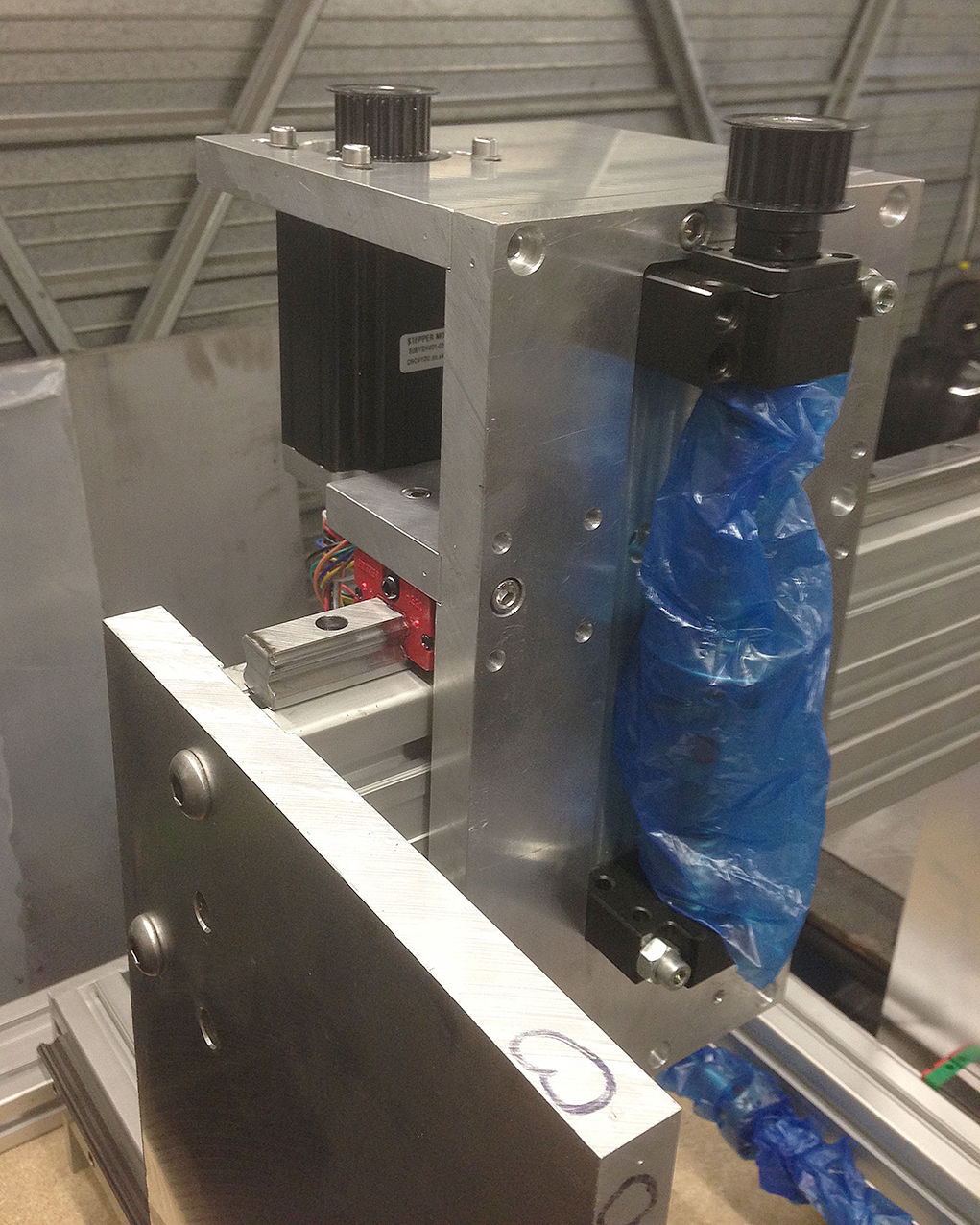

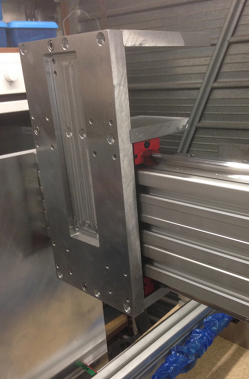

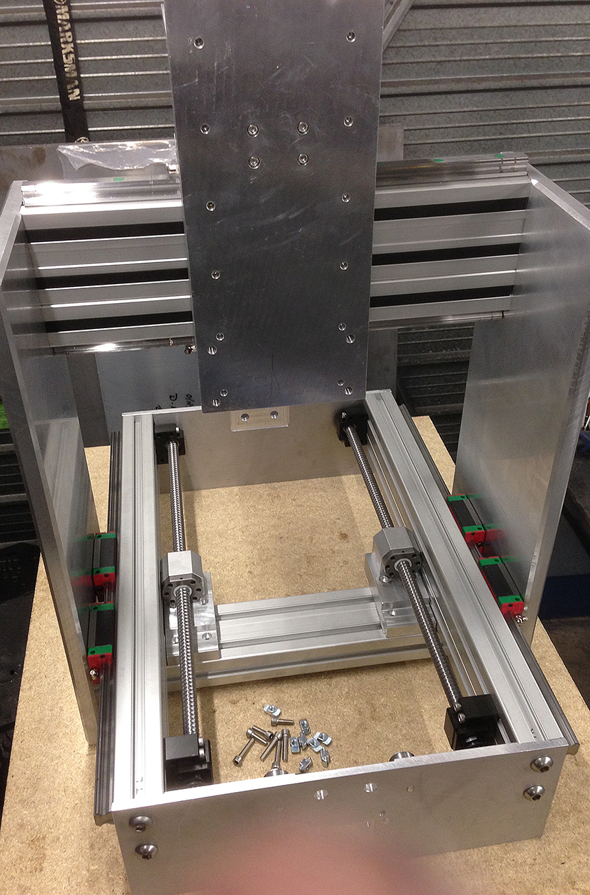

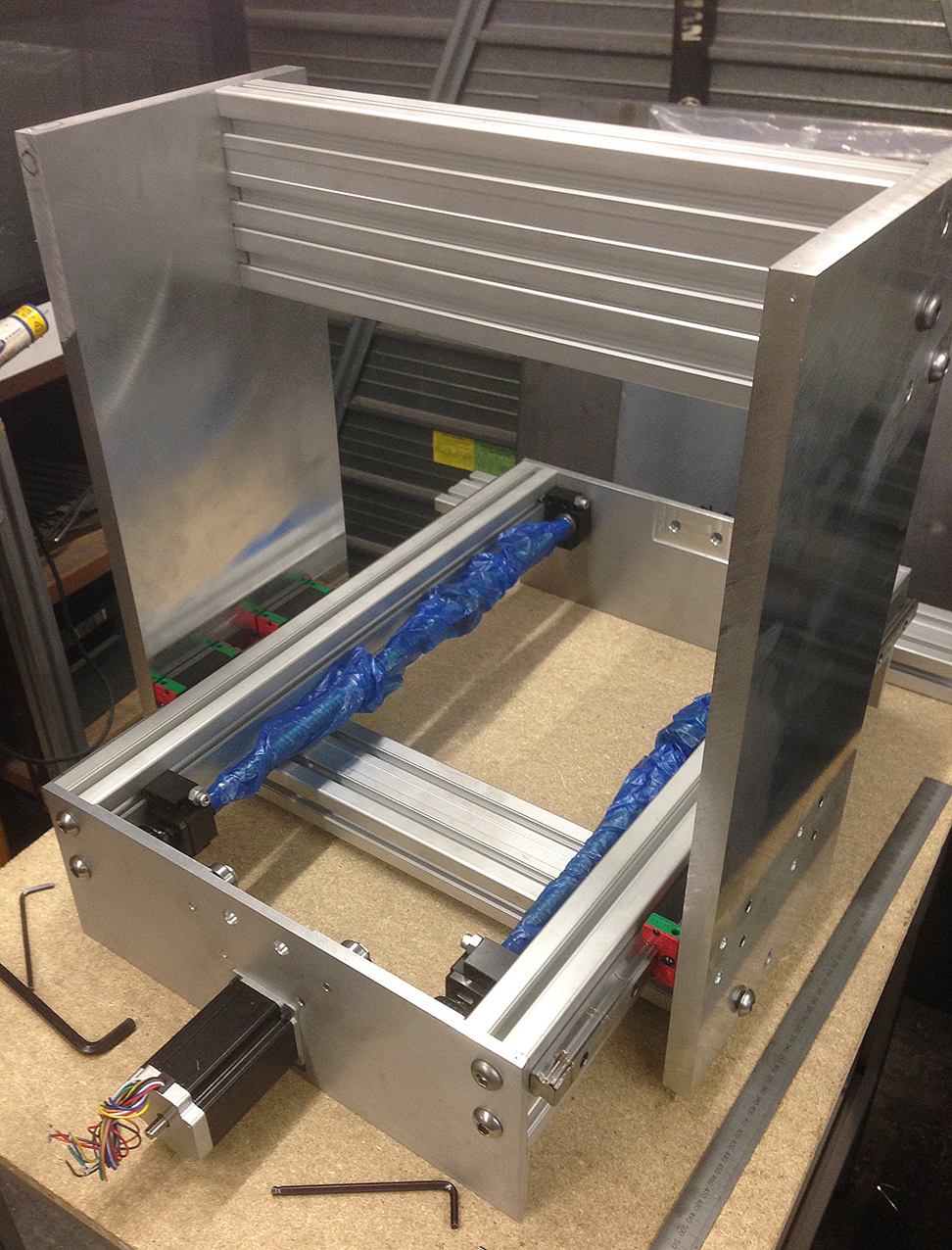

		Little more progress, started getting parts ready to assemble the Z axis...
Attachment 17717
All the motion parts arrived today, along with the spindle and VFD :)

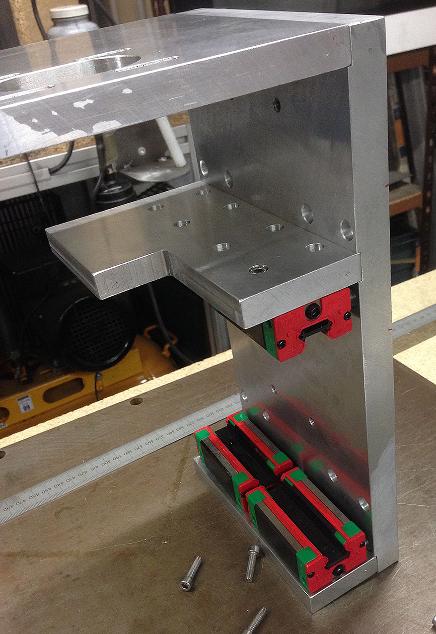

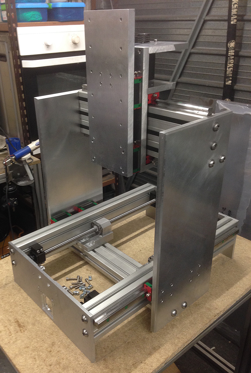

		Looking great so far! In this last picture, will that stick out be for the X-axis movement?
If i may ask a question about the Z-frontplate, that cutout for the Z-axis nut, how thin can the wall be in that area before one can notice any weakness?

		Yes, thats the plan, it protrudes enough to get me over the screw so i can fit a drop bracket for the nut. The cutout clears the Z axis motor body.
The Z front plate and the very front plate where the tool mounts are 20mm thick and needed 7.5mm taken out of each to align the rails and screw. I don't feel that will make any difference at all to strength - the tool mount plate is also reinforced by having the linear rails bolted to the back of it. The rear Z plate is has the Z axis linear carriages aligned directly with the support plates (shown in the pic) for the X axis linear carriages - the forces are transferred directly from Z to X.
Having built two plasma tables out 3mm steel which were still very sturdy, this thing is being built like a mini battleship!

 Thanks, I also think the forces are pretty much directly transferred from Z-carriages to X-carriages. One important task the z-plate also does is keeping the rotational forces at bay, and I agree, 7,5mm less wont make a speck of difference.
I will look over my own drawing and see if I cant do the same.

 I know that one, my Z front plate is 40mm thick...think I only took a similar amount out of that, overkill??!![emoji15]
