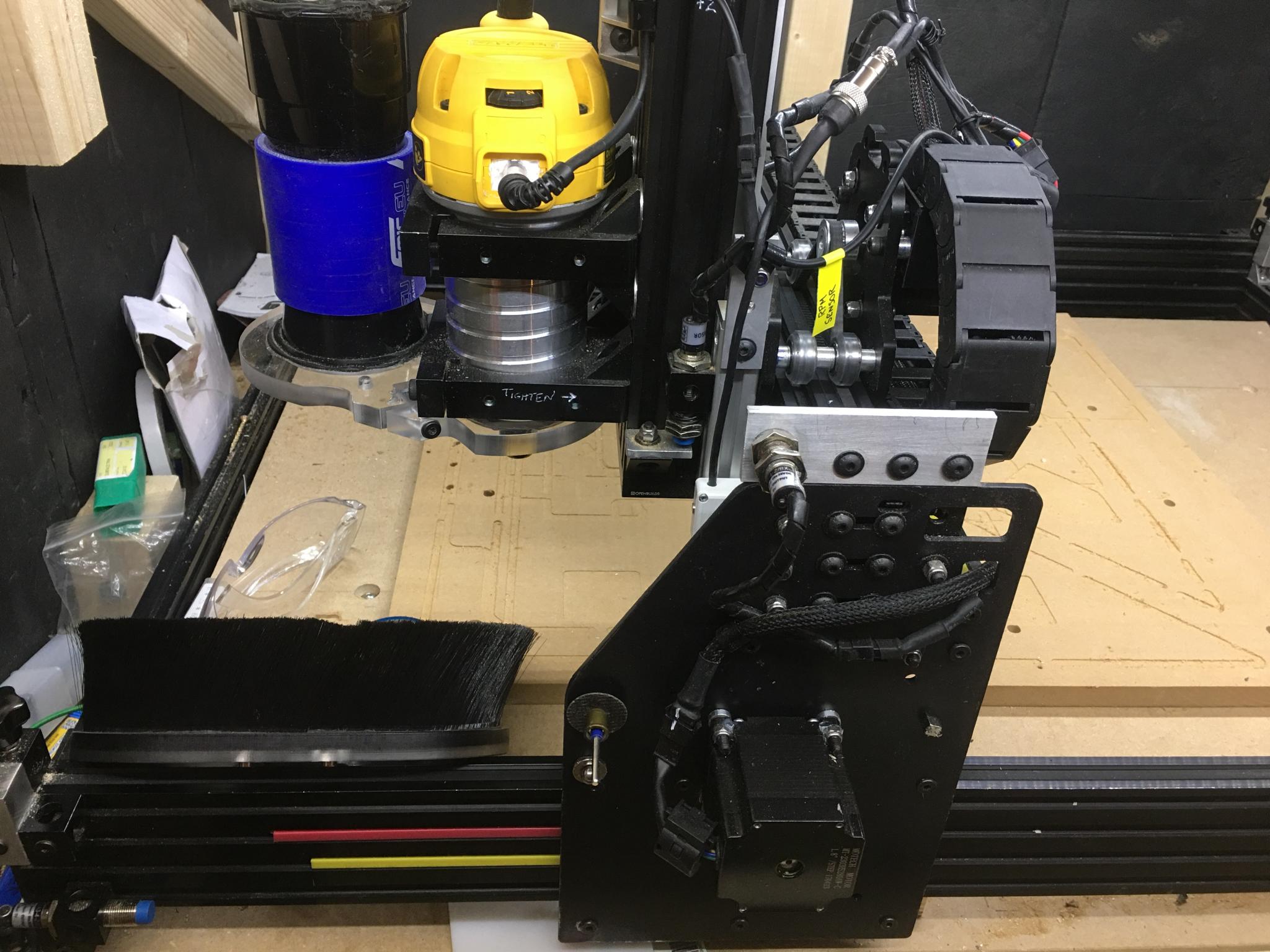

Attachment 27207
That's a closeup showing the gantry. It’s 80 x 40. The side rails are 80 x 20. I altered the stock z axis because it sucked. The replacement is similar to what is used on the Workbee.
I’ve already ordered a water cooled spindle and VFD to test. I’m probably going to replace the gantry before fitting the new spindle though. Might see if I can make the plates for the new machine with my old machine.
What advice I do need is to do with what linear rails and ballscrews to go with.

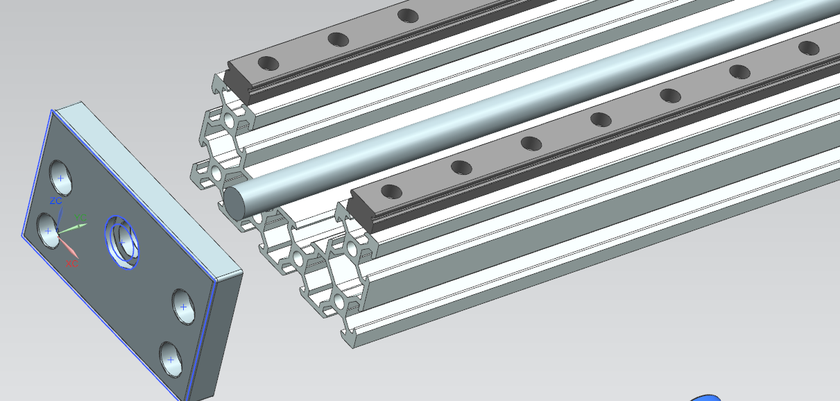

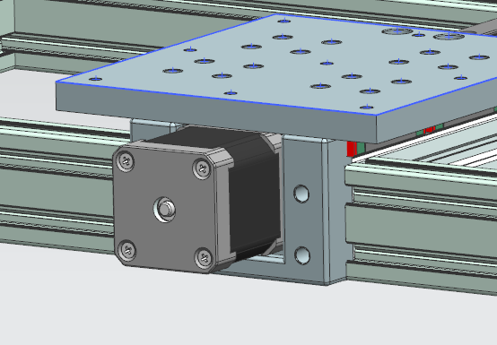

Dont rush discarding the C beam. Take a look at my design for a DTG printer base using that C beam and said linear rails+some 3d printed elements:
Attachment 27220 Attachment 27221 Attachment 27222
This is 12 size Hiwin square, which would happily move 0.8kw spindle. I would say even 2kw spindle if 3 blocks.
But this is not my point. Maybe 15 size and use the C beam like a L shaped gantry. I have never tried it but that's the fun of it, you can figure it out for yourself.

Give me the dimensions of the machine ie: Profile lengths for X and Y axis and I'll see what I have kicking around that could possibly send your way. I've got several second-hand but in good condition linear rails and also some new 15mm Hi-win bearings floating around. I've also got a few ballscrews floating about.
How is the gantry made up it's hard to see from that picture and I've seen them build these things several ways, plus you said you'd upgraded it. Just trying to determine if it's strong enough and best layout for rails. etc.
Regards the Z axis and C section profile and it sticking out a little far then I wouldn't worry too much because if you change to linear rails then the gantry end plates will probably need changing so you can design them so the gantry is offset back a little to reclaim the lost travel.
Give us better pics of the machine from different angles so can see better how to beef it up.

Back to my “upgrade” I’m abandoning the attemp as upgrading it would need me to replace too much. A friend has said he will help me with the heavy stuff if he can have a go at making stuff with it (which I think is a fair trade).
So it’s actually time to start planning a machine from scratch. Spent today looking through water pump requirements as the advice is all over the shop... “use a pond pump it’s the cheapest”... “Don’t use a pond pump ffs”... use a 12v water cooling pump and use a pc dual radiator”... “don’t use small pumps as they don’t pump enough to get it all through the narrow pipe”...”don’t use PVC pipe, use expensive anti microbial silicon pipe”... and on, and on, and on. Made my head spin.
