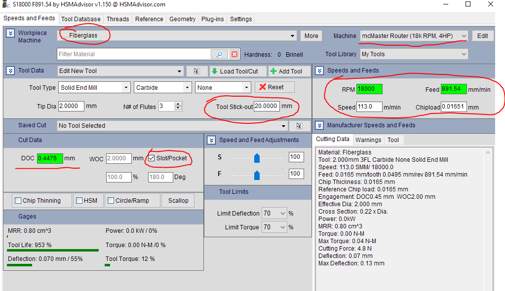

Re: Speeds and feeds for carbon fibre.
I have never cut but should be similar to fibreglass. Take care of the stick out as this severely could change things. I calculated all based on 20mm/ the tool shows 20mm from collet/
Hope that helps
Attachment 18855
Cheers boyan that does help
Ended up downloading an app came back with this info

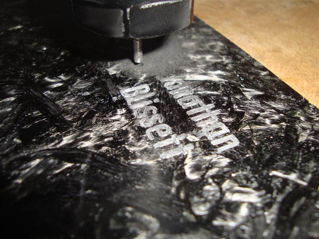

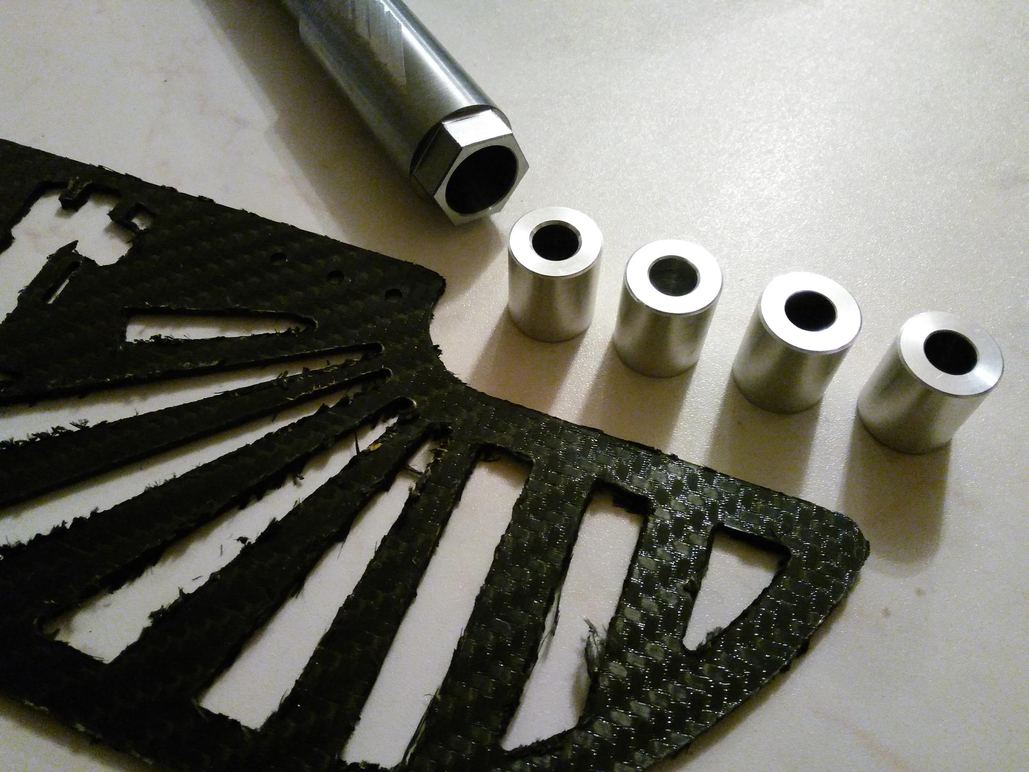

I've tended to use diamond burrs, the type you find in rotary tool sets, for cutting carbon. Even less than 55p each! Here's a recent example:
Attachment 19056
And a not so recent (T-5 years) example (probably already posted somewhere on this site):
Attachment 19057Attachment 19058
I'm still using that keyring - amazed that I've not lost it yet. I'll splash out on the cutters suggested here for the next part and compare...

2 Attachment(s)
Dean jeffery
Deffo splash out Jonathan that carbon looks really chewed up :(
It's just the edges, which as you've noted, clean up well with sanding. I agree it's not ideal.
Attachment 19060
Still, for some things the finish is a little hard to discern in when the part is in use ;)
Attachment 19059
