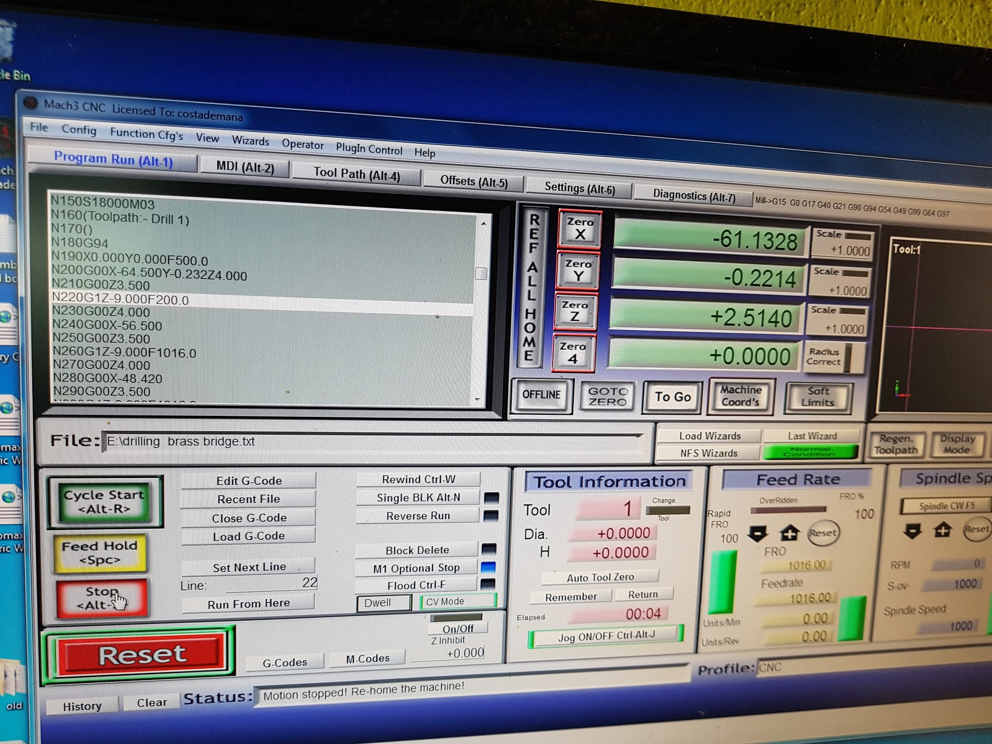

HI,
I am extensively testing the Pokeys57CNC with the hope that price wise it will control all my future creations. As its USB, Ethernet, made in EU and good price, i had high hopes for it.
So far i have only basically wired it to the machine. No sensors, homing and so. Till now i had a couple of minor problems with it:
-Something unclear in the manual about the pullup resistors, tried help in the mach3 support forum, received it after at least more than a week :grey:. Still not clear what value resistor to use. Hello, i am not an electronic engineer :grey: . Ok i figured from other forums 10Kohm
-Had some other positioning problem, at the end it turned i had not adjusted well the servos. Tried support on their web, opening ticket. Received an answer, which did not help me much :grey:. No answer on my follow up question or when i left feedback what the problem was :grey:.
So far so good. Started drilling 500 pieces , each piece 2x15 holes. Just opened a ticket, will see what happens. Bellow is the problem described. I am not saying its not again some mistake of mine somewhere. But i checked the code line by line its correct.
So my questions are:
-who else is using this board?
-any problems?
-support?
-anyone similar problem like mine?
I still have hopes for this board, may be i am doing sth not right. Furthermore i have a couple of them, not just one. The machine moves well, servos are smooth. Just that tiny problem below that made me loose material for pieces which if i have sold, i could have bought one more board.

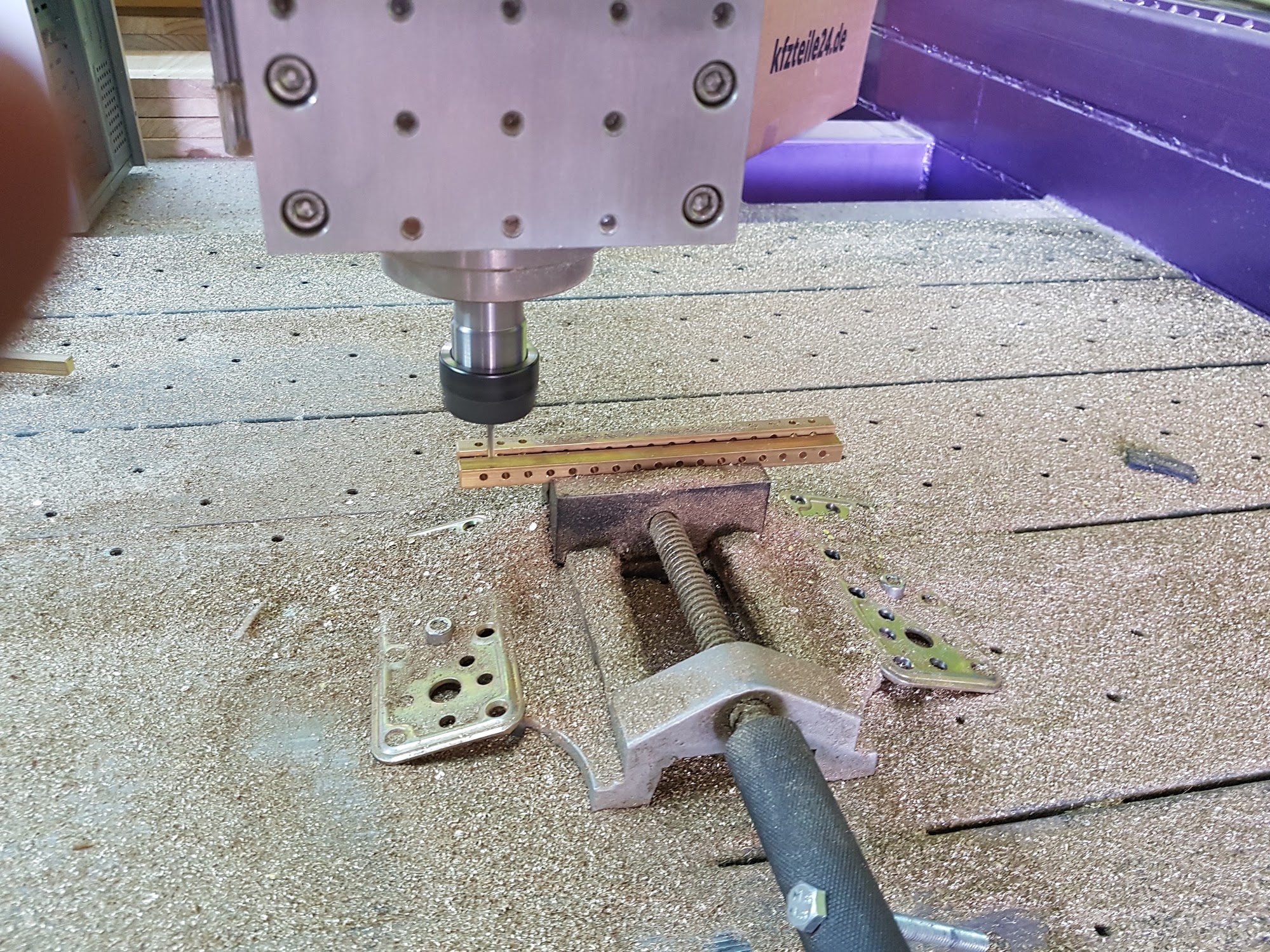

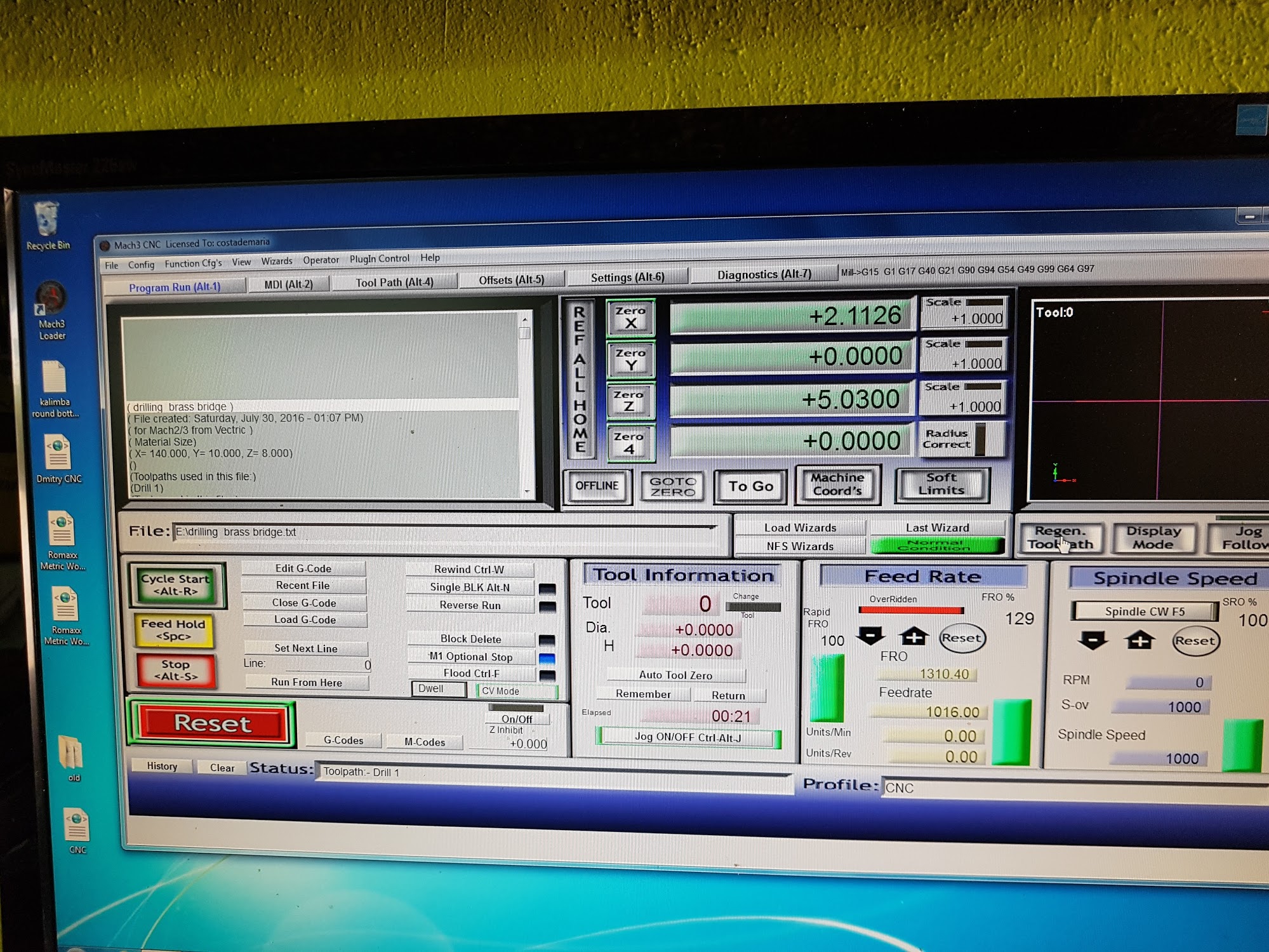

Pokeys 57CNC+mach3. All fresh install, latest all before a couple of months. Nothing else on PC. Second network card disabled from windows.
The problem is very simple. Its loosing X axis position somehow. Program is drilling a horizontal row of 15 holes. I change workpiece and then again repeat. 10 times it does it right. Every now and then instead returning to 0 it returns to ~ X-2, X-3 or X-4mm. I dont see that, push start program button and it screws the holes placement with -2, 3 or 4mm respectively. I rewind, recalculate and start again. Even if i start from X-4, when i recalculate it drills holes right. Until it fucks again the workpiece after 10-15 pieces making exactly the same mistake.
Problem is all happens very fast and i have no time to react to stop process, and even if i do, i am wasting time, which i dont have.
So it seems mach3 knows exactly where the spindle is at all times, just sometimes it does not move it till the right position X0, Y0, and from there on the error happens. So that means its not motor related, its Pokeys Mach3 thing.
I dont know about Y, as i drill in a straigh line and dont have time to make experimens in the Y direction, though looking at the numbers it does not do that mistake, as Y is always Y0 or some fraction like Y0.0033
On the photos below clearly could be seen what i am talking about. Instead of x-64 what the program says to mach 3, its -x62, When program finishes it is x-2 instead of X0.
Attachment 18974Attachment 18975Attachment 18976Attachment 18977

As you see above improper? grounding or just EMI from servos messed things up with my board and it was doing strange things. Make sure you properly isolate it from noise, cables included.
About the parallel, its in the manual i believe.
Take a notice what they say there page 16:
DB-25 (LPT-port) IO connectorWarning: on PoKeys57CNC v1.1 the pinout is not compatible with the LPT-based stepper drivers sincethe physical pin numbering sequence in PoKeys57CNC v1.1 differs from that of a real DB-25connector. Check the pinout diagrams above.

Re: Again Pokeys57CNC problems, anyone using it?
It must have been noise from servos or VFD and improper grounding. That was mu conclusion, though i have grounded everything perfectly fine in my opinion. And still had problems.
yes, 100% you have to EMI protect the Board to Drive wires. maybe that will solve the issue. Try passing a separate wire from PC body to board ground or box ground/ not VDC-/. Same to VFD if you have connected / PC to VFD/. Watch VFD revolutions with spindle turned ON and you will see if that makes effect, speed will rise.

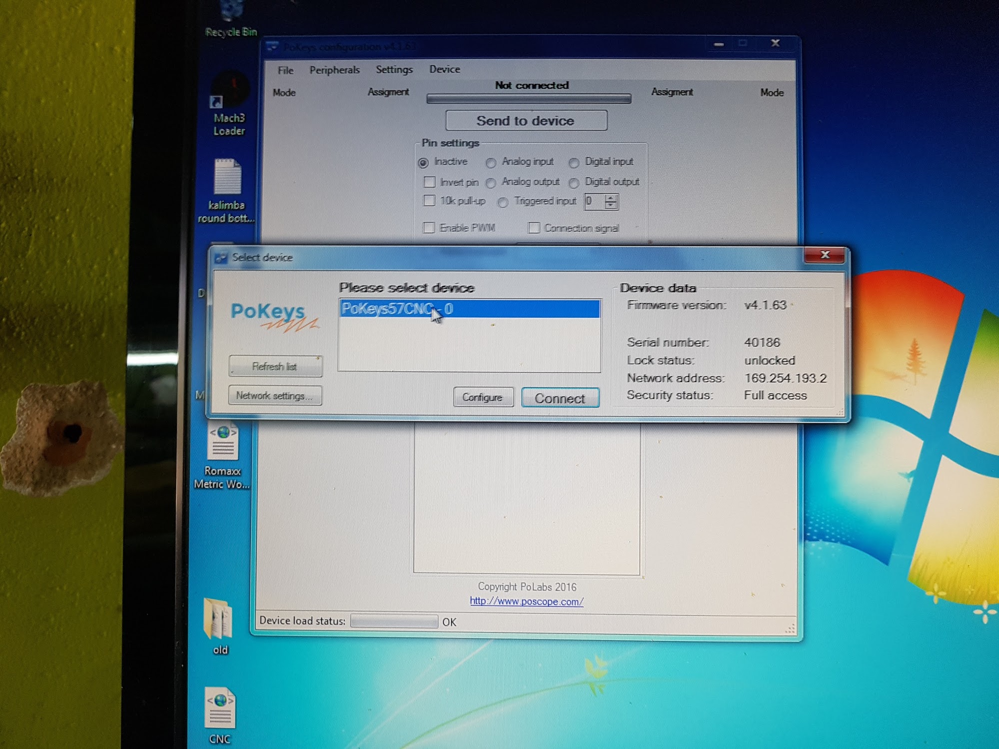

Argh, not getting spindle to work. Do I use Pin 17 for the 'up to 10V' output and then GND as the 0V?
Not sure if I am doing the mapping stuff correctly or not. This is with the Pokeys 57 U, not a bad board thus far.
Ok, got it to start, had to put in a timing value for PWM. It turns but my speed changes dont change the input voltage that is stuck on roughly 3V. Just wondering how my USB powered device 'creates' 10V if there is no external power supply.
