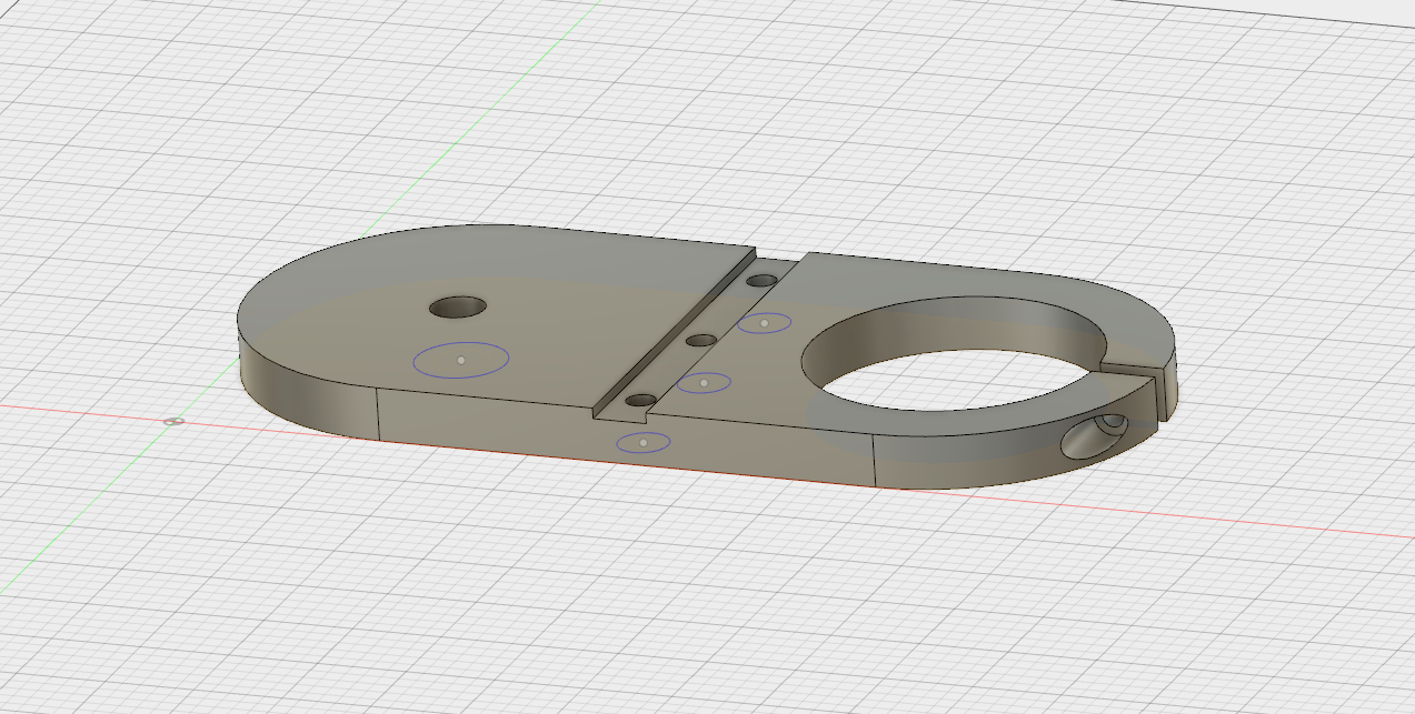

Been playing with Fusion360 :joyous: Sort of come up with a plan for the top plate of my dual-spindle adaptor for the mill. My thoughts are in the machining process...
Steps...
Spot the three holes in the middle,
Drill them through,
Counter-bore them,
Rough pocket out the two big holes,
Finish pass on them,
Questions so far,
should i rough the holes then finish with a mill tool or should I go for the boring head and bore-gauges/caliper ??
I was thinking to then flip over in the vise, mill the slot on the rear face, then flip back, bolt to table on scrap pads through the big holes and do the outer contour followed by the two small slots and a chamfer pass?

Depends if you are making out of an oversized block or plate that is already at the correct thickness.
If using plate I would use a another piece of plate underneath as a fixture, clamp at both ends then....
Mill slot and drill holes(making sure to drill into plate below,
Interpolate two large bores with a slot drill and chamfer
Use a T shaped clamp in both bores to hold while milling the profile.
Then put a couple of pins or drills in the holes and use them to align the part when you flip it over.
Clamp with T clamps again.
Counterbore and mill the two slots that break into bores.

Thanks, not thought about a fixture below with the alignment holes :)
I was going to use precision tooling plate, used it before and accuracy has been good on thickness.
What about bore finish - mill outright or mill rough and boring head? Its a consideration because of the massively different clamping methods needed for a using a boring head.
I don't think ultimate precision is needed, i was allowing +0.25mm clearance on bores, maybe more?

I have been using the tooling plate a lot recently too and have also found the thickness and flatness really good.
I just use another piece of tooling plate as the fixture.
Using a milling cutter would be fine to finish the bore. If you were making a batch I would say use separate tools for roughing and finishing though.

Will use a mill tool, probably change though as the pocket will be ripped with a two-flute and finish passes are better with three or four flute tools.

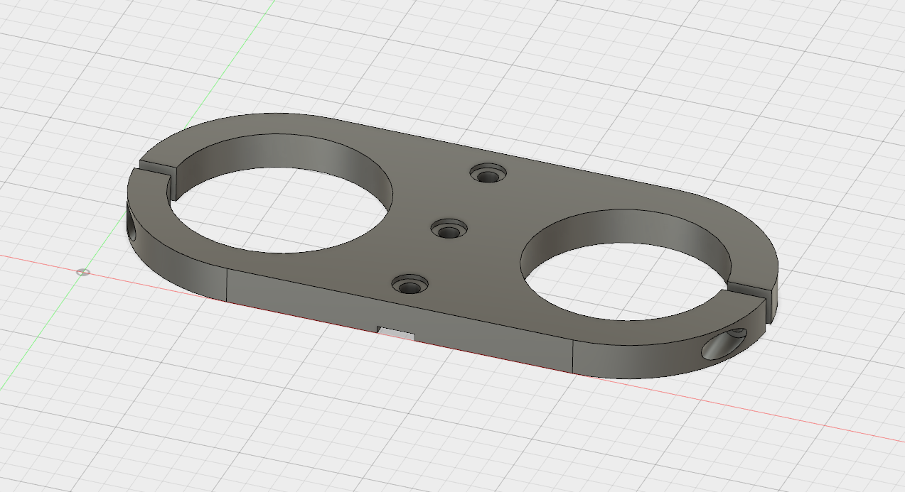

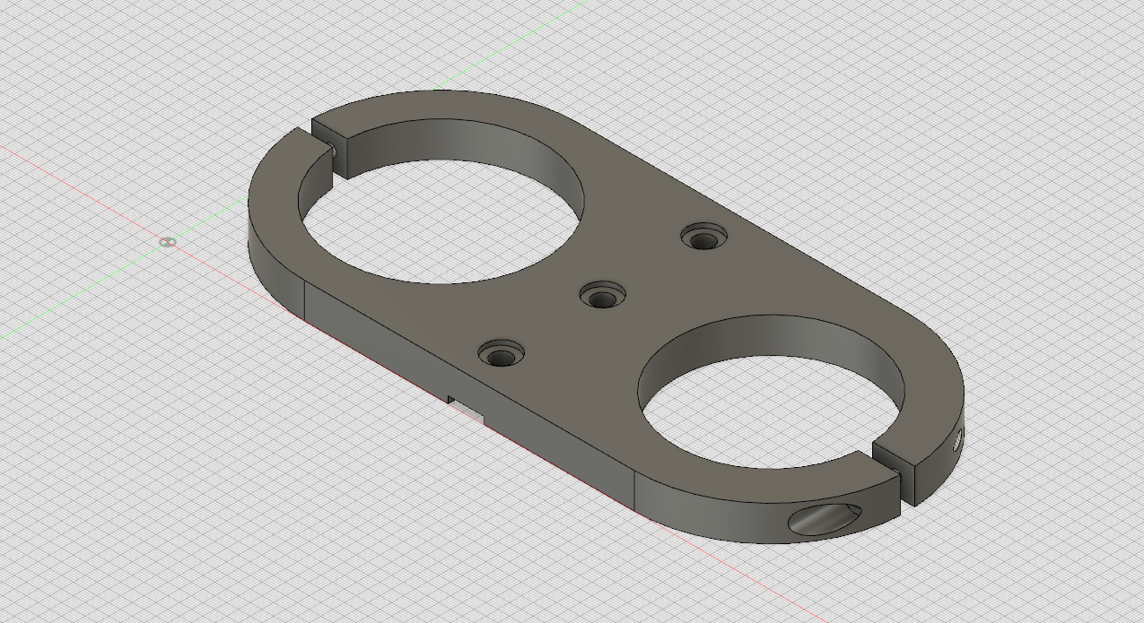

Top and bottom plates drawn, just the spacer block left.
The smaller hole in the bottom will take a 20mm spigot that will lock into an R8 collet in the spindle.

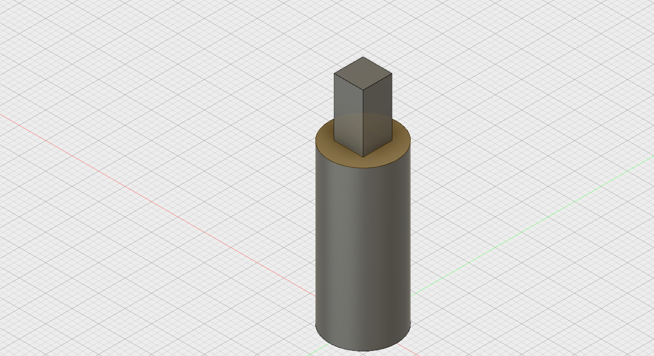

Something i used to make manually in small batches, would use a 5C collet block horizontally in vise, cut one side, rotate 90deg cut next and so-on. The diameter of the tool created a radius at the root of the square part.
Attachment 19078
Gonna have a go with CAM, modified the vise jaws so i can clamp a blank vertically and work round tip using a ball-nosed cutter.
Blanks are 1/2"dia and tip is 5.5mm sq. It also 605m36 steel so slightly harder than plain mild.
I have it drawn up in F360 and worked out the feeds/speeds in HSMAdvisor which gave me 420rpm, 84mm/min on a 12mm HSS tool. DOC is 11mm - 6mm radius and 5mm straight.
F360 wants to take the whole cut in one pass - would you feel happy with that, seems heavy. Although i selected 2d Adaptive, i think its too simple to work any magic on and it seems to have created a standard path.

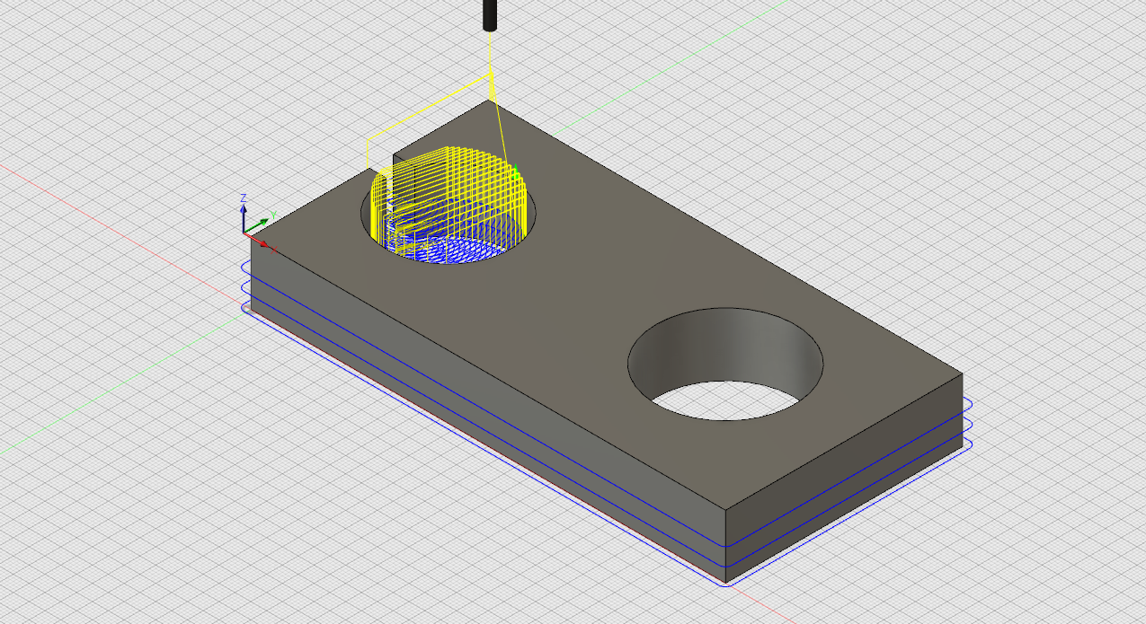

Ok, back to this task, nearly ready to get cutting now :)
Attachment 19100
My thoughts are to fix the waste strips down to table,
set plate square to axes,
clamp plate on top,
mill the slot
drill the three holes tapping size through
drill the part holes to clearance size
tap the holes in the scrap and bolt part down
remove clamps
mill the two large holes
chamfer
mill the outer profile
flip over and bolt down
mill slots
clamp part again
remove bolts and counterbore three holes.
I think that maintains accuracy between the slot/holes and the two big holes??
I could maybe add two extra holes between the three bolts for 6mm dowels if needed?
The bottom plate will be easier as i only have to drill the three bolt holes and maybe dowel holes and then clamp down using the same offsets for the part.
Re: Having a go with F360....
I think you're over-thinking it ;-)
Square your stock and drill & tap the clamp holes manually.
Stick it in a vice on parallels with thin sheet sacrificial spacers on top and machine all the internal features, including slot.
Hang it out of the vice to profile and slot one end outer curve, flip and repeat.

Ok, work holding issues aside, say i have machined the inside features etc and want to create the outer contour...
Attachment 19101
F360 knows the exact size of the raw stock but I'm buggered if i can figure out how to create a path to machine the junk away??
Do you need to draw a box/path around the stock - if so whats the point of putting the stock size in?
You cant select the stock in a process so i cant see its point?
