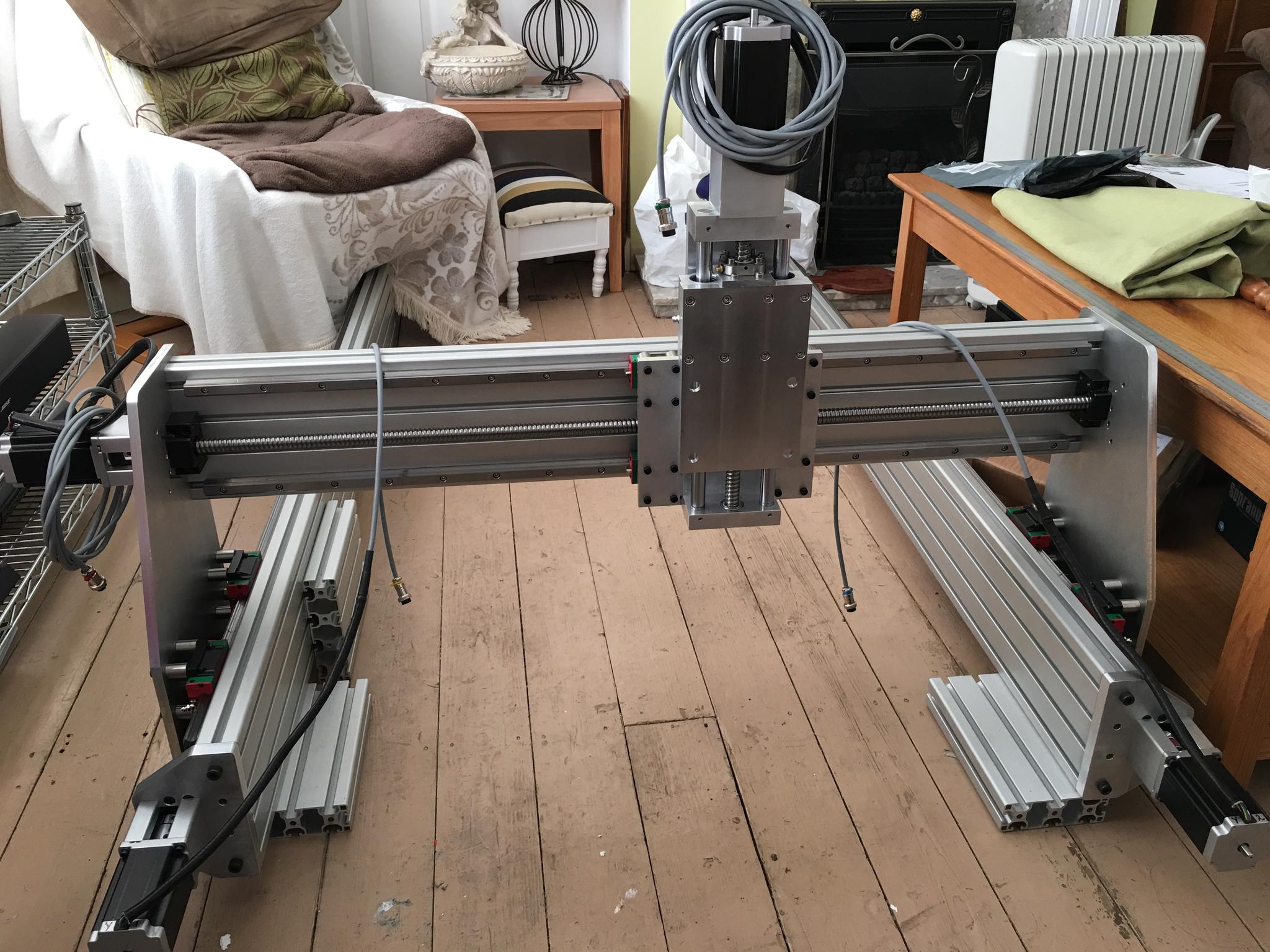

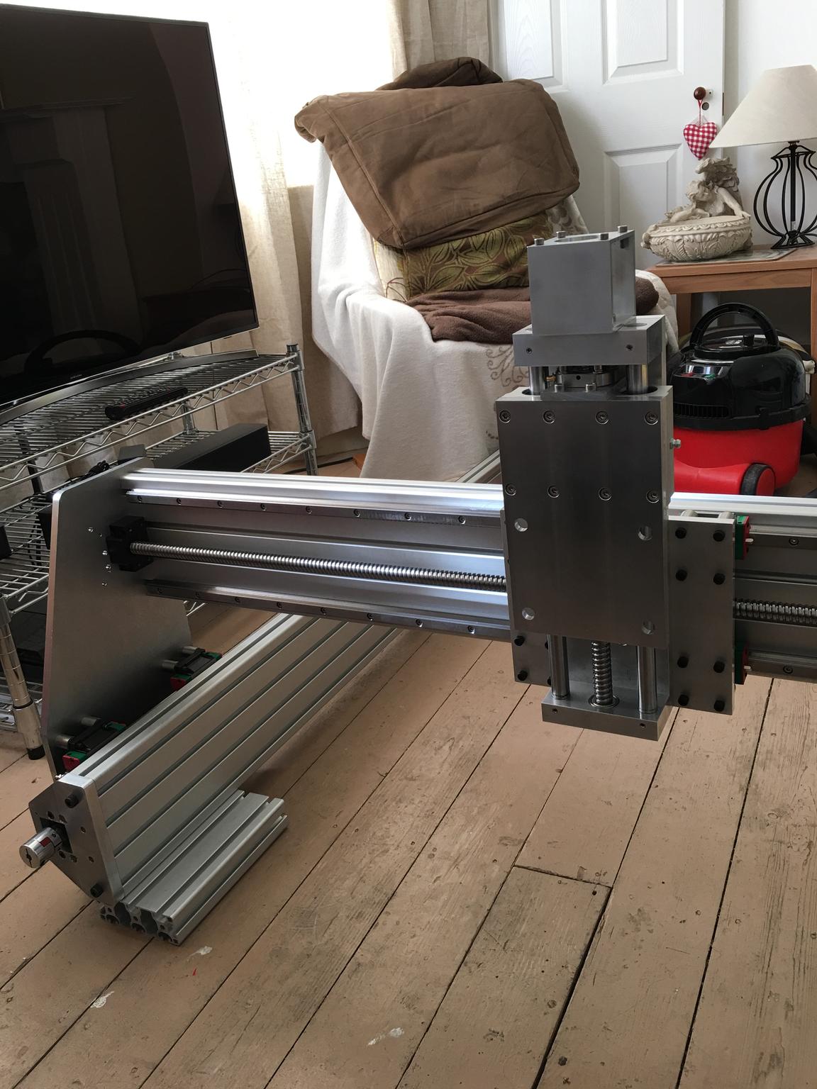

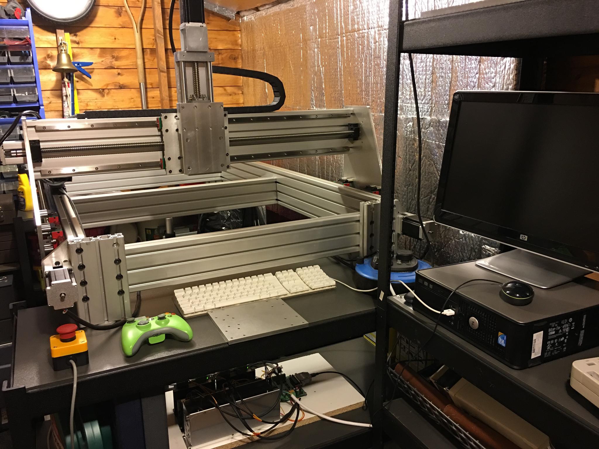

Hi to all thought I would start by showing some pics of where I am in my build so far.
Before anyone asks yes this is our lounge and my good lady is ok with it being there as long as its only assembly work :encouragement:

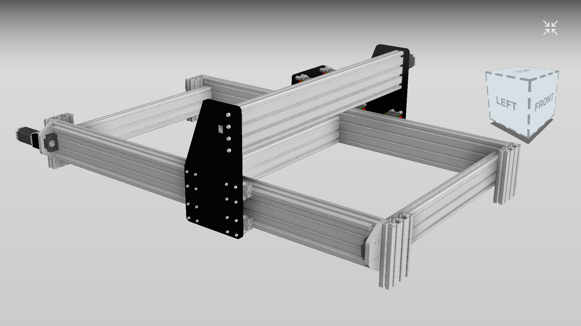

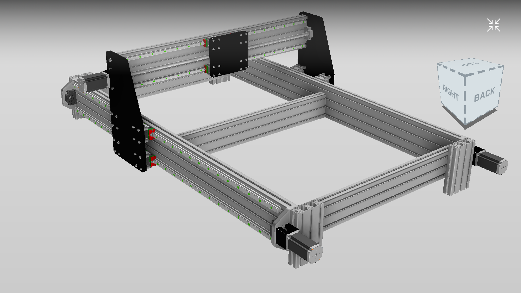

I have inherited my dad's "overkill gene" with the Y axis and X axis having 160 x 40 Aluminium Profile apparently lightweight !
1.5 metre 20mm Twin ballscrew Y axis with 4 Hiwin carriages per side on 20mm square rail.
1 metre 16mm Ballscew X axis 4 Hiwin carriages on 16mm square rail.
The Z axis was a pre made assembly 250mm travel.
Gantry plates 10mm and bearing mounts 15mm and Z axis 10mm mount machining to hand drawn drawings in aluminium cant get to grips with CAD just yet :cower:
Nema 23 4NM motors now fitted
Will add more pics as I go.
