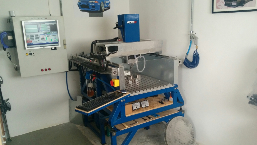

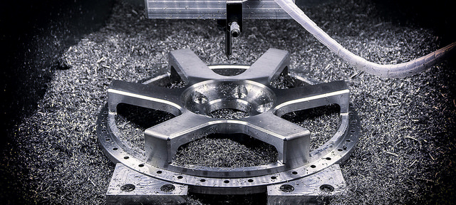

I imagine the machine won't be done 100% anytime soon since there are always some upgrades. Here is the latest pic:
Attachment 19072

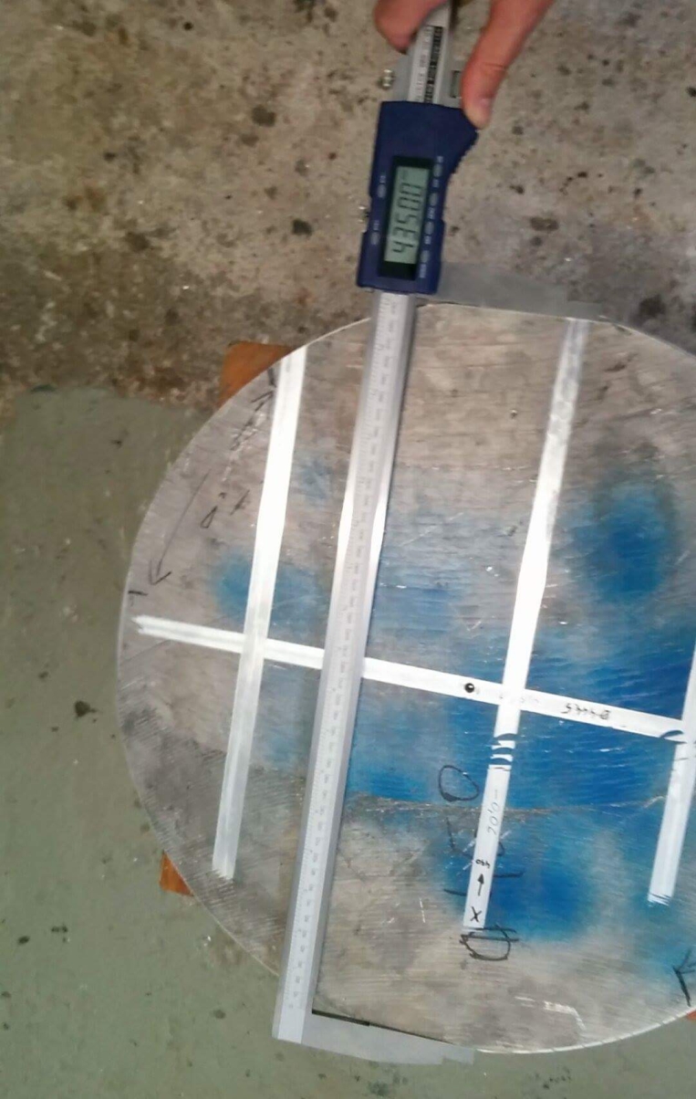

And the test cut i made for measurements. Not sure if I am lucky or :cool::
Attachment 19073
That is X axis, Y axis was not that accurate, need to calibrate it a bit.
So that's about it. Hope i could get some help to resolve the issues i still have.
