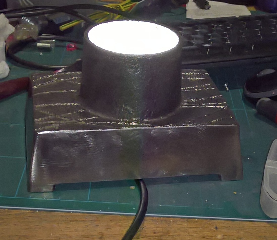

I need some guidance on electrical safety of products rules. I have made a lighting base for a glass sculpture. It is a sealed LED driver and a 20W LED chip on a heatsink. There is a fuse in the mains side and the mains cable and switch are purchased prebuilt. The cable is with an earth wire and the driver is earthed to a common point on the terminal block, which is connected to an aluminium base plate. I cut the base plate on CNC and there are plenty of ventilation holes, but strategically placed so that it is difficult to reach a mains voltage through them. The sculpture base is either bronze or cast iron and it has the base plate bolted to it. I will have the finished units PAT tested, but I am wondering if there is any other official process I have to go through before they are offered to the public.
The pictures attached gives you an idea of the bases, but one pic was of a failure of the resin embedding of the glass, so doesn't show the base underneath. The second one was a brief test of the lamp.

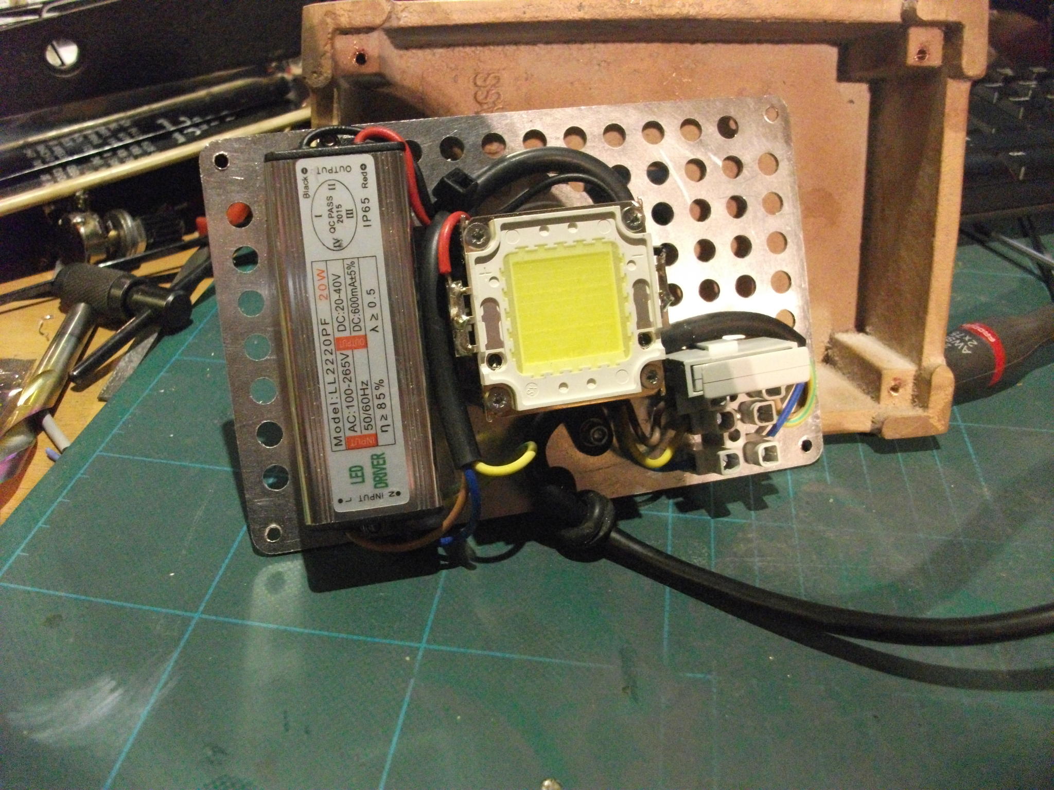

Here's some pics of the lamp base. Don't forget that is only a prototype to test the idea out, nowhere near a finished product, so if you see anything that needs to be changed, please say.
My desk isn't normally like that, I tidied it up to get some space to take the photos :applause:
Attachment 19138Attachment 19139Attachment 19140Attachment 19141
Having looked through the photos, I can see one thing that needs attention - the mains wires input to the driver !

Rob I am not an expert But I would put some mica or other suitable material under the mains choc block so as to make sure no strands of wire will touch the ali base.
edit I don't see the frustation hammer on the table
Re: Electrical product advice needed
Clive S
You are right, the mains shrouding will have to be attended to. All things electrical have to be quadruple safe, just to protect yourself from twats. I hope the sculpture itself will be expensive enough for owners to keep brats with paper clips off it. But you k-never k-know. If people are daft enough to try and dry off a poodle in a microwave and then successfully sue because the manufacturers instructions didn't say not to, what hope is there for the intelligent world ?

The reason I am saying it is that I can see several very basic mistakes in your design, which are pretty simple to to fix, but are very important from the safety perspective. I think that what you may regard "common safety sense" is not the same as what a qualified person would, and it is always a good idea to ask for their opinion.
If you can see them would it not be nice if you stated what they are as that would be more helpful.

Yes, I take on board these comments. First of all the cover was 3D printed to give a pattern for casting in bronze, which the one in the photo is. Secondly the fuse/connector block fixing screw acts as an earth point as the earth wire from the driver cable is connected to it. In fact, the earth wire connected to the driver fixing is redundant. The driver itself is two-wire and thus I presume, double insulated. Finally, the cable is a prewired one with one end stripped and crimped and a moulded on plug and switch, which I did not want to remake, but I understand your concern.
We have done some testing on the unit now and it is not good. The driver gets too hot. The steady state temperature is reached after 45 minutes and is 50 deg C on the top of the casting above the driver. The baseplate is too hot to touch. Even if the unit remains electrically stable, at that temperature it would damage the furniture it is on. The two units we have tested give similar results.
Clive - your suggestion of a wall wart or separate power supply like this one http://www.ultraleds.co.uk/white-60w...ed-driver.html is looking the most sensible way forward and I will be talking to ultraleds on Monday.

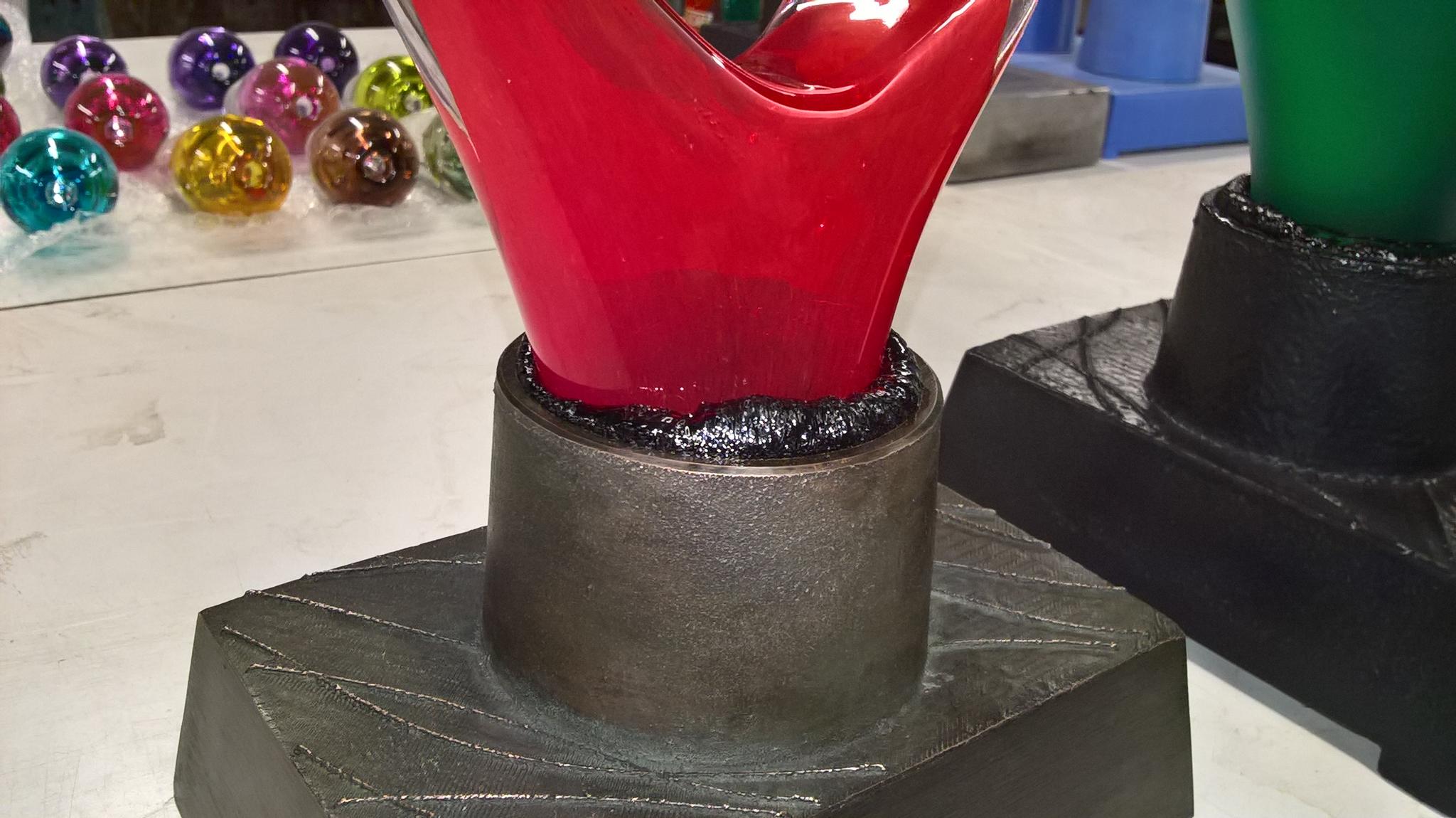

2 Attachment(s)
Just to let you see the quasi end results.
Attachment 19252Attachment 19253
We still need to pursue the external power supply idea, but these are the demo pieces for the craft fair starting tomorrow at the old Truman's Brewery, Brick Lane EC1.
Even before the exhibition starts, we have had a lot of interest in these pieces.

We sold two of them at #LDF16 over the weekend. Now we have pressure to get the power supply right ! Especially as the retail price is near £1,000.
