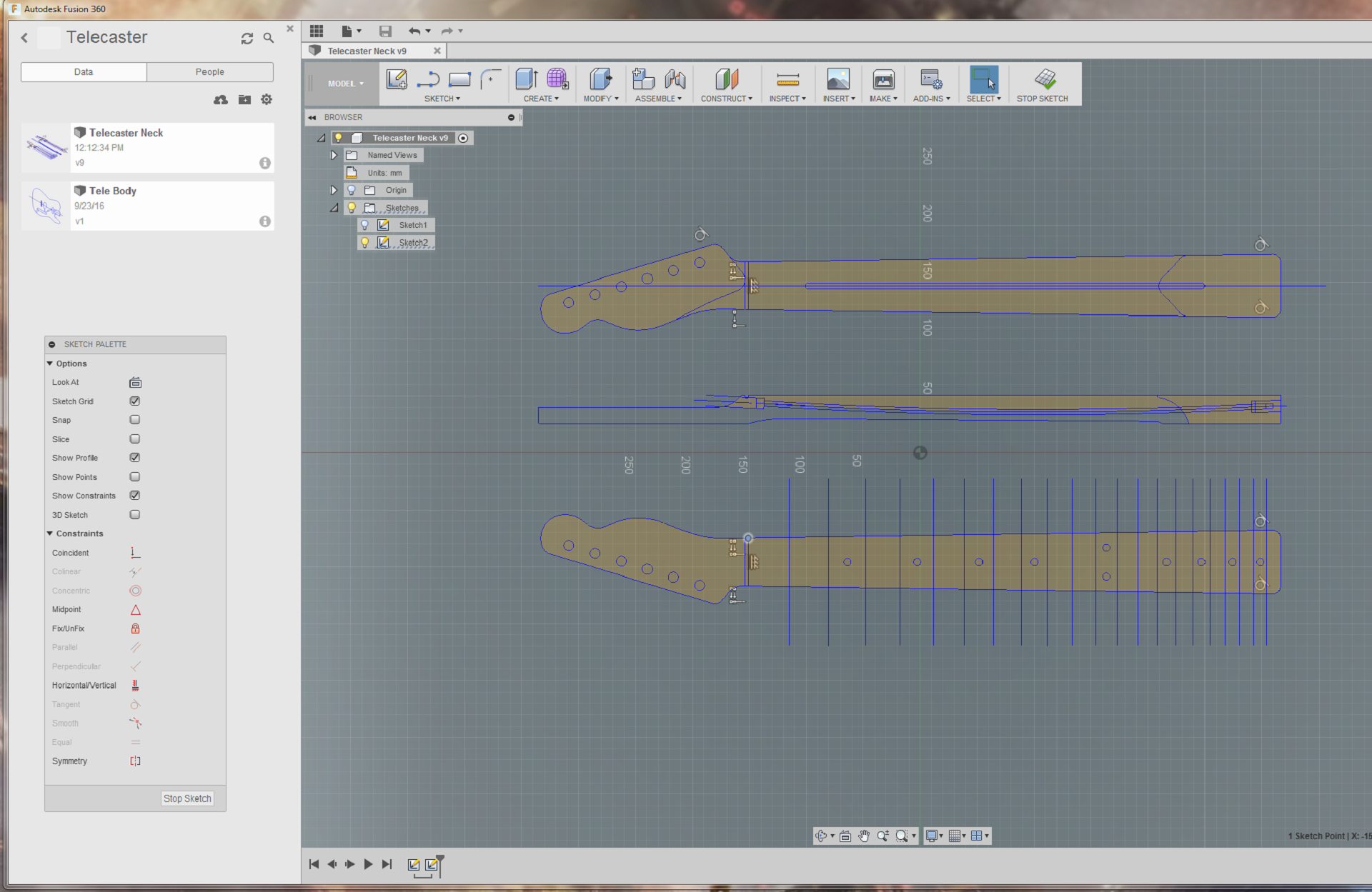

Anyway to get the ball rolling I have taken some pdf plans (PM me if you want the source files) and converted these to dxf in Vectric Cut2D. I have then imported the neck and body (after a fair bit of clean up) into Fusion 360 and now have a project going in there. Here's a screenshot (I hope):
Attachment 19327
I have started with the neck as this is where most of the work is and the conversion has worked OK for dimensions (I've checked the fret spacing against a calculator) however there is much more to do and the tasks are roughly as follows:
Convert as many of the curves, which are made up of 100's of short lines into splines or other Fusion 360 geometry. I have already done the circles and the upper neck with fillets and splines for the headstock. The way you can tell is if you hover over a line and the whole curve highlights then it is done. If it is just a small line amongst hundreds of others then it still needs doing.
Sort out the truss rod on the side view (top view if you were playing the guitar), so that a standard double action truss rod will fit (we'll be going for a heel adjuster with a walnut plug at the headstock).
Probably combine or layer the fret slot marks onto the top most plan view so we can extrude and model from that one rather than trying to align extrusions from both.
Extrude the plan view into a solid body and start the process of "carving" the neck profile, fret board etc (going for a solid maple neck as its a lot easier than a cap rosewood but if someone wants to do that in a branched model then by all means go ahead).

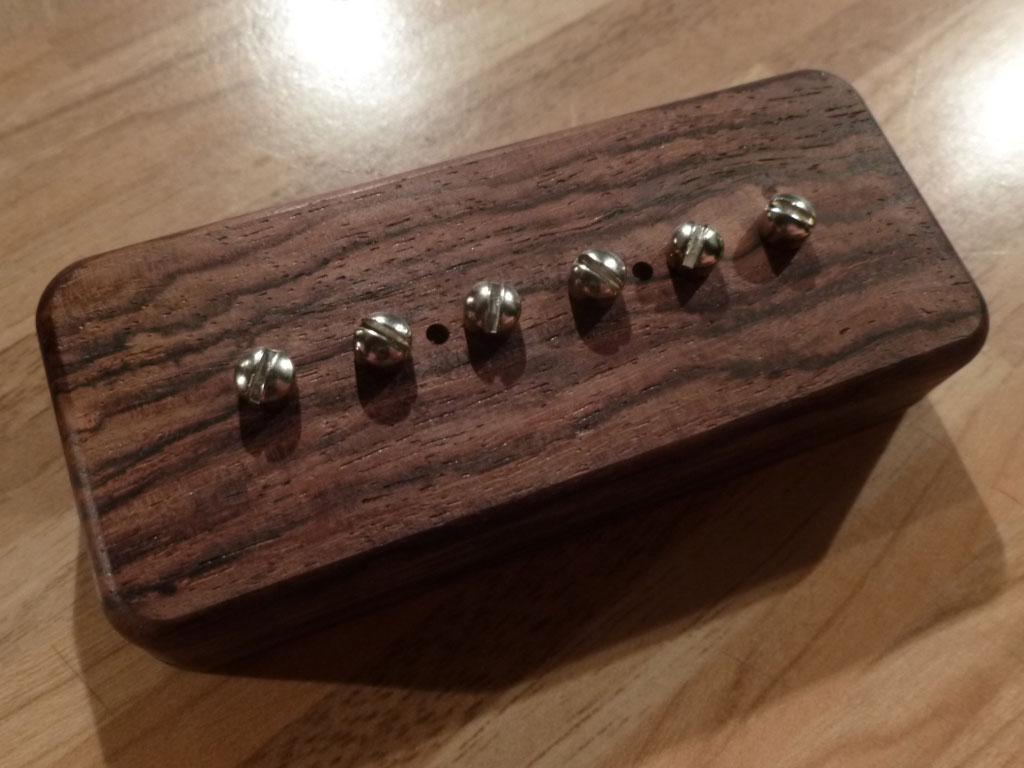

Cheers Chris,
Not sure I could bring all that much to the party body and neck wise, but maybe inlays, or a badge of some sort? Perhaps the pick-ups? I mention those as I'm currently making a set of 10 prototype Rosewood P90's for a local builder, pics and vid of an earlier effort below. I could always ask if he'd wind you a custom built set if you wanted to go off the beaten track - might be a bit cheeky but he's going to be dabbling in CNC himself at some point next year - I've already had the thought that you might make a good contact for him regarding learning about the machine and a solid introduction to CNC guitar making...
Attachment 19347Attachment 19348

Hi Wal,
That might be an idea - I was going to go with some kind of vintage Fender reissue pickup in the bridge (the original guitar I'm copying is a '62) and a '57 PAF re-issue in the neck, but if I can get closer to "vintage" by going custom that might be worthwhile.
