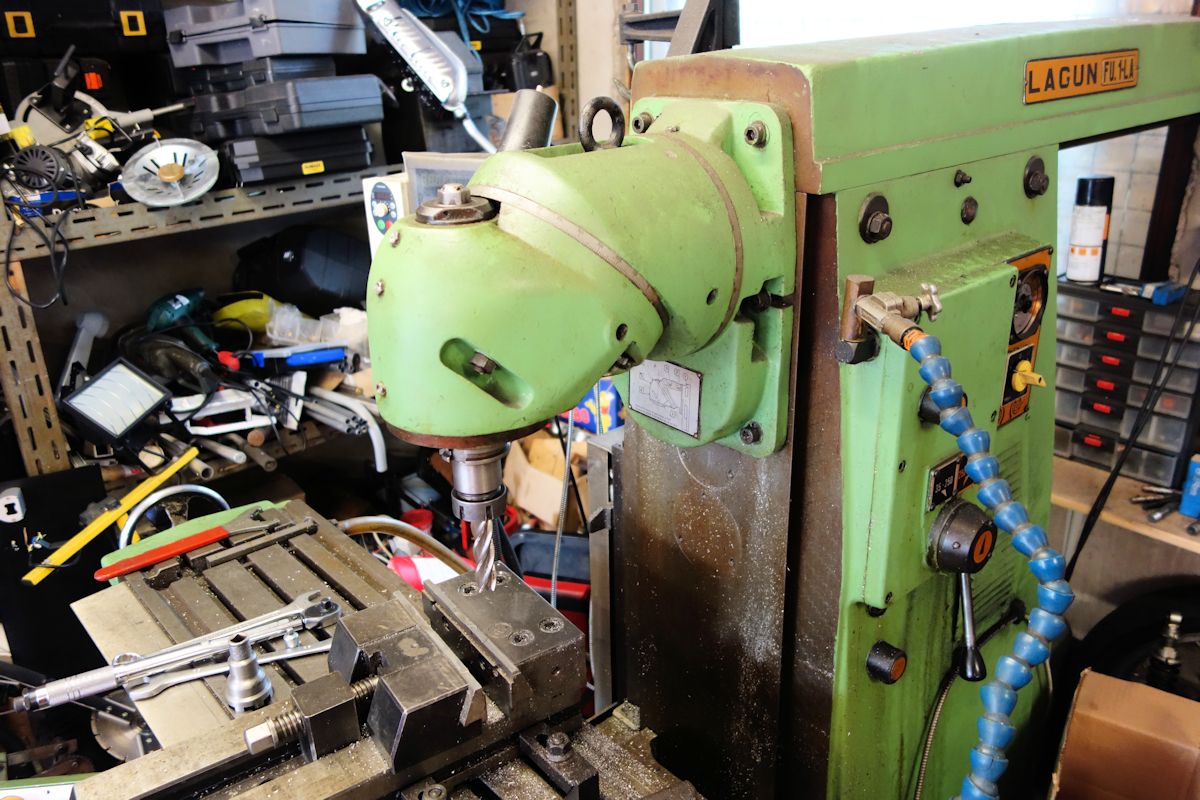

Stepper motors should be chosen by looking at graphs showing torque against speed. You can mix and match. They are all 200 steps/rev which suits 2.3" a lot more than it suits 3.4". The stepper market is dedicated to American's who believe more is better and need to be told what to do and what to buy because that is how they were taught in school. Why do you want to power the bed vertically when you can power the quill? You can put a screw along side it. Fix that backlash first or it haunt you.

You would be better served with servos and good quality ballscrews. Way too much weight to push around and up/down.
Not what I would call an easy conversion by any standard.

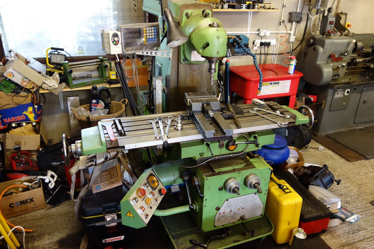

Ahh, stepper 23 & 34 case size = inches. I have read that over sizing the motors apart from being bulkier and more expensive, results in a slower machine? I thought the speed would remain regardless of size.
Unfortunately my universal mill has a fixed head and therefore no moving quill as per pic’s. My measurement of 9.5 lbs feet of torque to move the Z axis is around 1800 oz in, of course I need to be able to plunge and cut etc so with 2:1 gear reduction I thought I would be ok. But with the X & Y requiring a fraction of the torque to move the tables I maybe need to look at 2.3” steppers for these.
I take your point that backlash is a problem that won’t go away but I am reluctant to start into a ball screw conversion until I’m confident I can get the CNC stuff working. Where do the UK people on the forum buy their hardware from?
Sorry for the daft questions and thanks for the adviceAttachment 19355Attachment 19356

Its not just the moving the table the steppers have to deal with its the cutting force as well, plus the acceleration of the mass and stopping it...I'd have thought that servos would be best but 8 & 12Nm Nema 34 steppers coupled with 230V drives should see you right.
Don't be tempted with kits of electronics, they're seldom well matched. Zapp Automation, CNC4YOU are good for steppers etc.
What's the all important budget?
