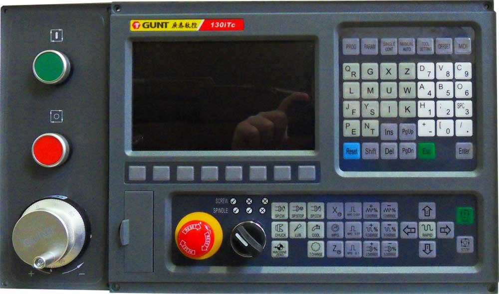

Higher end Chinese controllers?
		I know there's been plenty talk about the low end controllers on here and various other places, but has anybody came across anything about the higher end controllers?
I'm talking the 990/1000 series. I like the look of the 1000 type with the MPG panel, but there seems to be a void of any sort of information about what exactly they're capable of, and how much you can program them to handle things like tool changers. Most listings seem to mention PLC scripts and being able to custom edit them, but that's about as much info as I can find.
SZGH have manuals at http://www.szghauto.com/index.php?c=...&a=type&tid=40
but after having a scan through them, they mention nothing about custom programs. The CNC1000Mdbc(machine centre) manual does cover tool changers at the end, but I suspect quite a bit has been lost in translation.

		Model numbering seems to be almost random. From what I've seen, I'm guessing 1000 series are basically 900 series but in a complete unit (900 series have separate display/control panels). The big problem with comparing models, is every spec sheet seems to be worded, laid out, and translated differently, so comparisons are hard to do.
I've had an email back from CNCMakers, and they've recommended the GSK218MC series, however as standard it only does a max of 3-axis simultaneously I.e it can only move 3 axis at any one time - I had to email them it clarify that.
I'm waiting to hear back.
I've also emailed Newkye to see what they recommend.
CNCMakers/GSK call the break out boards De-concentrators, and they have the option of basic ones that simply convert the 3 25-pin D connectors to screw terminals, as well as an output board with relays.

Having spent a good bit time looking through and comparing the GSK manuals last night, other than certain models having specific features, I suspect the difference between a lot of the models is simply different hardware, but still with the same key features.
The 988 series are the top of the range controllers, capable of 6 axis with 3 spindles.
1000/990 other than being physically different, I can't find anything majorly different in the specs.
983/980 (bus version) are for bus controlled servo drives.
218 seems to be a newer version of the 990, or a lower spec version of the 988.
Certainly for what I'm looking for, the GSK 218MC-H seems like the best fit. However the standard control panel doesn't include a MPG, but a remote MPG may be a better option.
I'm not going to make any decisions until I've heard back from the other suppliers, to see what they suggest, and what their prices are.

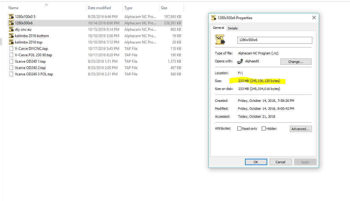

		quote from other thread:
JAZZCNC
However there are many potential pot holes it could fall down on like Canned cycles etc, long cycle times etc.
Lack of memory is also another issue. Even the higher spec controller is memory limited. 32Mb or even 64mb isn't enough for Large 3D programs and will require DNC to drip feed the code. For some 32Mb may seem plenty but I can tell you some the people I help have 3d files in the Gb's. Pauses or temp locks while dripping code, even if position is not lost, is problem on 3D surface because it leaves mark which wreck the job or at best cause extra work hand finishing.
Dripping from USB isn't always reliable and RS232 just defeats the point of stand alone Controller. All these things have to be tested and influence the final outcome.!! . . . . Unfortunately again we are back to Cracking open the Good or Bad Egg.?
After talking with a couple of manufacturers unfortunately that seems to be the case. The typical  answer i received was:
Our CNC controllers are using standard G code, the system can be directly copied from the U disk file to the system processing, but can not directly use the U disk online processing.The file size depends on the disk space of our system.The largest disk space of our system is 128M.
Its incredible but the mini controller DDCSV1 beatas them on that front. I will continue its review in the relative thread. Just would like to say here that it reads and executes  10 million line file without a glitch. From start to end. There were some glitches at first and at the end i found that was because i was not using the original pen drive. Once i started doing that, 2 weeks of perfection till today, working 8h per day at least non stop.
If you wonder how i managed to make 10 million line file. Very simple. Milling 1300x1000, trochoidal using 6mm bit. it was not big on size though. So at the end that memory limit could not be such big problem as it seems.

Boyan Silyavski

Boyan Silyavski
 But how large was the file size.? 10 Million very small lines won't take much memory. Try complex 3D surface at that physical size and see how it performs. If it loads that file then I'll be impressed..:thumsup:
		Re: Higher end Chinese controllers?
JAZZCNC
That good enough for you? I don't think a bigger file can make any difference evaluating the controller. I paused it in middle and changed tools, re zeroed and started again/ broken tool/. I stopped it later, remembered the line and when i had time started from line 2 500 000. Controller was busy 15 minutes until it went to that line and started perfectly from there. I don't have doubt the DDCS V1 is a working controller. I know how to square with it the gantry, how to tool change and all that stuff. It homes perfectly and mind that, can be made to repeat 5 times at the sensor and you control the backoff.
I will write all that in detail when i have time, but i am impressed.
Attachment 19479
		Boyan what is the significance of the 233mB file shown in the pic.
			 Thelargest disk space of our system is 128M.
   What is the actual gcode file size?
