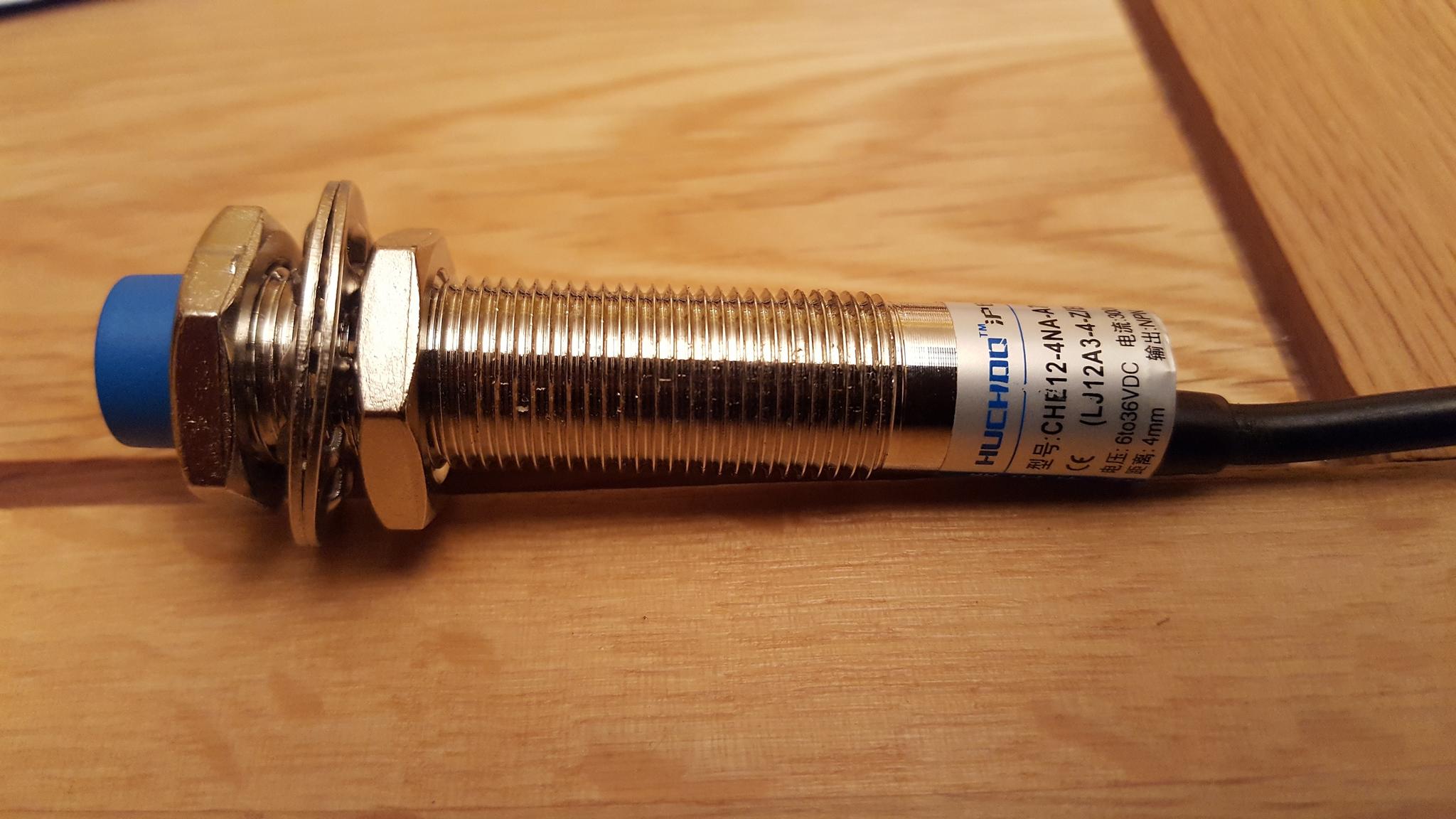

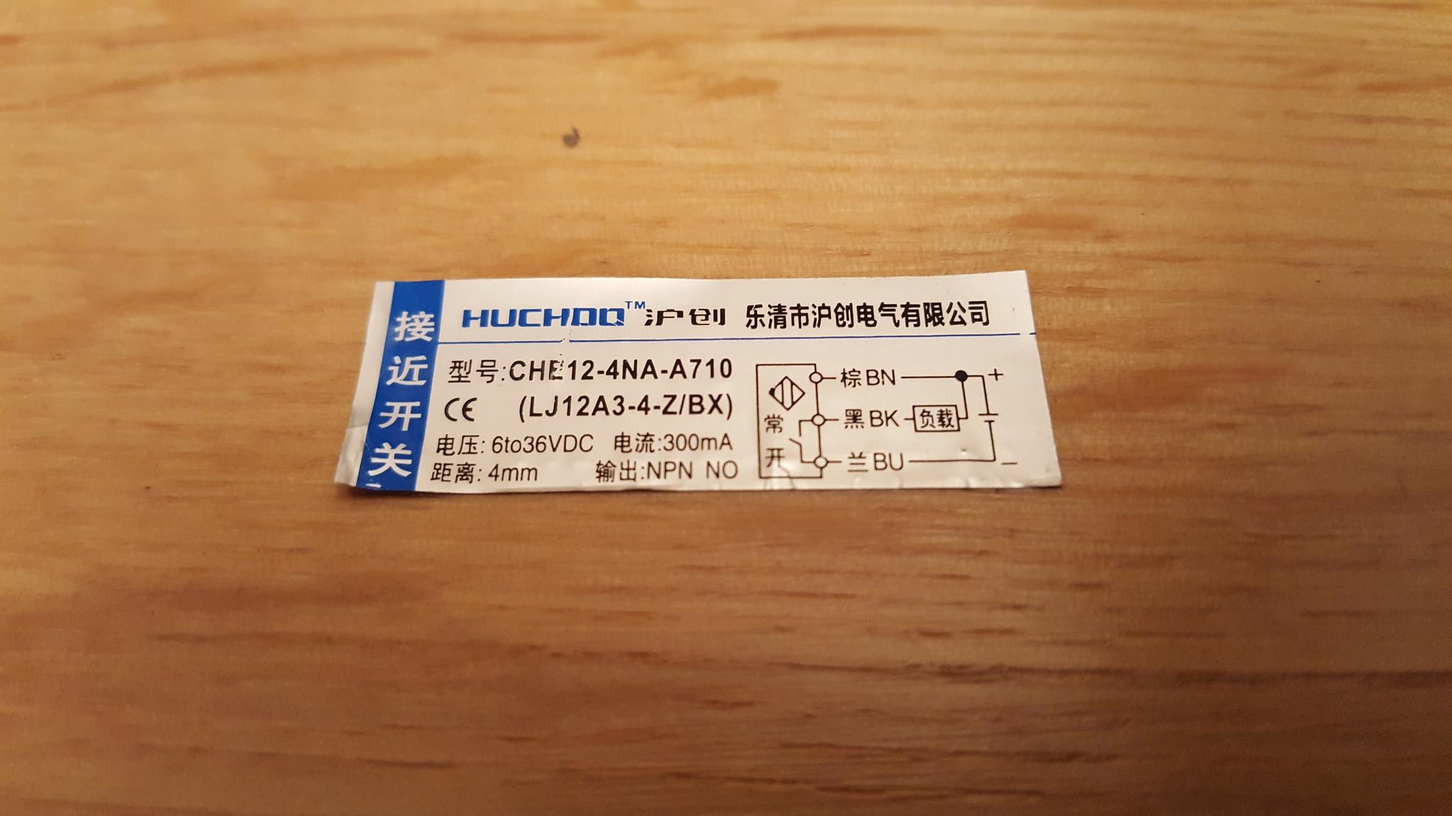

Hi Guys
I am using NPN Proximity switches from here and a 5v BOB from Zapp Automation . I fitted a 2.4k ohm resistor between the black signal wire and the blue (-ve line) and connected up to a 24v dc power supply. When the switch is open, the voltage between the signal wire and the blue line is 4.5v ok I think for the input to the BOB. When the switch is closed, it drops to 0.7v - measured using a DMM and the LED on the back lights up. I connect the black wire to pin 10 of the BOB and the blue wire to the GND. When I activate the switch, the LED does'nt light and nothing is detected via the diagnostic screen of MACH3. And yes the port & pins is set for the Home to pin 10.
The 24v power supply buzzes and the indicator LED on it goes out. What have I done wrong?
MikeAttachment 19436Attachment 19434Attachment 19435

Hi Neale
Thanks for your response. It seems to tie up with what is on the switch label anyway. The ZPA5-INT has a seperate ground for each pin input. I'll give it a go.

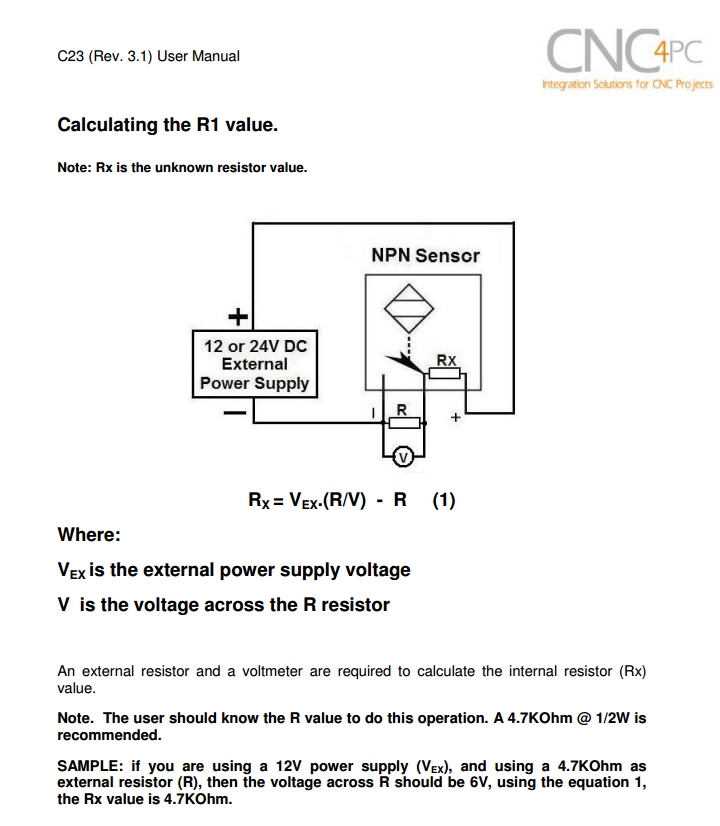

Absolutely right. Here below is how to check if that is the case / credit goes to C23 BOB manual/
Attachment 19439

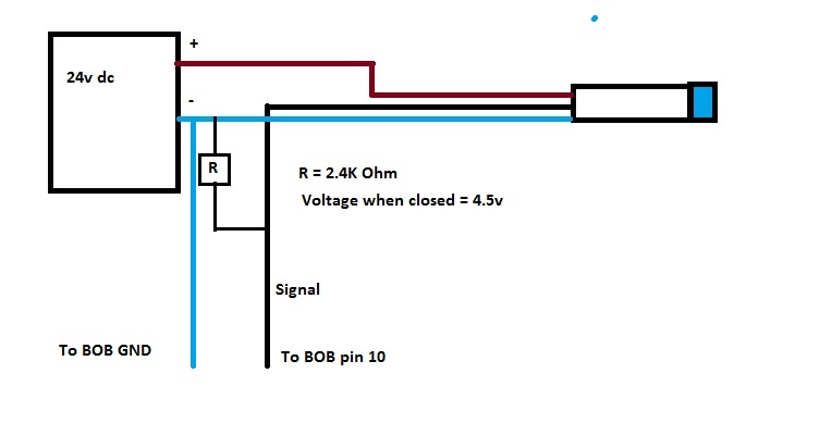

Useful post Boyan. Applied the formula to the NPN I had with the external 2.4K ohm resistor I used and got answer of 10.4K ohm for the switch internal resistance. This seems consistent Clive S post. The switch does have 300ma printed on it. But I think this is too much current for the BOB input. So back to the Neale's suggestion. Will let you guys know how it works out.

Hi Neale - I gave up on this for a while but now my machine is working nicely I really do need to get my "fish brain" around this and get the homing set up with these proximity switches so that I can do auto tool setting height etc. So if I understand your post correctly I need to do this as shown in the attached picture
Attachment 22984
Choosing the appropriate value of R drops the voltage down enough for the input and away we go (hopefully!) .

Re: Wiring 24v NPN Proximity Switch to 5v BOB - Why does'nt it work
For all practical purposes the proximity switch behaves like a Normally Open mechanical switch.
Most people are overthinking the problem.
If your BoB input when unconnected is shows a light on the Mach3 diagnostics screen when it is configured, then the BoB has internal resistors to float the input 'High'. Putting a switch, relay or Normally open proximity switch (like wot you got!) between Ground and the BoB pin will push the input to Ground (Low) when operated and trigger the selected function.
The Black wire in the untriggered state has a high impedance and so it is possible to parallel them up to put all home switches to one input. I would use a routing diode on each output. If you are unsure I will breadboard a test and video it.
The Black wire will sink 300mA to ground. Any more than that, the switching transistor in the output stage of the device will make smoke signals that it has failed, and may even give you an audible indication (BANG!).
