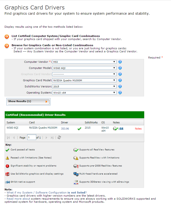

M1000 is listed and is fine - this is mobile workstation
Attachment 19468
my concern is related to desktop workstation with i5
Simply do not want waste money on higher card if I won't use its potential.
