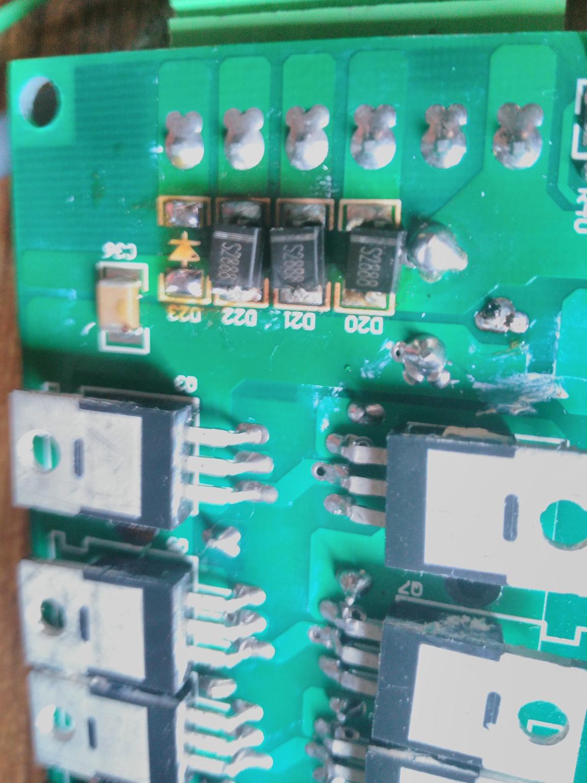

Unfortunately Ive now got one dead one as well. Still in the process of replacing the eding controller with the cslabs one, haven't really had time to get stuck into it, and powered the drivers up to test the limits and home switches and estop. Reset the estop and the driver went bang. Oddly enough Ive had it stripped down to the board and cant see the flashover mark or a blown component. The driver powers up but comes up with error codes.

Bit of an update on this. I have the driver apart on my bench and have found the cooling fan faulty and a shorted IGBT. The fan is easy but waiting for someone to see if they can get me a replacement IGBT.
With the faulty IGBT removed from circuit the existing fault disappears and now says that it cannot find the motor which is correct seeing as its not connected.
I will update again if I can get the correct parts and get it working.
Ive already got some on order but thanks anyway. Looks like the protection diode is built in. I think that's whats gone short circuit.
OK - it varies, e.g. the DQ860MA add external diodes from the phases to DC bus, as they're higher speed so offer better protection against unplugging whilst powered on. The m752's I've seen don't have these.

New IGBTs and cooling fan arrived today. Fitted new parts and rebuilt the driver. Tested and working ok.
