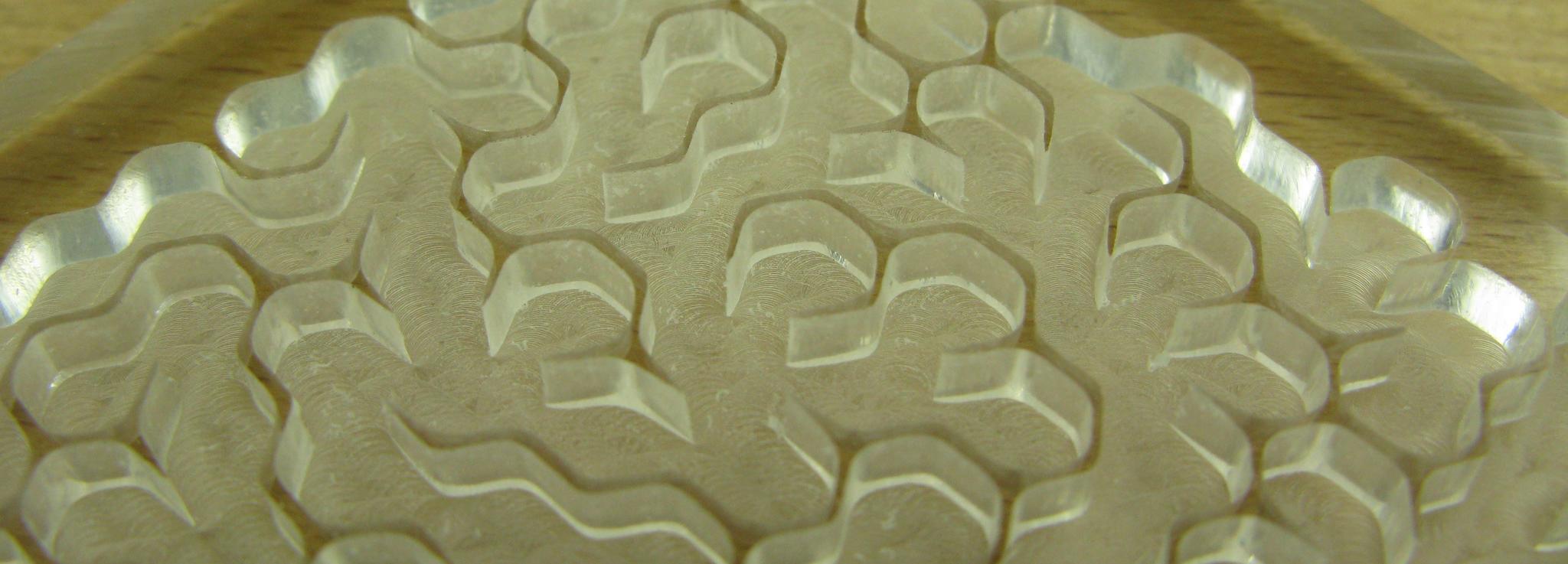

Newbie question: I purchased a High-Z/S-400T milling machine from CNC Step recently for hobby use. As a test, I'm going to mill a maze into a piece of brass plate. As a prototype step I've cut the same pattern into a piece of perspex. The vertical edges have turned out very well, what I'd also like, though, is to somehow smooth the end of the mill to remove the circular scuffs (see picture below). Can anyone suggest a way of doing that?
Attachment 19589
Cutting parameters were: 2 mm two-flute end-mill, tool speed 3,500 RPM, feed rate 4 mm/second, plunge rate 0.3 mm/second and pass depth 0.3 mm (so 10 passes to make the 3 mm depth above).

Tram the spindle as good as you can.
Use corner rounded end mills.
Get a more rigid machine. :chuncky:

You need to use a one flute end mill, the 2 flute leave more trace on the end of tool. Especially on perspex. the rigidity has nothing to do with that, the walls are clean, so no vibrations.... 3500 rpm for a 2mm flute and 4mm feed rate is to low, 8000 rpm and up is 🆗

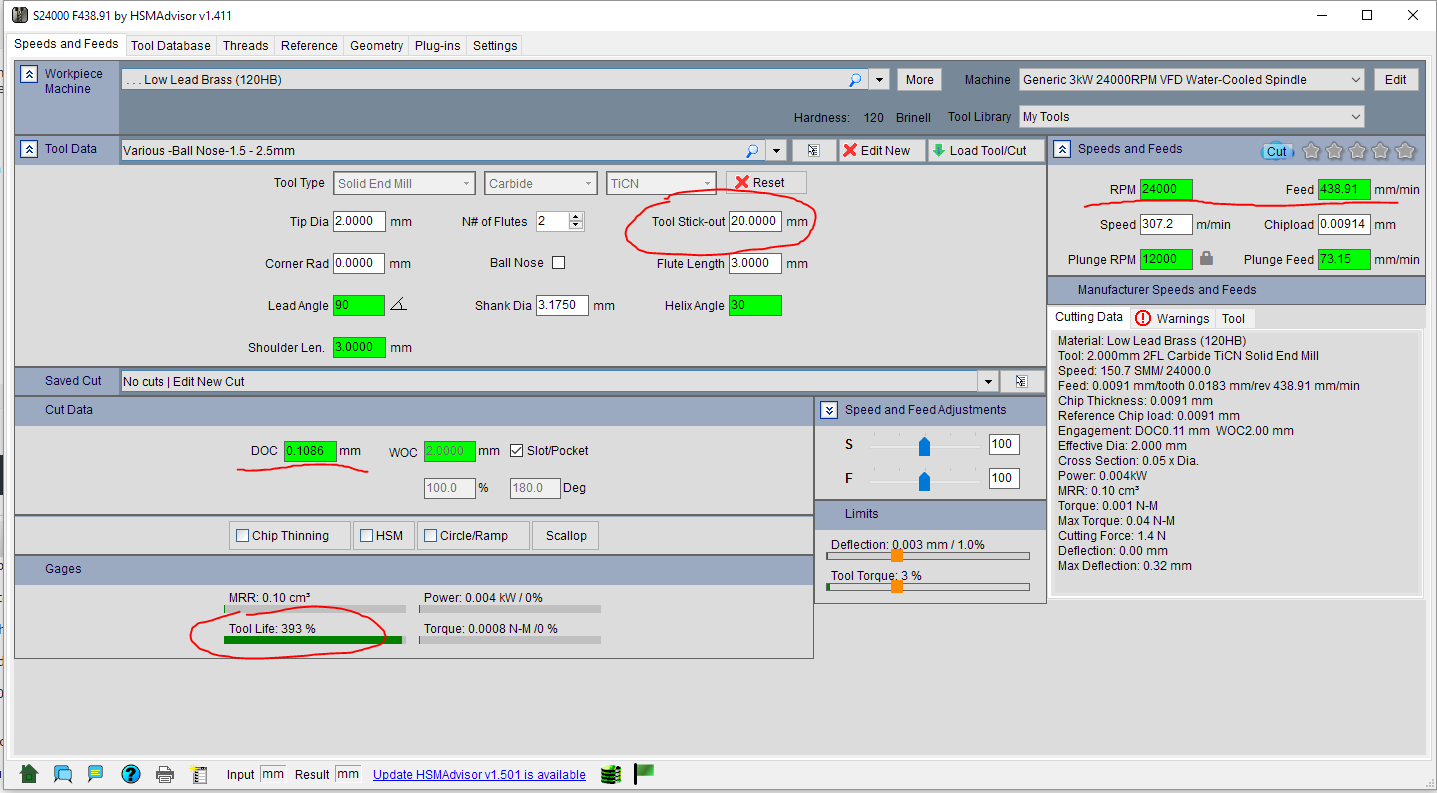

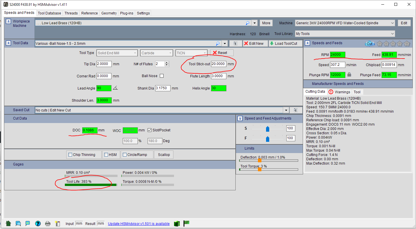

Bellow i did the calc in HSMadviser which i greatly encourage you to test and purchase later as its extremely useful.
Attachment 19723
Changing the suggested pass depth very actively affects tool life / surprisingly for the better this time, normally for the worse/ so 0.3mm pass depth gives me 219.46 mm/min and double the tool life.

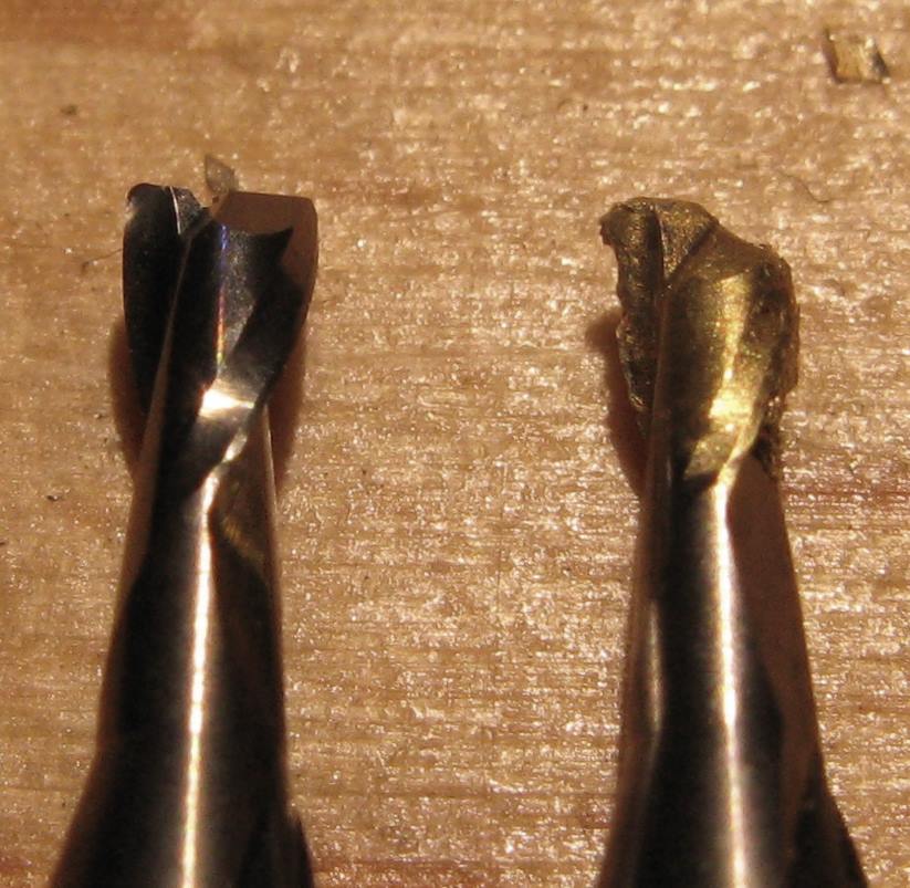

Well, I'm not having much success here. I don't have my compressor yet so I thought I'd try a HSS/8% cobalt end-mill (4 flute, 7 mm flute length, 6 mm diameter shaft) which requires a lower speed. With the tool sticking out 20 mm to avoid my clamps, I've taken the HSM Advisor recommendations and then backed them off, so 5 mm/second feed rate and 0.5 mm depth of cut, tool running at 14000 RPM as recommended. As a reminder I'm cutting a slot in [343-460 N/mm2 tensile strength] brass plate.
Result: tool snapped off in the middle of the first pass. It looks as though the tips have worn quite quickly and then the tool has become clogged with brass:
Attachment 19958 Attachment 19960 Attachment 19961
Here are my tool details, material details and the HSM advisor screen to match. Where am I going wrong?
Attachment 19951 Attachment 19962 Attachment 19952
FYI, until it snapped, it appeared to be making quite a reasonable cut:
Attachment 19956
