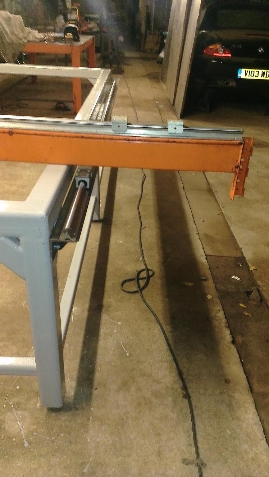

hi, im building a cnc plasma table, its constructed from 80x80x6 box section, with 80x80xx6 angle running along side the y axis to support the linier rails.....
im using rack gear system to drive it.....
Can i tig the rack onto the angle rather than drill and tapping? also, i want the x gantry to be able to extend outside the table so i can cut large diamiter pipe.i was thinking of using a piece of link pallet racking to make the gantry,it being light and strong

Looking at the pictures of what you've built so far, I think you probably already know the answer to the "welding rack to frame" question?
Surly the rack is far to precious to weld it in place?
What about distortion from the heat build up?
Would the tempering of the steel be effected from welding it in place?
Will you need any adjustment/wiggle room from the rack, when it comes to truing everything up and final assembly ?
Not sure I would risk it myself and just bolt, shouldn't take that much longer.

Lazy bugger get the drill out. . Lol . . . . I've recently done exactly same thing on Router but used Nut bolts didn't tap and didn't take that long really. (My rack was pre drilled thou)
Tig will work but for the little extra work I'd be inclined to Drill.

i thought id cut a few corners previously and bought a project cnc plasma off a well known auction site..iv junked it all apart from the longest linier rails which im going to use for my x axis on this one.....im using 4nm nema 23's...Stepper Motor Driver 6.0A, 80V CNC Microstepping CW8060 .....Breakout board CP0-10V CNC 4 Axis with Charge Pump and Relay ....600W PSU 48V 12A CNC Power Supply Stepper Motor Milling ........EMI Panel Mount IEC Filter 10A ......UC100 USB Motion Controller ...and a thc 150 proma elektron
....iv got some help off someone local to me for the wiring and setting up.....iv built the ttable as heavy as possible but id like the gantry to be light and as rigid as possible

16mm supported rails will handle 80mm box section easily so wouldn't be bothered there.
Dump the link pallet idea as it will only cause you grief. No point spoiling machine for little extra piece of box section costs.
80mm or 100mm box with with few well placed braces will be fine for plasma machine.
Regards the overhang then if you talking about using for Rotary type axis hanging off the side then yes no problem.
But if your talking about actually engraving on separate table kind of thing then I'd say don't waste your time and just build another machine because engraver and plasma are two very different animals.
Engraving machine needs to be far stiffer and accurate to work well and R&P just isn't going to cut if any real fine engraving type work is to be done.
