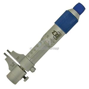

I've seen this type used (an analogue internal micrometer) ~£60:
http://www.ebay.co.uk/itm/5-30mm-Moo...-/231227465653
Attachment 19692
This quotes a resolution of 0.01 mm but no accuracy value. Could be good enough?

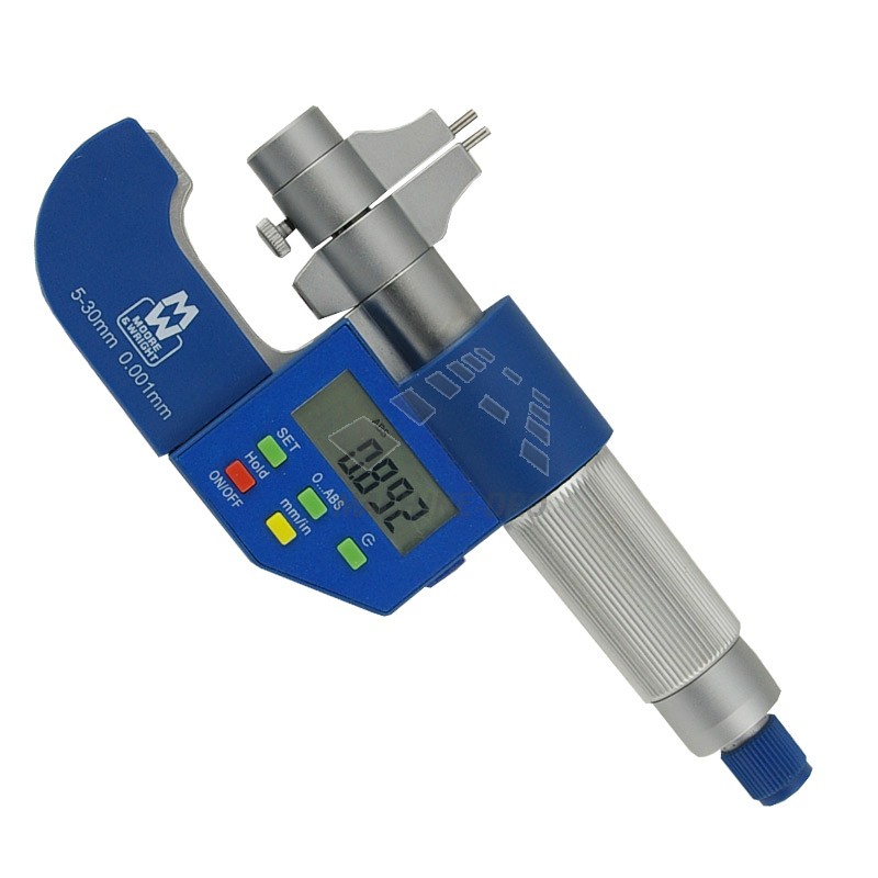

The digital versions are pricey ~£190:
http://www.machine-dro.co.uk/5-30mm-...80-series.html
Attachment 19693

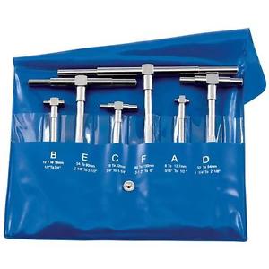

There are telescopic bore gauges, but have never used them and there seems to be a knack to using them. How do people find these? I have an external micrometer so could mic off the gauge assuming the gauges give repeatable results:
Attachment 19694

Telescopic gauges like the ones in the last photo are prone to inaccuracy. I personally avoid them in all but very special circumstances.
There are others to look at too:
3 point bore micrometer is the best but most expensive
there are also dial bore gauges
Google them up for piccies.

Oh, and telescopic bore gauges are a skill in their self, however when you need them, they are invaluable. Short of spending a huge amount of money on lots of three point micrometers, there's no other cost effective way of measuring various diameters of deep bores.
I've got a set, however I think I've only ever used them once in the past year, and that was to measure deep enough down a worn bore to get a starting measurement for a repair.

The budget/entry telescopic ones are not that nice to use unless they are high end such as Mitutoyo which are much smoother

Two point internal mics were reasonable (as per 1st photo)
But critically, and as you mention Boyan, even with reasonable tools it comes down to the operator and the feel of the gauge when taking the measurement. This is something only experience can give - i.e. when the interference fit part just falls off under gravity you know your method needs a bit of work. I'm sure I can dial myself in as per all the other tools I've got.
In all I'm homing in on the 2 point internal mic. Reasonable price, just one measurement to take, seen them used a bit (Youtube etc.) to make good parts. Maybe one for the Christmas list . . .

Before you do that:
All the boys I watch on YouTube...
Use the telescopic ones to get them close, an external mic to measure the scope and get them even closer...
Then! they use there own skill to find a piston fit "pop" :)
It's normally in the flavour of Starrett though on the scopes, so yeah they do operate nicely, I can't see that a cheaper set would give you that much of an off reading that you couldn't recover from it using your learned skill on the last op.

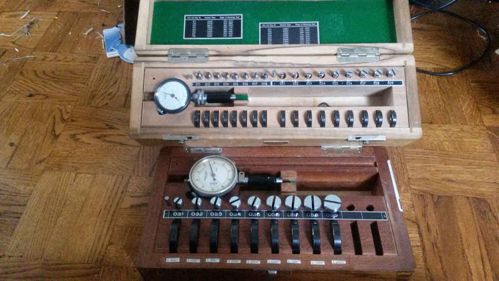

When I found these I thought of this thread
Attachment 19713
You can pick up sets of Diatest Gauges for reasonable money on ebay from time to time, they are very quick and easy to set up as you slip the assembled gauge into the standard and set the dial gauge in the sleeve to read the exact size, repeatability is fantastic and you can check the bore at various depths if necessary, I use them for assessing chamber wear in barrels.
To swap to metric you just use a metric dial guage and a calculator to convert the standard size to metric for zeroing,
- Nick
