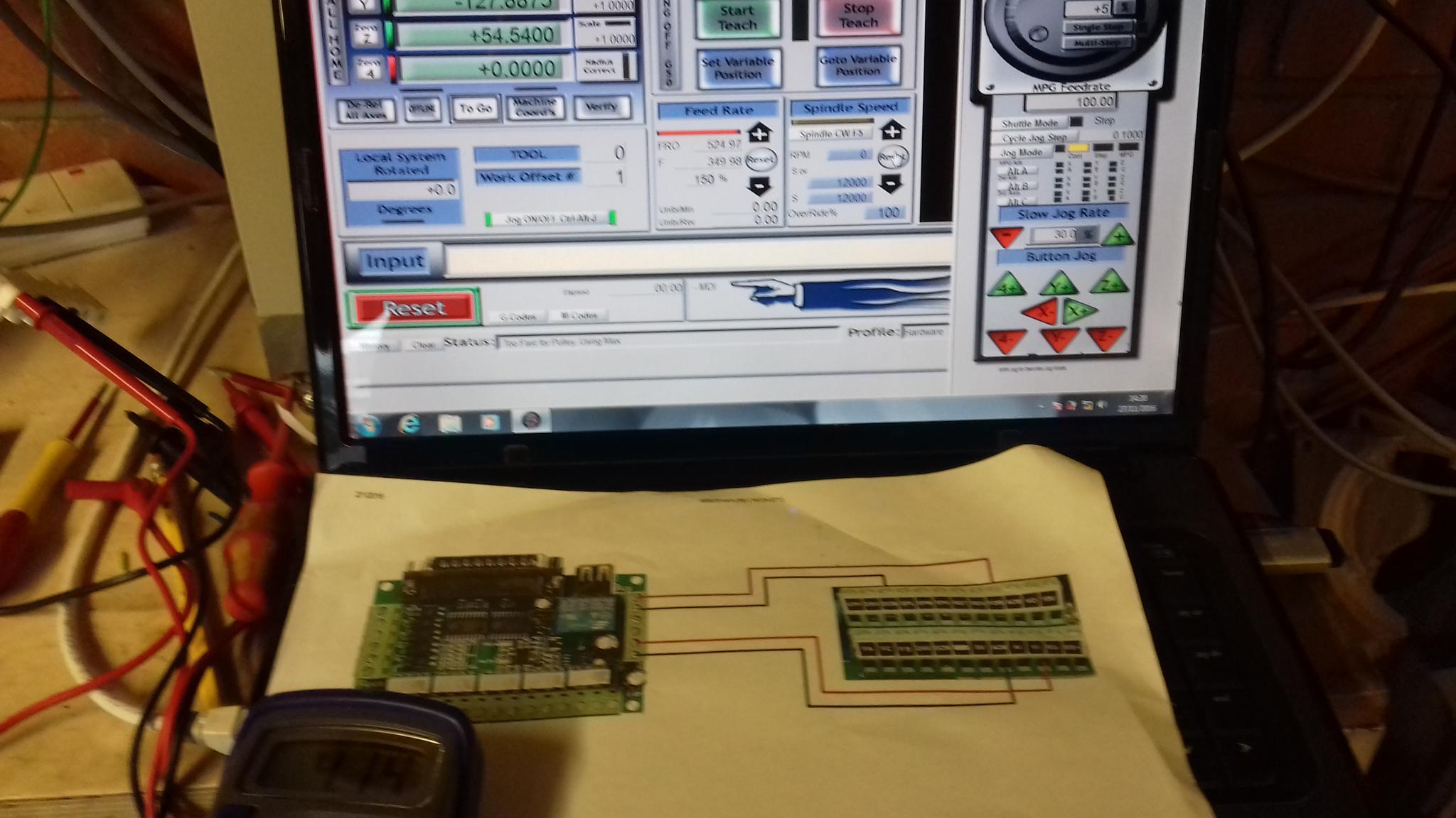

But with Christmas looming and family and friends asking for things cut I decided to connect my HY vfd to its 2.2kw motor using the 0-10v out on my bob.
The issue I have is the spindle works fine under manual control from mach3 but when I move any axis in rapid or with a cutting program loaded my spindle slows to a stop it regains speed once these movements have finished, the only time it does not do this is running under reduced jog speed in the software MPG. I hope this is me being stupid and someone can get me up to speed (sorry could not resist the pun).

I have Ess connected to cheap bob similar/same to the ones Emvio Eng recommend.
This picture shows spindle running 12000rpm 4.14 volts at the vdf connections, so looks to me like the relay is misbehaving ?

Re: Spindle being awkward.
PS have checked connections FOR-DCM and V1-ACM checked and double checked.
When rapiding around there is no volt drop.
Mick
This might help I am getting 23.5v across the FOR connector on the vdf when I press jog.

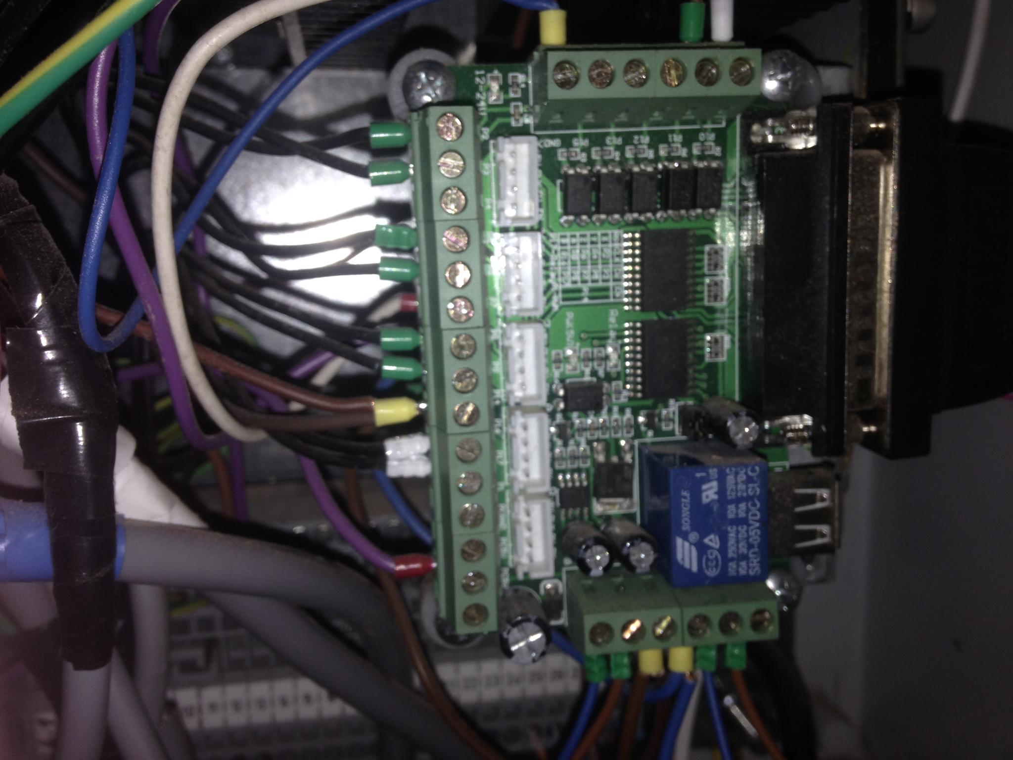

2 Attachment(s)
Attachment 19730Attachment 19730Attachment 19731
I have tried to upload xml file but keeps failing.
I have done some more checking and the relay on the bob switches when any of the jog buttons is pressed I cannot work out how the relay is controlled.
The Bob needs a 5v connection from the PC. There are terminals to take the PC side of the power and a USB connector also. If you do not connect up 5v from the PC the opto couplers will not work properly.
I can't see that connection on your photos.
Here's a link to the Bob manual in my dropbox https://www.dropbox.com/s/v1fha65o2p...rd-EN.pdf?dl=0 Just in case you haven't got the document.

Please reassure me that you have the PC side of the BoB connected to ground and 5v from the computer (using the USB cable or the teminals bottom left in your photos)

MPH100
I have checked the connections and added an extra ground still to no better, the relay switches on/off when feed is engaged manual or program dont know what is controlling it :ambivalence:
What about the 5v from the computer !!!
I have 5v power supply feeding Ess and bob keep checking voltage seems fine
MPH100
So I presume the photos you uploaded of the BoB are not showing the current state of the connections and there is 5v and ground from the computer connected to the USB socket or the PC 5v power terminals in the bottom left hand corner. - Rob
