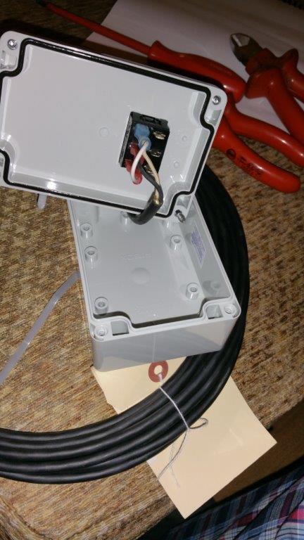

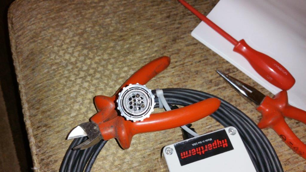

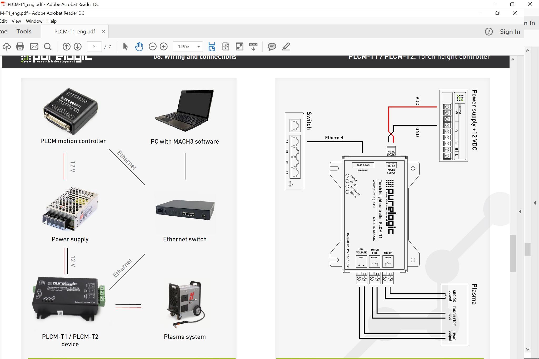

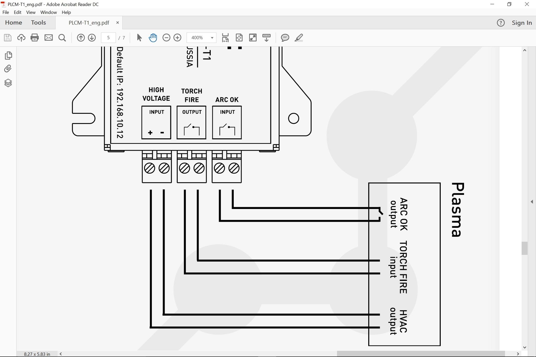

Hello all i have completed my cnc build and as stated i have bought a Hypertherm 45 with T45 machine torch.
I am in the process of adding it to my table and would people recommend a floating head or a static head as weeks of searching google and peoples opinion differ....some are spring loaded, some solid and others hybrid etc etc.
2nd question is the elctrical connection to my THC from purelogic.
Attachment 19910Attachment 19911Attachment 19912Attachment 19913

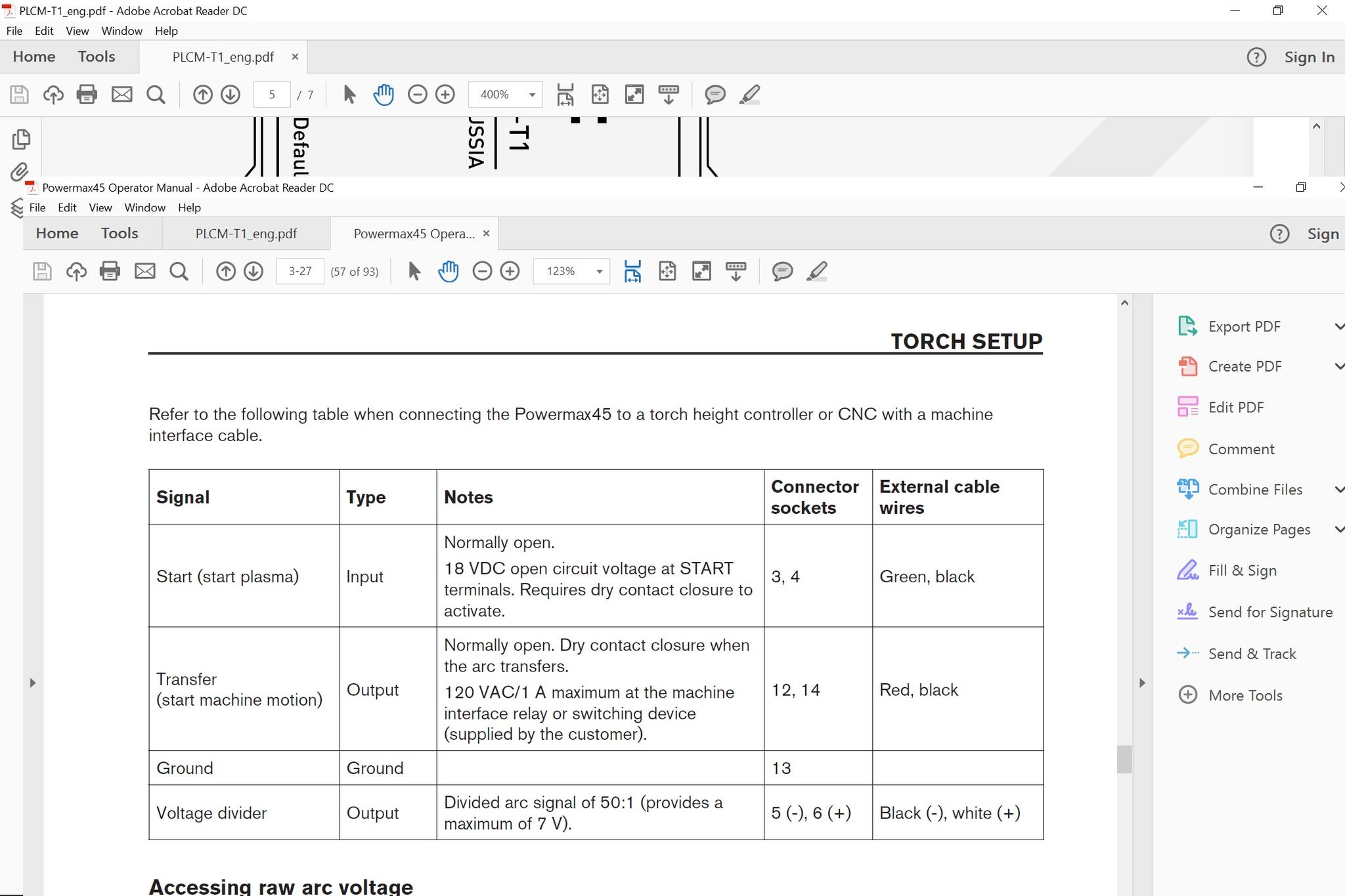

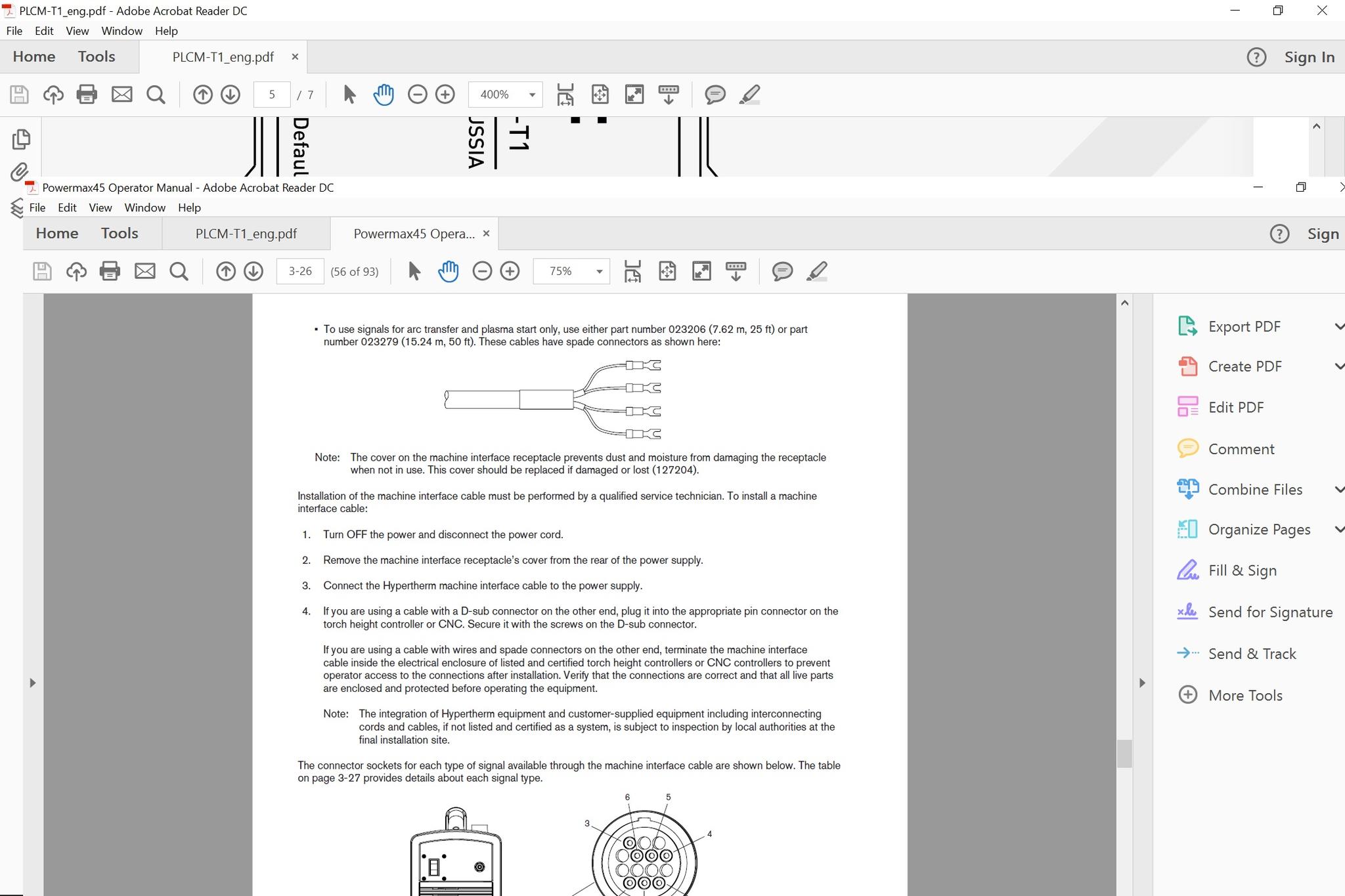

Am i right in stating the connections from the HYPERTHERM going to the PURELOGIC THC are
Hypertherm Purelogic
Start (start plasma) = Arc Ok output
Transfer (start machine) = Torch fire input
Ground = Ground
Voltage divder = HVAC output.

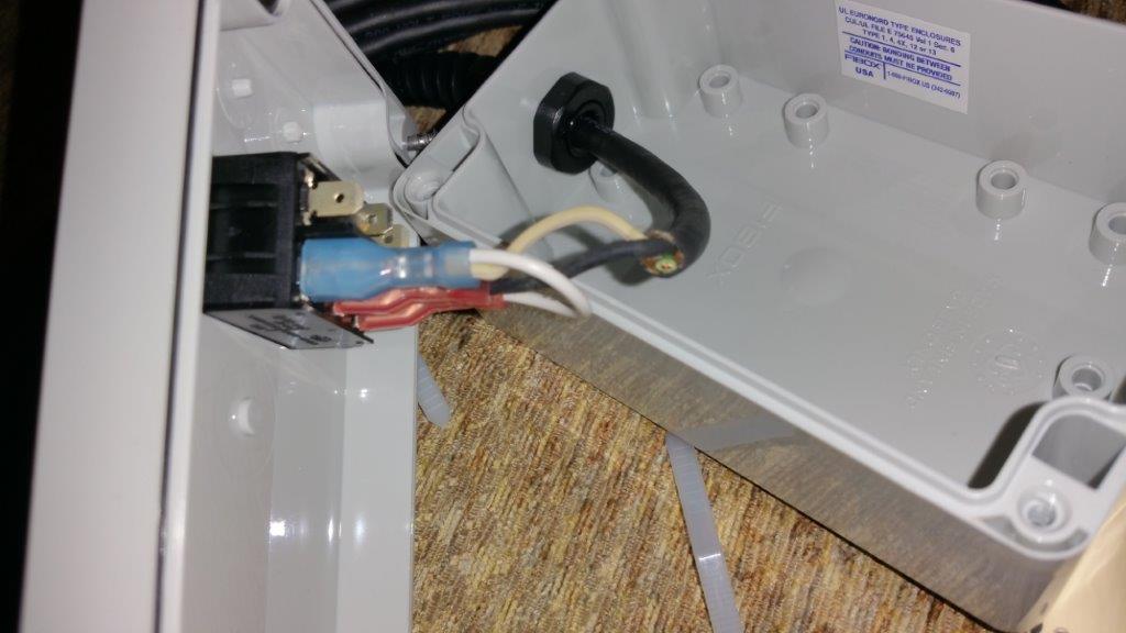

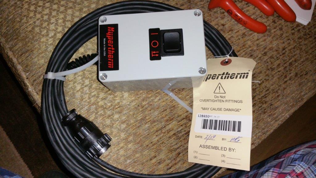

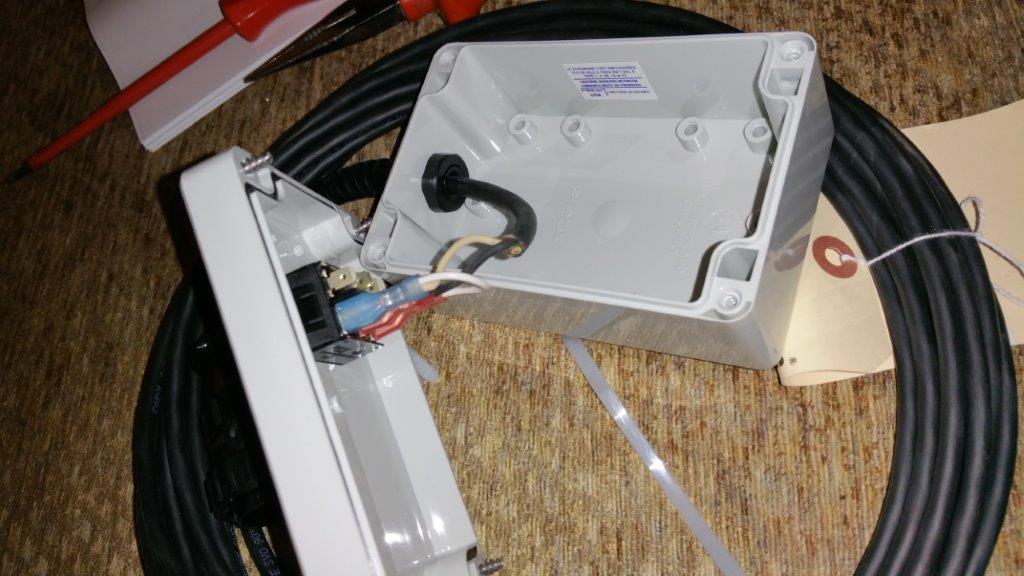

I have bought the T45M and it came with the lead as shown in the photos below and i have a feeling that i will need another cable as this one only has 3 cores even though it shows 2 used.
Attachment 19924Attachment 19925Attachment 19926Attachment 19927Attachment 19928
Any thoughts, alterations or comments good or bad welcome.
Cheers Tommy

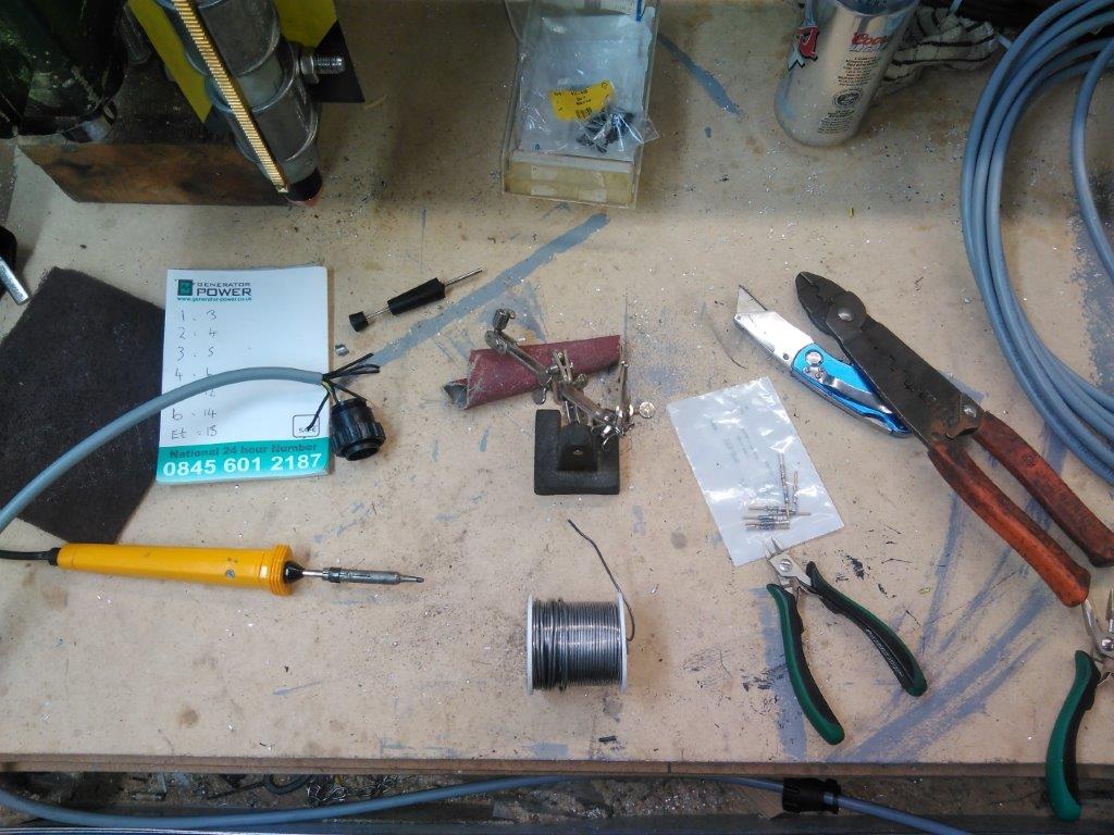

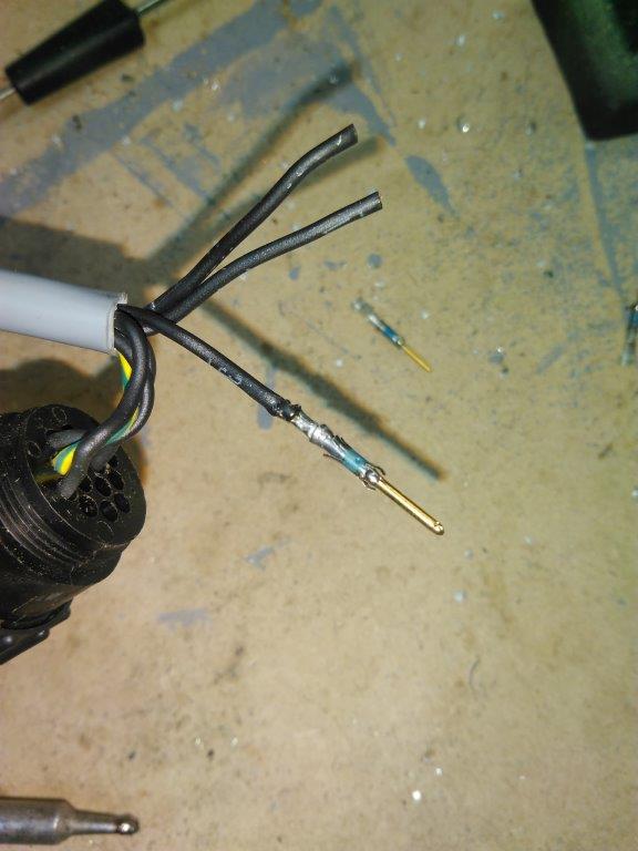

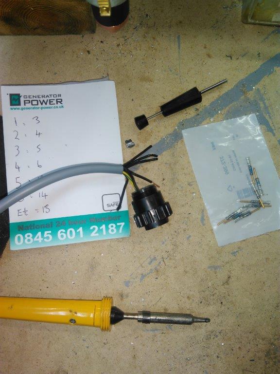

I have bought a new plug and connectors / pins and have wired the plug to suit the diagram as requested.
The machine wont fire from program and i think i must be missing some gcode or macro input as i have tried every conceivable combination of pins and outputs but nothing seems to work.
I have got the full bought versions of sheetcam and mach3 so these shouldn't be a problem. the post processor i am using is the purelogic with fr one which was one off 7 available and it doesn't tell me which one is the best.
I have used the independent button to start of arc and cut the following square as seen but i would like to get it to fire via the software / program.
Attachment 20977Attachment 20978Attachment 20979Attachment 20980

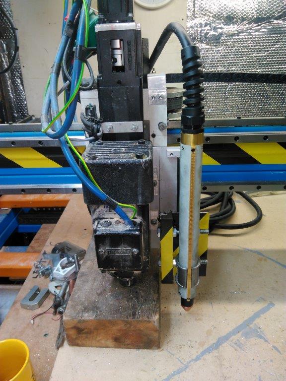

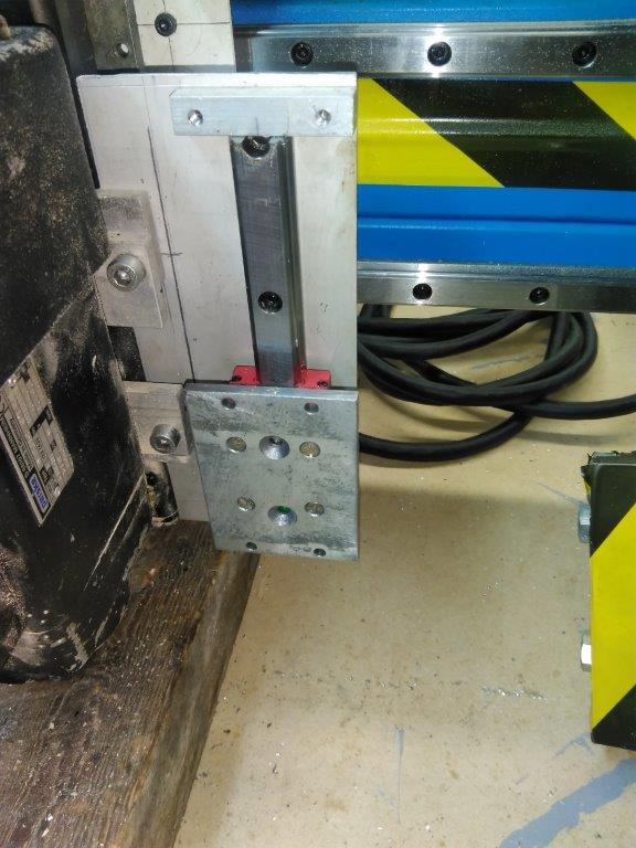

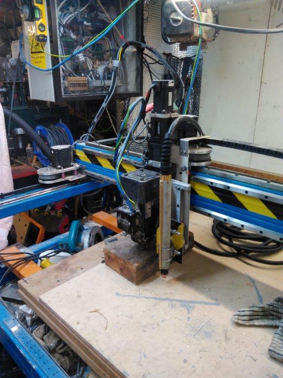

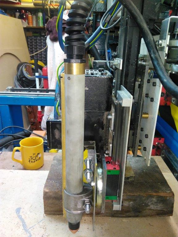

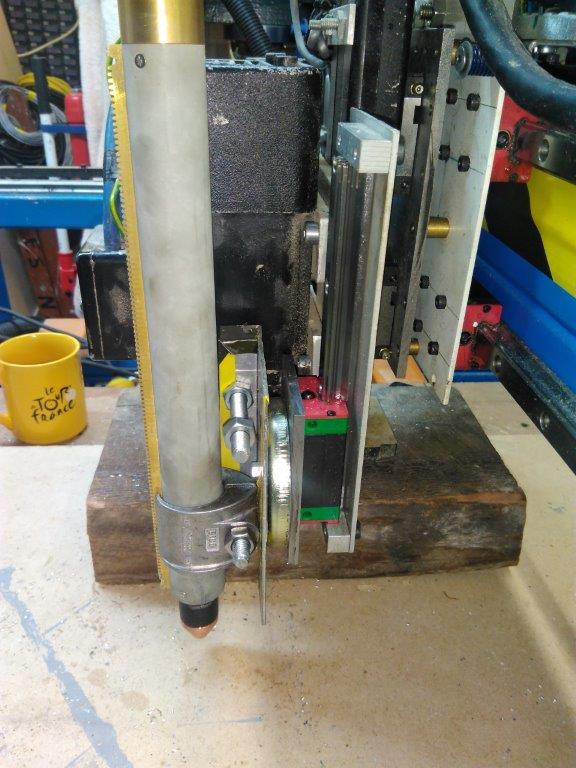

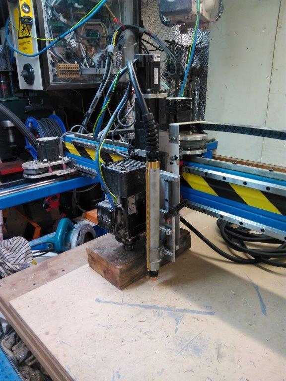

Re: Next stage is Plasma add on...

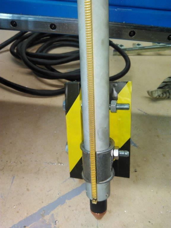

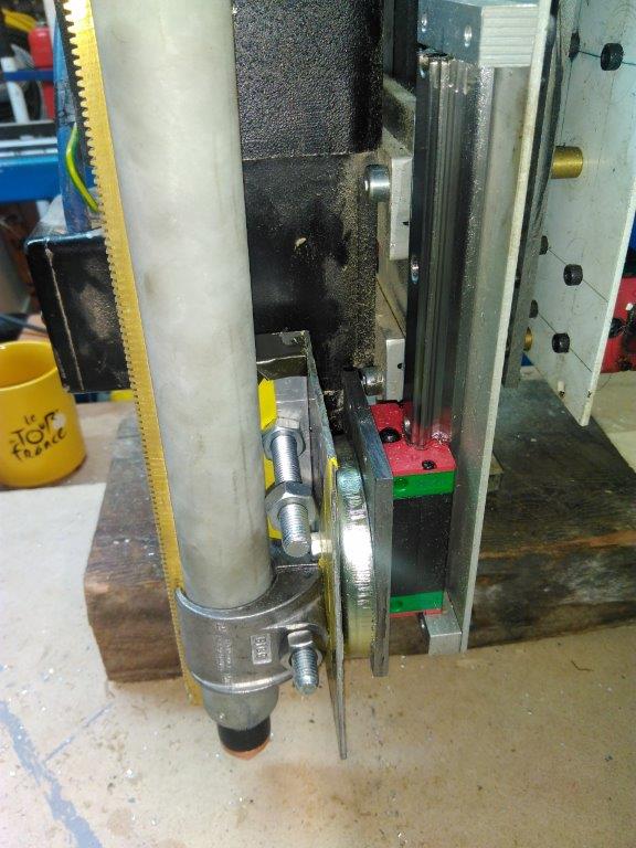

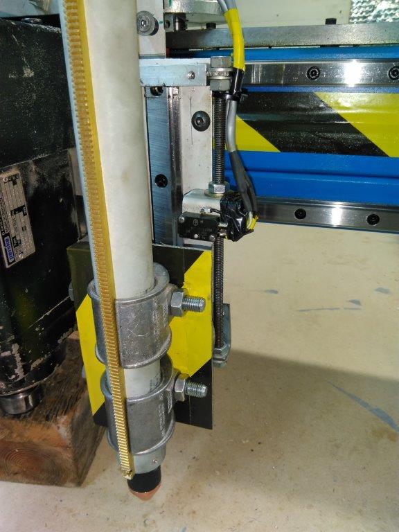

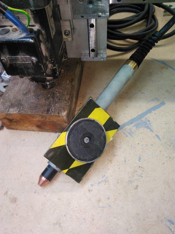

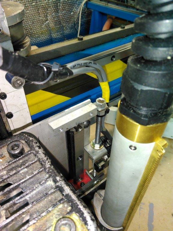

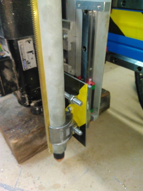

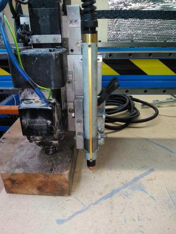

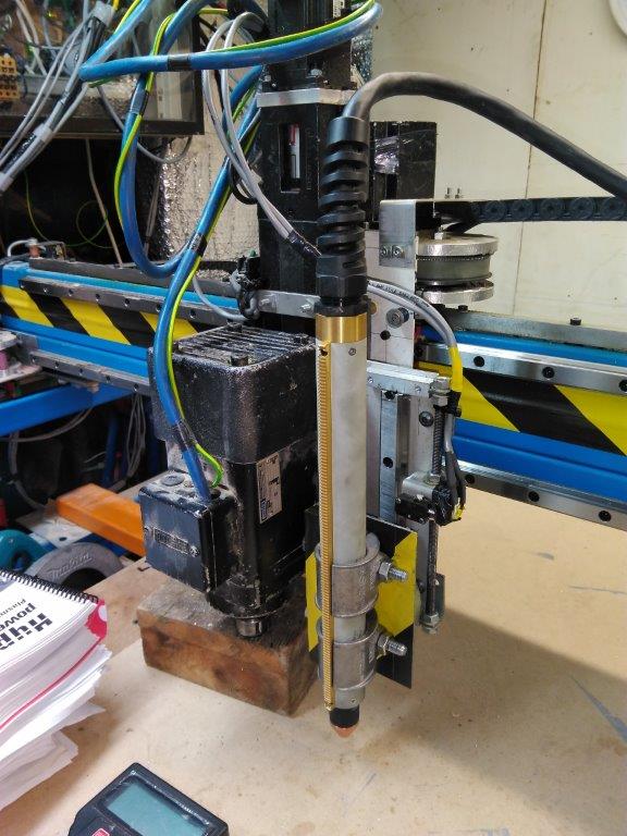

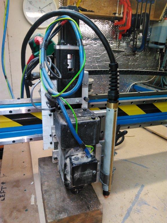

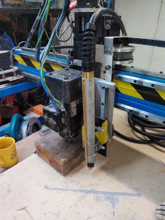

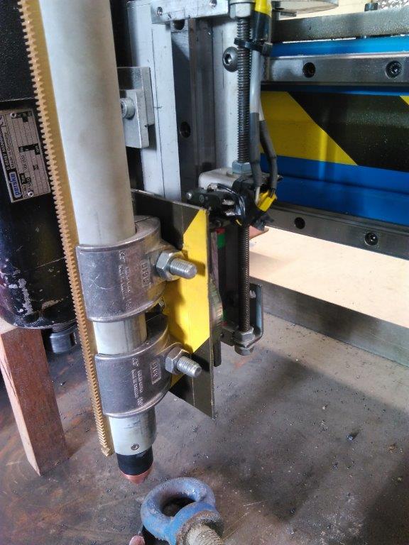

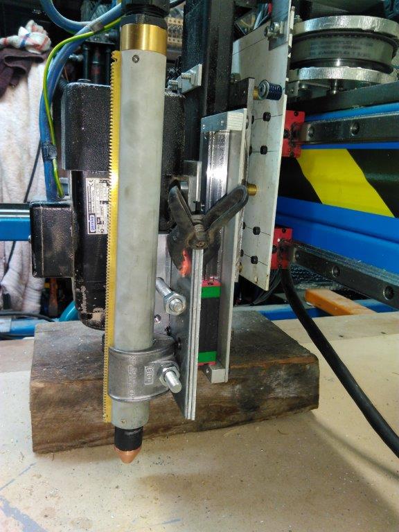

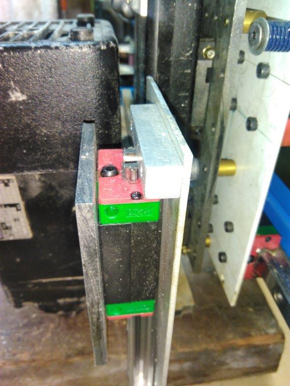

The magnetic base was taken from a magnetic car aerial which was obviously stripped of all plastic bits "and drill through the centre and attached to the torch holder.
The torch is held with two 1.25- 1.5" BICC cable clamps which fit perfectly around the torch.
The torch is very "stuck" once attached but also detaches if it comes across an obstruction. There will be a micro switch attached to stop motion in case of a collision but that is to be attached.
I used this type of magnet so that i have an infinite number of angles to choose from if needed.
The torch and spindle occupy the same z axis as the is plenty of room on the table for both and i just cover it up when plasma cutting and remove the torch when i router with the spindle.
Hope this helps anyone if they are looking for ideas.
Cheers Tommy

Hello Warwick....not had it firing from mach yet only from pendant button. I made my own plug as the cheapest i could find was £86 + vat from a uk source for a 6 pin version. I got the plug wire and pins from RS for less than a Tenner so this was a massive saving.
The lead i made has continuity etc but i think im struggling with the pin outs.
As the pictures show i have a purelogic THC which is made for the hypertherm 45 and this is connected with an ethernet lead so not real sure what pins i need if any. My floating head has a micro switch on it which i have configured for both Z home and Probe scenarios but nothing happens.
I think i am missing some code / script as all the ones i have used have worked for finding top of material but i think i am missing the trigger scripts if that's what you want to call them.
So basically if you have any ideas or could share your scripts etc, i will be very grateful as no doubt, once it works it will be looking at me straight in the eye.
I do have the RS codes for the leads if anyone wants to make their own and save a massive amount of money instead of buying a hypertherm one.

Well slowly getting there.....with help off warwick and Andrew....i have the machine cutting from mach3.
Andrew sent me a few files which i used and alter to suit my machine which is identical to his i.e purelogic and hypertherm and switching on spindle as warwick mentioned i got a few squares cut.
I will post a diagram of my pins etc and how its wired up once i have tweaked it just in case someone else wants to scrutinise it.
Once again many thanks to warwick and Andrew for help on this....
Cheers Tommy
Well....i have it sorted with help from Warwick and Andrew.
Spindle turned on as Warwick mentioned and Andrew sent me a few files to use and also a few phone calls aswell.
I tweaked the files to suit my machine and hey presto....a few squares cut.
I will post my pins, drawings etc of how i wired it just incase any one else wants to scrutinise it.
Once again many thanks to Warwick and Andrew for help on this problem as i think i would still be twiddling my thumbs without them.

Hello All
Rewired the Hypertherm 45 up today and set it away....It now shows the voltage going up and down but still no movement on the z axis.
Not sure if it is a pins problem or a software problem....I'm getting there but one brick at a time unfortunately.
Got family coming tomorrow so can't play with it Sunday which is a bummer but there's always next week..
Ill do some more reading and I have had a few replies from Purelogic which stated i had to use the raw voltage rather than the divided voltage i used previously..
The metal I have used is 6mm thick and quite flat so not sure if it is not moving because it doesn't need to so I tilted it approx. 10mm one end and when the torch moved towards the high end, the voltage dropped but no movement from the z axis.
The machine works as should except for this one little problem and I have attached a few photos of my progress up to now.
Think I will try the software you use to see if that simplifies things.
Will keep playing until it is sorted.
TommyAttachment 21262Attachment 21263Attachment 21264Attachment 21265Attachment 21266Attachment 21267

Well got it sorted eventually as Purelogic.ru sent me the most up to date file and also help off Andrew and Woz (again many thanks).
Must give Purelogic praise as even after buying the items 3+yrs ago, they answered all my queries instantly without delay even though thay are in another time zone and gave me a few pointers aswell. Excellent customer service.
It now moves..........so very happy and now on to the free water table build.
