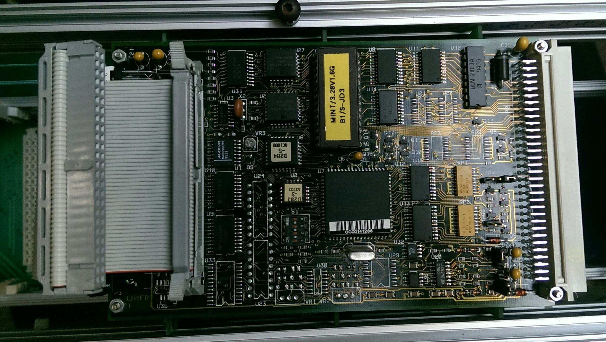

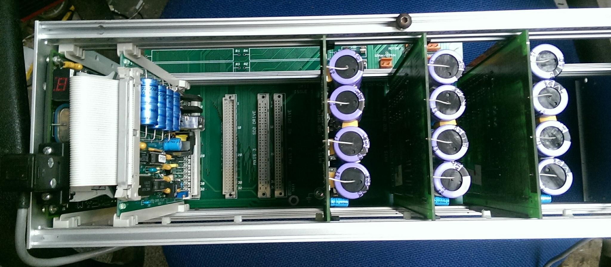

I've got a complete rack from a 90s VMC sat on the workshop floor just now, and I'm near Edinburgh. It's got a Mint V3.28 eeprom in it.
Attachment 19990
Attachment 19991

damn, that is the same DOS eprom i have already. Trying to get it working on VR5 in order to retain the atc operation. Out of curiosity have you converted your VMC to Mach with a tool changer? What are you looking for the parts?
